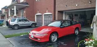

So about 2 months ago i pulled into a gas station to get gas. After getting gas i got in thr car and it wouldnt start. So i got it towed back home and started diagnosing. Verified fuel at the return line, spark by arching the plugs on the valve cover. I replaced the fuel filter and coolant temp sensor. When i pulled the plugs they were completly soaked in fuel so i replaced them and gapped to .28. It wants to startit kinda does but instantly dies, also when getting into the car the cel comes on but the boost gauge does not go to zero. The car is completly stock and its a 1g awd.
