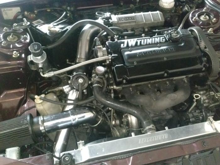

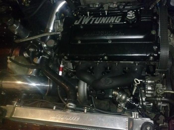

This car has been a project of mine for the last couple years, got it pretty much stock, and is now an 11 sec street car, built and tuned by me in my garage. This last year has been my most successful getting into the 11's on a 20G turbo and full street trim on 92 octane Gasoline, but still is not enough for me, its time to get serious and grab some 10's. You guys will be seeing a lot more from me this 2014 season.

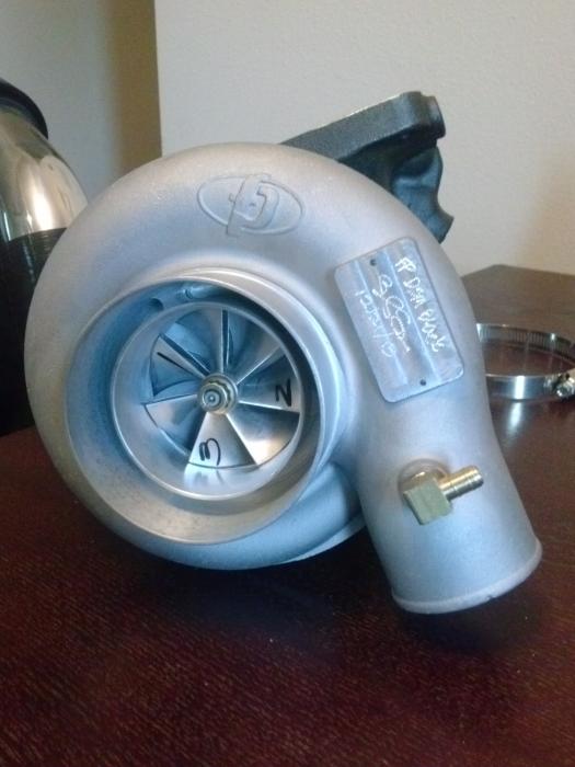

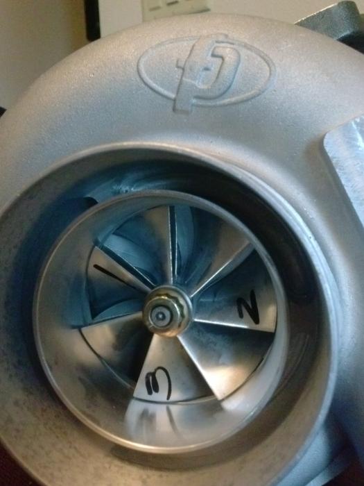

I bought a JB Black turbo from Forced Performance for my weapon for this next year ( though they didn't send me any stickers to rep them, hint hint FP ), and plan on running E85, so let the terror begin. :hellyeah:
I'll be updating over the next couple months as I get everything together and get the turbo on. [ame=http://www.youtube.com/watch?v=tAHVOCr4K6s]20G Eclipse GSX 11.96 @118.6 mph - YouTube[/ame] One of my better passes in 2013 on the 20G. All Mods are up to date in my profile.

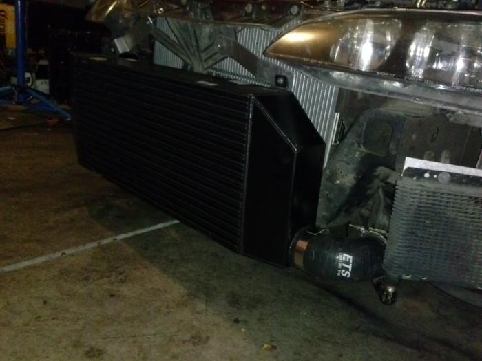

Gratz on the Black...nice intercooler too looks good on there...you gonna try to be at IFO in may?
If we get the white car together by then hopefully he can get that up there too. Should have the fwd ready by then and we will see you up there. I have too order another core now too to go with pipes I have left..LOL
Nice build. I'm running the black as well. Pulls real good and I only got to 20#s before I ran into some problems. Going to meth injection, sd and a boost solenoid after I get my tranny back. Interested to see what kind of power you put down.
That's awesome man! What's the spool like? Does it have a hard hitting torque compared to your old turbo?

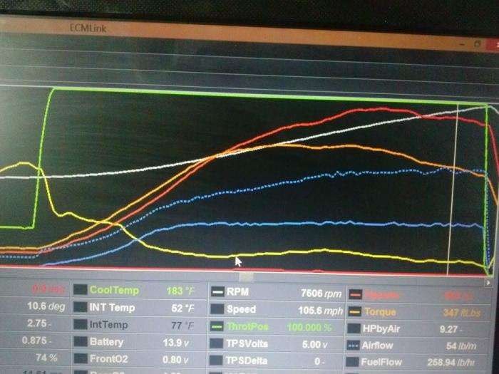

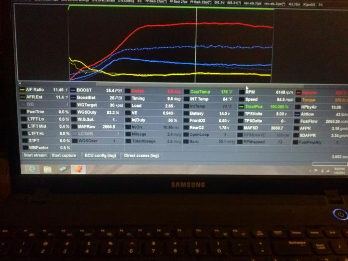

Spool isn't bad. Its a little laggier than I expected but still feels nice. Saw 20 psi at 4600 rpm, and 25 about 4800 rpm starting a pull from 4k, and im seeing between 54-56 lbs/min of airflow at 28-29 psi between 7-7.5k rpm.
Doesn't hit as hard as my 20G and I definitely lost some mid range torque, but once the torque comes on it holds and just rips no problem to 8k rpm, and the power up top more than makes up for the loss of mid range.. Also There is nearly no lag between shifts if I shift fast, so that is nice.
Overall I think its an awesome street/strip turbo. I should have some dyno numbers by this weekend, next weekend at the latest.
