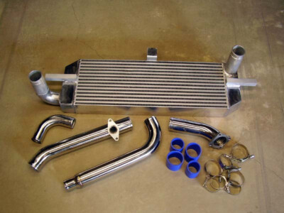

Tell us more about the car and engine mods. You may not NEED a FMIC and could go back to a SMIC (which are a dime a dozen). If you do a lot of revving of the motor and do that back to back, the SMIC will heat soak where as the FMIC won't (or not near as quickly). A 3" core with 2 1/2" piping would keep lag at a minimum over large piping to keep the velocity up.
Here is one of our vendors super short route FMIC's. An internet search may find you some other options that may be easier on the wallet.

VRSF "used" to make a short route FMIC that came with all new piping and a fairly nice intercooler but they have quit producing them for some reason. Those are the intercoolers that I run on my DSM's if it isn't still on a stock SMIC. Keep your eyes on our classified ads and maybe one will pop up.

RTM Racing and CX Racing both offer short-route front mounts with intercooler piping.
RTM Intercooler
CX Racing Intercooler
Dont have personal experience with either one. i have a ETS 7" street for my Evo 16G, which is a smaller sized intercooler compared to other options out there. Purchased a CXRacing piping kit from someone who never used it and it fit fine other than some minor trimming of the bumper around the fog lamp on the drivers side.
