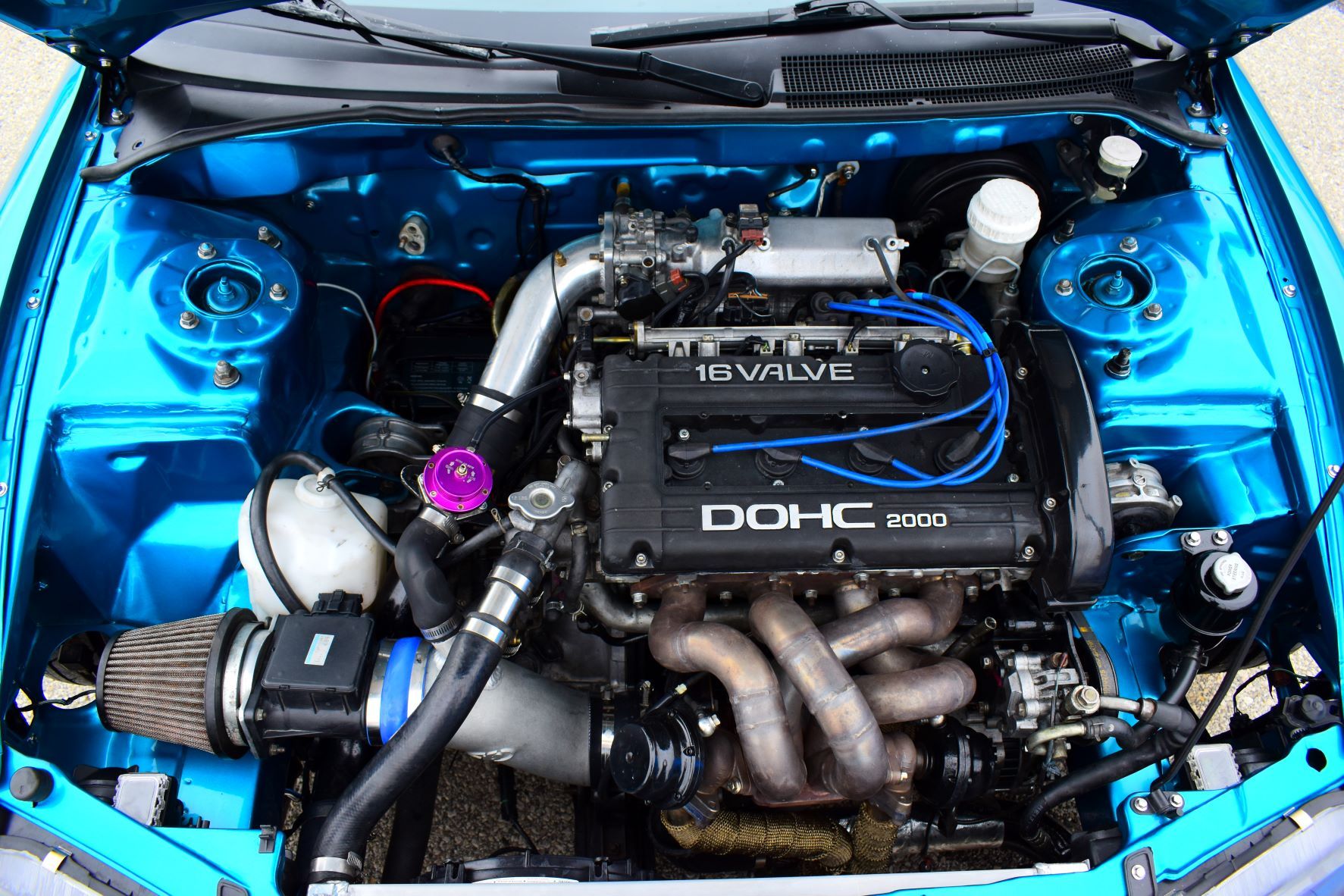

Looking at your build thread pictures, I think I answered that question.
