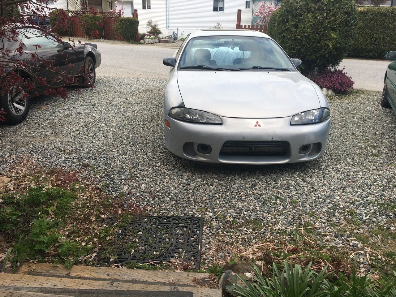

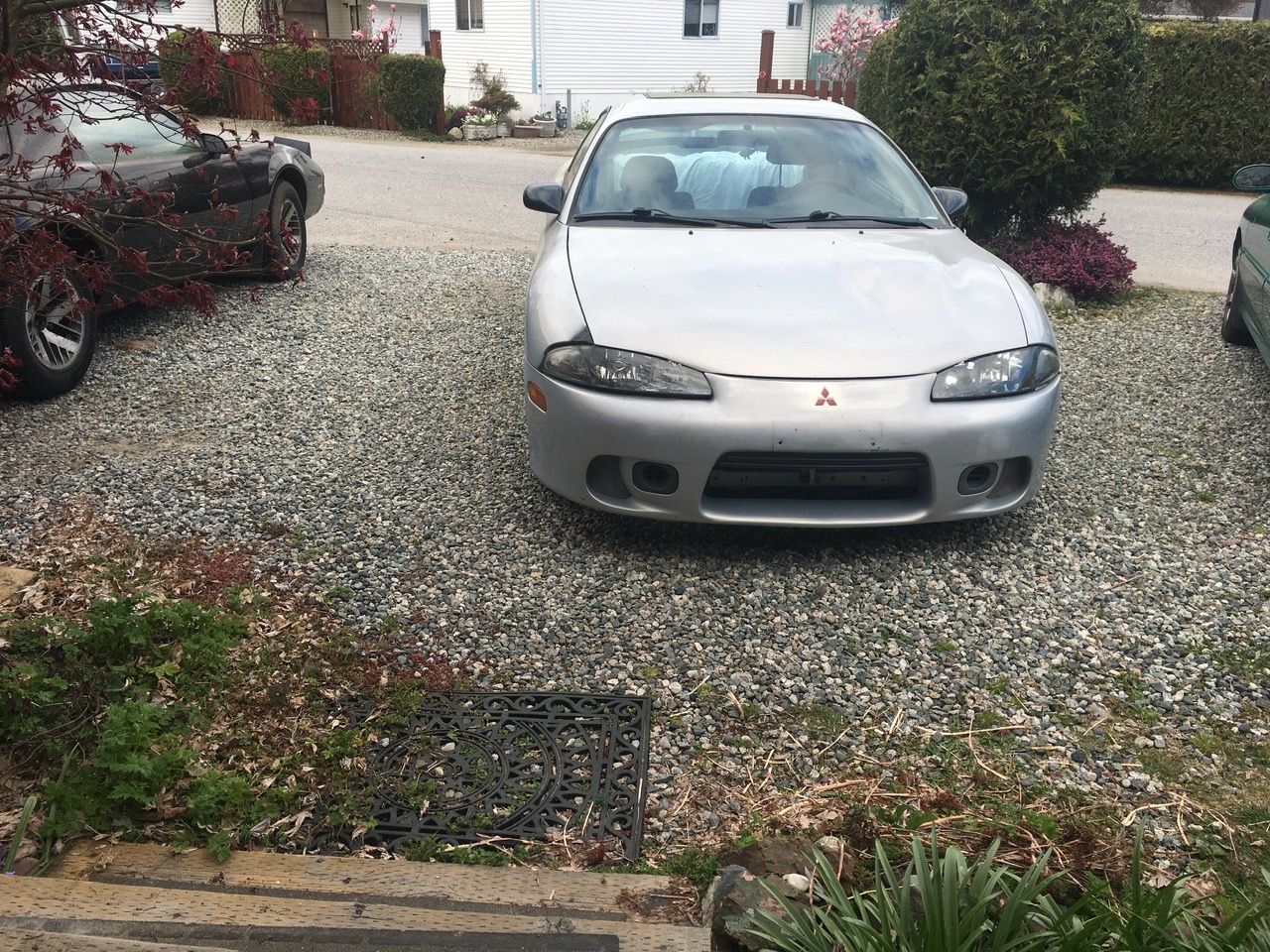

1999 eclipse rs project. —> AWD ——>evo 7 4g63T, auto —-> manual

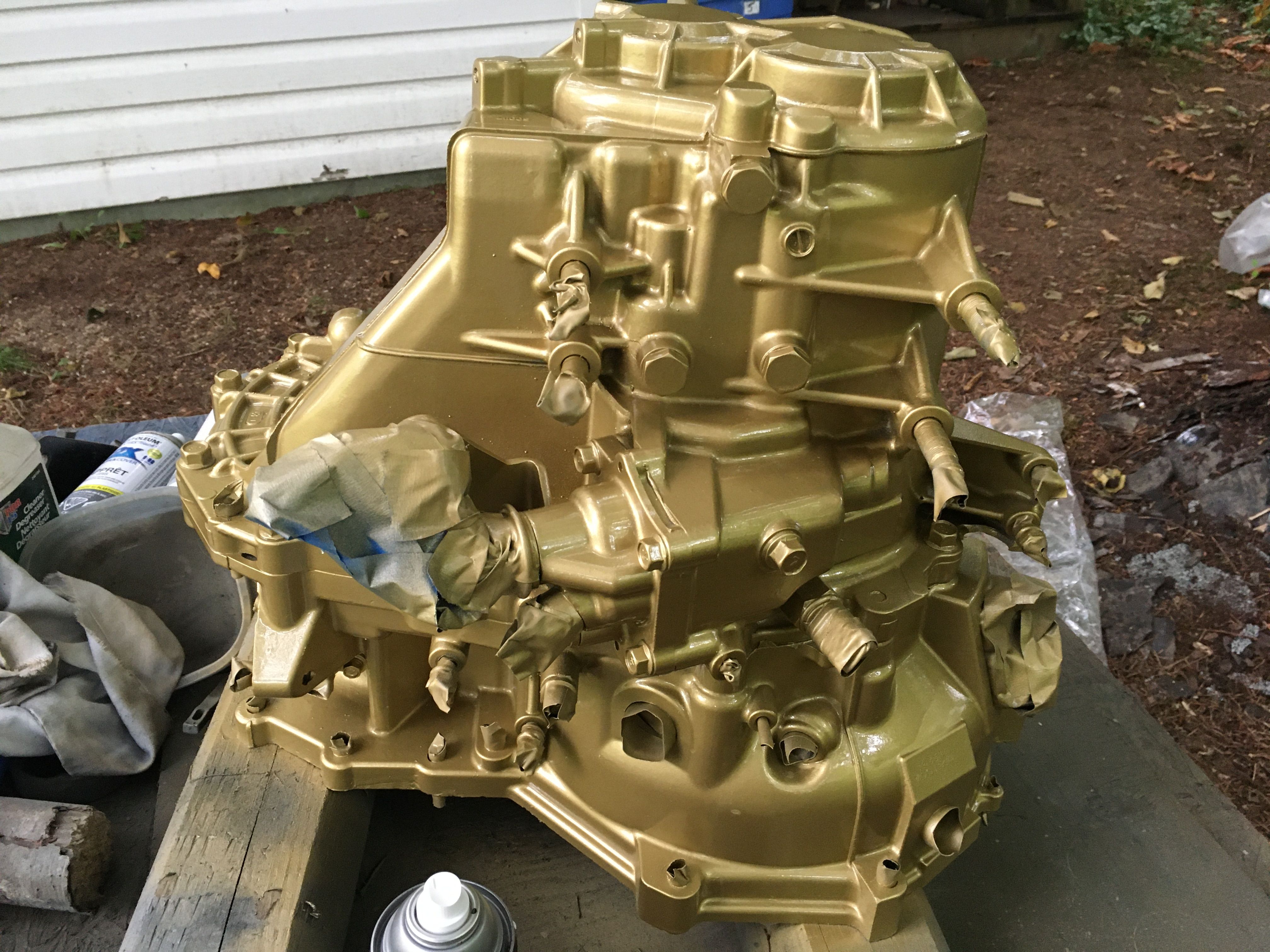

Howdy everyone! How’s a going? so the plan was to gather whatever drivetrain componants I could and get as much together as possible before buying an engine to swap in and that’s what I’ve done. I’ll list what I’ve gathered and what it’s used for, if anyone sees anything out of place, or has questions or info to add or anything helpful, it would be super appreciated. Also going to be starting up a YouTube build channel to document the process.
For anyone wanting to do this swap; IT WILL be time consuming, even if you can do it thrifty, it will still cost a lot. That being said, the DSM community is really helpful and friendly overall, and everyone I’ve met in relation to my build has been great energy about it. Evo community? Ehhhhh, their not baaad. But I’m ironically painting evo parts gold.

- 1999 eclipse rs complete, bone stock maybe AM sunroof? Idk.

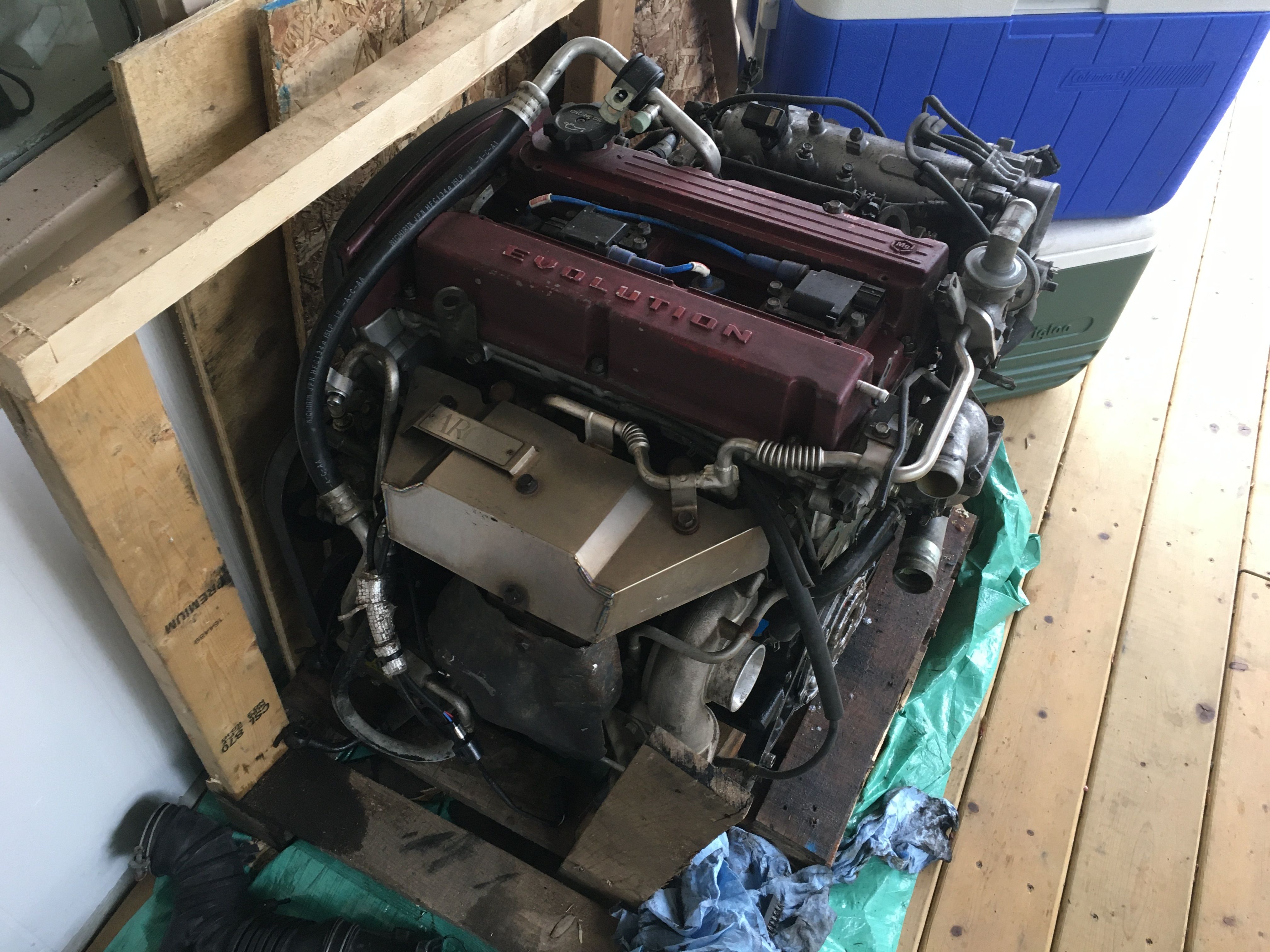

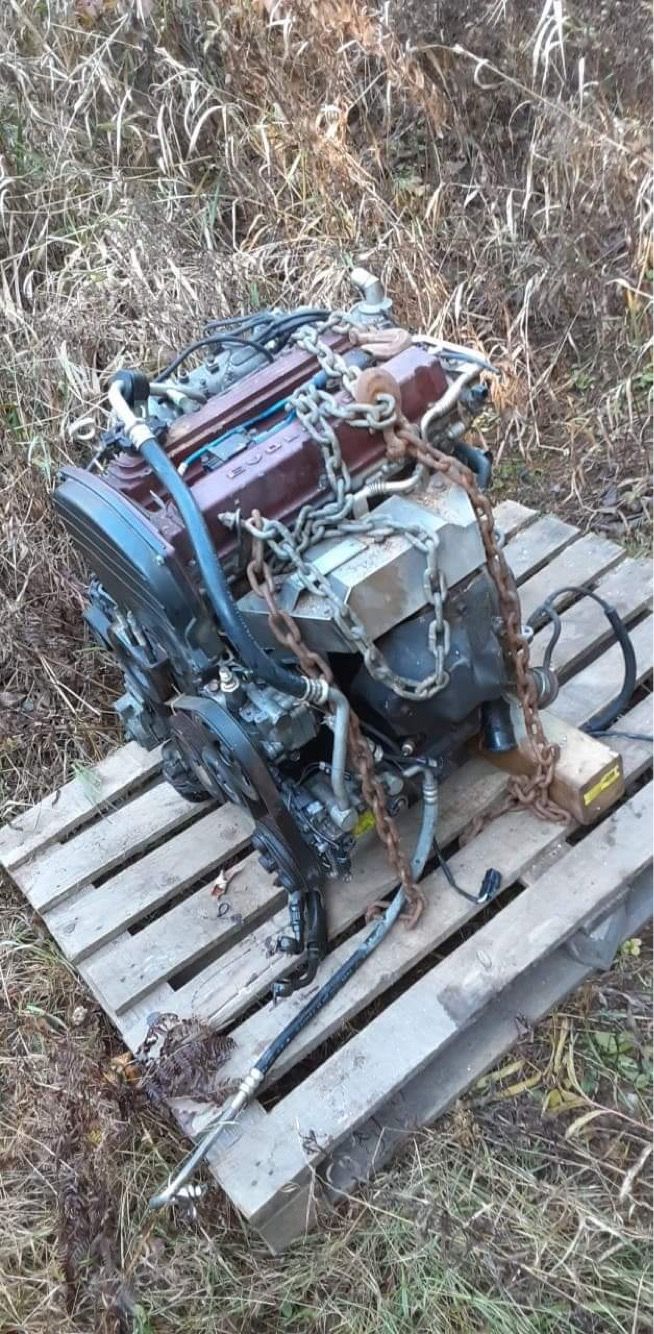

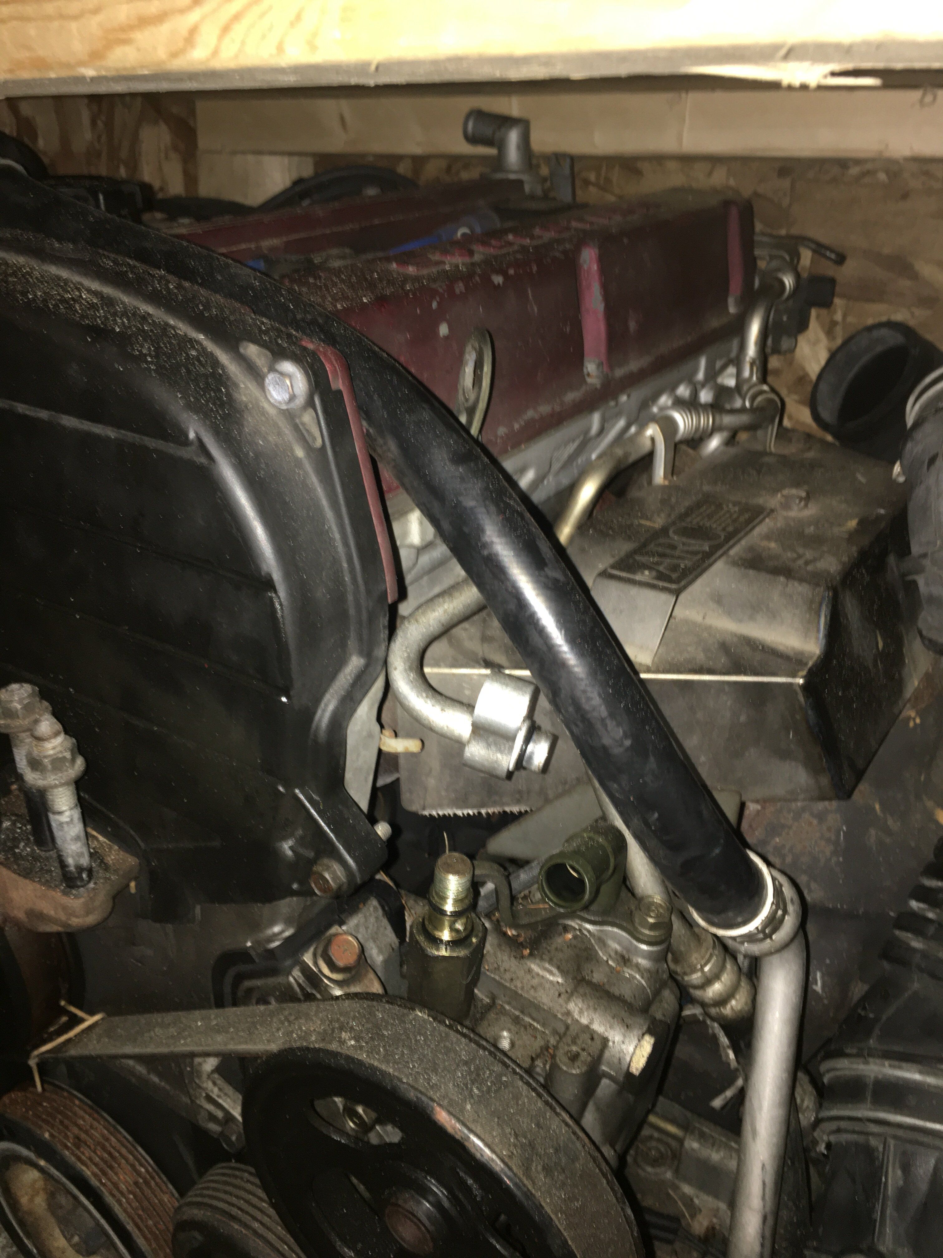

- Evo 7 long block 4g63T
-Evo 7 ECU

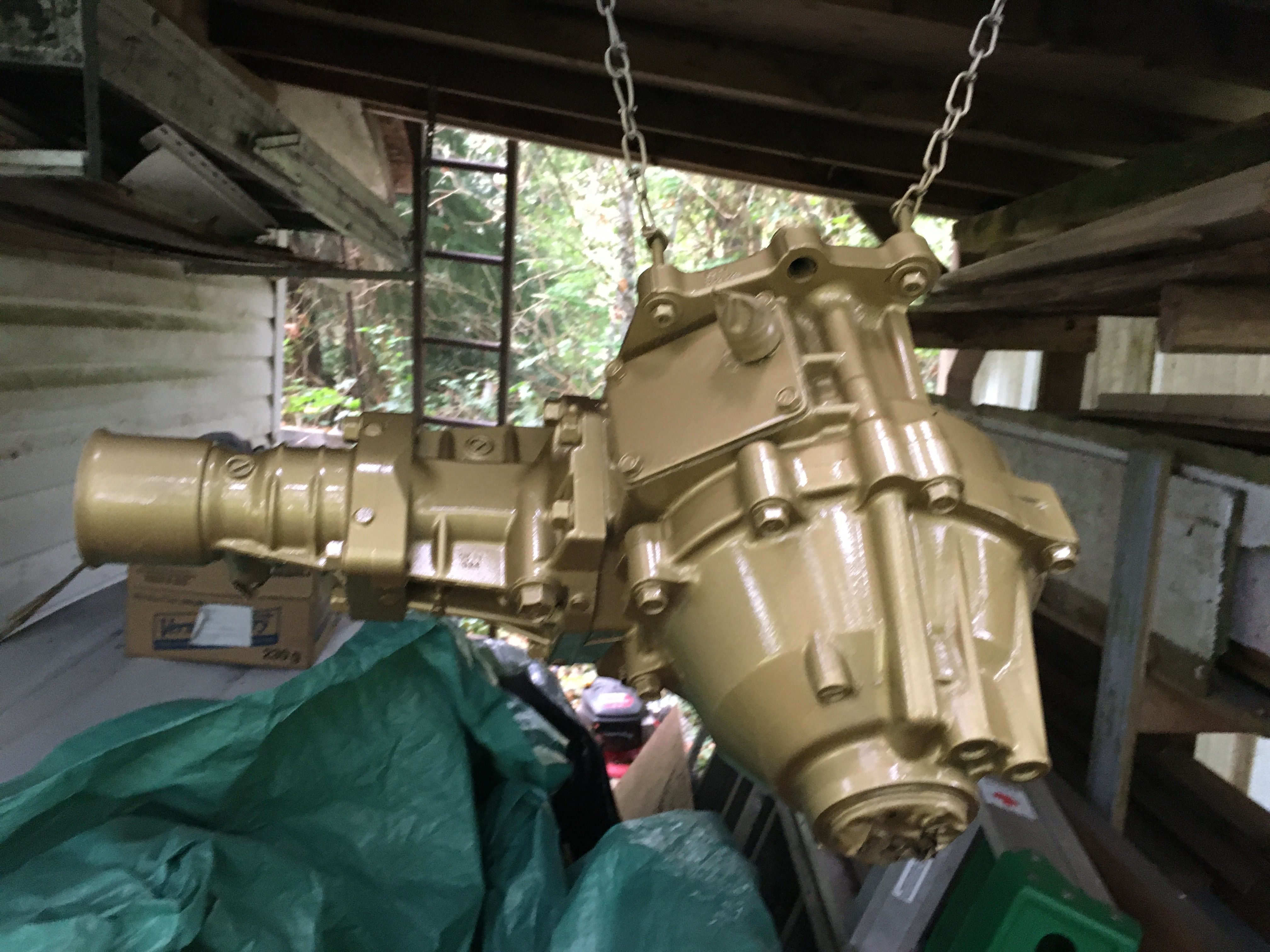

- Evo 4 trans/tcase

can anyone explain the dynamic of the 3.307 rear diff ratio in relation to the evo trans, particularly the iv. The 5/6 appear to have a 3.307 rear diff whereas the evo 4 has a 3.312. Is this something that I should be worried about? I found a thread where someone was asking a similar question about an evo swap in a Peugeot, some sad bad news, some say its close enough to be safe.
