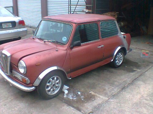

Well, title says it all. I know its been bounced around but no one done it. But after a few years or hording dsm part I ended up with a conpmete gsx (two more 1gs on the way) a set of sub frames extra blocks and heads, to much to list. The mini is a 1968 wolseley hornet that I drove way too far to get ( from n.h to florida) have had it avout year got I running drove later found out it wasnt a real hornet it actually an 80 mini with a hornet body parts. That discovery mhas brought me to this since its not authentic im ganna have fun. Ive done alot of measuing it will fit...barelly
Heres the car the day I got

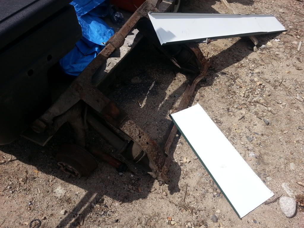

Now its in the garage and ive had a few hours to tinker with getting the body stripped
[/IMG]
[/IMG
[/IMG]

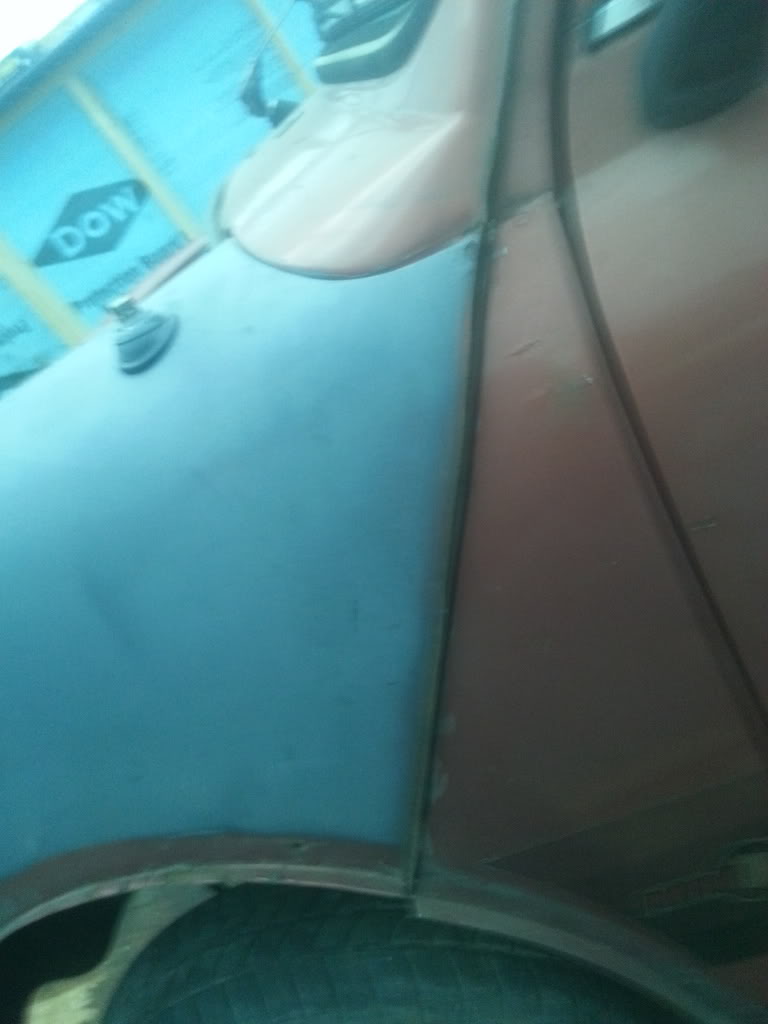

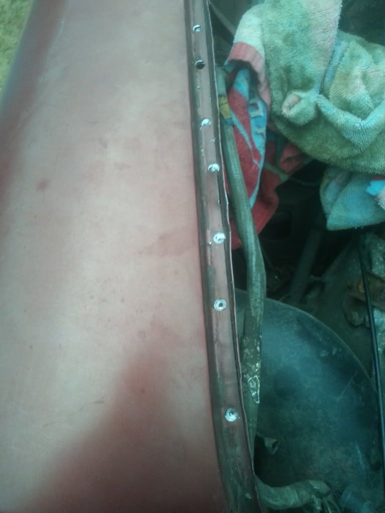

So far ive managed to pretty gut the I side drill the spot weld that hold the fenders on and cut the A panel he the fenders a spot welded to as well. Not how most people do it as far as cutting the A panel but mine were rotted so I dont really care. Also did so parts organizing

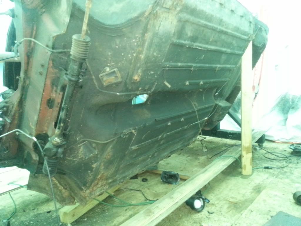

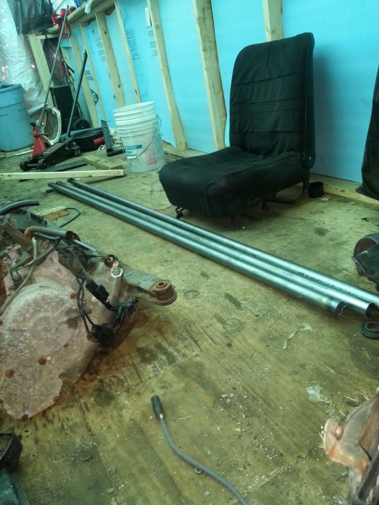

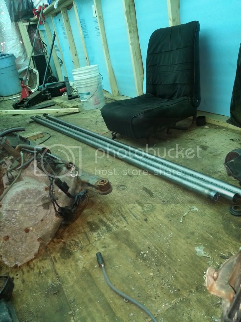

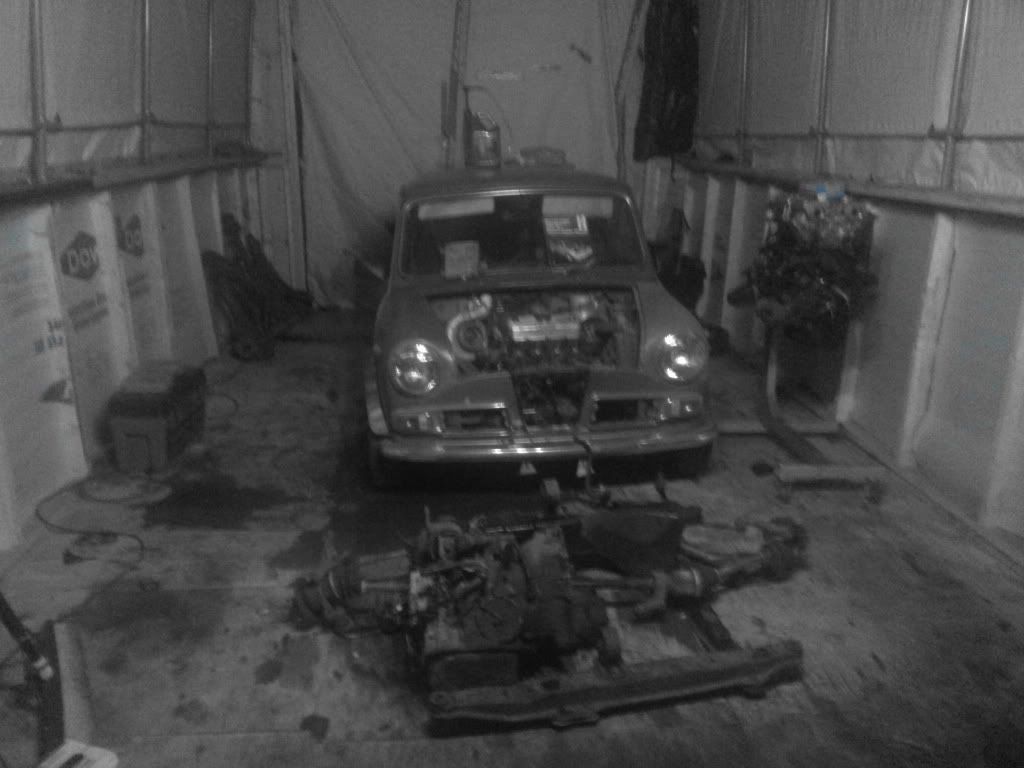

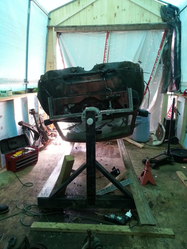

Got some more stuff done, managed to get the nose off after getting the engine and sub frame out and built a rotisserie to make life a little easier also got the rear sub frame out and picked up some 1-1/2 x .120 dom tube steel. Have also decided to build tye motor and run my big h1c holset with a bullseye hhousing. Might ad welk go all out if im going this far.

[/IMG] proving how lifhtvthe car was by picking up the back half ]http://

Thanks:D im glad you guys like the build should be some more progress soon I just picked up a new 175 mig, now I just got to get a gas bottle and my tubing bender and Iill be starting to build the front sub frame. The benders is going to ti be a week or two to ship so in the meantine ill be continusously reworking the subframe plans to see the best way to run horzobtally mounted coil overs.

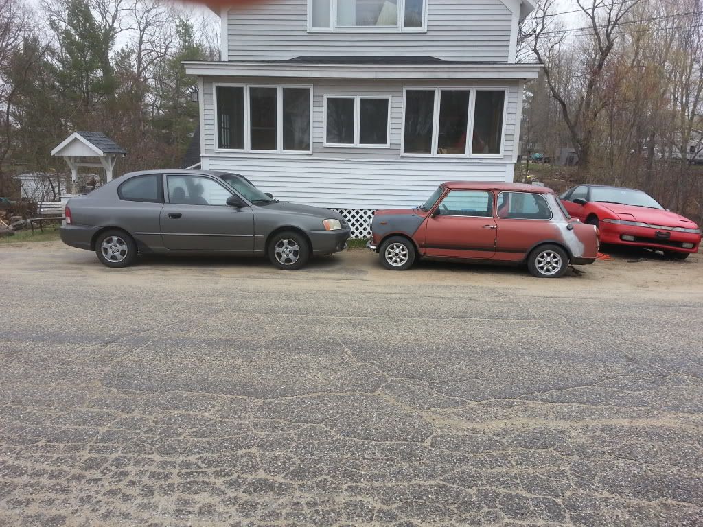

An austin america would be pretty cool I havnt seen anyone playing with those. I just cant wait to get the thing going its gaanna be fun blowing the doora off everything in area were I live with car thats only 4.5 feet tall. I love the 1g talons there so ugly that there good looking haha. I have a hard time cutting up the 1g if I think about it to much im always trying to find any reason to not do it but its in such bad condition it definitly time for it to go. I think Id cut up a 1g for a galant though I love those too.

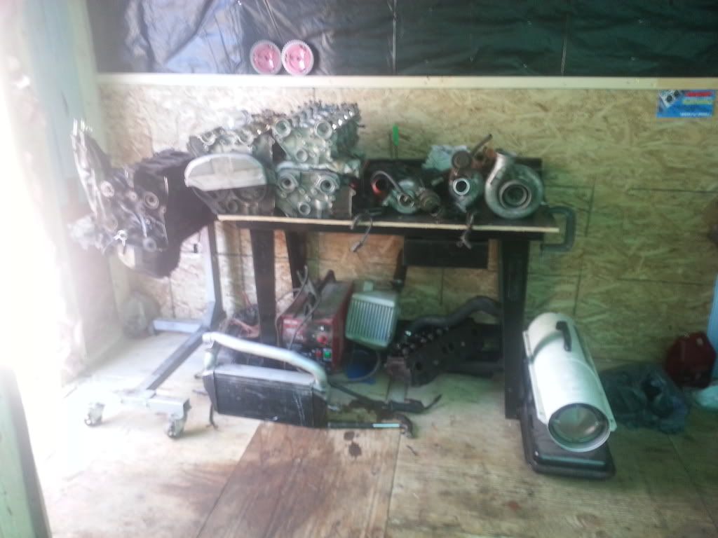

Small up date. No real progress went to get a welder and then didn't have the one I want so I ended up buy a 175 instead of a 130 so I need to get 220 ran out to my garage.also will be picking up the 2 dsms finally so I can getvmy harness and ecu finally. Also started to pull apartbs block I picked for 100$ was told it ran but was making 'bad noises" took apart s found a broken piston and a spun bearing also the rod bolts were no where near the required torque spec. Was able to undo them with a 1/4 inch ratchet with no hassle which was a first for me LOL.

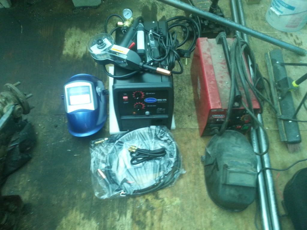

Thanks for subs and taking interest in the project.Im going to pick up the wiring harness and ecu for the car tomarrow. I got my welder running but the regulator that came with it is bad so once I replace that I can start fabing the subframes. A buddy is lending me a pipe bender so that helps my biggestest prob is the fiberglass nose it has a 4-6 week period befor I get it becuase there built as ordered and im not to fond of fabing sub frames with out the nose here but atleast I can get started. Sorry for the lack of progress hopefully soon there will be some more leaps in progress
