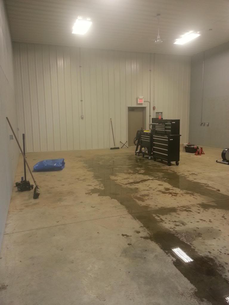

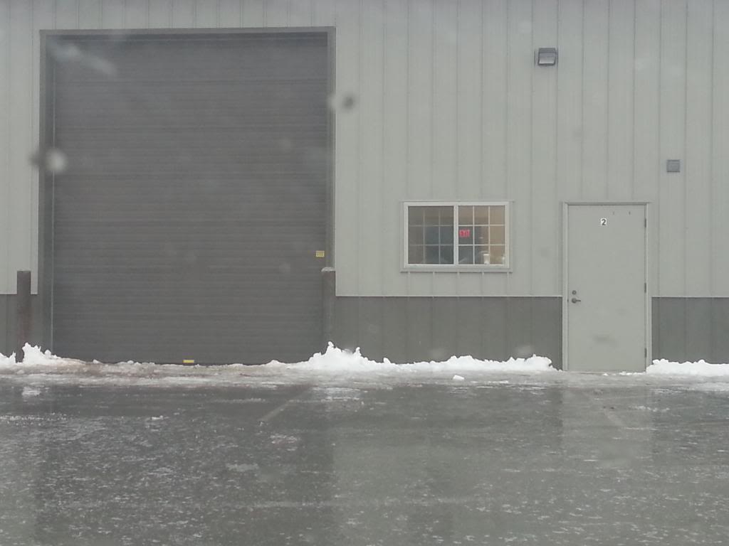

Nahh I havnt yet, i havnt even got the car there yet but ill be sure to post it as I do it. Yeah im sick of playing game me and my buddy both rented a bay each and he a certified tig welder, we are looking into gettibg into the fab part of buisness. The next tool is a burn table, I have an in with the engineers at my work and a couple have built there own cnc so with solid works and a little training I should have a good set up. definitly more to come just need to get every thing moved to the shop :) sgould be with in the next few weeks ill have the bender hydro conversion done and dies. In the mean time Im ganna continue modeling the aubframes in solif works to figure out a good horizontal coil over set up
