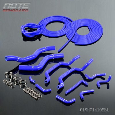

Here's a kit on Ebay that might fit, and includes some vacuum hose.
That's not a recommendation, I just picked one.
I'm doubtful you'll find anyone that knows exactly what sizes and lengths you need. You'll need to measure your own vacuum hoses and estimate total length of each size, and then round up.
