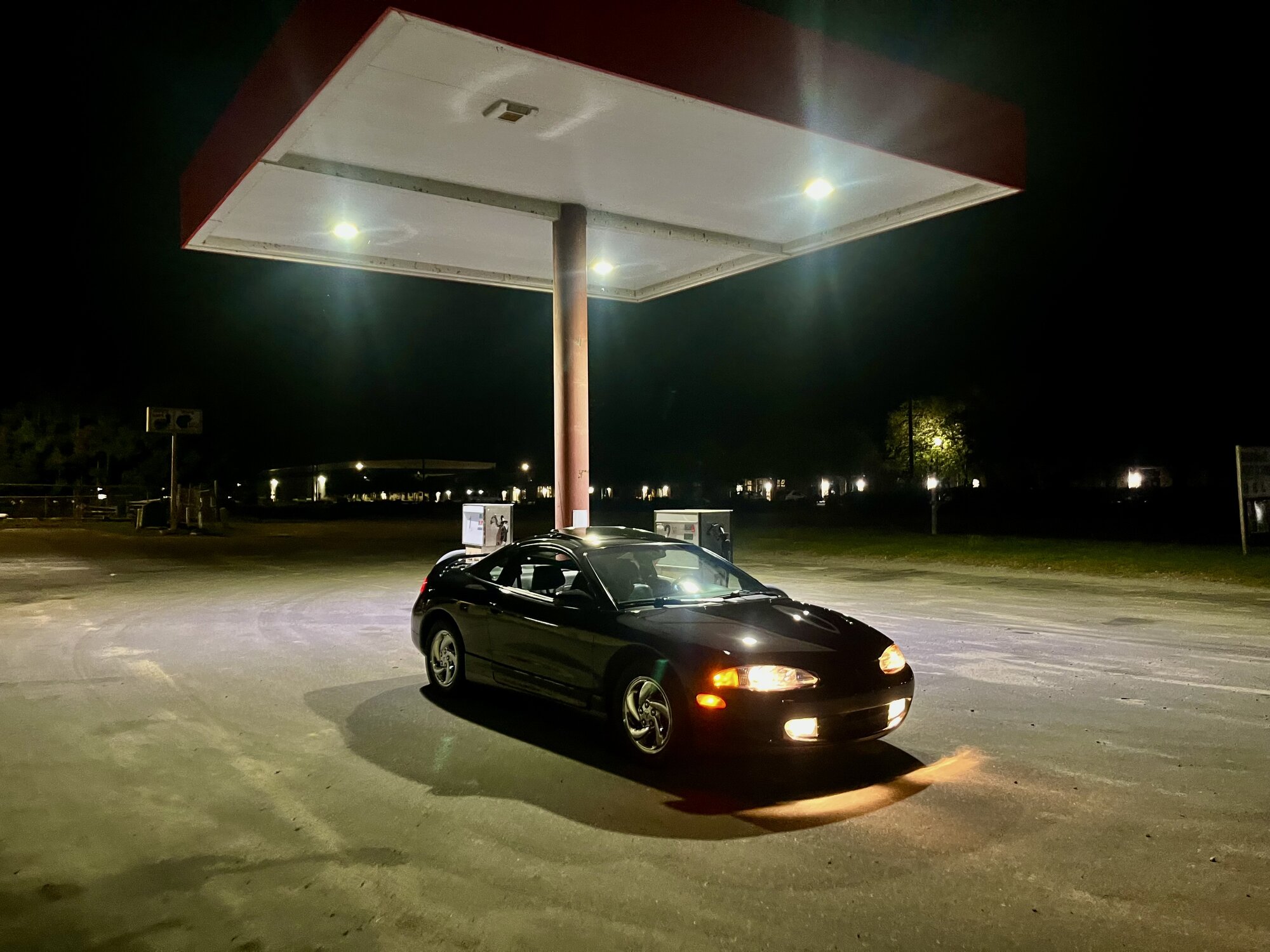

This is the Build Thread for DD Eclipse. Reply below.

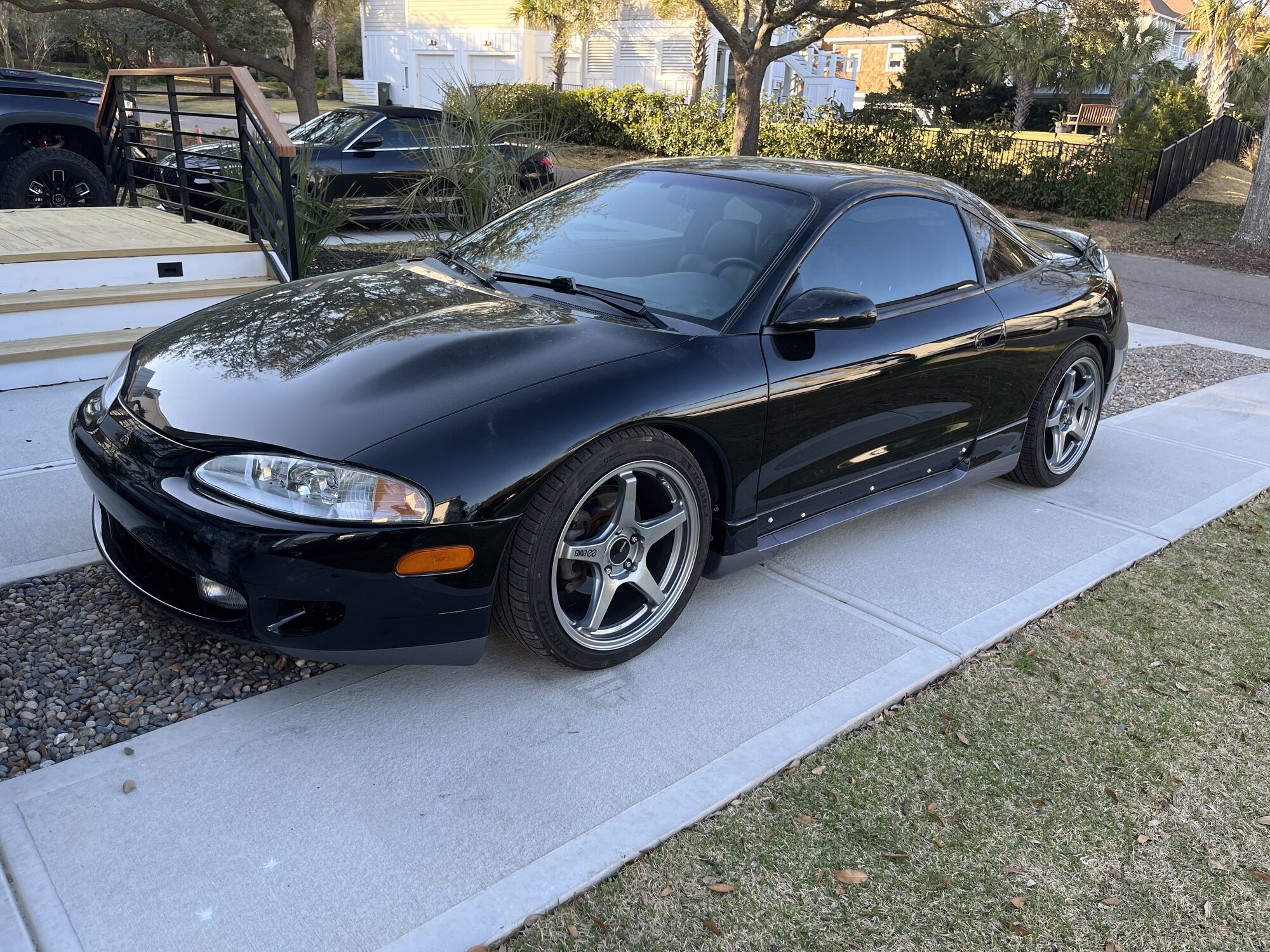

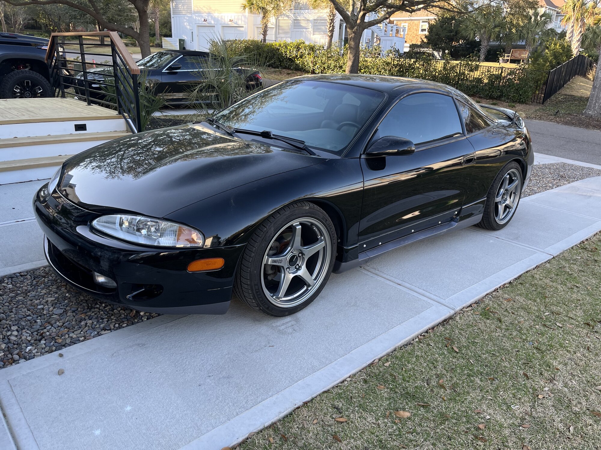

Hello, may I ask about the TS-5, they look like a great fit on the 2G, and they remind me a bit of the Evo 8 Enkei 6 spoke wheel, it's hard to tell from the image but are you running 17 or 18 inch? Also what width and offset if you can share? I'd love to know since I like the idea of driving with a 17 inch like the Evo wheels but trying to find them secondhand doesn't really edge out pricewise compared to getting a new set of wheels like the TS-5s, plus the 5 spoke design looks nicer imo compared to the 6 spoke design, especially if you get some nice calipers.Got Enekei TS-5 and Feal coilovers few months later… was sitting like a truck for a bit
Also both door caps broke off so currently in the market for 2ga ones
Thanks for the reply, may i ask how do they ride? From what i’ve read and watched 18 inch wheels tend to give issues to the 2Gs. Do you experience any rubbing/scrapping or contact with your suspension components or wheel well? Are you on stock suspension? Lowering springs? Coilovers? Wheel spacers? Would love to know.I completely agree- they're 18X8.5 +38
They're not terrible- i got Feal Coilovers and it took a couple of adjustments to get it right. It's only bad to the point I have certain roads I take because potholes are terrible but i don't clench on speed bumps or RR crossings anymore. If i do hit a big bump, the fender is actually what makes first contact- iI have little lines in my tires from rubbing but nothing that isn't manageable.Thanks for the reply, may i ask how do they ride? From what i’ve read and watched 18 inch wheels tend to give issues to the 2Gs. Do you experience any rubbing/scrapping or contact with your suspension components or wheel well? Are you on stock suspension? Lowering springs? Coilovers? Wheel spacers? Would love to know.
