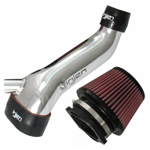

The K&N Filter you show is for a turbo, as stated. Your profile shows you have a 98 Eclipse . Is it a 2.4 N/T or Turbo...Is it a V6?... If it is a turbo, a cold air intake will do you no good. Let us know what you have would help find the right intake.
The factory MAF location makes it so you cannot put on a standard type cold air intake. They do have kits available such as this one but they are quite expensive and everything stays in the stock position. There are many mods you would benefit from before doing anything to the intake. At the point where the intake becomes a major source of restriction you will probably want to run speed density which will use a MAP sensor and you would eliminate the MAF

Ill save you hundreds right now.
Get the ebay style aluminum intake pipe. Get the 3 inch adapter for the maf. And buy a 3 inch k&n filter. Now you'll have to measure say an inch from the maf to what kinda length and width, do you have to fit in said air filter.
