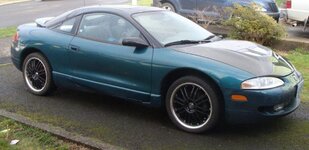

OK... I looked. I really did.
I found articles on how to remove the washer nozzles from the original hood.... BUT I need to know how people went about fitting those nozzles into carbon fiber hoods. The one I fit through the new hood wants to spin to the side and will not sit down flush in the hood.
What do now?
