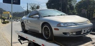

Hey! My car was clicking but was not cranking, and it turned out to be the battery. I just changed the battery, and wanted to take a look at the radio, because it was not working. I removed it, and also the door panel (window was not going down so I wanted to take a look at the motor). Midway I stopped, I wanted to go somewhere to buy a new radio so I could install it. Turns out I couldn't start the car.
When I turn the keys, I hear a "click" sound, but no other signal of life. It can't be the battery because I literally changed it today. I don't even know where to start looking for the problem because I'm pretty newbie. Any tips/suggestions? Could I accidentally disconnected something when removing the radio? I checked but everything seemed in order.
