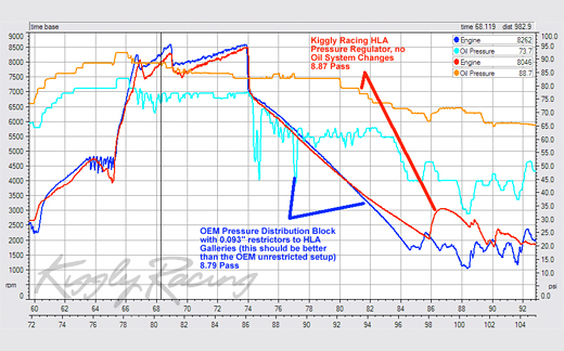

HKS 272 Delta Re-Grind Cams Here. How would the Kiggly HLA benefit me besides making it shine underneath my valve cover?
Sure , but I'd rather have people's collective knowledge than some sales blurb off the manufacturers web page. I've heard before that they're not worth doing (can't remember where)
It regulates the oil getting into the head, so you have more oil in the pan.
There have only been a handful of cast rockers breaking. I do however run evo rockers. They are slightly lighter and have never seen any cases of them breaking.
I was thinking the rockers were better designed to see higher RPMs. Lighter & Stronger.
The Kiggly HLA seems to point out a flaw in OEM - that there is significant drop / fluctuation in oil pressure after hard acceleration. Apparently it is the fix to that. Interesting, didn't know that was a problem. I certainly don't want to see my bearings get chewed agian, so this could be cheap insurance. I'd like to see more evidence of it working besides Kiggly's chart but I'm becoming convinced.
