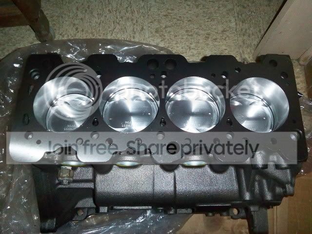

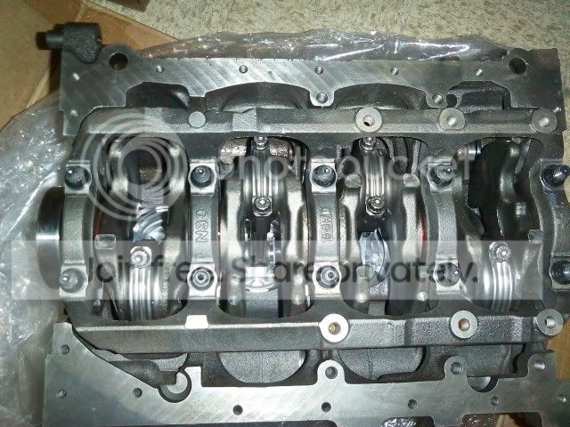

Last year my motor spun a rod bearing. At first I was gonna do a 6-bolt swap but I found a 99 7-bolt for the same price. My goal is to use all original 2g components in my car. Nothing against 1gs I just want to be more on the unique side because nobody else here in Utah is running a built 7-bolt to my knowledge.
The shortblock was finished last spring by Jensen Auto Service here in Utah and it looks tough if I must say so myself! You don't see 7-bolts done up like this very often.
Here's some specs:
2.0-liter 99 Eclipse Revised 7-bolt 4G63T
Eagle Forged H-Beam Rods
Wiseco Forged 9.0:1 CR Pistons
ACL Tri-Metal Rod Bearings, Main Bearings, & Revised 3-piece Thrust Bearing
ARP Main Studs & Rod Bolts
.020 over bore
Balanced Crankshaft
Block Decked & Hot Tanked
Balance Shafts Eliminated

Why is the top of the block black
That's how the light hit it from the flash on my camera. It's not actually black it's really shiny and reflective from being decked. :cool:
98-99 have a revised engine.. as previously stated... they have a 3 piece thrust washer... (or was it four piece??) and i've NEVER herd of one walking.... i'm wondering why more 2g guys don't try to find the revised motors... ??? nice work... :thumb:
Thanks! Late 97s also got them too and yes it's a 3 piece. But for most 2g guys 6 bolts are much easier to come by. This motor basically fell into my lap, I would've gone 6 bolt had I not seen this motor.
Strm Trpr;bt4698 said:
Actually guys, it's a 4 piece thrust washer set-up.
http://www.dsmtuners.com/forums/cyl...98-99-anyone-have-pictures.html#post151936028
^^^ That's my block.
It has two half moon washers, and two regular main bearings, for a total of 4 pieces....
True that. I think it's been referred as a 3 piece (from what I've heard) because it's basically a bearing with a half washer. Versus the earlier 4G63s that have the washer connected to the bearing itself and making a full circle on either side. When I first bought my bearings I was like "WTF how is this supposed to not fall out?" LOL

Can you tell me more about the Revised 3-piece Thrust Bearing? This is the first I've heard of it and I want to know more. A link to a good thread would be ok. Can you install those in the 95 7-bolt?
Tom
Tom
The 3 piece (or 4 piece as we've sort of decided ROFL) comes on any block made after June of 1997. The earlier blocks would have to be machined to fit it though.
