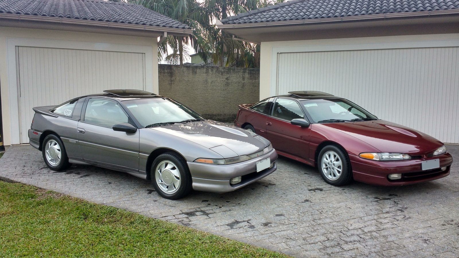

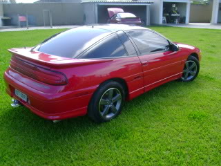

Since 2007 my father has DSM's. The first was a '94 GST red, and the second was a '93 GS bought with 19.000 miles. Since then always I wanted to buy one.
In 2014 I found a 1GA in a city 350 miles away. Was a '91 GST in quartz gray color, with just 45,000 miles and two previous owners.
I bought the car for R$16,000, about $5000.
The car was in top condition. The interior was perfect. The exterior had some details, but everything easy to fix. The engine needed some care.

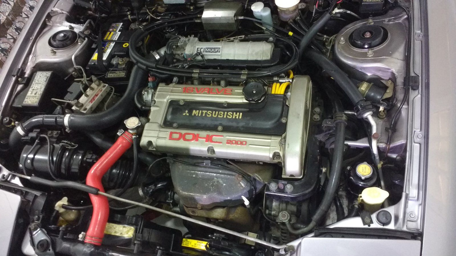

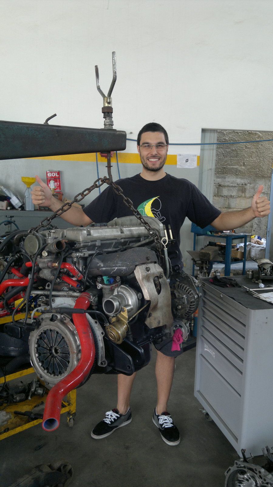

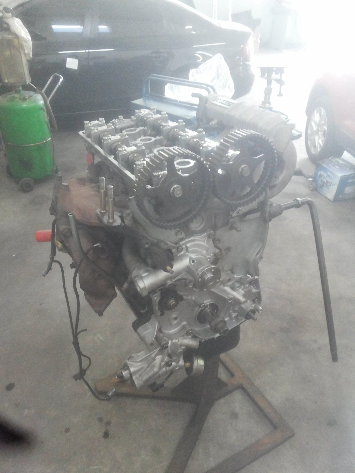

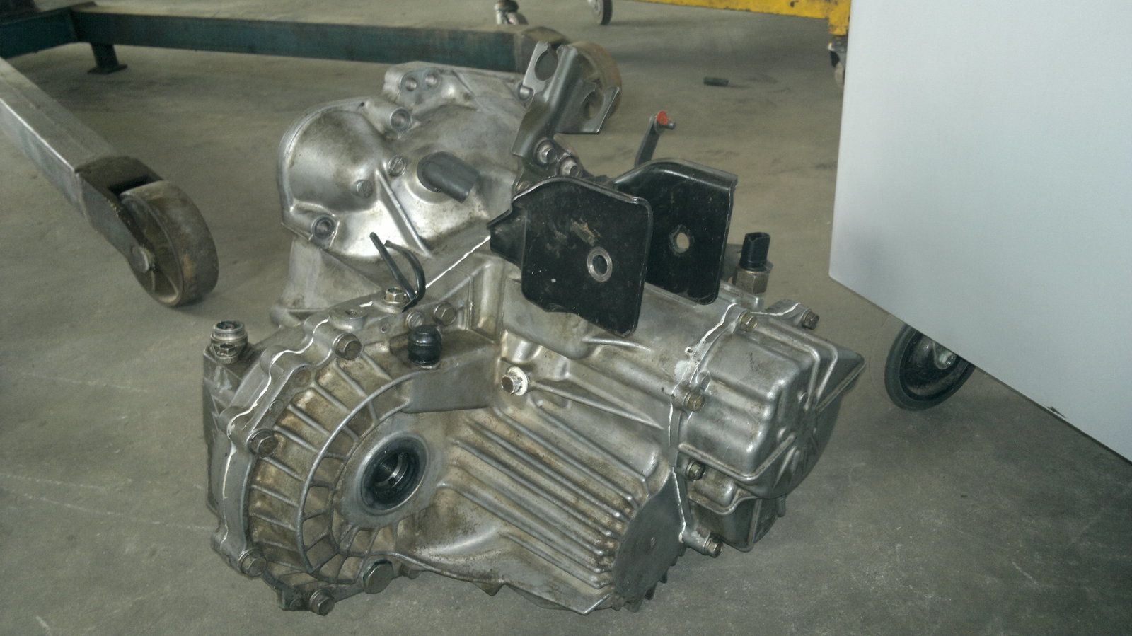

I drove the car for a few months until the engine broke because of balancer shafts. It was 3 months to rebuild it. Already we take the opportunity to review the gearbox, clutch, turbo, ECU and multiple sensors.

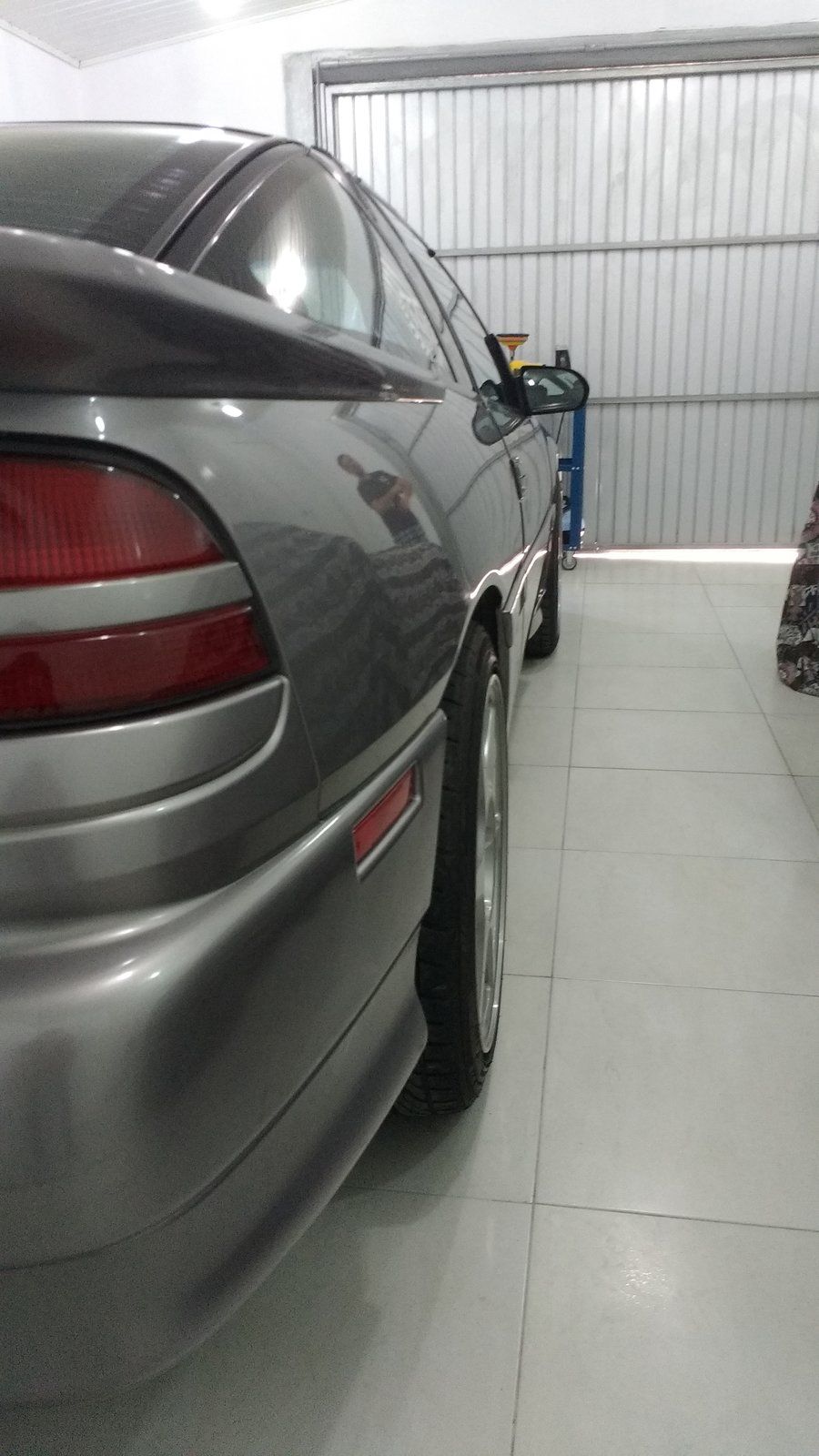

The car was still at its original height and I did not like the appearance with the wheels installed. So I sent the dampers to a friend and he worked them to make them lower. It improved a lot, because the originals were bad.

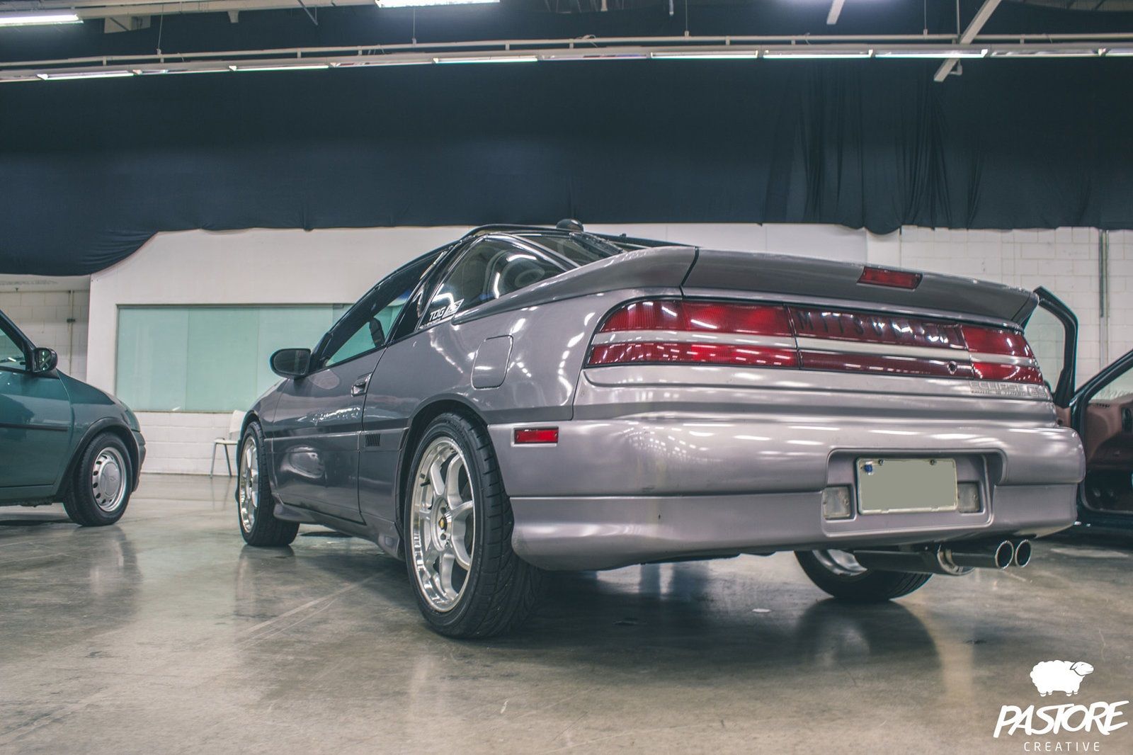

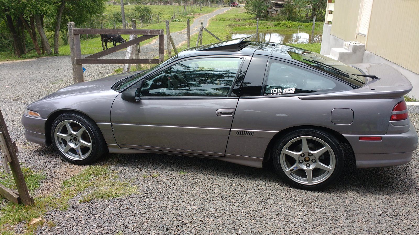

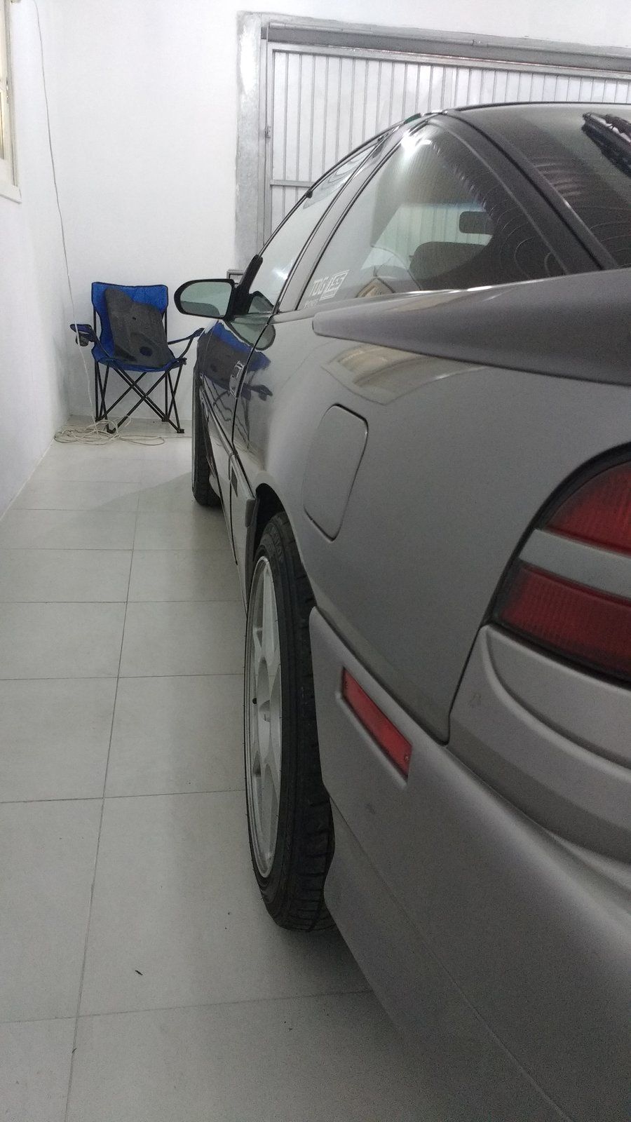

A few months later, I found a rare (in Brazil) set of Evo III wheels for sale. They were in a rally car. I traveled five hours to bring them!
In the same week I sold the RS7's. Bought a set of Bridgestone Turanza ER33 215/50/17 and the same day I went up the Rio do Rastro Mountain. Same as driver Rhys Millen made a video a few years ago.

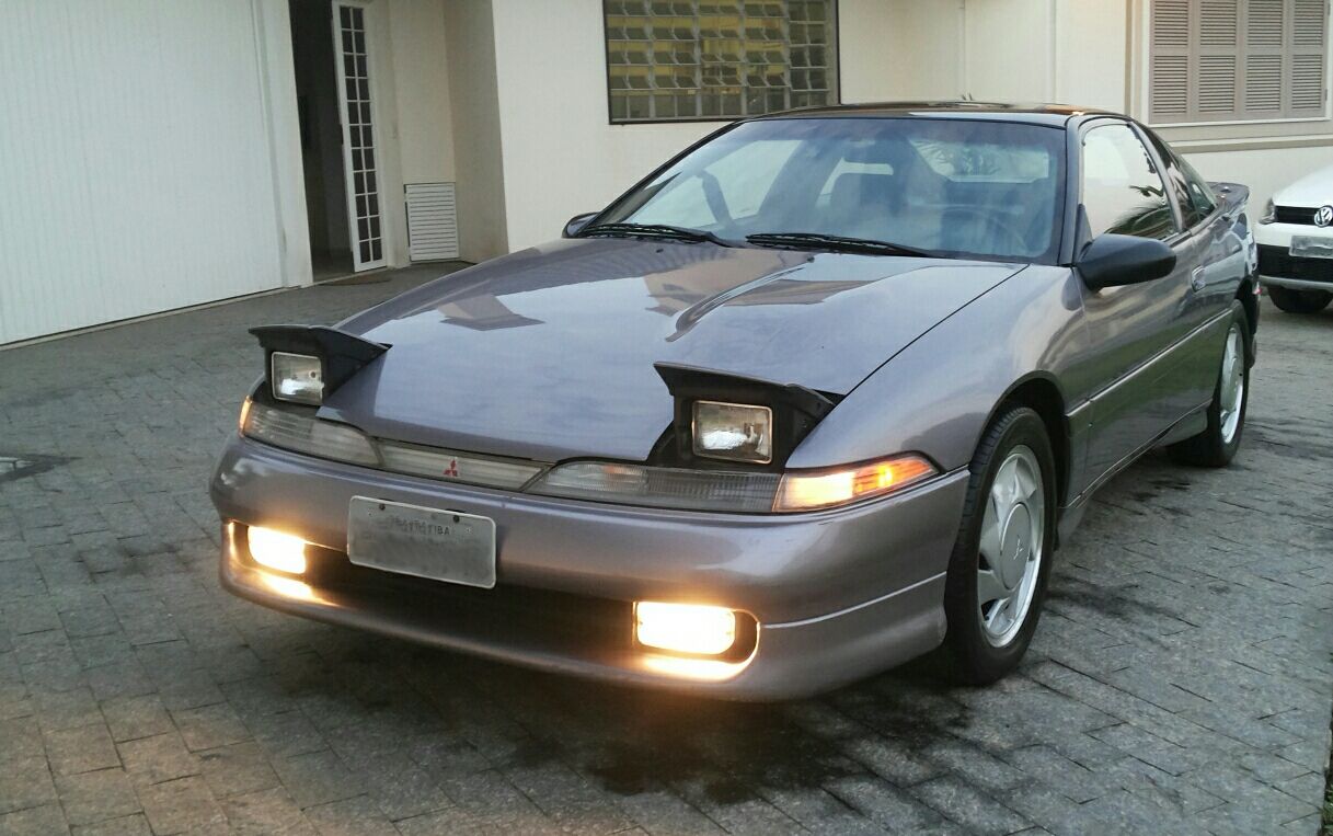

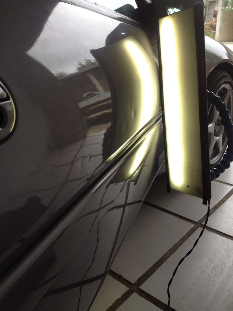

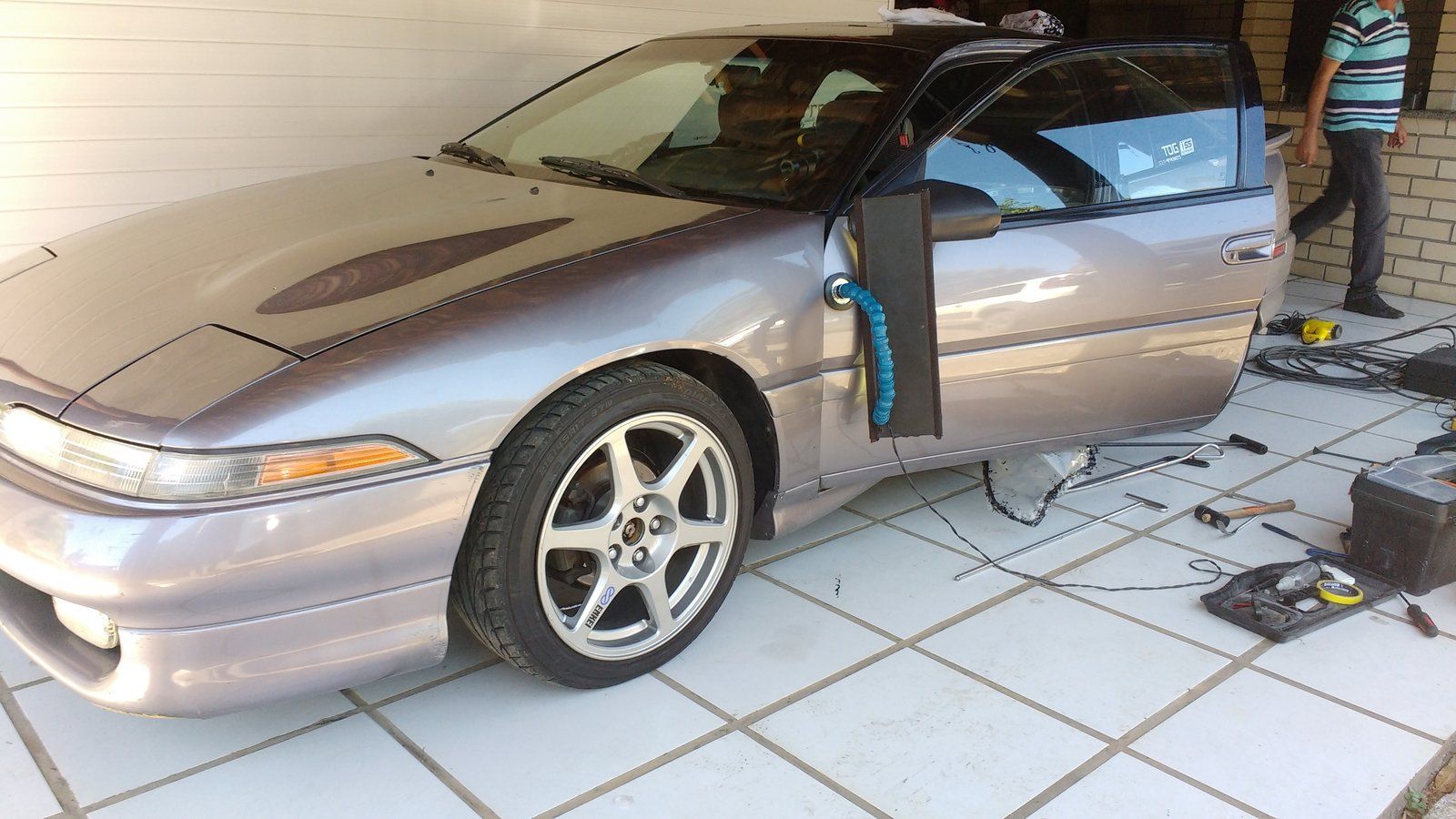

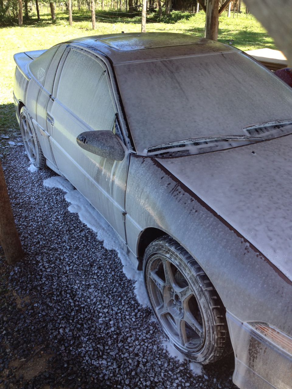

A friend made a full paint detailing and removed the small dents around the car. He changed completely. It looks like a new car!

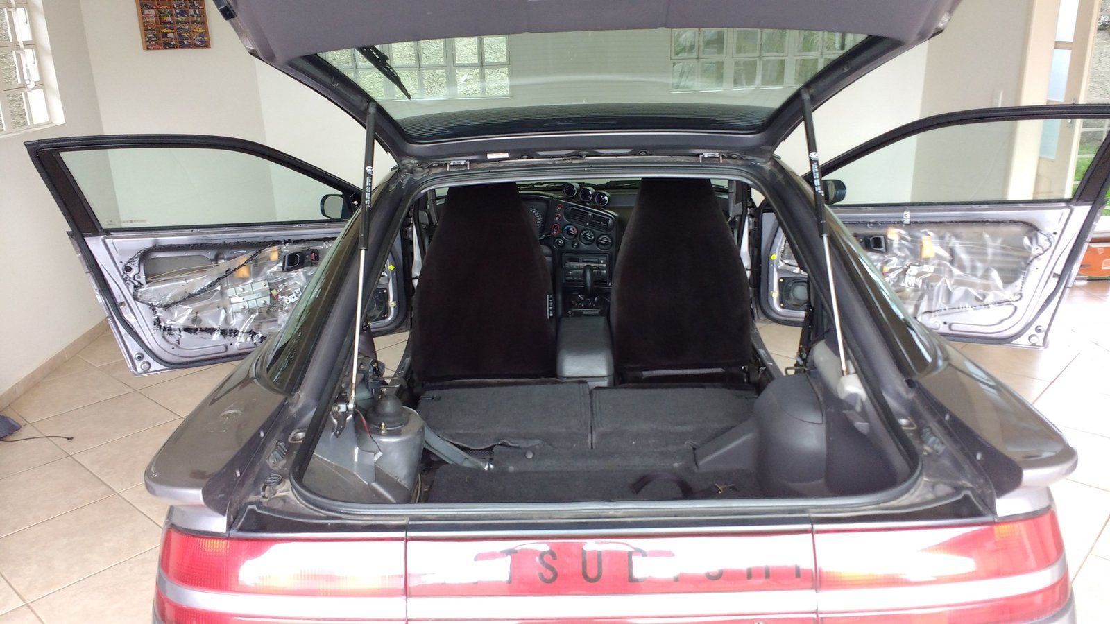

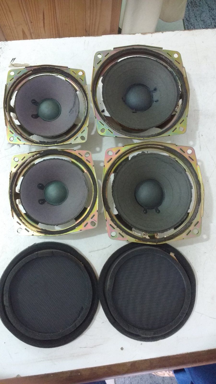

I took the opportunity to refurbish the speakers, wash all the interior plastics and to fix the electrical antenna.

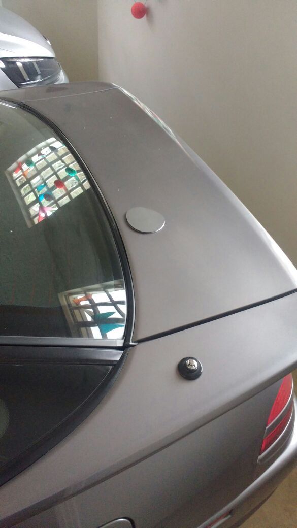

I also removed the rear window wiper. The rear looks much better without it.

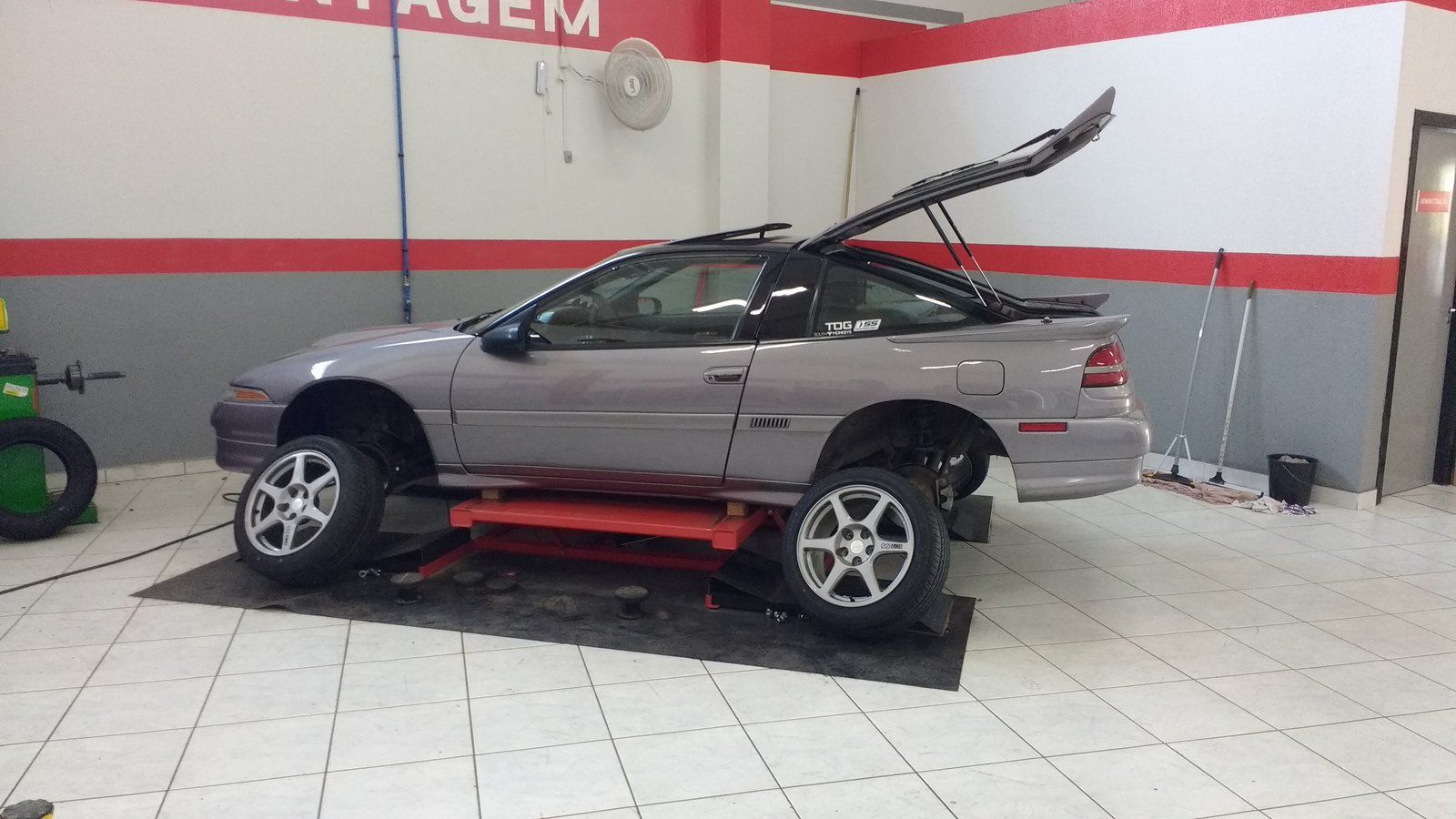

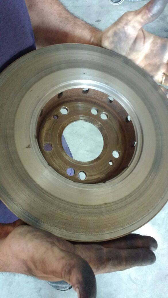

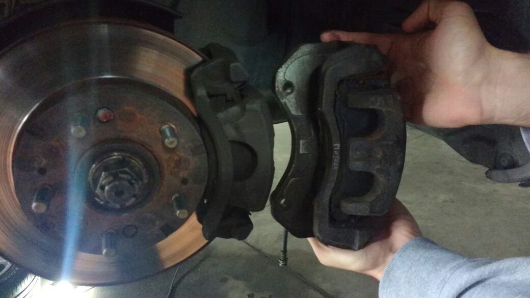

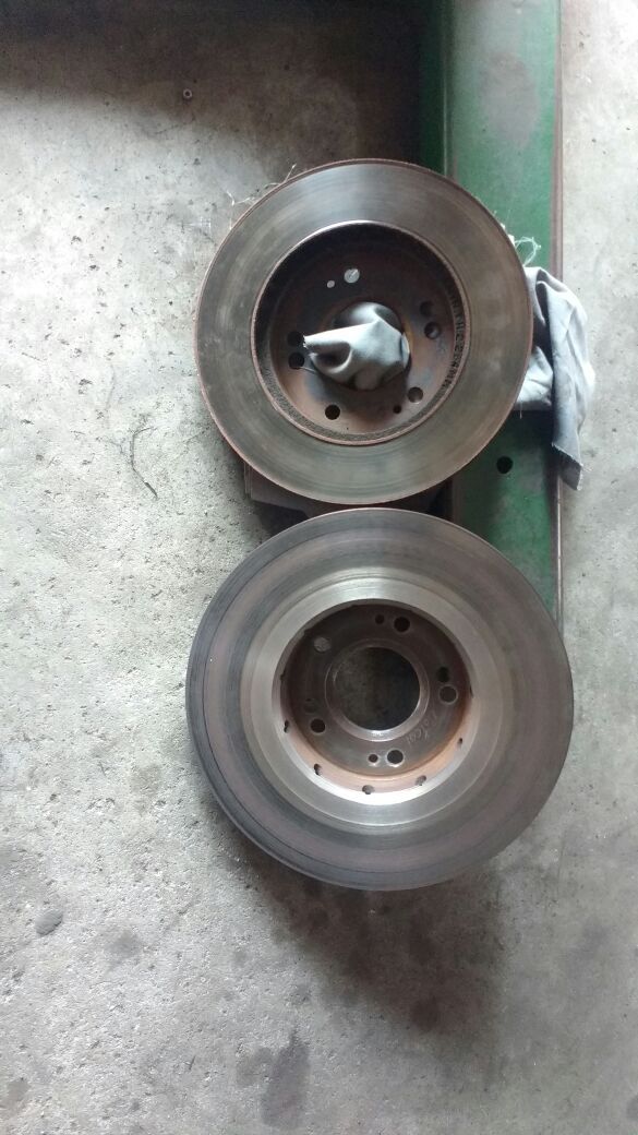

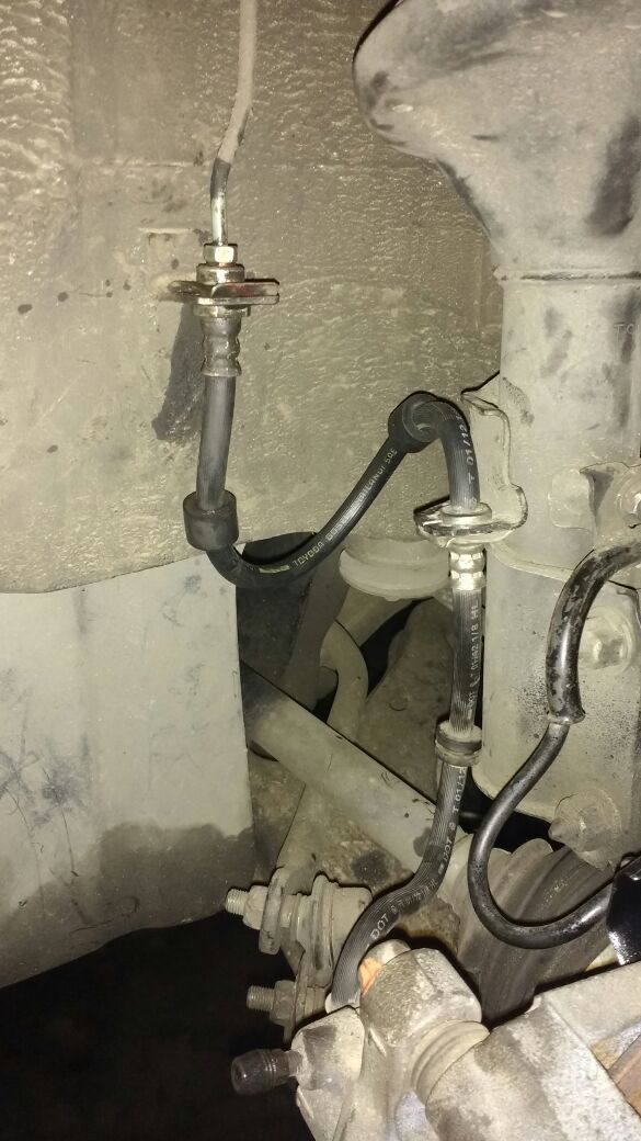

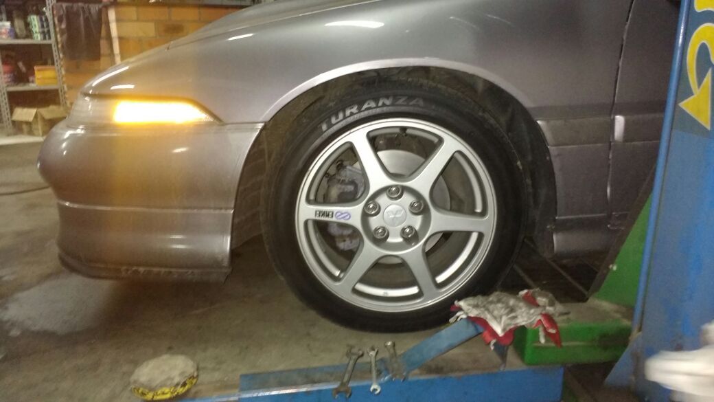

In the last week ai upgraded my front brakes. Install a set of Lancer Sportback Ralliart. Is the same of Outlander. Two pot calipers and 294mm disc brake. I install the Ralliart brake line too. I'm ordering a RRE adapter brake lines.
Because my car has ABS, I had to make some adjustments to the disc. It took two holes for the ABS sensor screws and machining the back of the disk so as not to scrape on the magnetic sensor of the ABS. It was also necessary to cut the disc cover.
In addition, for ABS to work properly, the magnetic sensor had to be moved 5mm away. I used a small washer and replaced the screw. I forgot to take photos ...

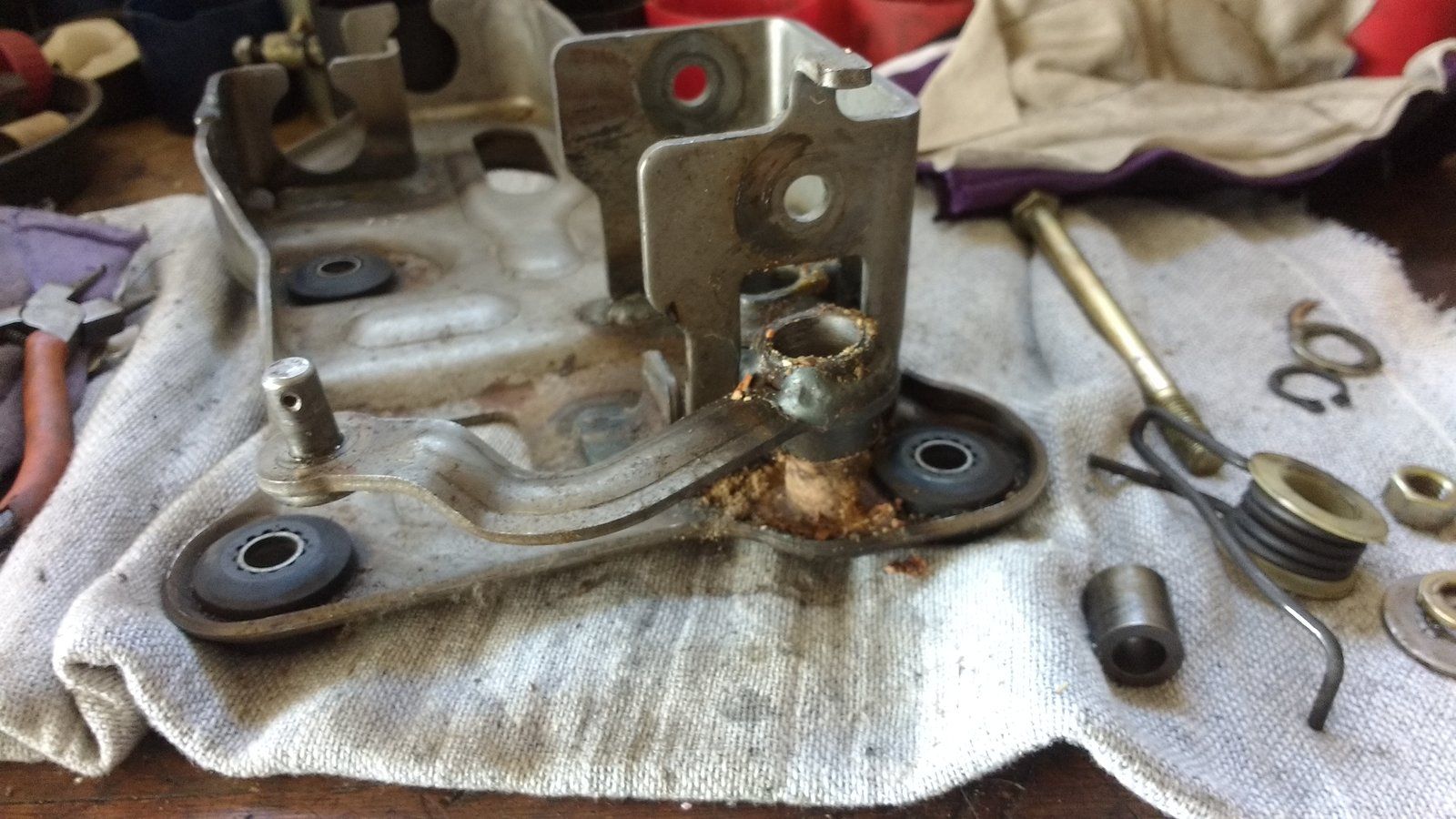

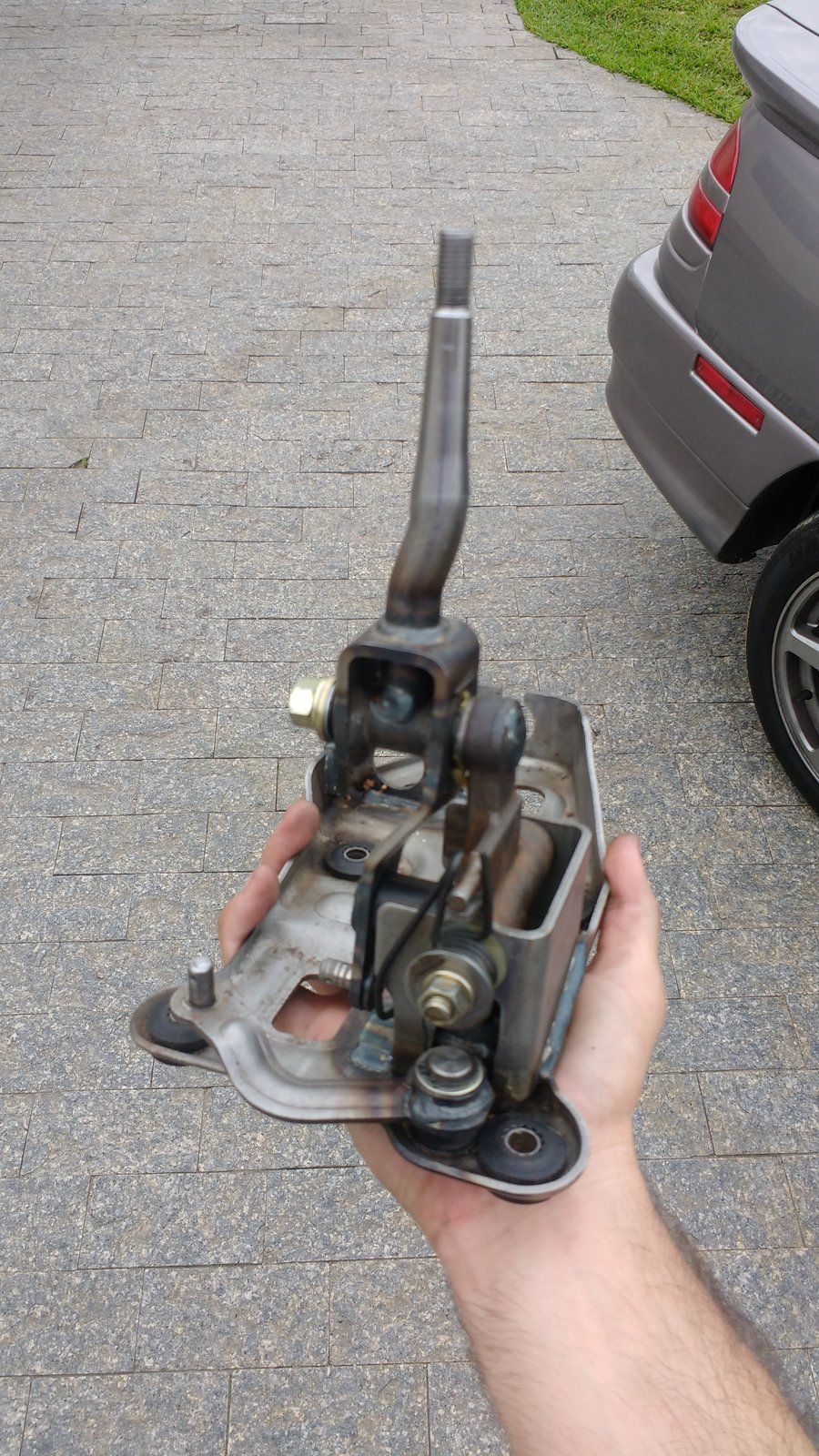

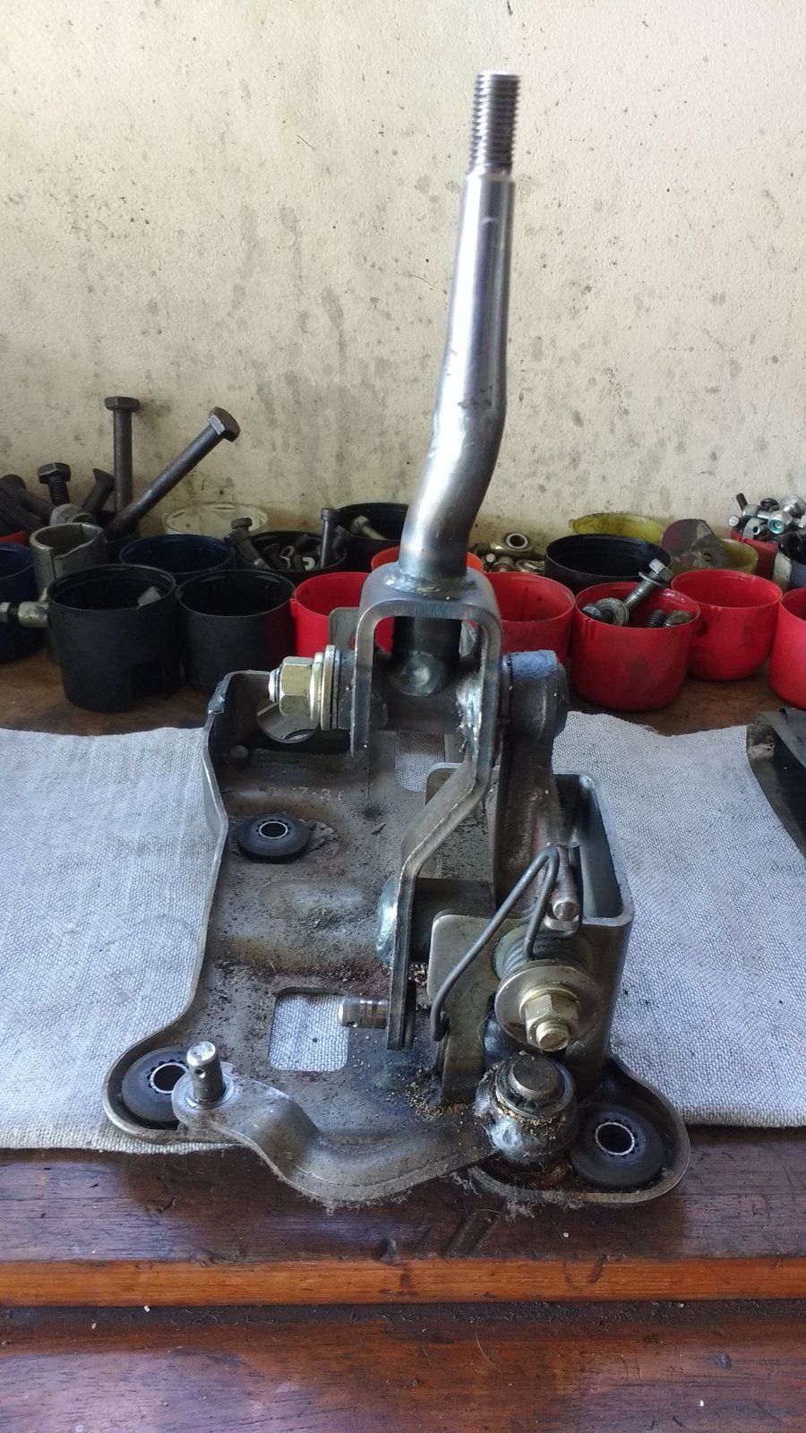

I brought some US parts, purchased from JNZ. Shifter bushings, pedal covers and door strikers.
I changed the shifter bushings and now it looks like a new car!

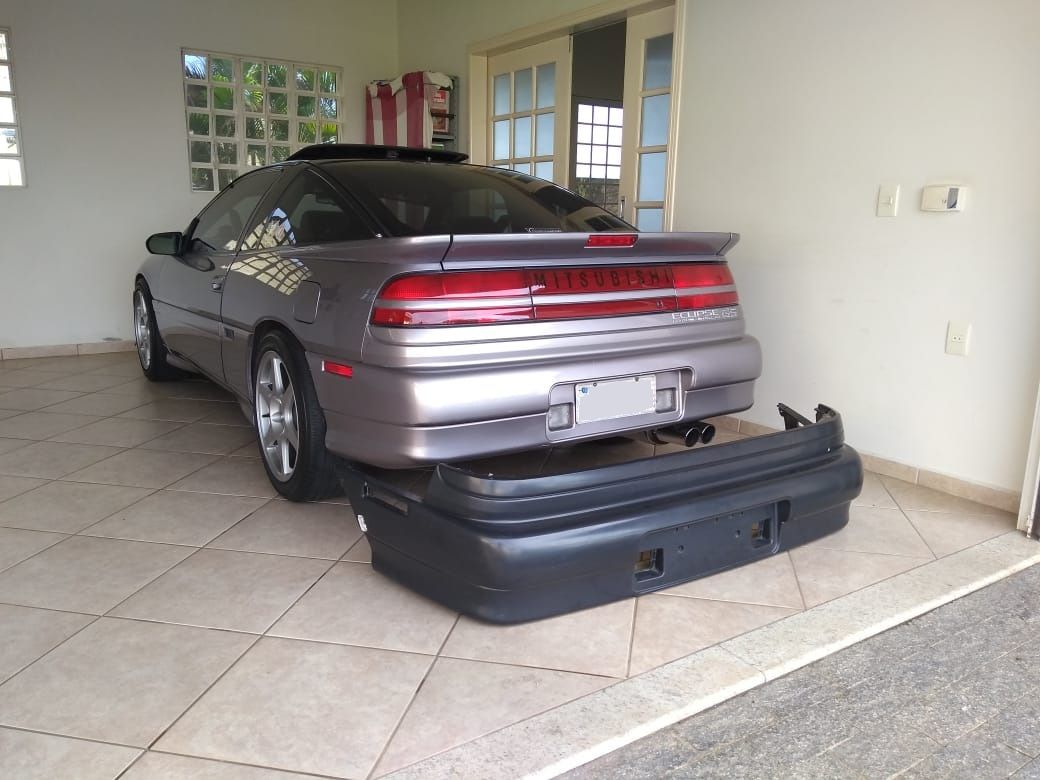

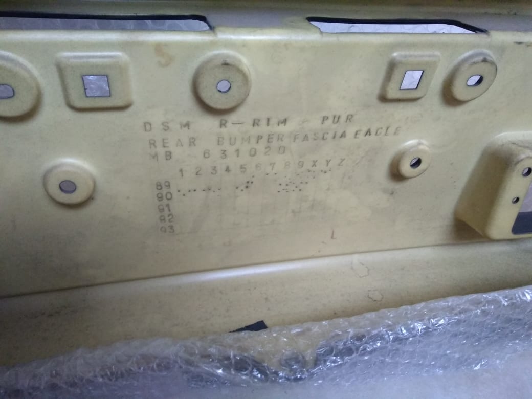

I found on Facebook group two brand new oem bumpers. R$200 each, approximately U$50.

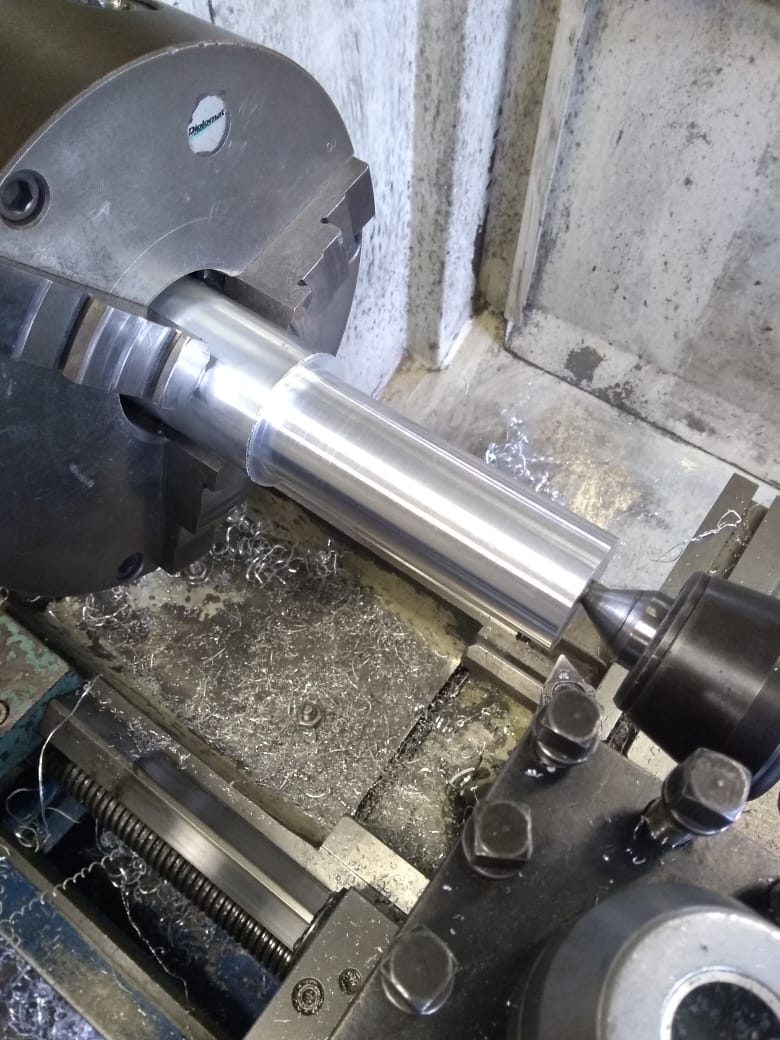

And I am building a custom shift knob. More a few days to be ready! The ideia is create something like the oem. As soon get ready, I'll post pictures here!
