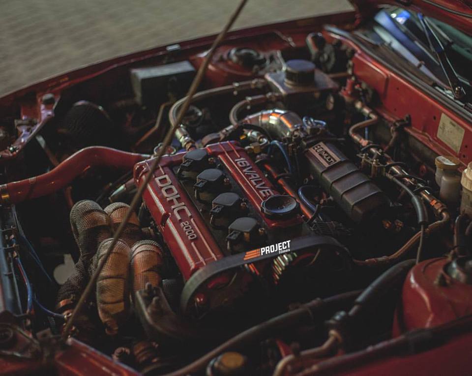

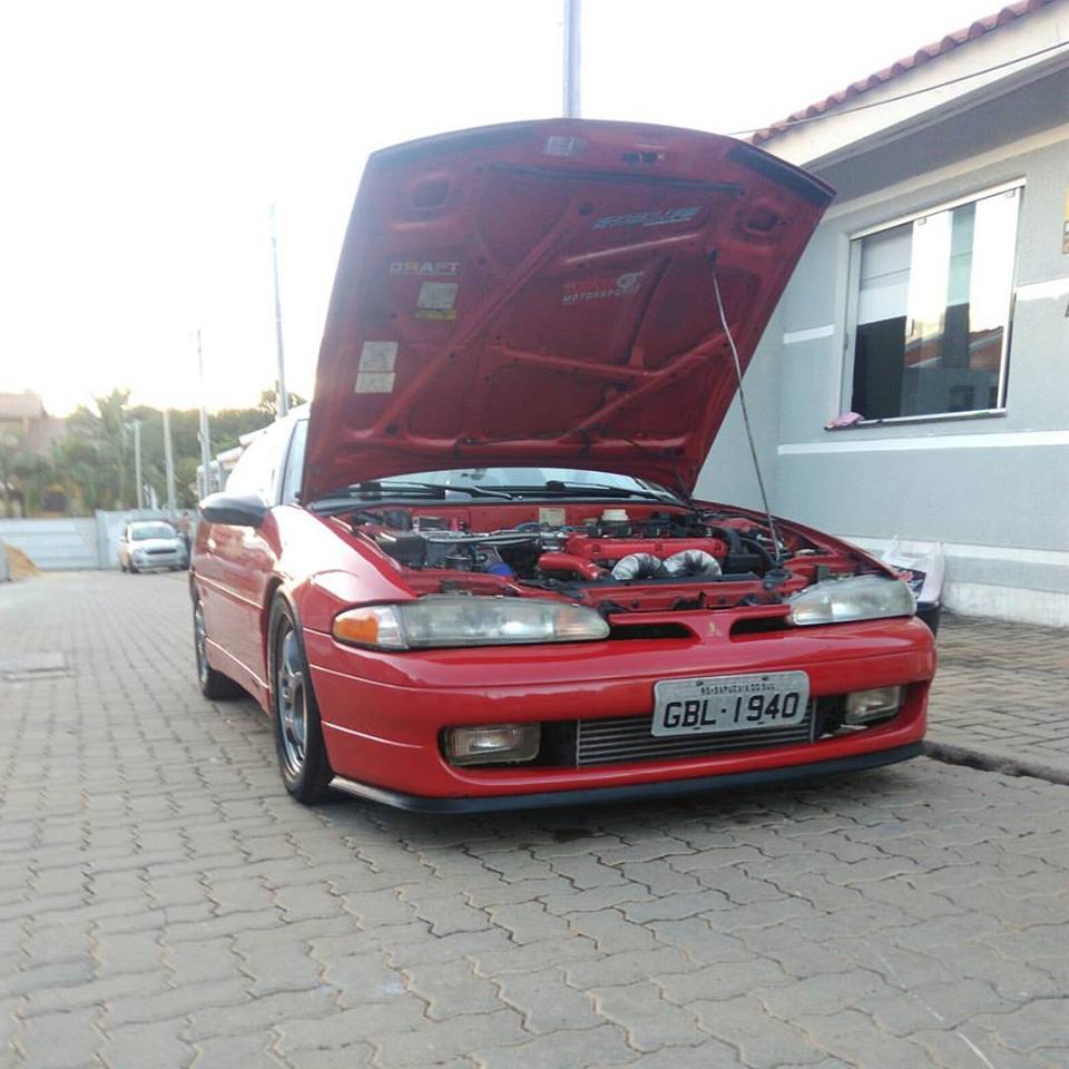

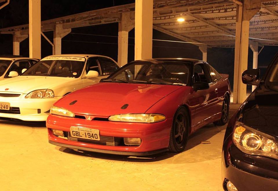

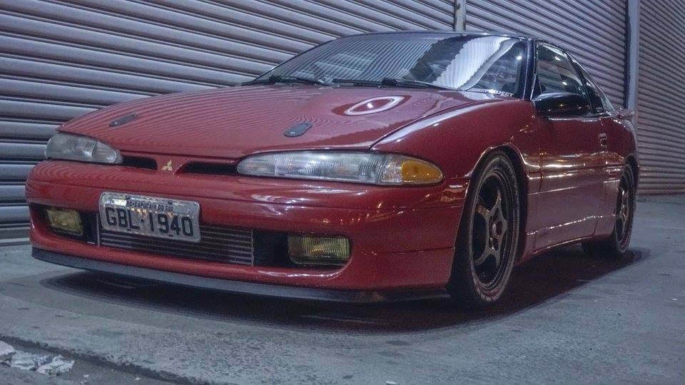

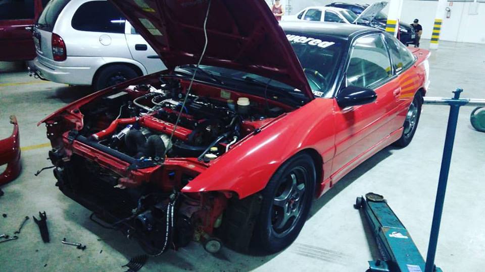

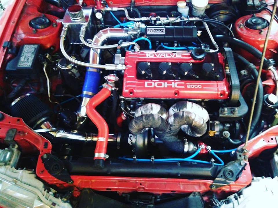

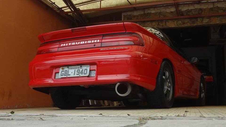

This my Mitsu Eclipse 1993 FWD, i found him about a 3 years ago, in a garage, most like a barn, ugly, stinky, simply a tragedy in form of car, here in Brazil its not so easy to find one of this cars, usually we found somes 2G, but 1g here is a little rare to see, however bad it may seem, we try to start the car and he run, all run, AC, windows, steering wheel, failling but he worked, testing some things we discover the problem, and it is the ECU, we pick a ecu of a friend and boom, found the problem and the solution, i run a year with the OEM Ecu, some i found here in brazil in a good shape, over a year with them, i decide to change my project, its when i pulled the Fueltech EFI, here in Brazil its the greatest EFI of country, and more easier to tune, with that i pulled a Holset HX35, 2 sets of fuel injectors, FMIC, all new pipes, and new Exhaust, how it runs with all stock, it runs with 20psi on E85, with 326hp and 37kgfm of torque
but the project dont stops, this year i plan put rods and pistons,
As much as I drive every day, I'm always afraid to fly everything
This is my car, i hope you liked!

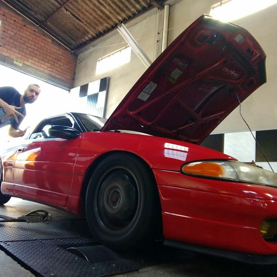

Thank a lot dude! Next week I'll probably go through it again on the dynamometer, and I'll try to get some pressure up and see what happens! Suspension is a model of coilover made in Brazil, nothing more, only regulation of height itself

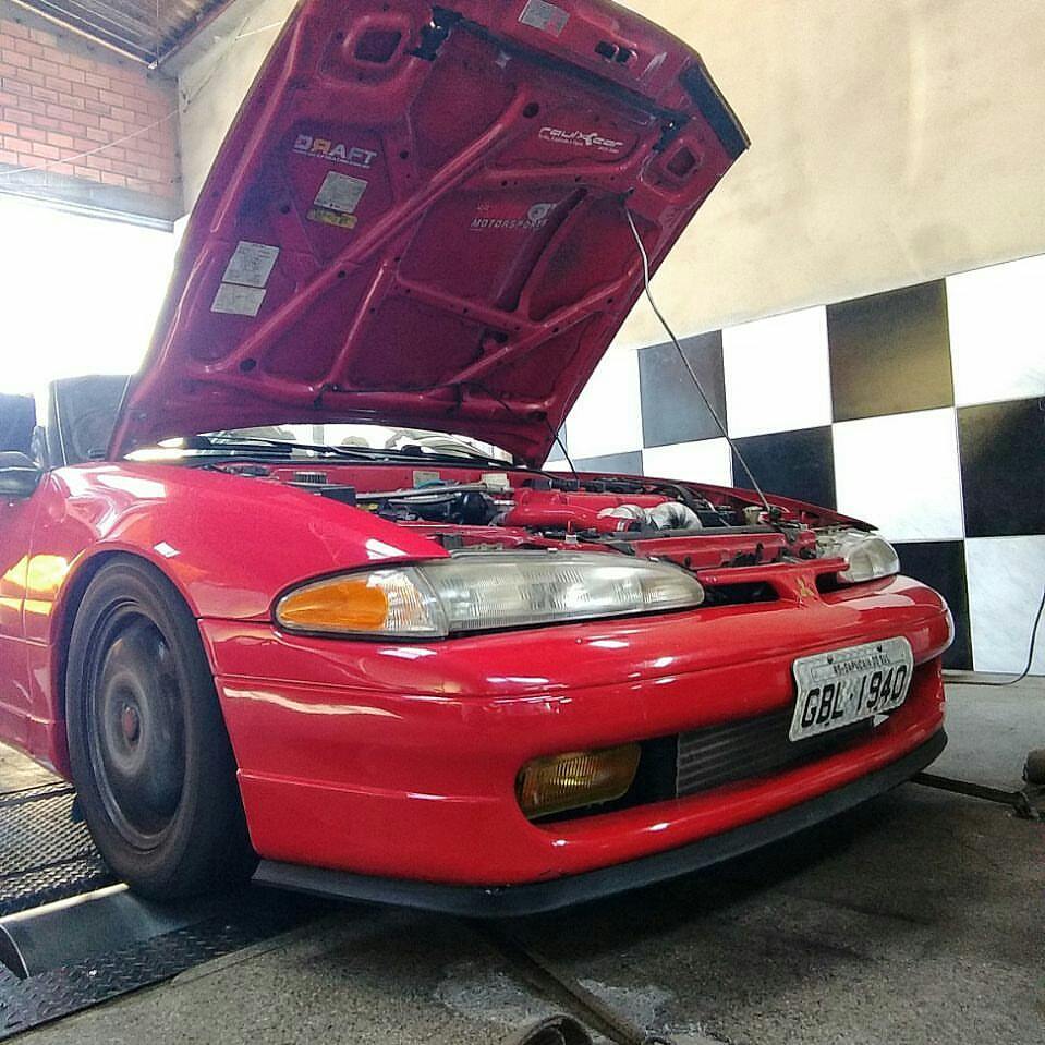

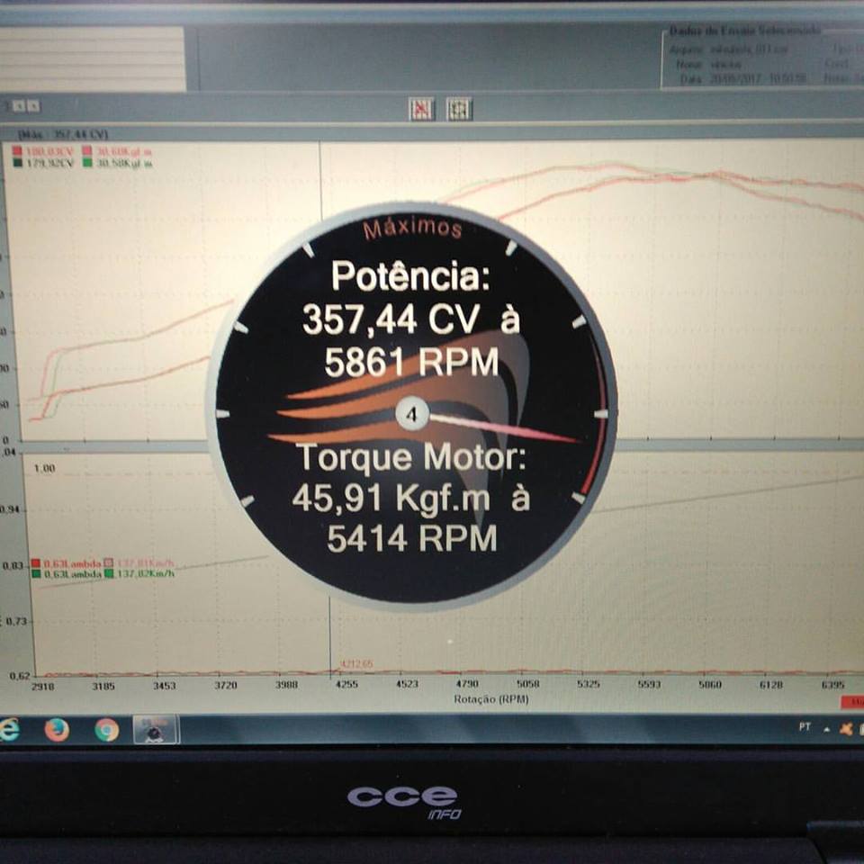

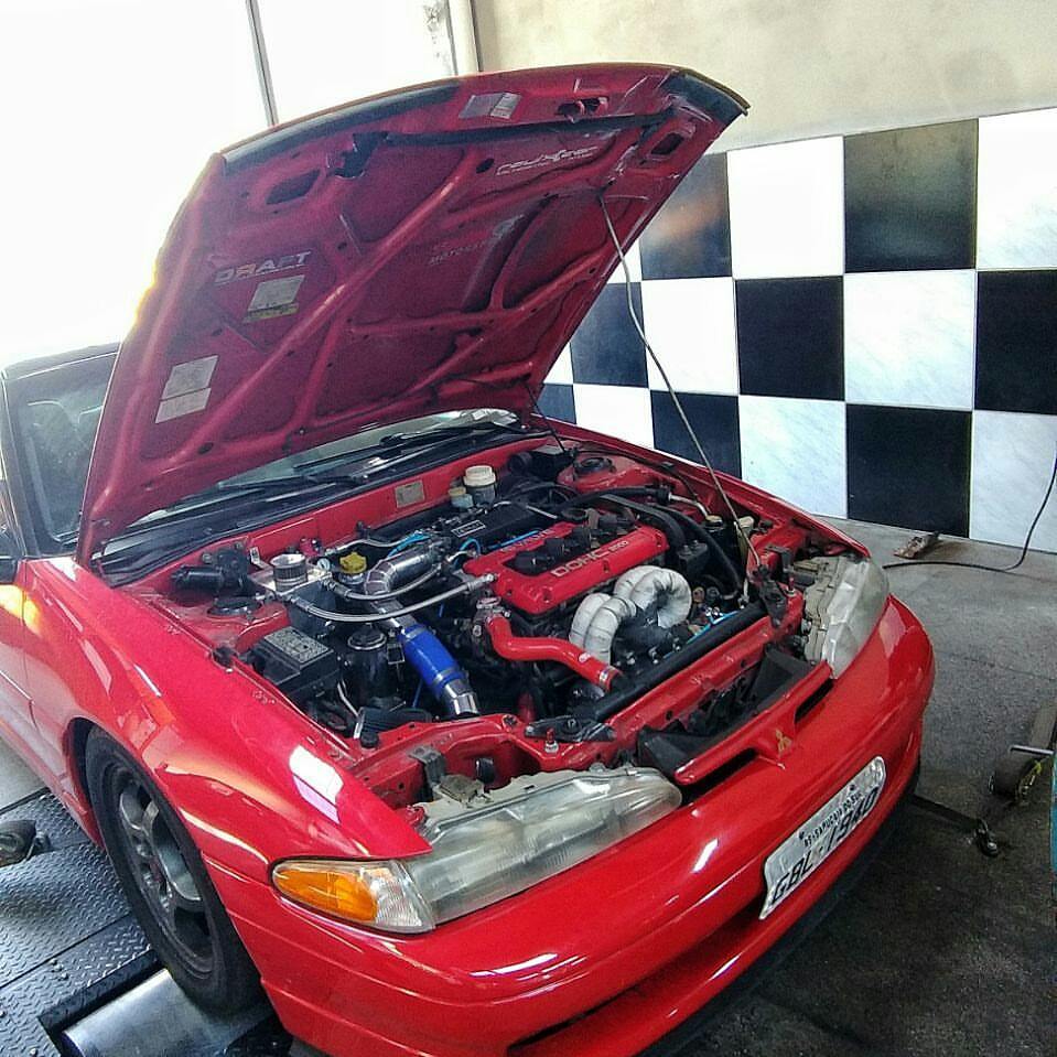

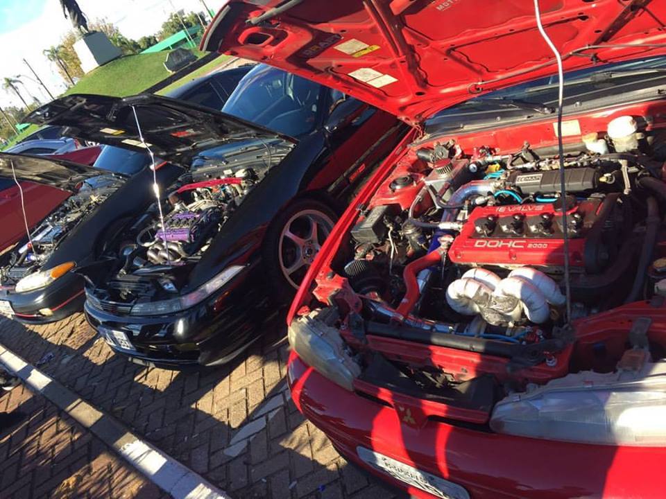

Hey guys! This weekend I took the car to the dino, made some changes of ignition point, and some adjustments in the injection time of the injectors, and with the same 20psi, I managed to increase about 30hp, I thought to raise the pressure more, but the Fear was greater than the will, now I continue in the searches of the connecting rods to climb everything else, make the head gasket and the screws, follow some photos and videos of the weekend, even had a micro encounter, in which immediately after the photo a Of us went running and broke up, dsm problems hahahah
