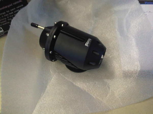

We figured it was time to go back to the basics and start with a good old-fashion boost leak test. As soon as the air started filling the system we heard a huge bleed off of boost. After some feeling around we found the air coming out of the HKS BOV (it’s not recalculated back into the intake). Now from what I understand the great thing about the HKS is the more boost you make the tighter that baby gets. That wasn’t the case right now. I’ve wanted one of those fancy limited edition flat black versions so here’s my chance. Ordered one from my favorite one stop shopping site – ebay and two days later she was at my door. Installed and boost leak free, I took T. Talon out for a test drive.

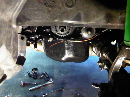

The driver’s side of the motor is coated in oil. Since we can’t see the leak we assumed it was coming from the front case. Guess what we’re in the process of right now? That’s right – oil pan dropped, front case off. Looks like a gasket used for the front case was leaking right below the water pump.
