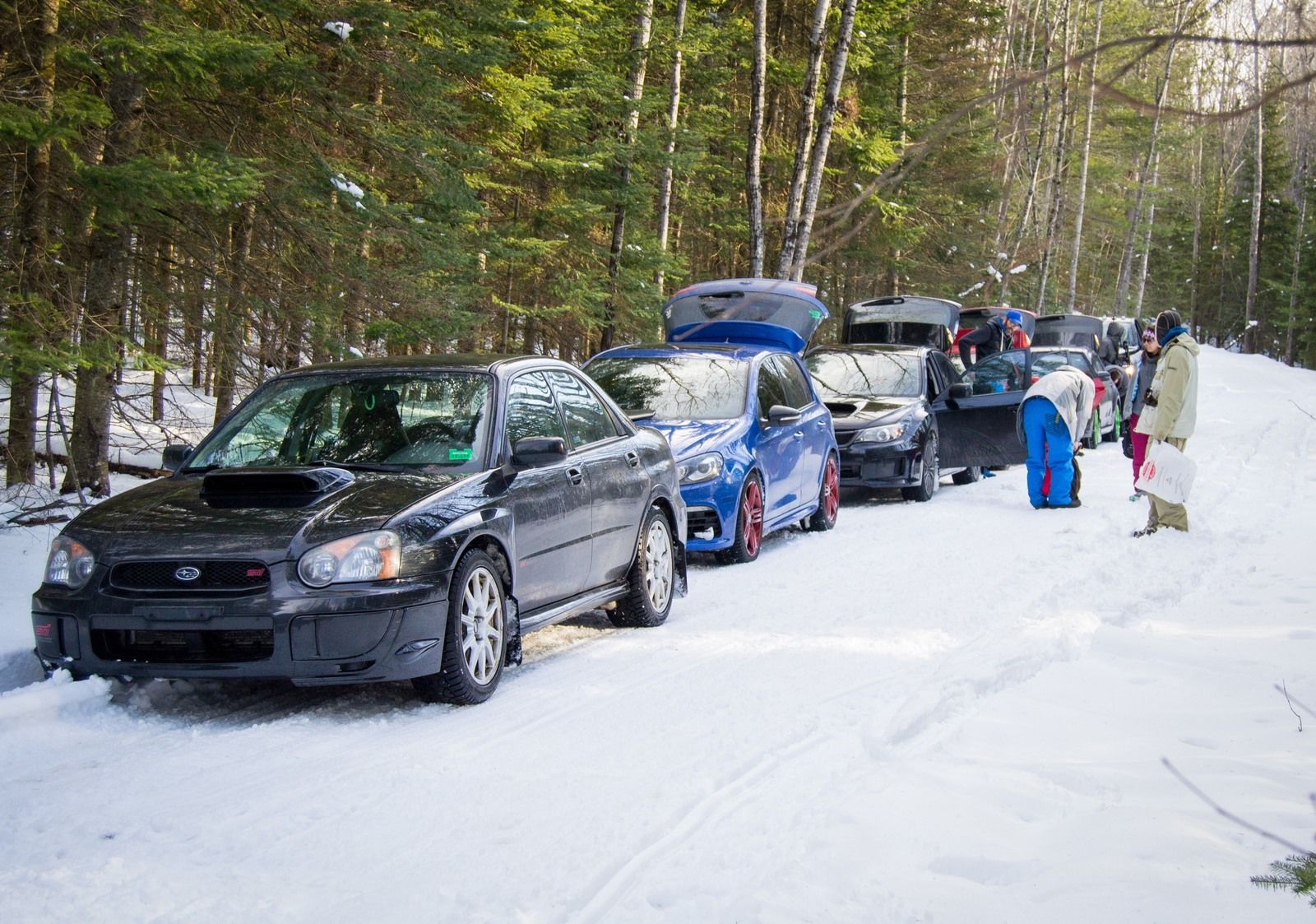

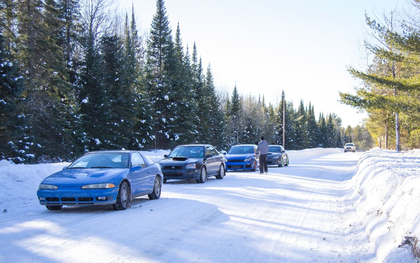

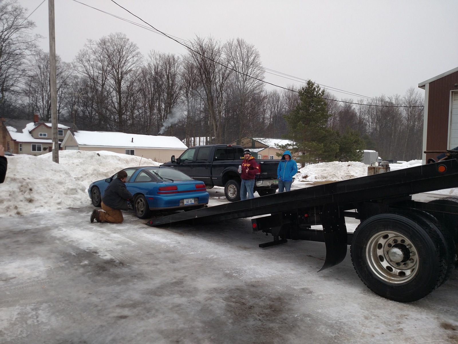

Had some fun over the weekend. Me and some of my buddies went up to Sno*Drift in Atlanta MI. We try to make it a yearly thing. Here are some pictures of the festivities. The blue laser is Mulldawg on the forum (and his AWD non turbo).
Sadly the laser didn't even make it past the first day. While driving to one of the stages (on another stage) he had a bit too much fun and the transfer case ujoint/yoke on his driveshaft failed. Luckily I had my driveshaft rebuild kit handy so I gave him those while he gets me another kit on order.

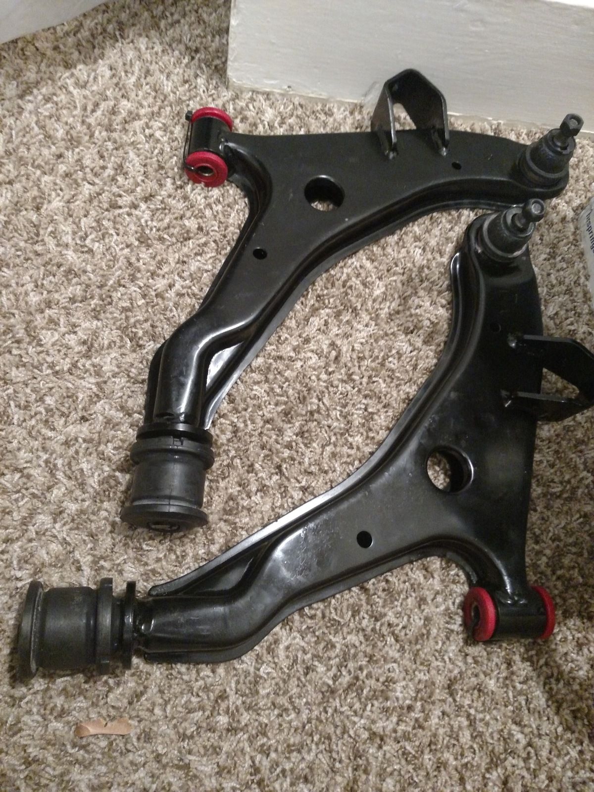

When I got back to work I was told that my control arms were ready. They were able to get the measurements of that stock sleeve and machine one of their own. You would never even know anything happened!

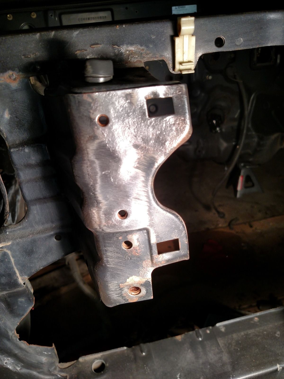

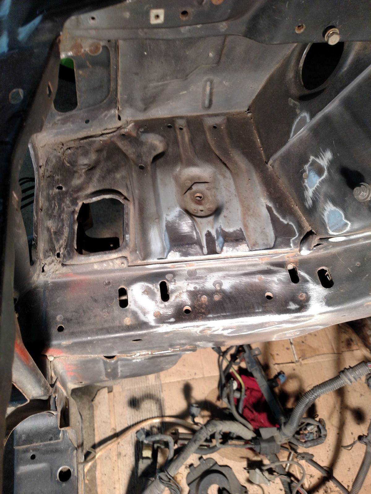

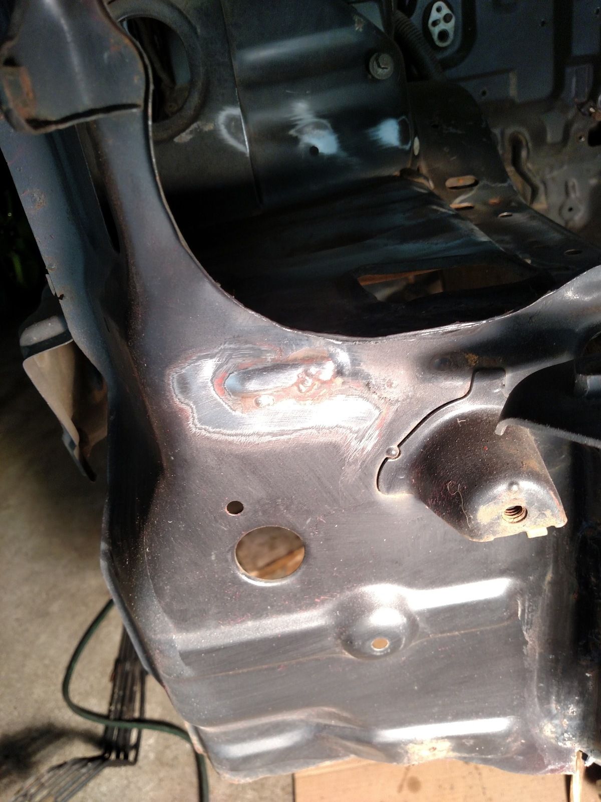

It was a gorgeous day out so I figured I would start some of the engine bay cleanup. I cleaned up rust around the battery tray area and the front bumper support area.
This was the worst part of the rust in the front of the car. I need to prime it and paint it still.
I still need to apply rust bullet but I am going to wait until it is consistently above 35* out (as that is the minimum temperature you can apply it).

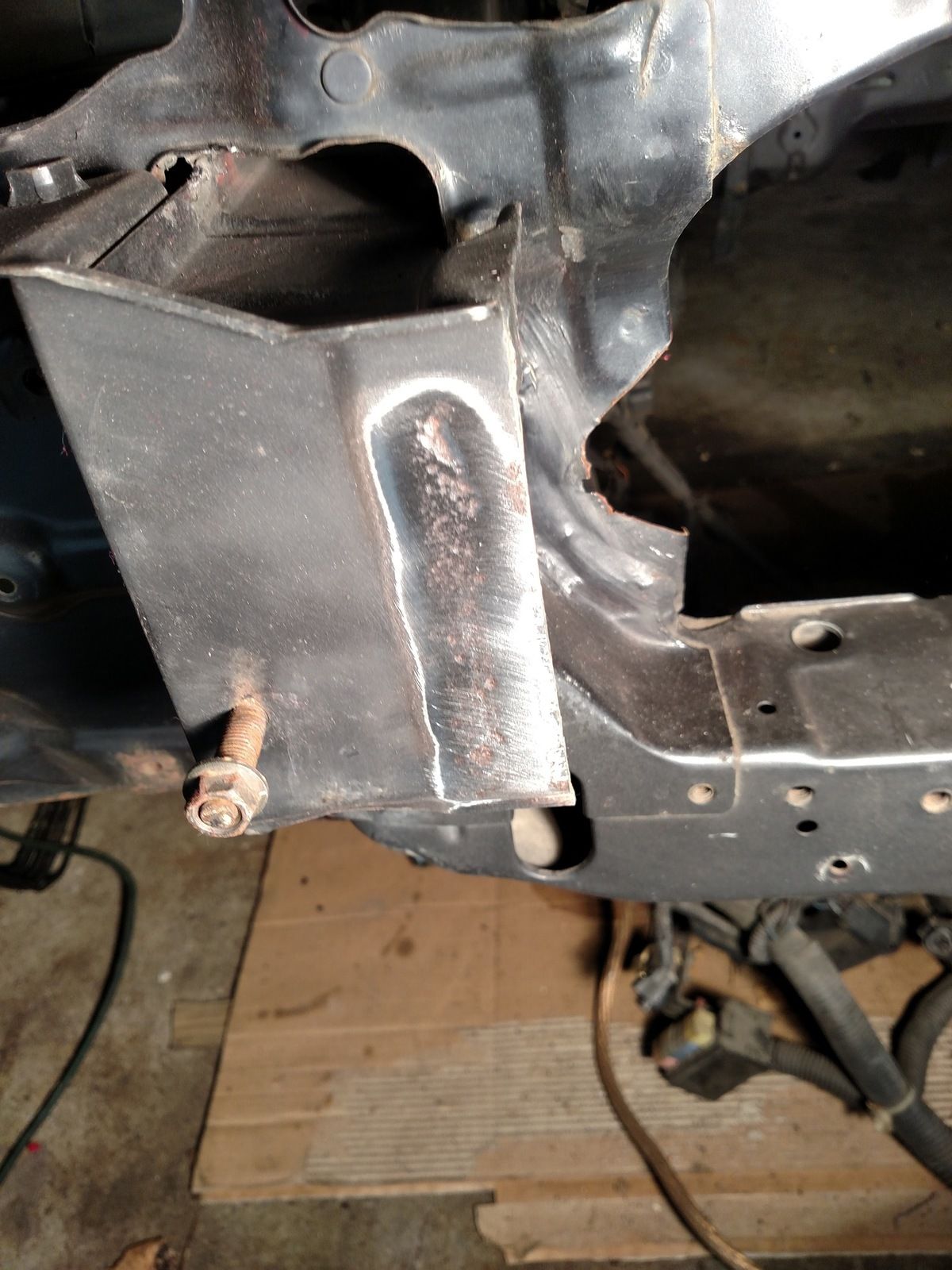

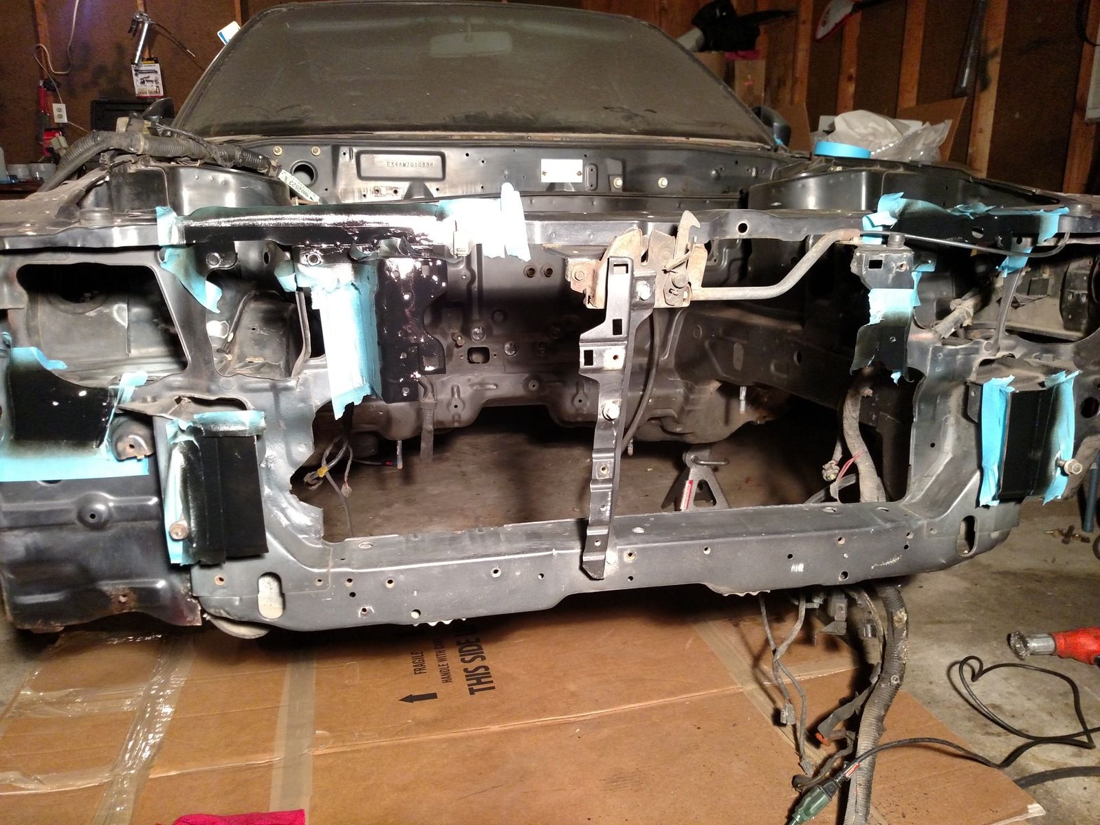

I was able to get some more rust repair done today. I wanted to paint the whole engine bay but the only bad area was the battery tray and a few spots on the front bumper support, the rest of the engine bay really is in great shape.
I will have to move in the next few months so I decided I would just repair the rust for now. I will probably revisit this down the road and take it to a body shop, but for now this will do. This will allow me to remount the motor and trans before I move.

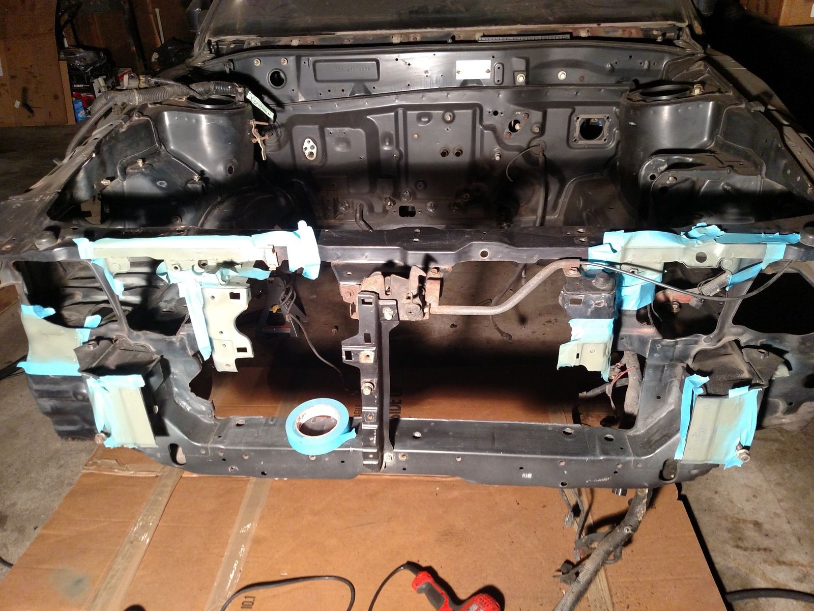

I know you're under tight time constraints, but I think you'll regret not dong the whole bay now. Your bay is wayyy more stripped down than mine was when I painted mine. Additionally, you'll have to do very little prep work with the condition yours is in. I basically cleaned mine, removed the surface rust, then sprayed it.
Like I mentioned above, you can literally put a trash bag over the wiring harness and drape it out of the way.
You can have the bay prepped and painted in a day. 12 hours later you can be dropping the motor in. Just a suggestion to think about. Either way, the car is coming along great.

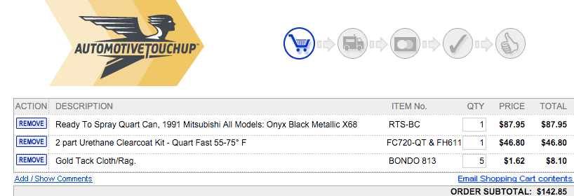

I'm not sure how much paint I should get for the engine bay/front support. I see on 1837 you used automotivetouchup.com with great results, how much was left of the pint that you used? I may need to get a heater for the garage as well, the 2 part urethane clearcoat has a minimum temperature of 55*.

So I get all my stuff from Automotivetouchup.com:
Here for X68 (Nile/Onyx Black Metallic according to them): http://www.automotivetouchup.com/touch-up-paint/mitsubishi/1991/all-models/
You should only need a pint for the engine bay alone, but I'd get a quart if you have more stuff to spray. You'll need to pick up a quart of their clear coat as well: http://www.automotivetouchup.com/urethane_clearcoat.aspx

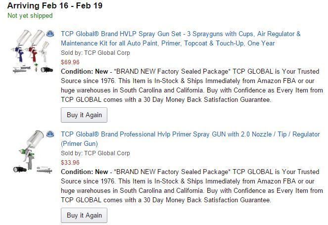

I did a bit of research today on paint guns, turns out there are a few paint gun kits on Amazon with surprisingly good reviews. The one I choose had some great reviews and was 50% (maybe a new model was out or something). Either way I snatched these up. Buying a 2.0mm nozzle was $20 plus $10 in shipping, so I figured i'd just buy another gun for that price!
I would love your review on those as I was also debating on getting them myself. I have no experience with painting gana learn on my car. I have a few months before I am ready for me to attempt on painting myself, but when you get to use them please let us know how they are.
Sure, i'm sure I will have tons of pictures of my process/finished product. There was also a good looking DeVilbiss starter kit, but this one being 50% off caught my eye.
I need to snag an inline filter for the air line and I should be set for the guns.
I'll try to do some more disassembling of the front clip, removing the hood latch and seeing how far out of the way I can get the harnesses. I think ill stop off on my way home tonight and get some more cleaning supplies as well.
