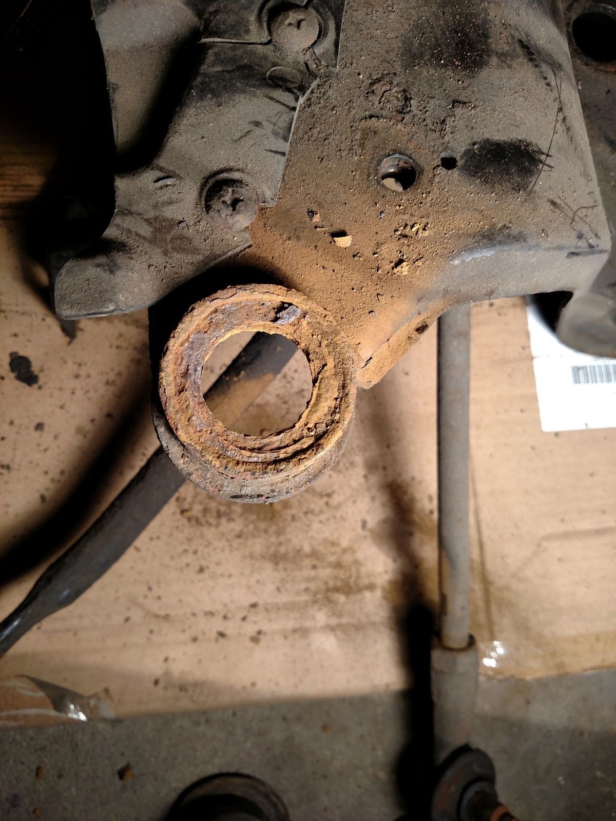

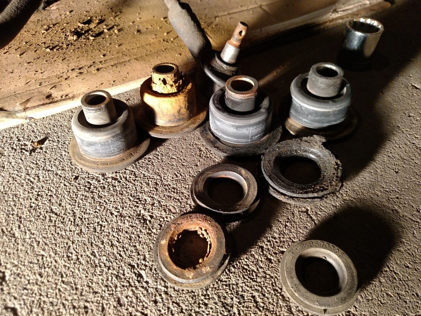

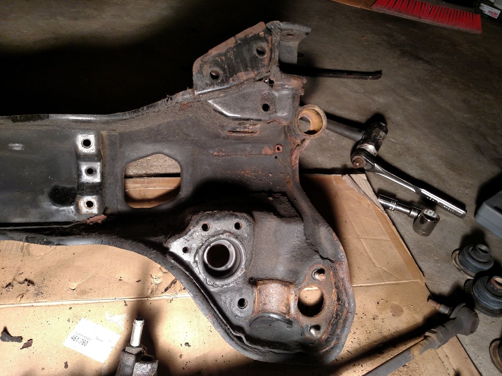

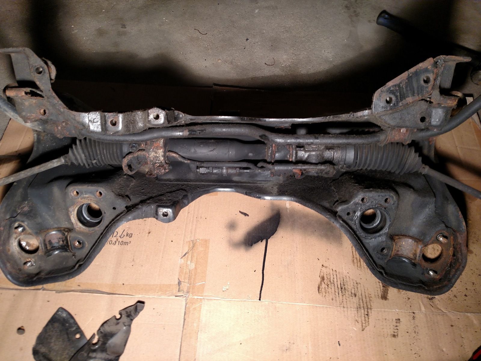

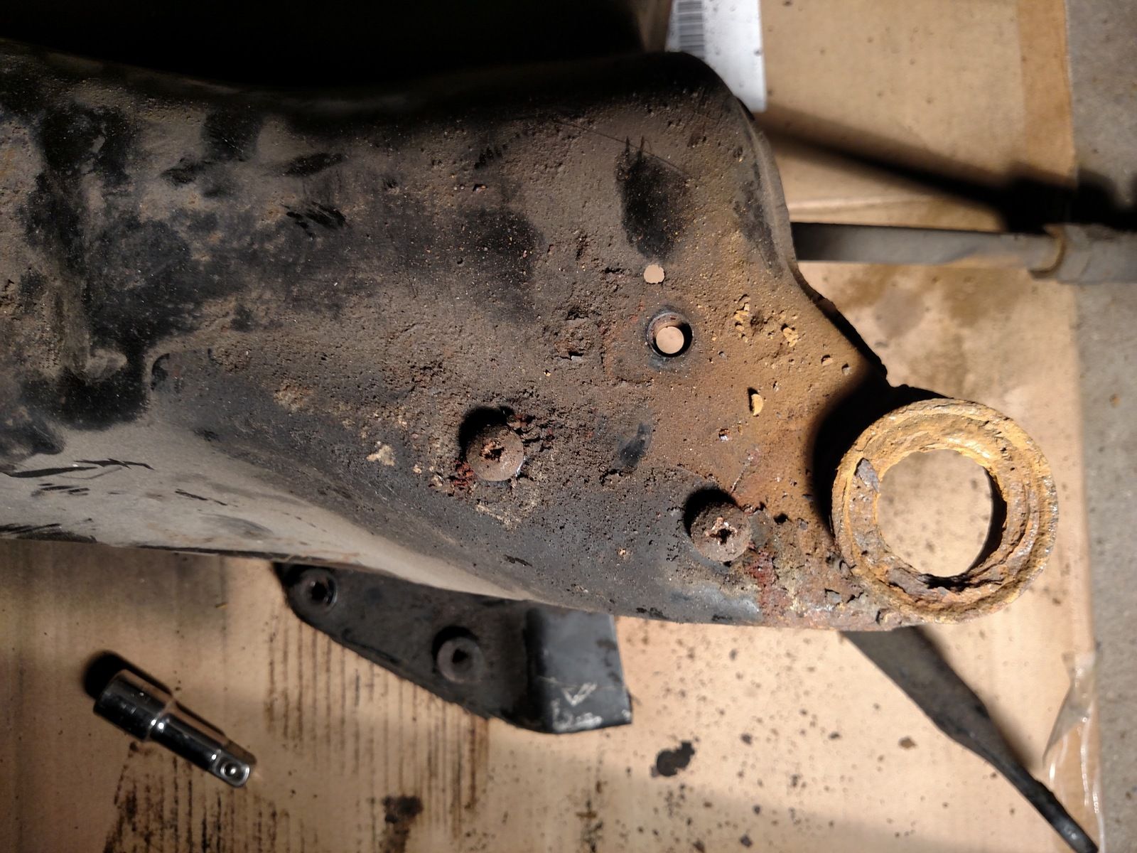

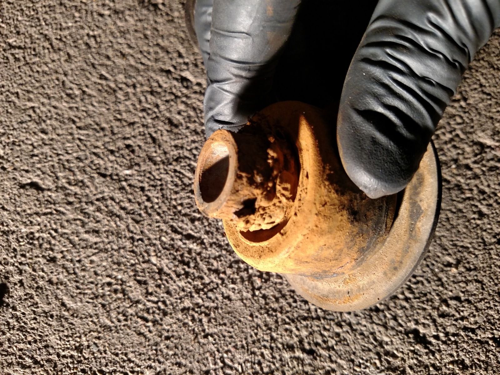

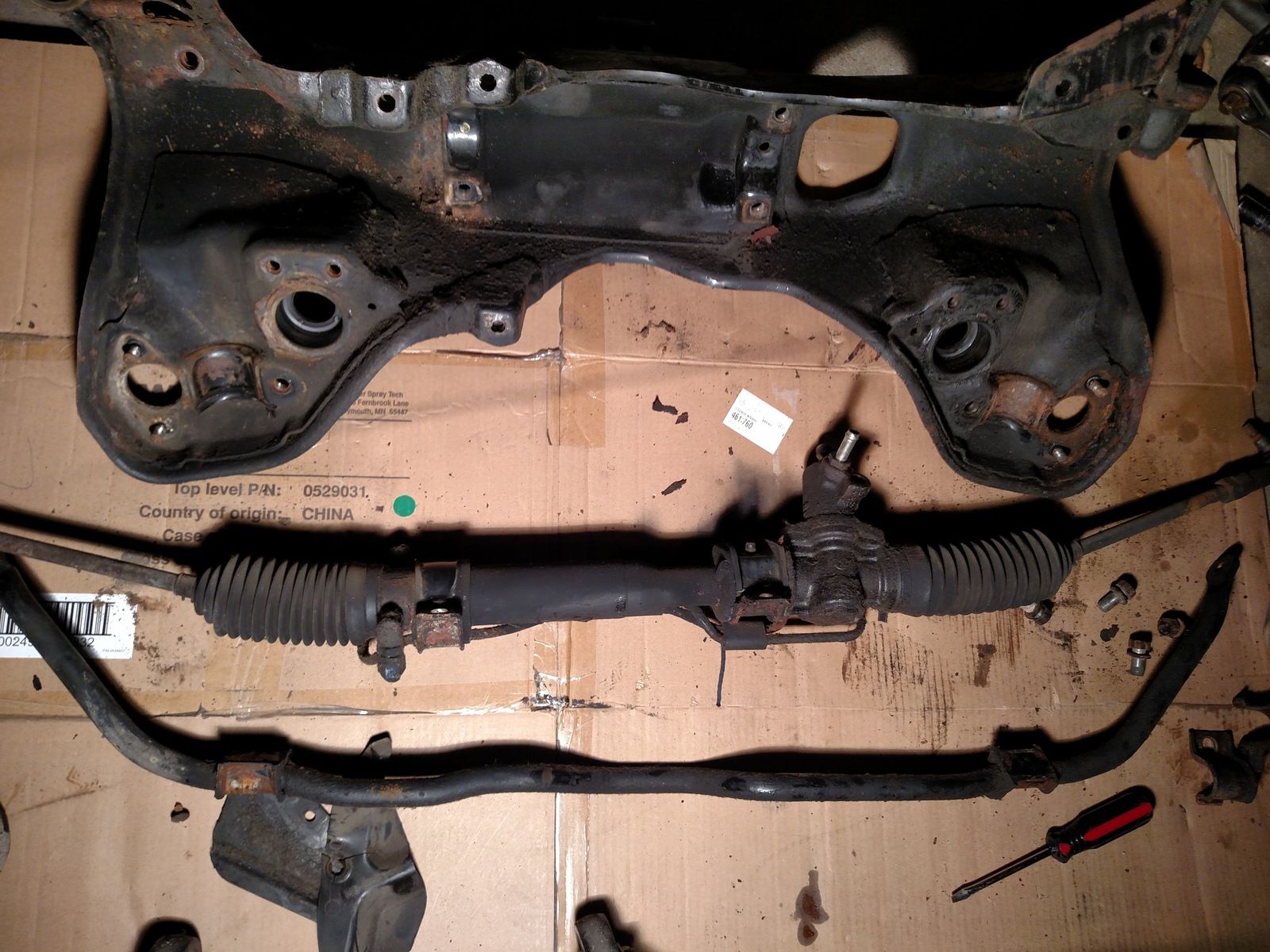

I worked on the front subframe a bit tonight. I figured I would try my hand at removing the bushings, to my surprise it wasn't that difficult with the right socket and a hammer. There was one bushing/bore that was pretty rusty, that required a bit more...motivation.
Then I tried to remove the little plastic splash guards. I was able to get one side out but the heads on both screws on one side started to strip. Iw ill need to get some vice grips or something to try to remove them.

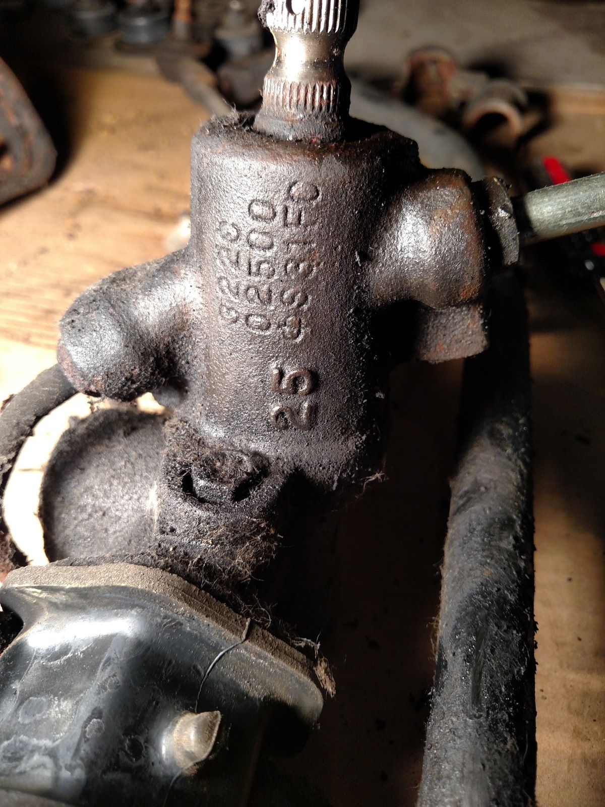

I also removed the sway bar and steering rack. I'm not sure if I want to rebuild the steering rack or just get a reman one.
It looks like the subframe is going to take some effort to clean up due to the shape.

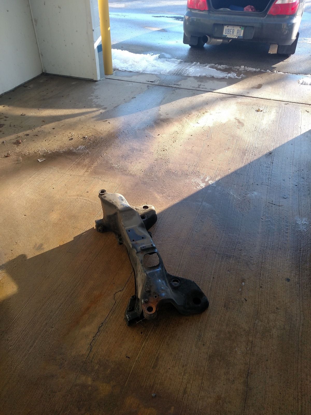

I came up with the bright idea to take my subframe to a self wash bay. I was able to get a decent amount of gunk off of it. I'm interested to see how much a powder coater will charge to do it so I am going to get a quote.

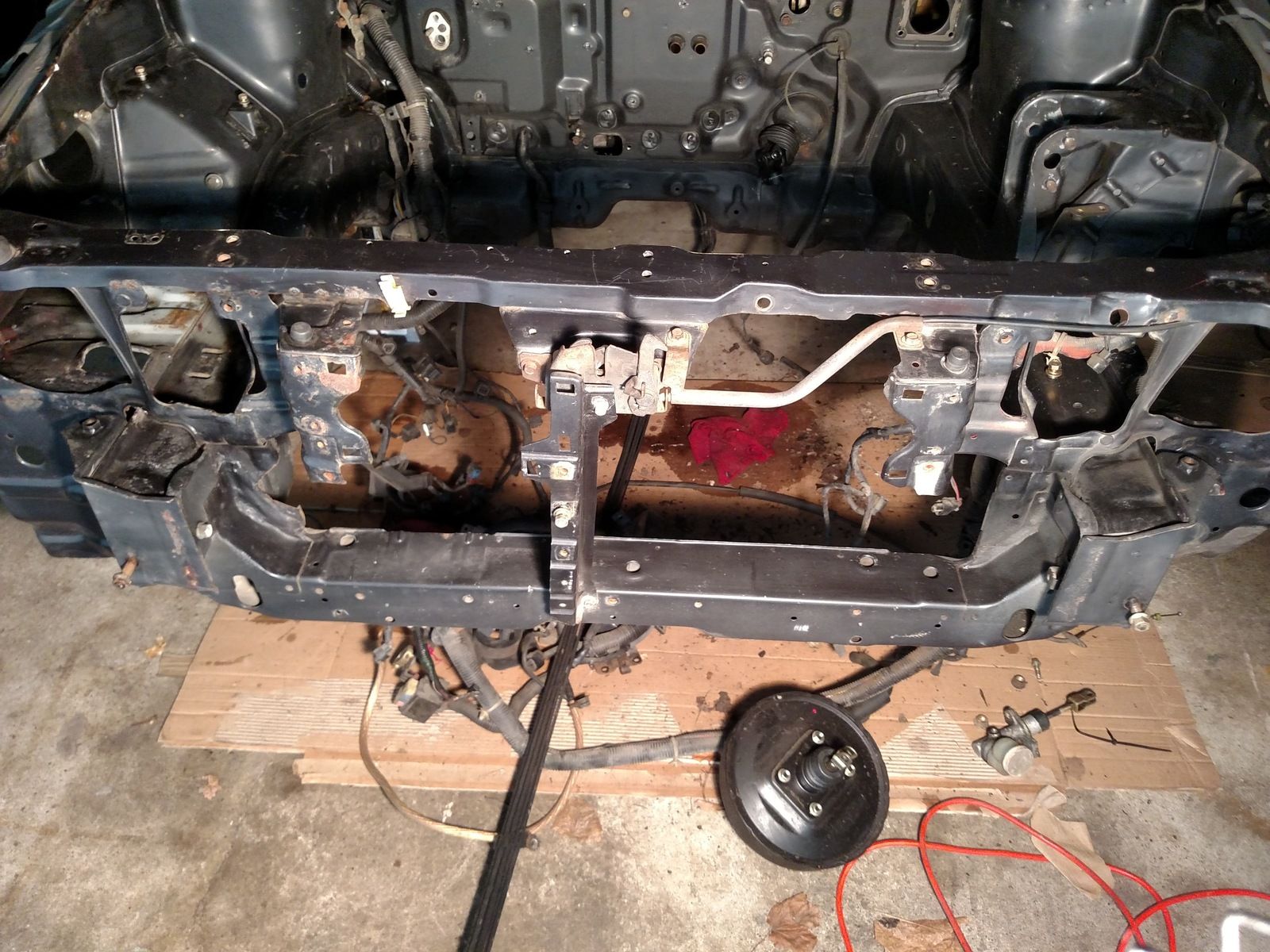

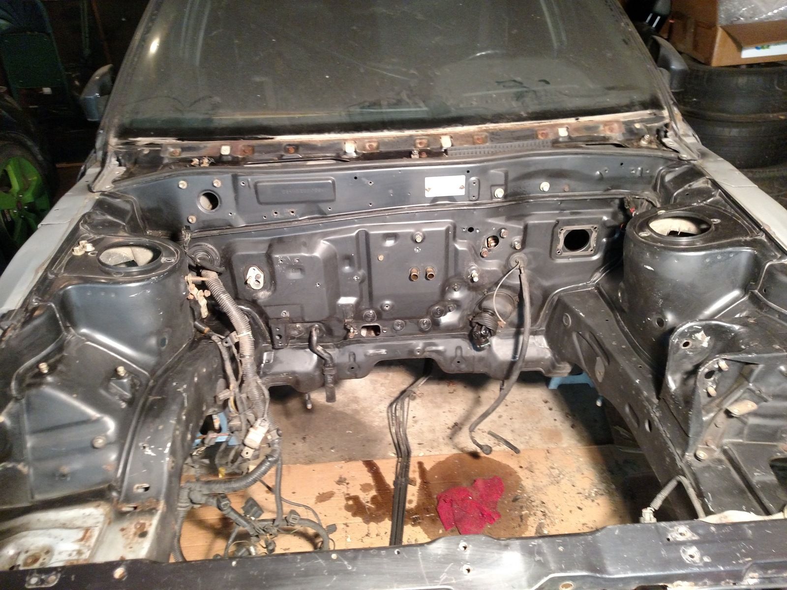

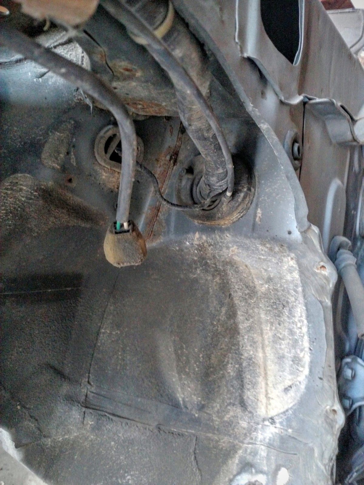

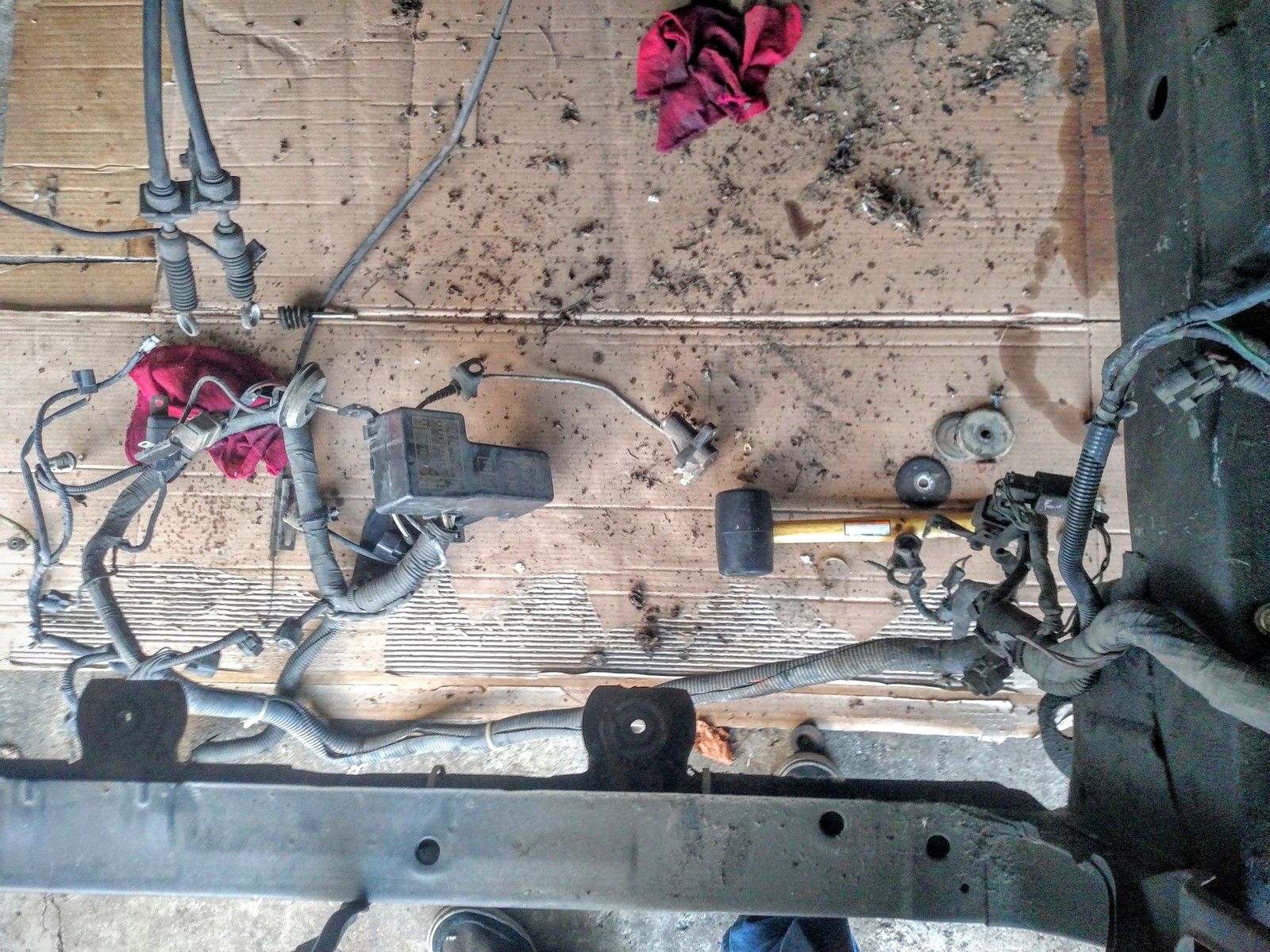

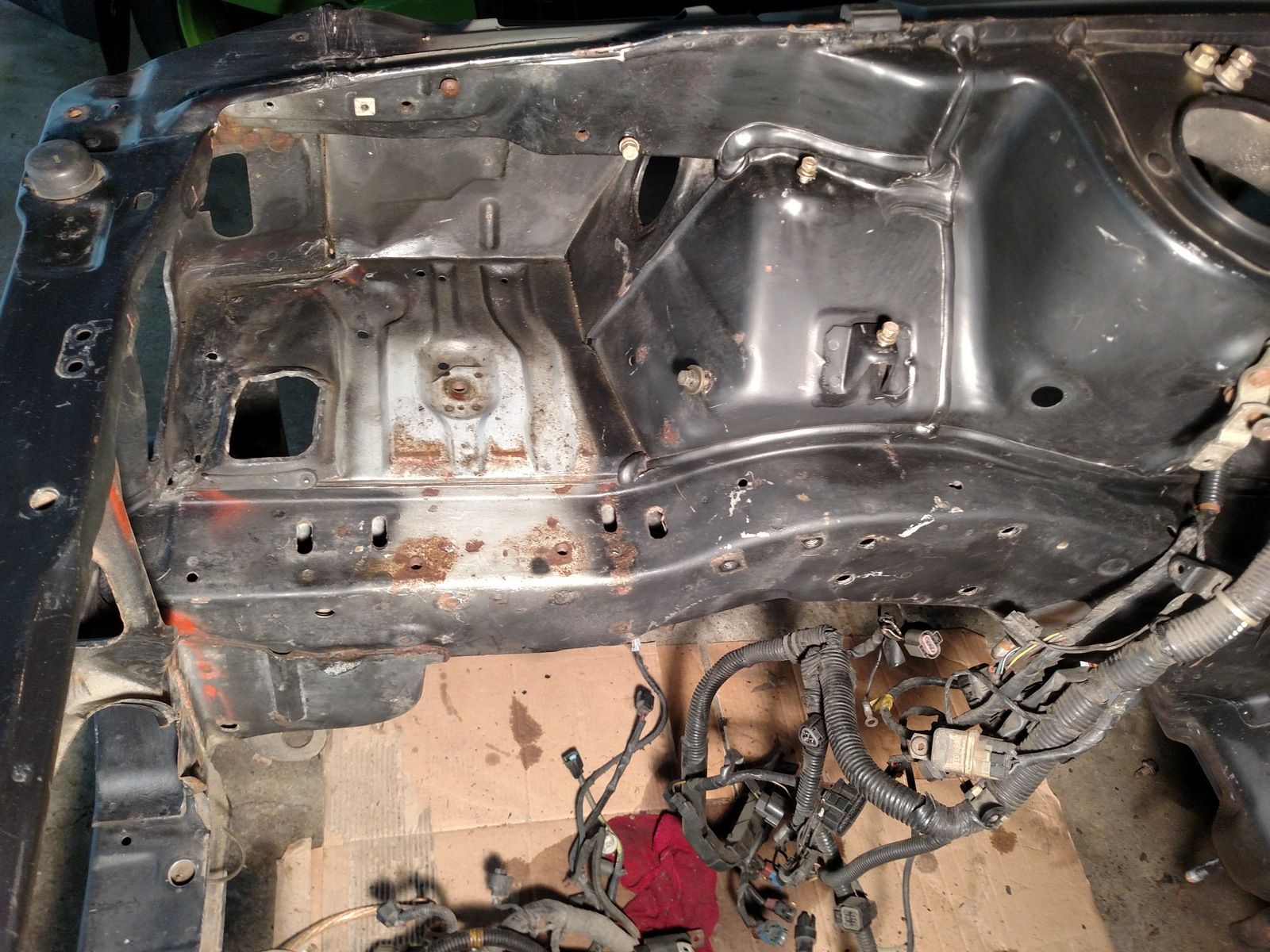

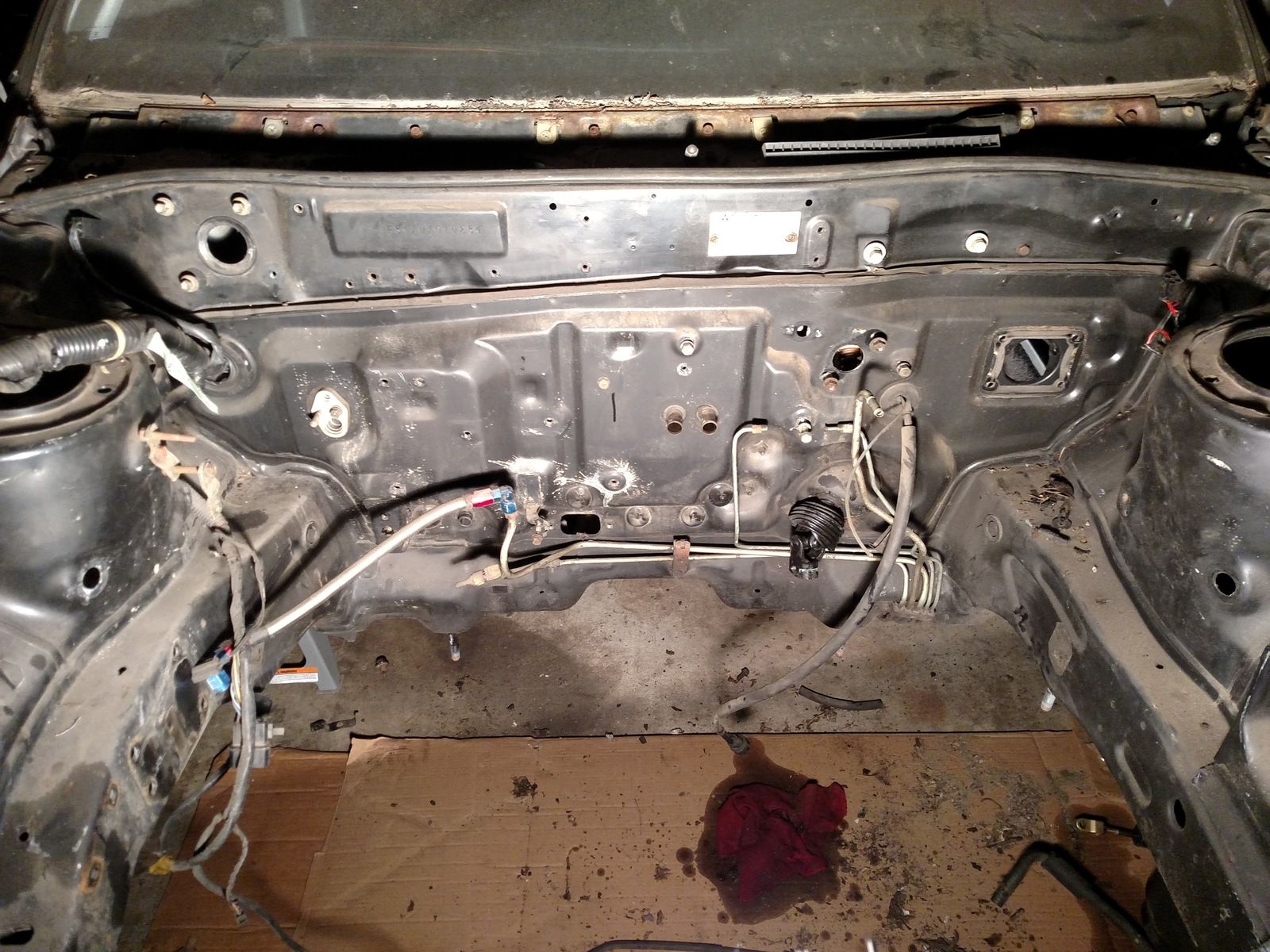

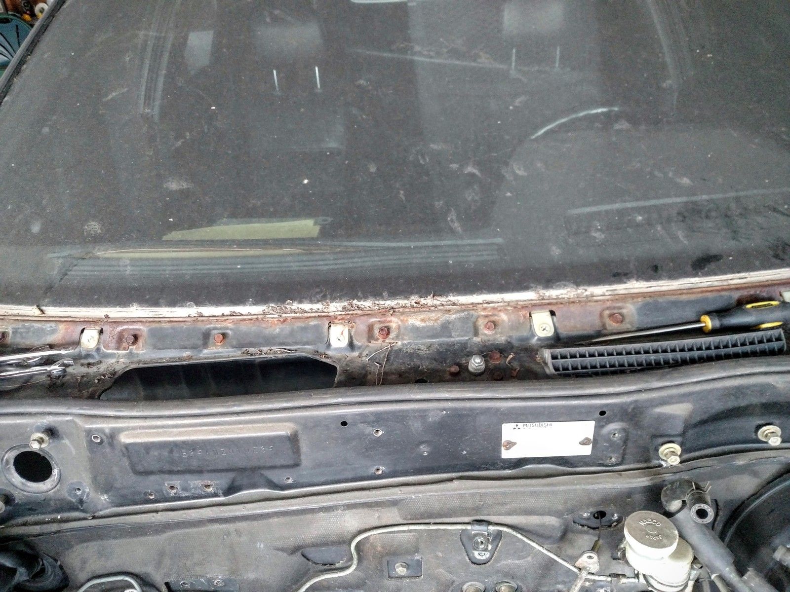

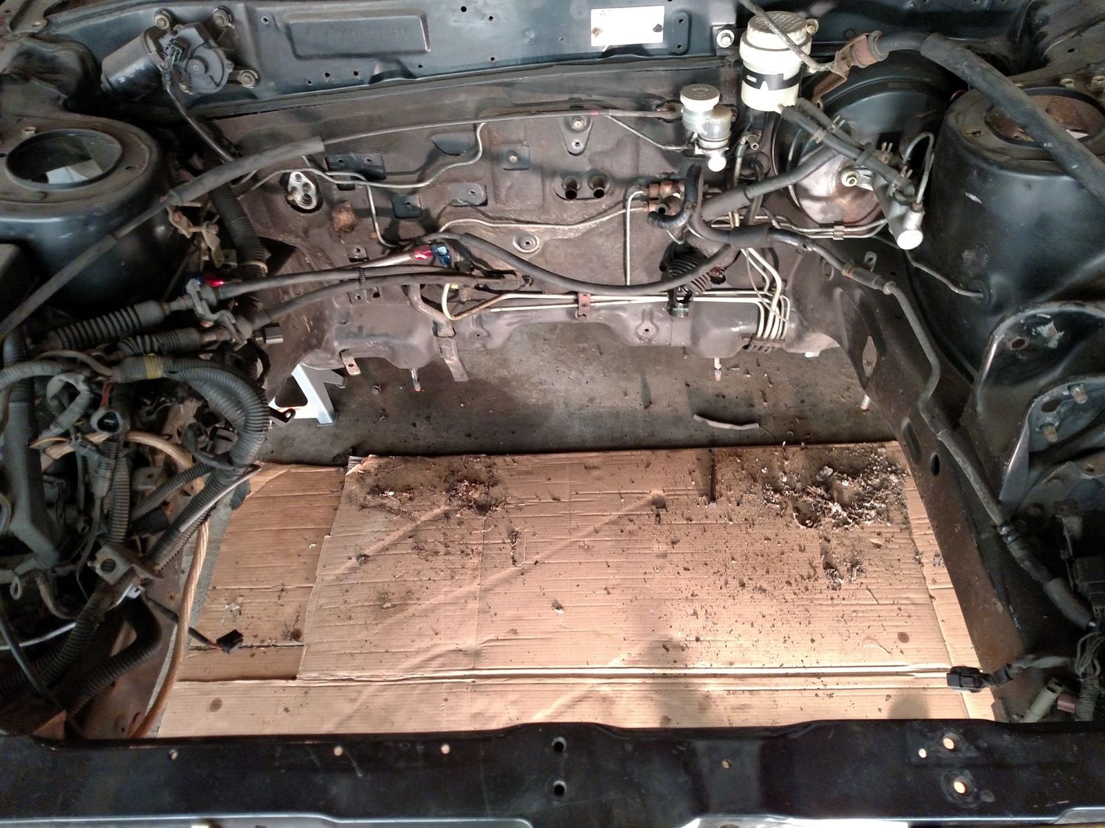

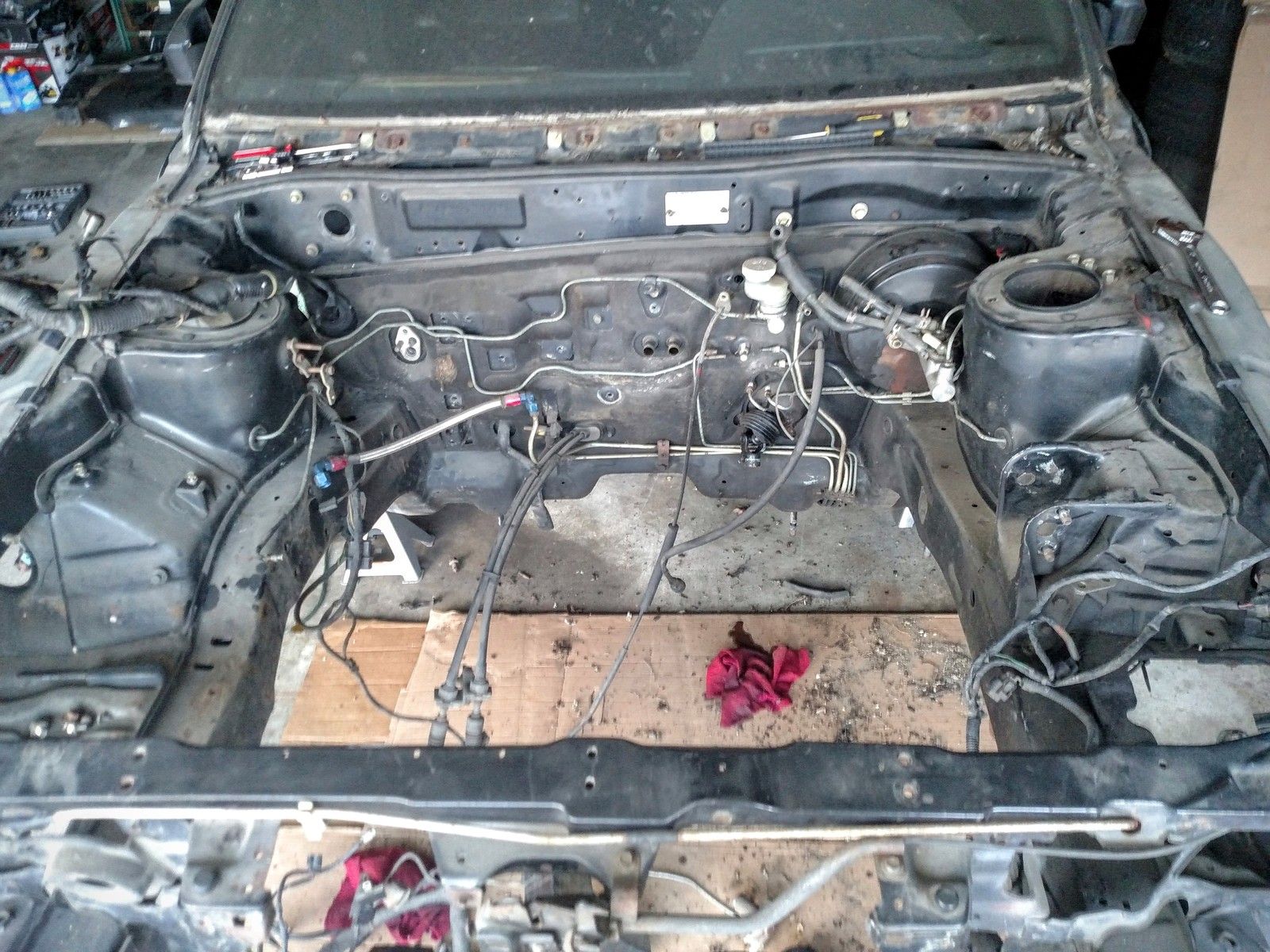

I also started disassembly of the engine bay. I removed the brake lines from the prop valve, removed the prop valve, wiper motor, cowl (and found some more rusty bits), and most of the harness from the body.
I need to get the interior parts of the harness disconnected so I can pull them through to the outside.

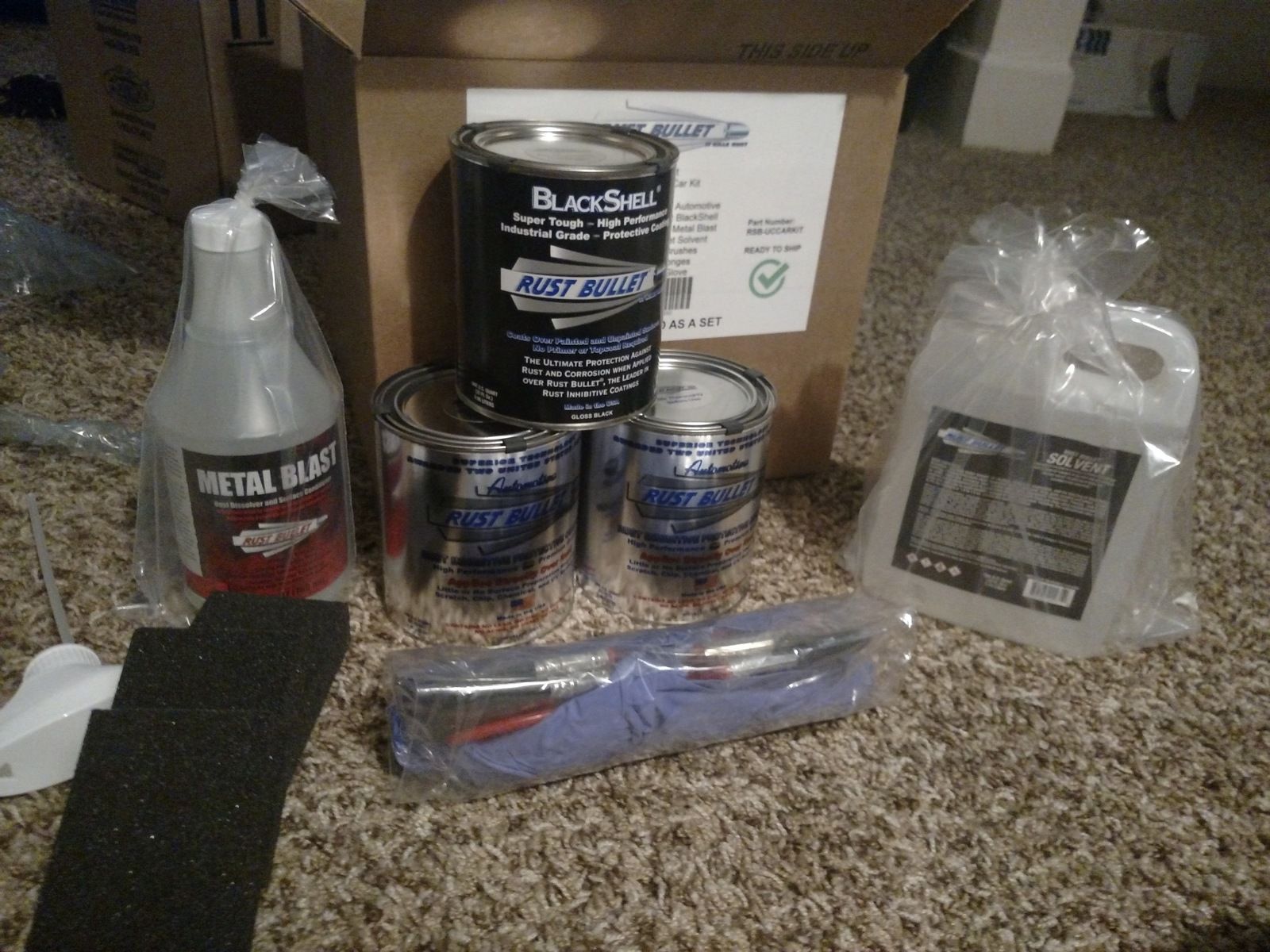

To start the evening off I had a nice box arrive! I can't wait to apply this to the rocker panel area. Hopefully ill have enough to finish the side skirts, wheel wells, and whatever needs to be fixed in the engine bay.

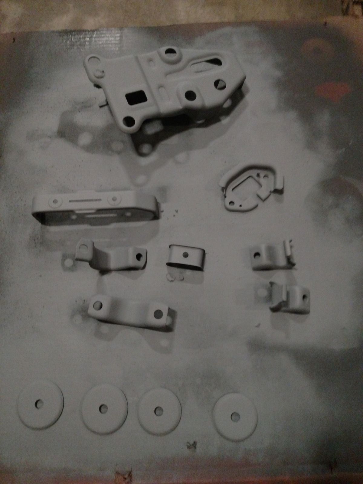

I did make some good progress tonight, and found some more things for me to sandblast!

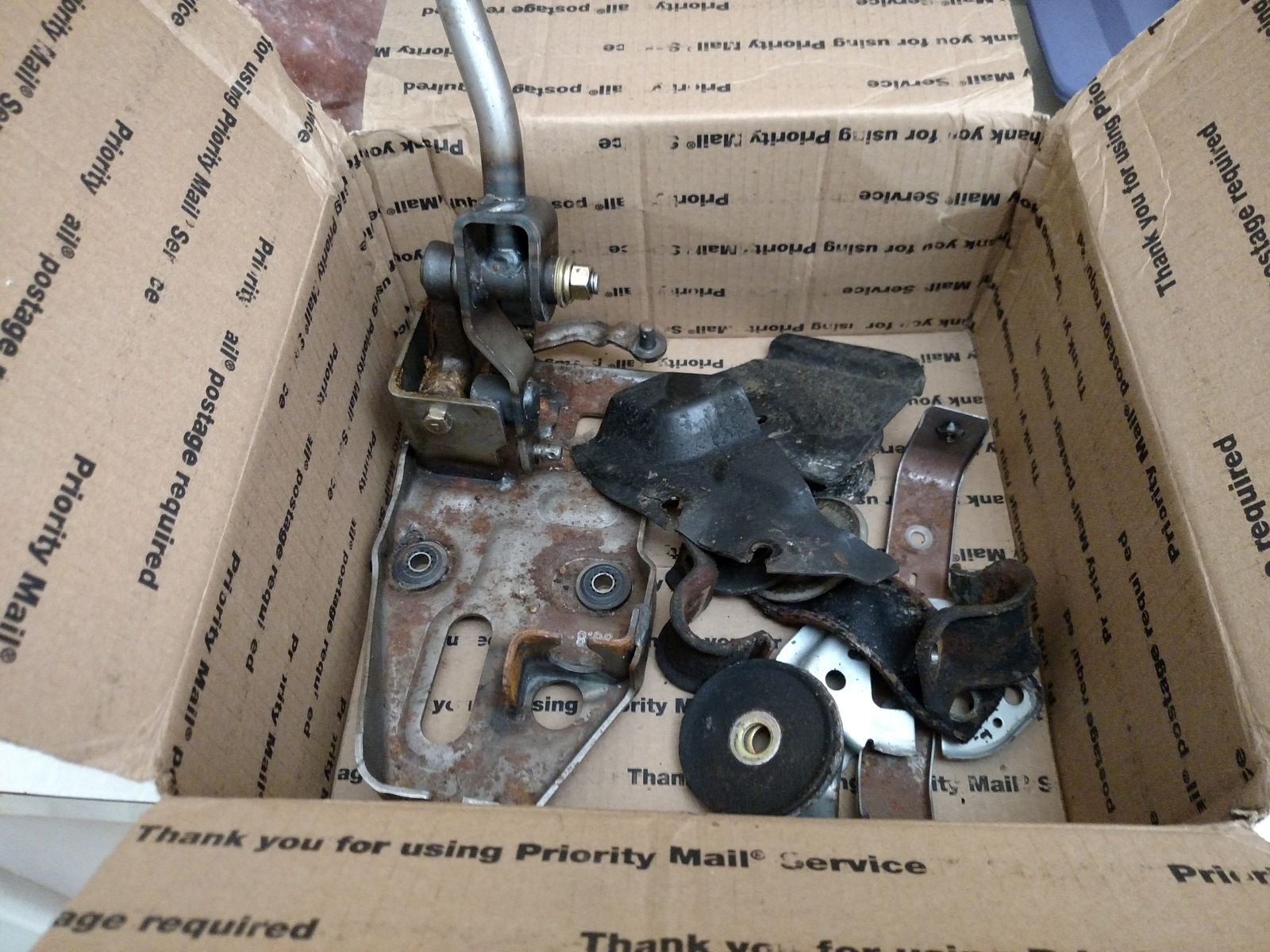

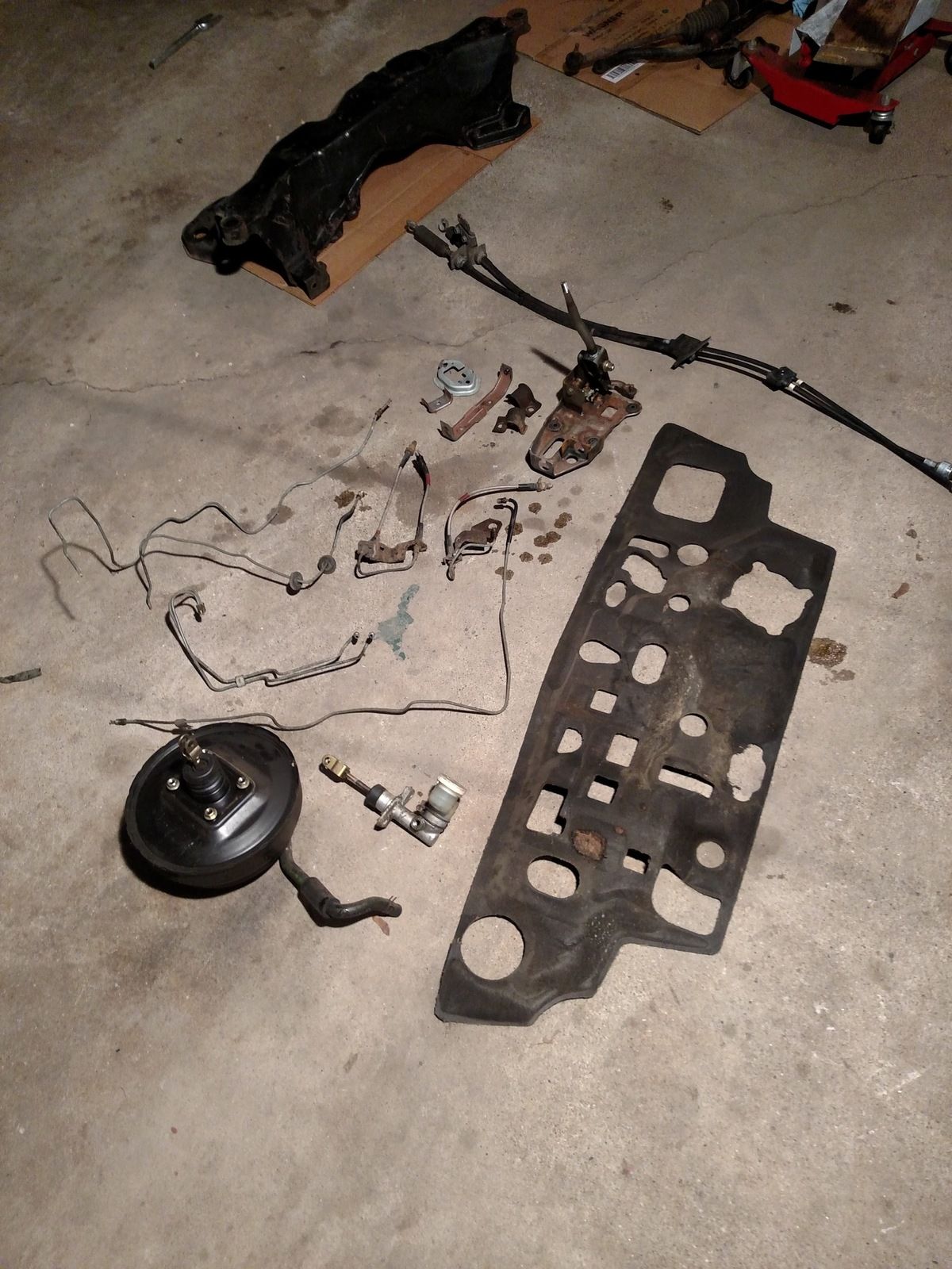

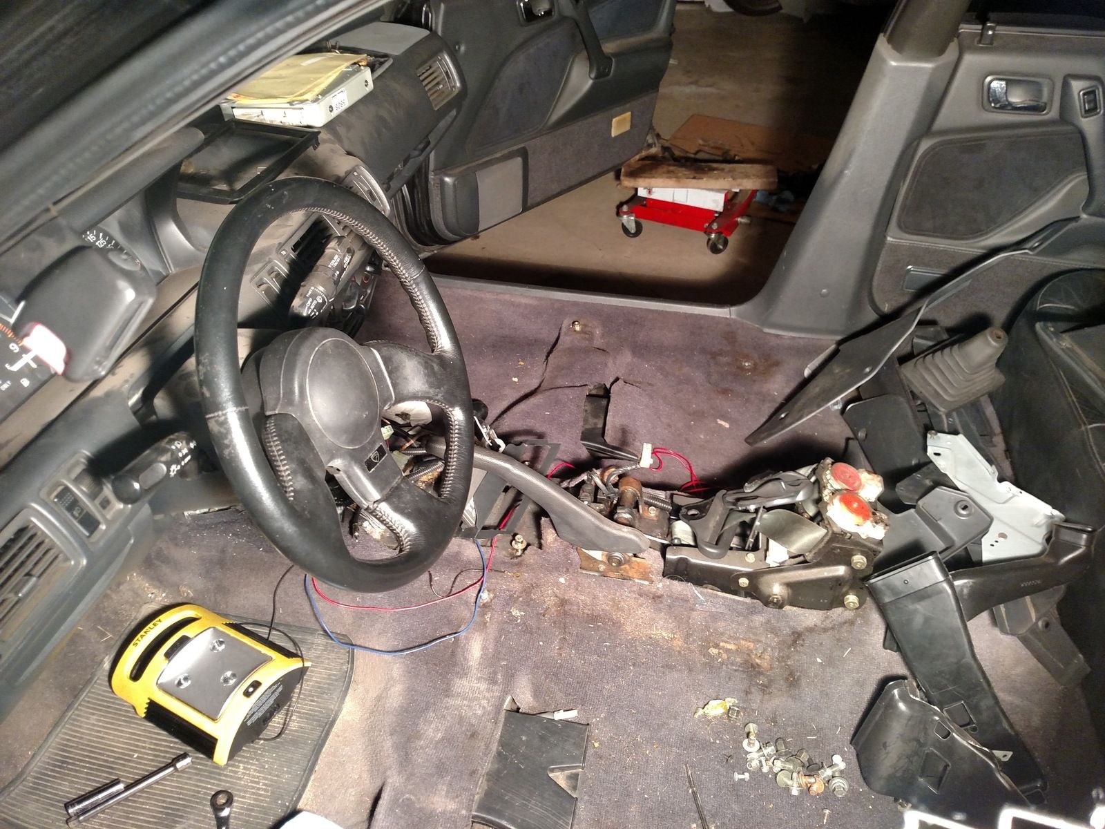

I started with the center console...well let me back up. I started with the seats because there was only one nut holding each of the front seats on. Once those were removed from the cabin there was ample room to get to the rear portion of the center console. Removing that wasn't so bad until the last screw by the gas pedal started to strip. I ended up just drilling the head off and the center console popped loose.
Once removed, I was able to gain access to the shifter cables. I unbolted the plate that holds the cables on the firewall and the bracket under the radio that holds the cables to the chassis. From there I snaked the cables out through the engine bay.

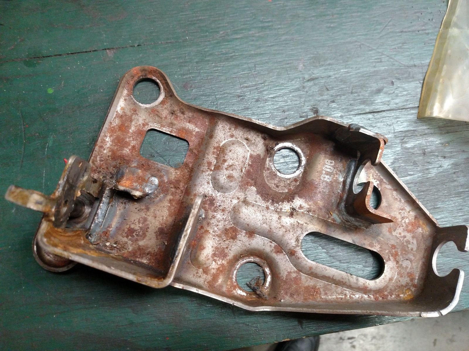

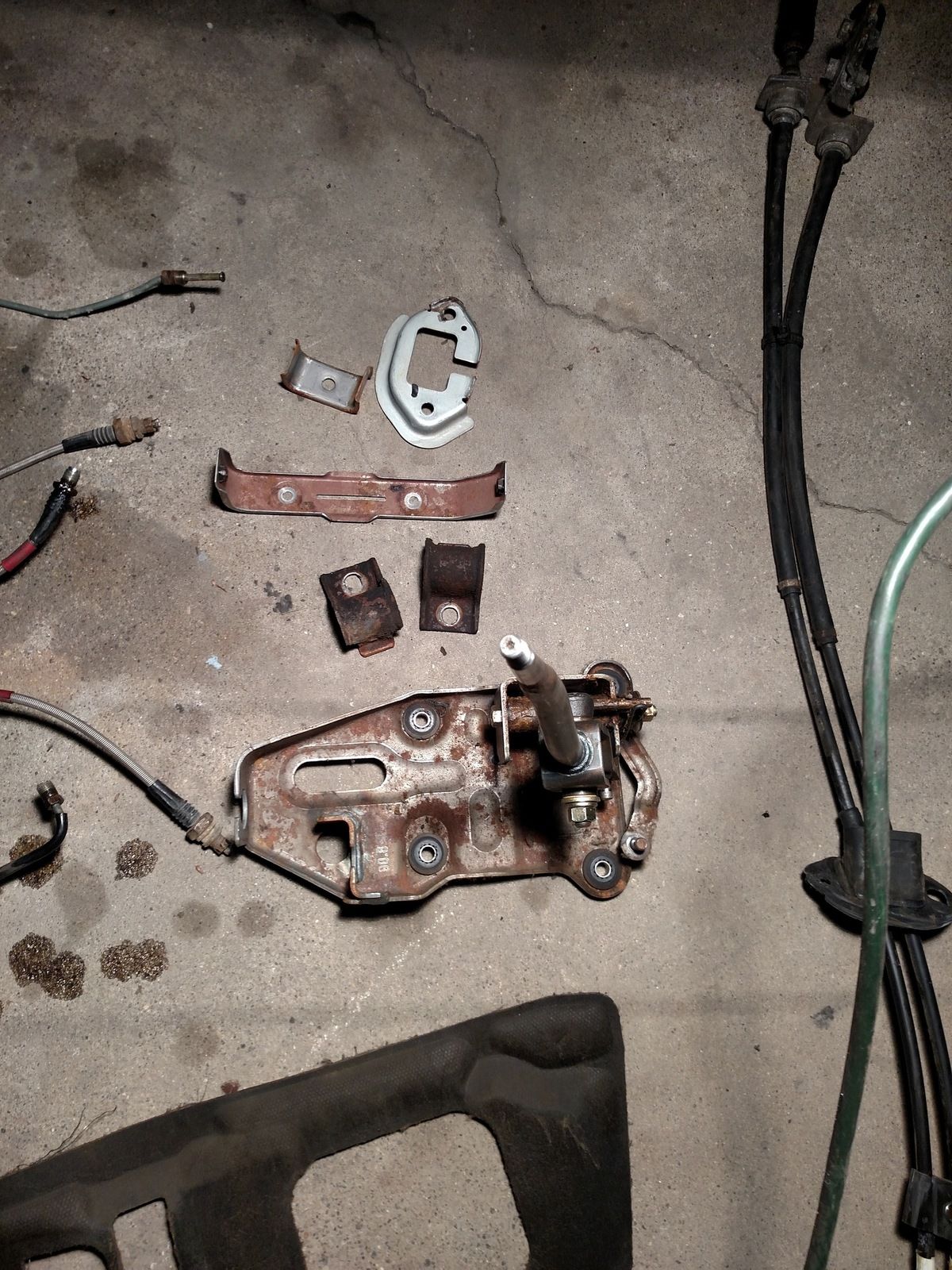

Staring at the shifter assembly I realize how rusty and disgusting it looks...so I remove the four bolts that hold it to the chassis and throw it in a box for sandblasting!

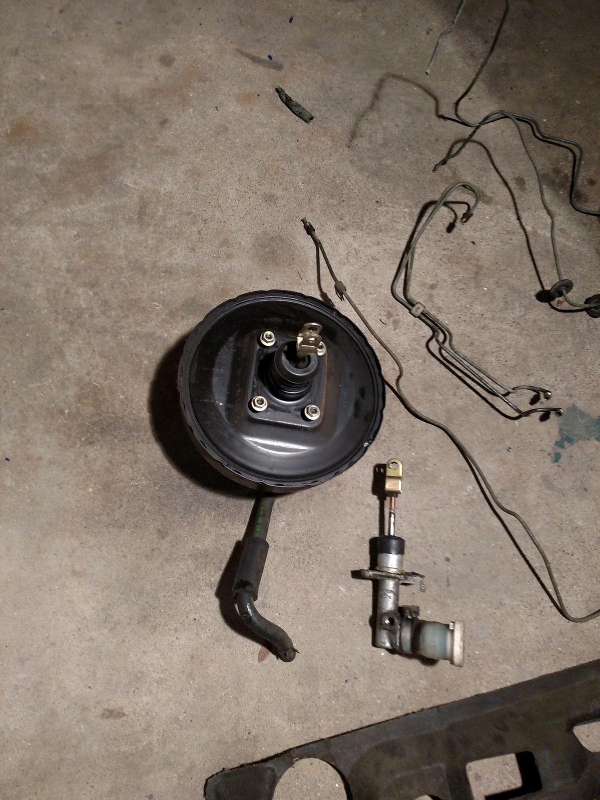

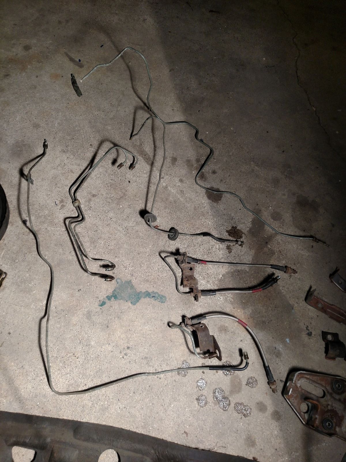

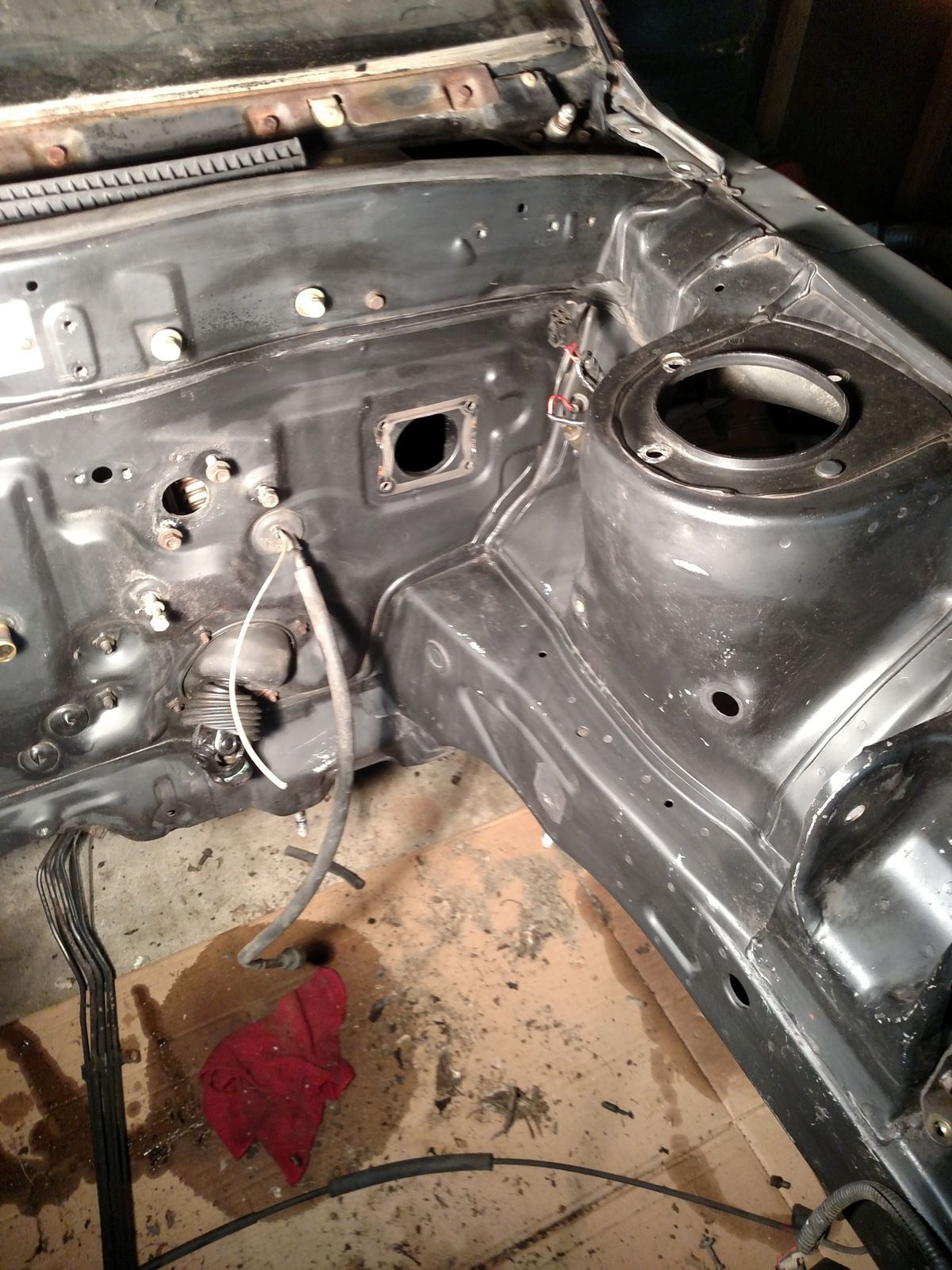

After looking in the engine bay I decide to get the brake and clutch lines out. The clutch line was pretty much good to go, but I had to cut the fittings off the ends of the front brake lines as they were seized. I kept the shape in tact so I can make newer ones more easily.
Next I tackled the driver footwell area. After removing some of the plumbing for the heater I was able to see the tops of the clutch and brake pedal. Removing the cotter pins and pulling the fastener off allows the plungers in the brake booster and clutch master to move free. I unbolted the clutch master and brake master from the outside and remove them. I then unbolt the brake booster from the inside and wiggle it out from the strut tower area.

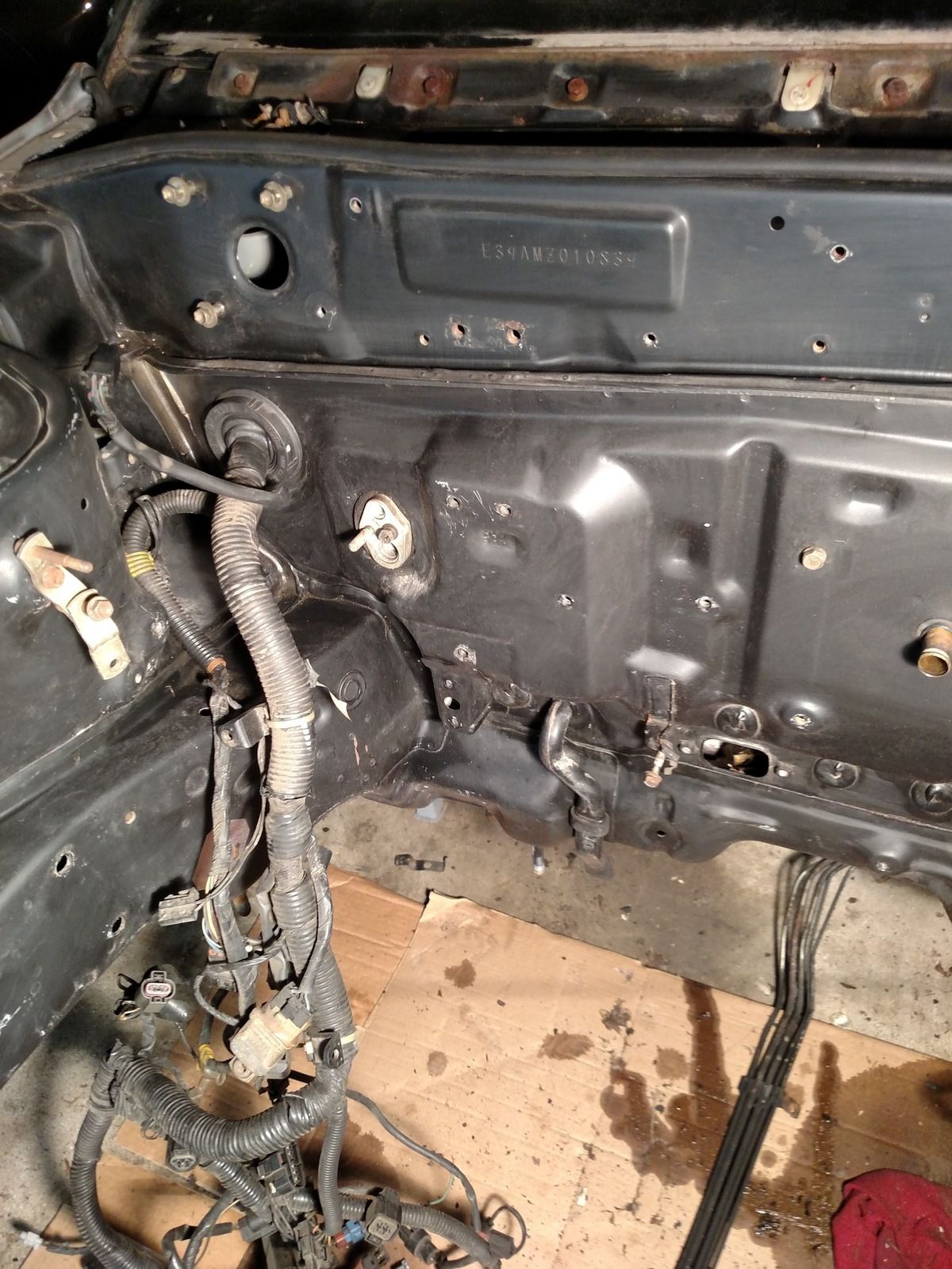

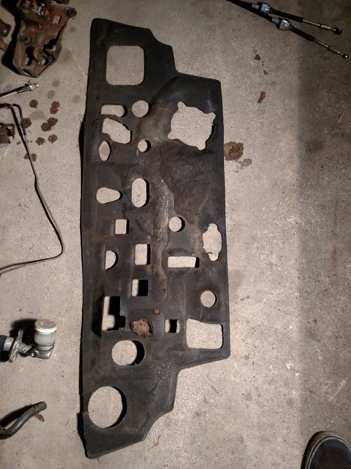

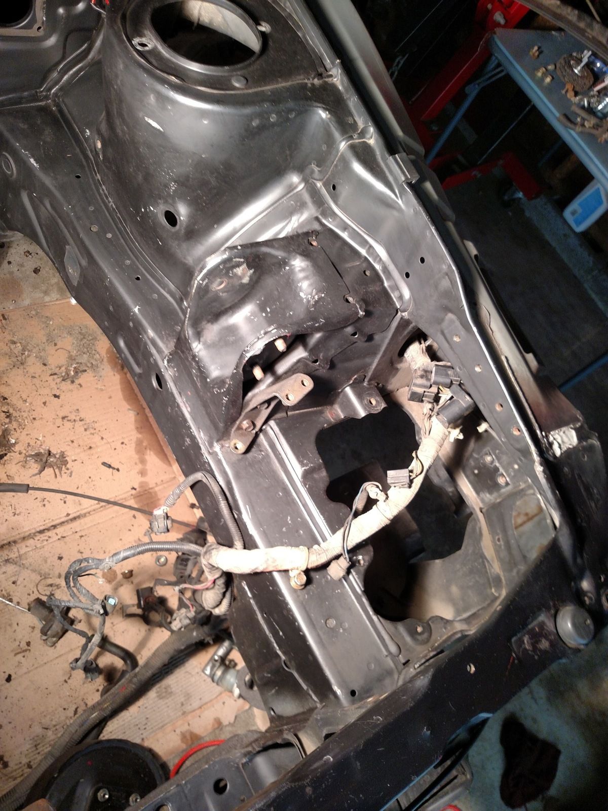

Next I tackled the sound deadening. I cut it in a few places to make snaking it out a bit more easy. I won't be putting this back on. To my surprise the paint in the engine bay area doesn't look too bad. There are spots that will need to be addressed so i'll decide if I want to repaint the whole thing at that point.
Here's everything that I removed.
My sandblasting bits.
Remaking these will be part of the brake project.

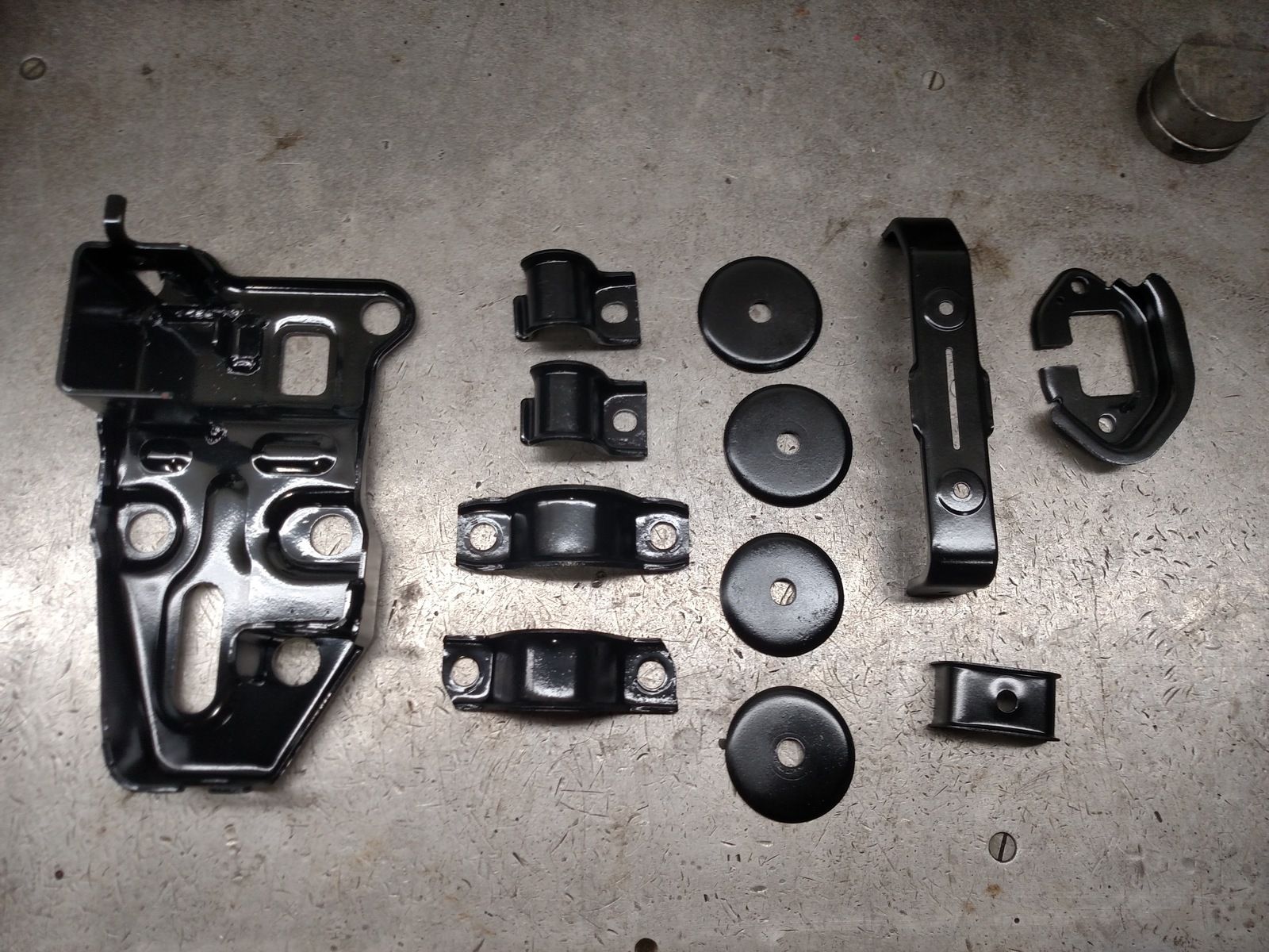

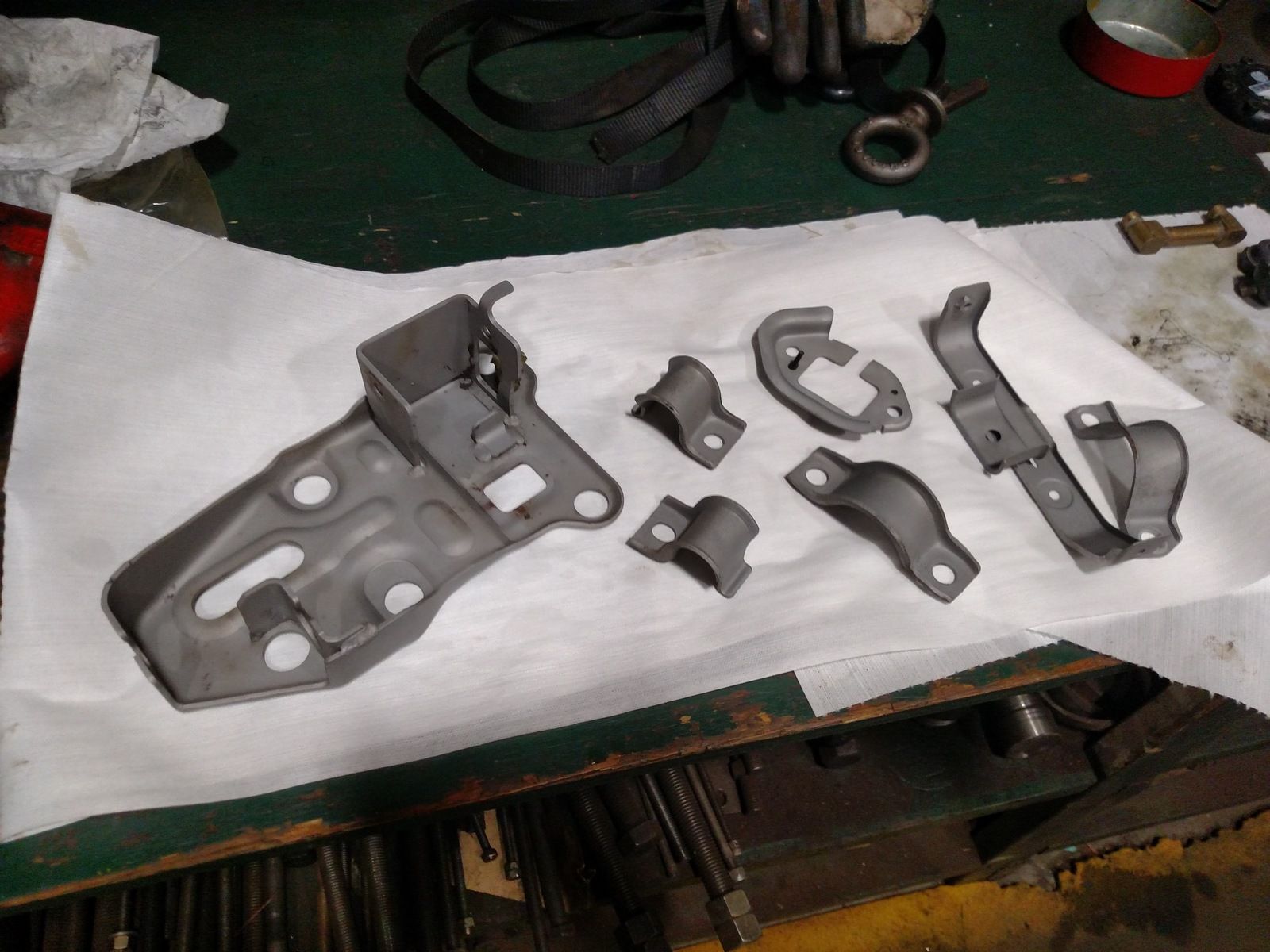

I worked on cleaning up those parts over the last few days. They turned out VERY nice, it's the little things!
I looked into ordering the bushings to make the shifter good as new. It looks like JNZ still sells the VR4 shifter cables as well. I thought they were the same as DSM cables, which are discontinued, but they are still listed. I may have to get me a set before they are no longer available.
I just got a set for my gvr4 from them :). Only diff is they are updated and only have one cable that adjust. Wasn't even a issue and fit perfect for me. I also got all the bushings to rebuild my shifter from them and man what a difference it made. Doing a really nice job on the restore bro! ;) love it
After debating with myself on whether or not I wanted to do SS braided brake lines (instead of the hardlines) and pricing everything out I decided that I would go with SS hardlines.
Today's adventure was dropping the rear subframe so that I could pull the hardlines off in one piece. It is going to be easiest to just bring in my old lines and have new ones fabbed up for me.
After that I decided I would do an initial wipe down of my engine bay. To my surprise the paint is still in really good shape, aside from around the battery tray area. I may not even repaint the bay, I might just touch up the sections that need it.
I'd just spray the whole bay. You can put trash bags around the wiring harnesses and tape them up instead of removing them. That's what I did, and it worked great.
I know, I really need to just do it now. I just don't want to wait for it to get warm enough to paint!

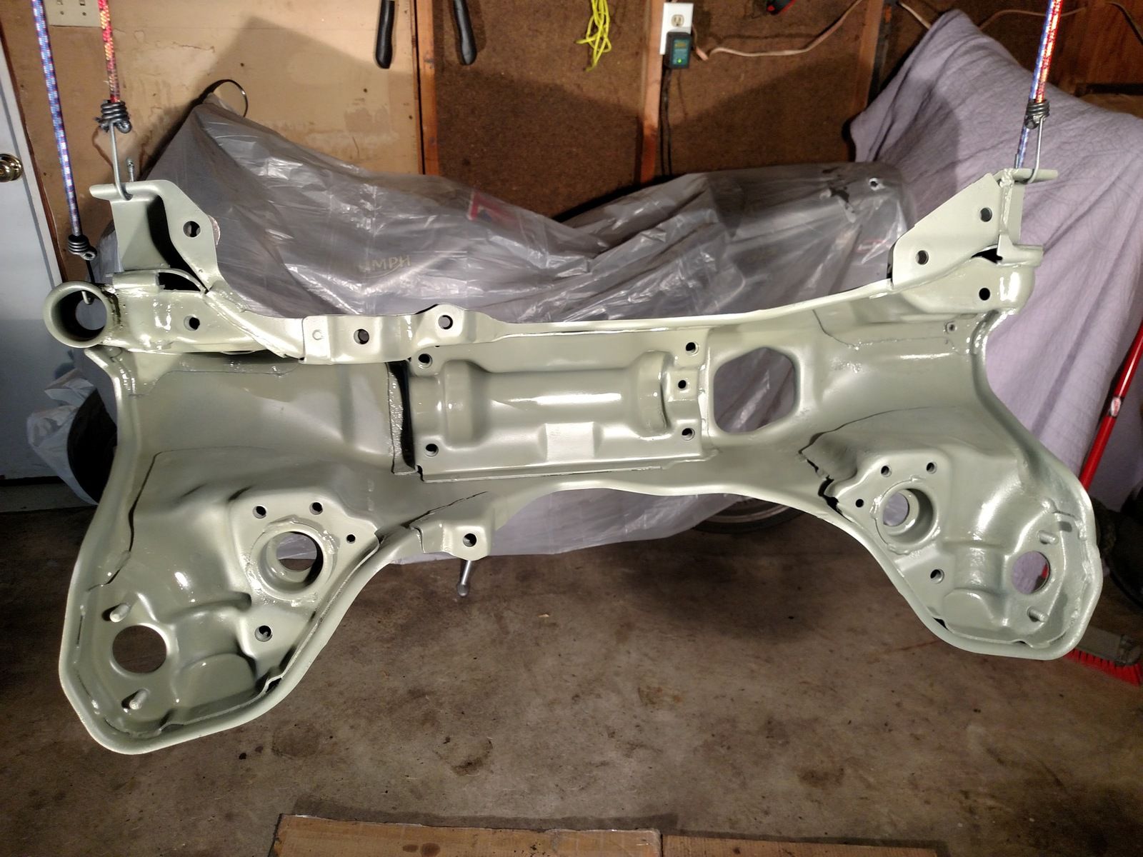

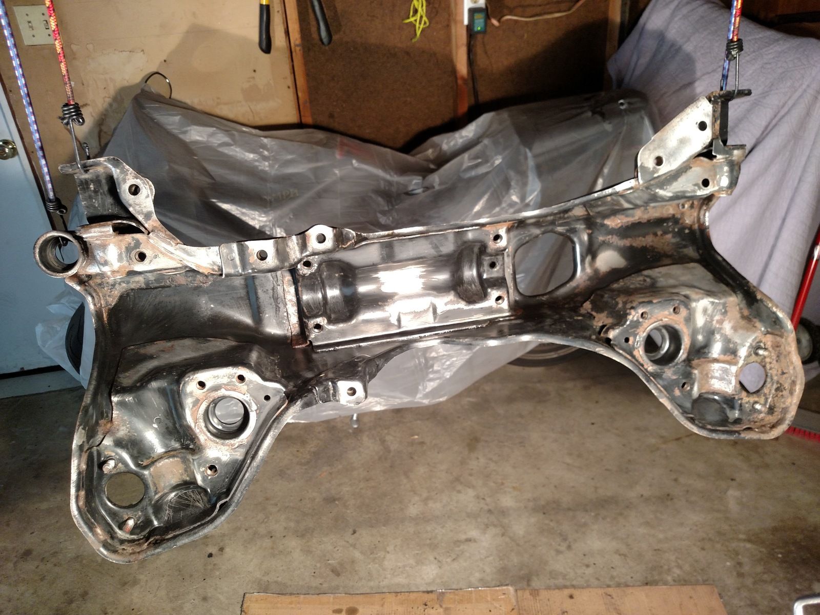

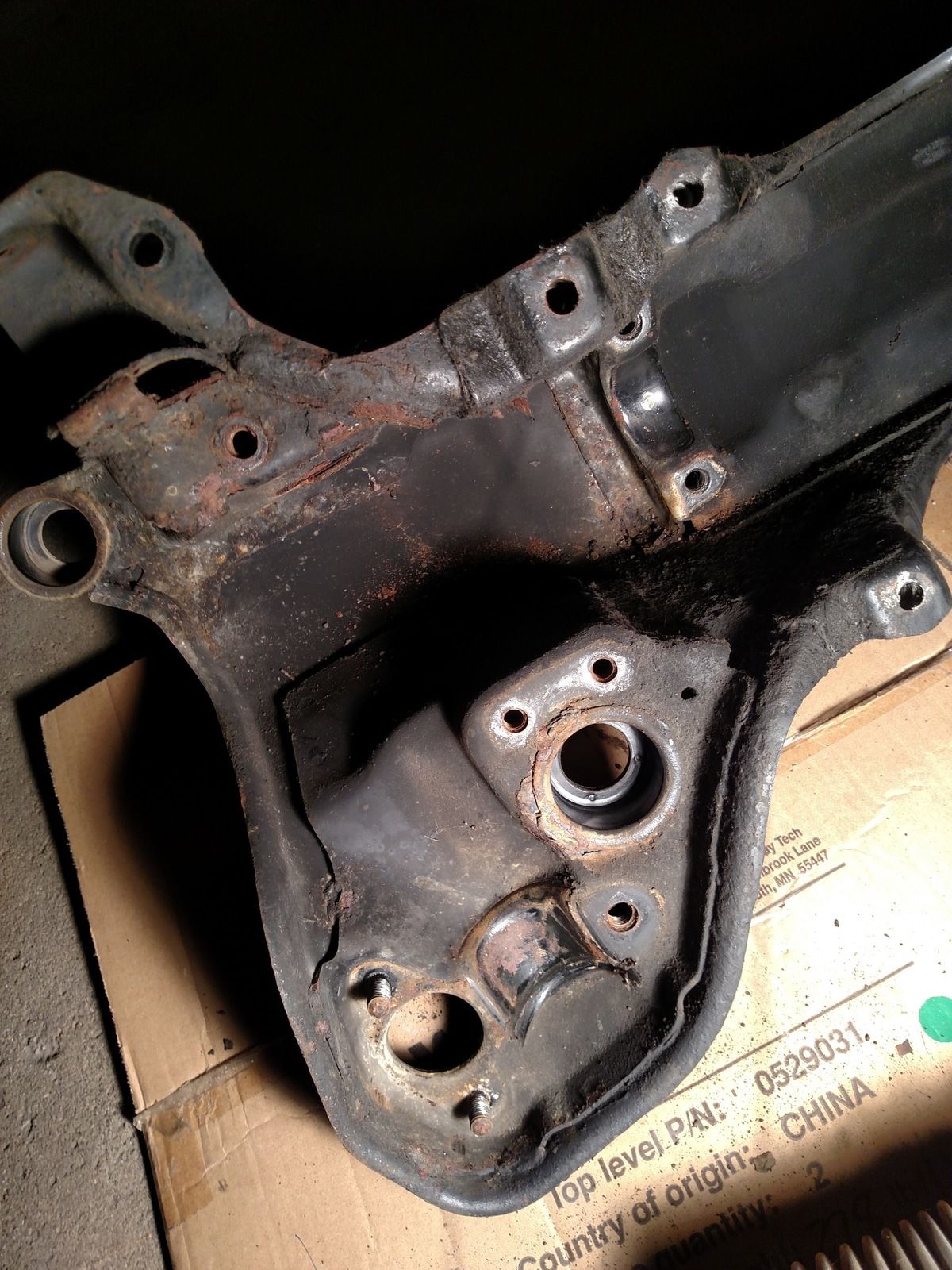

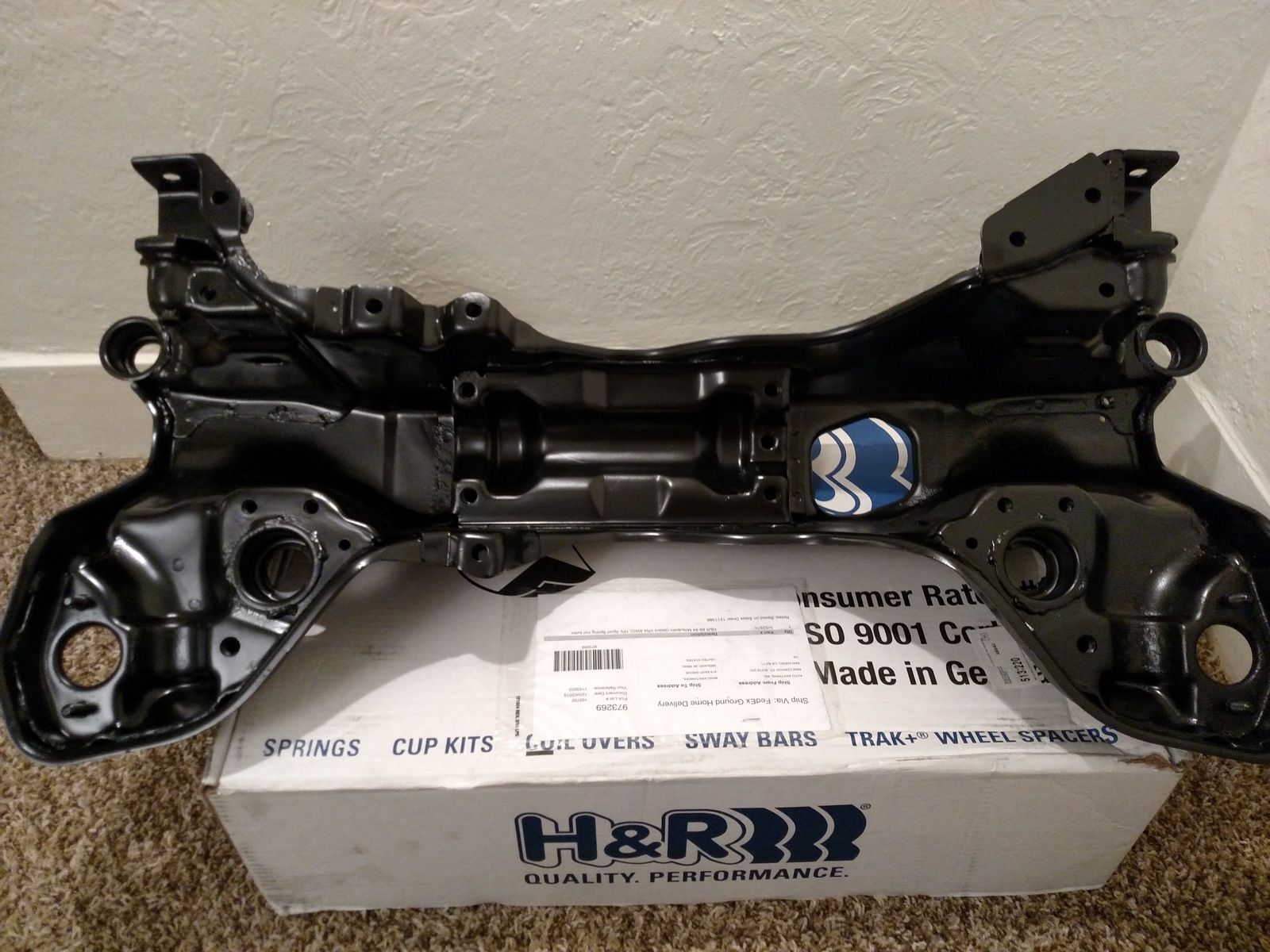

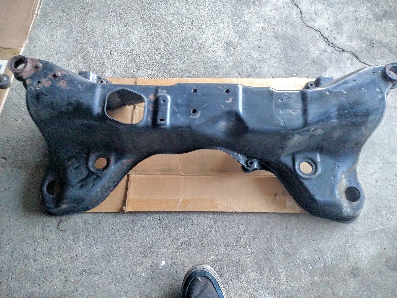

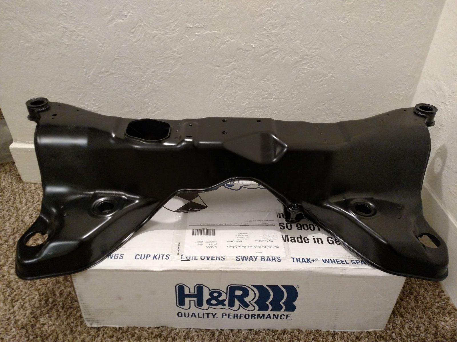

Today I tackled the front subframe. I've really been dreading doing this because of all the grease/oil thats caked on. I used some simple green and kerosine to get most of the crap off of it.
I hit the rusty areas with a wire brush, but there were still a lot of places I couldn't get to, due to the awkward shape of the subframe. I had some rust converter so I decided I'd spray some of that on the areas that I couldn't get to, I did the same for the hardline on the fuel tank and it turned out nicely.
This is what it looked like before applying the rust converter.
Once the rust converter cured I hit it with three coats of primer.
Finally I finished up with some acrylic enamel. I believe I did three coats of this as well. It turned out great!
I would have sandblasted this if I had a big enough booth. The one I use could probably fit this in it but not be able to get all of the angles I would need.
I may acquire another subframe to have it powder coated down the road.

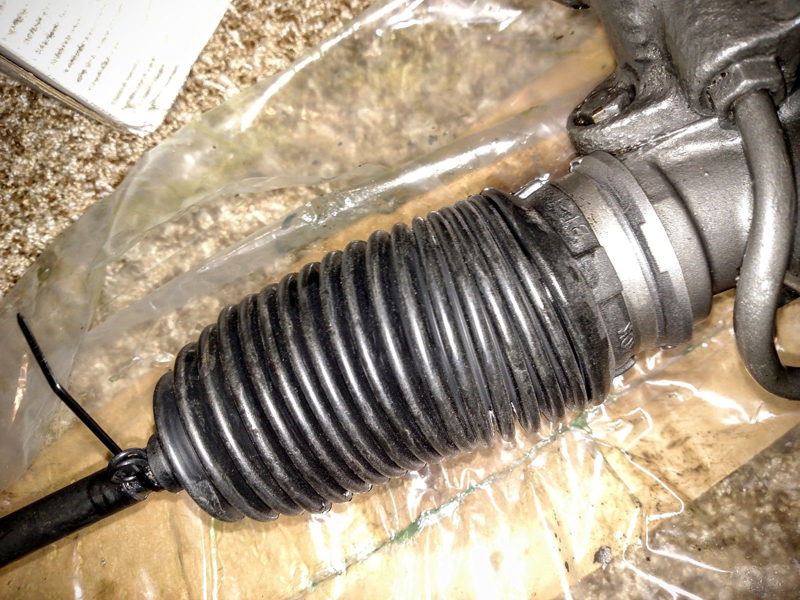

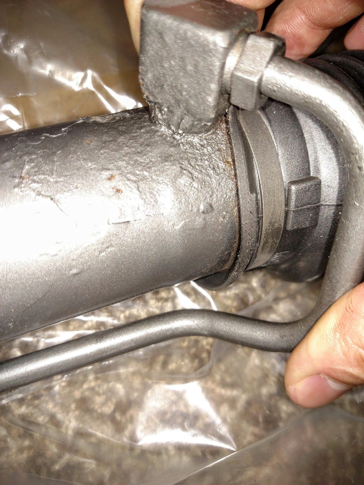

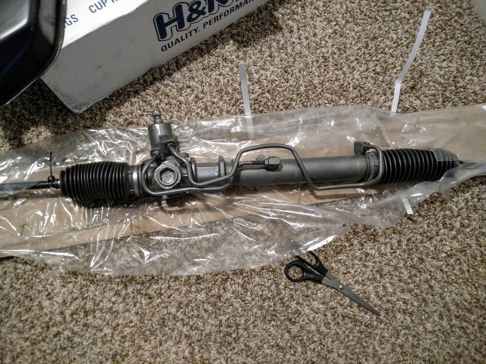

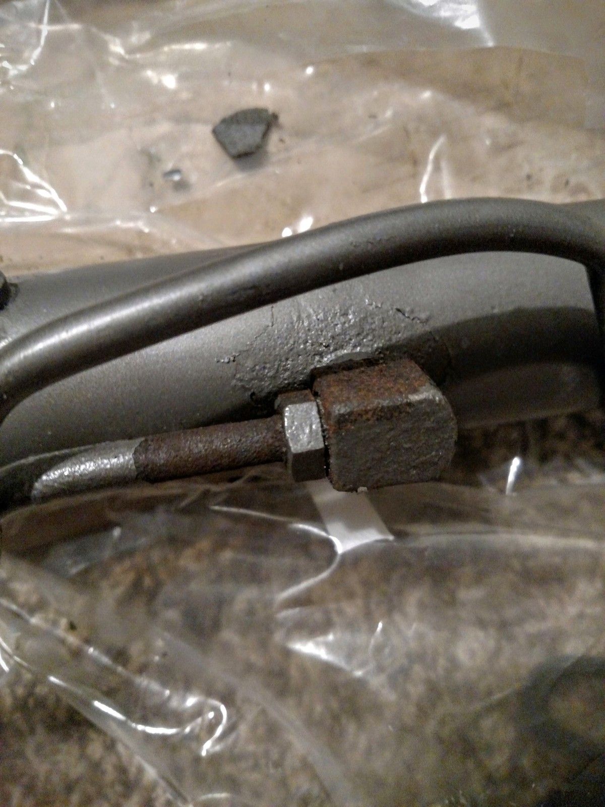

I need to get the front re-assembled enough to get this on a trailer and moved. I figured I would order a reman steering rack from Detroit Axle. I saw a few reviews on Amazon and people seemed to think they were alright. It was only $125, and the quality looks pretty bad, so I really doubt it is going to be anything spectacular.
Given the quality (or lack there of) of this rack I will be keeping my old steering rack and probably doing a rebuild down the road.

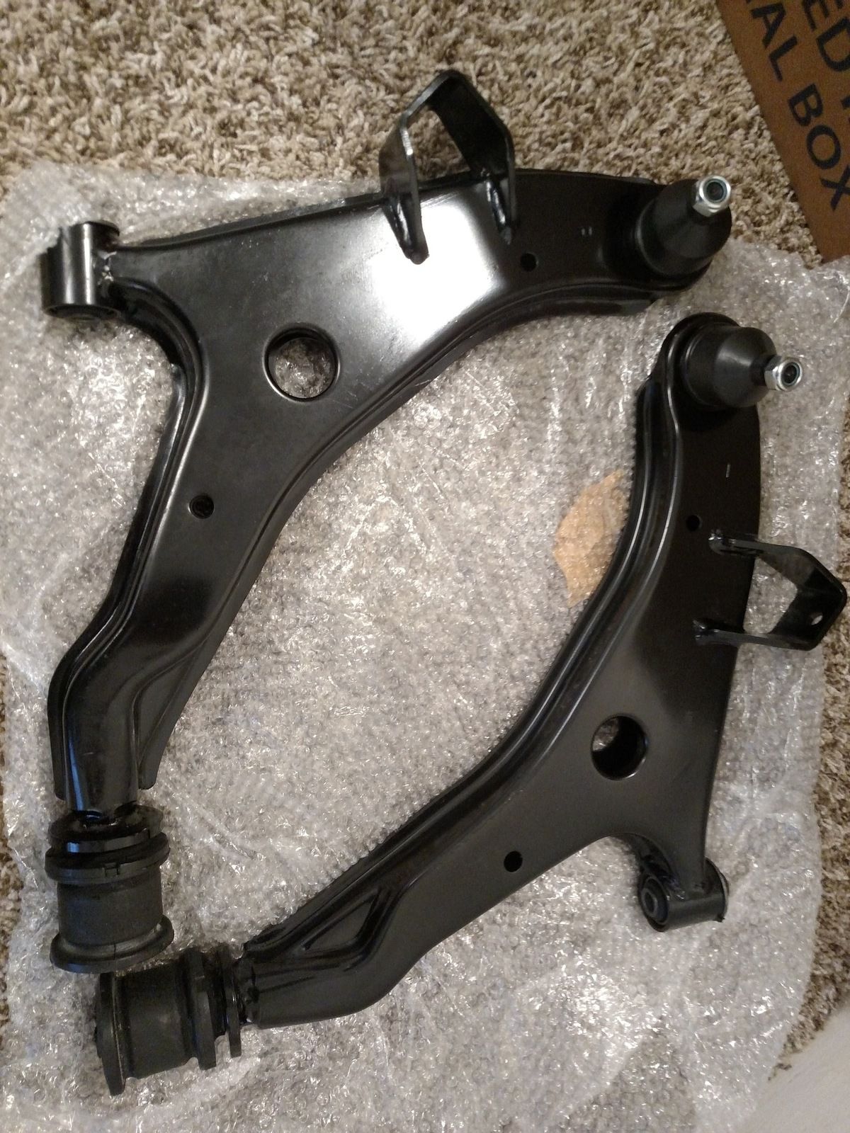

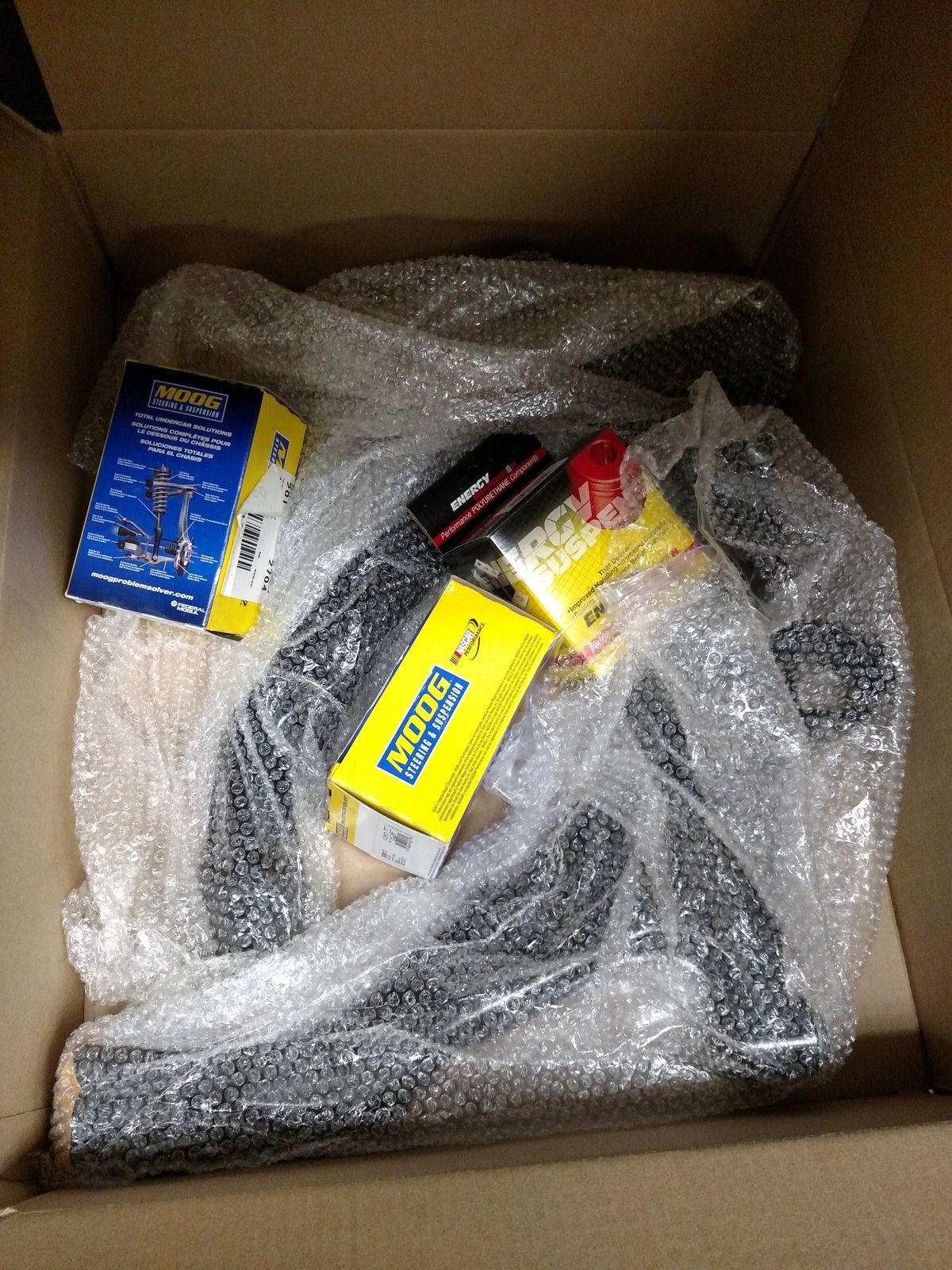

Some more goodies arrived in the mail last night.

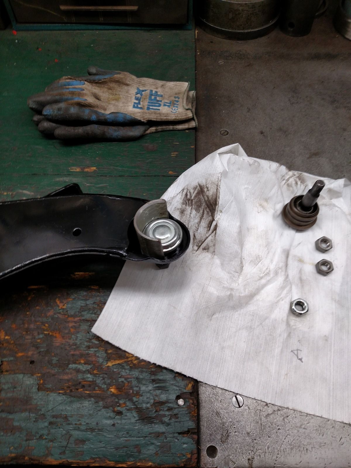

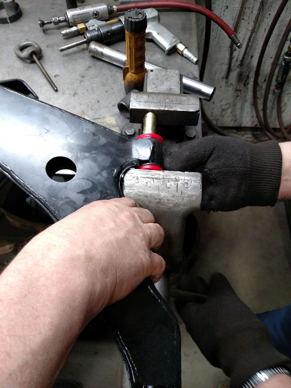

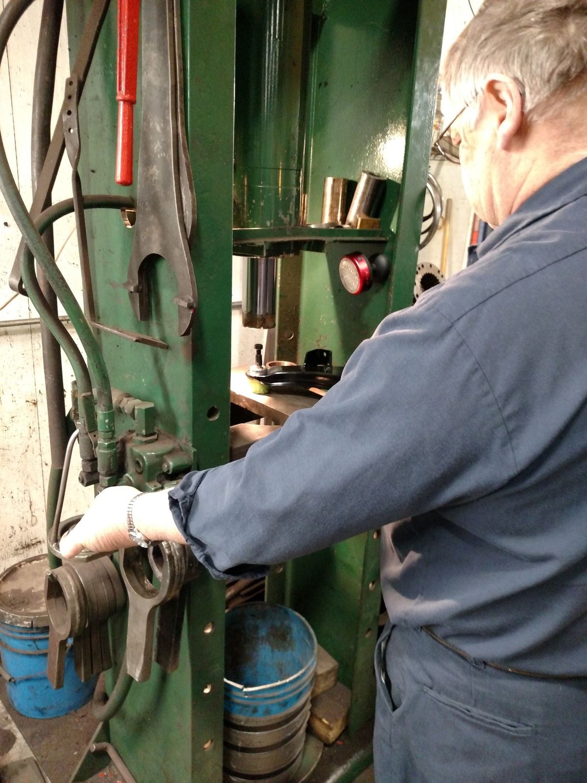

Brought these bad boys into work to get some work done. I already bought Moog ball joints for the front so I will be putting those in instead of the ebay ones that were on them already. I also have some Energy Suspension bushings that I will be replacing on them as well.

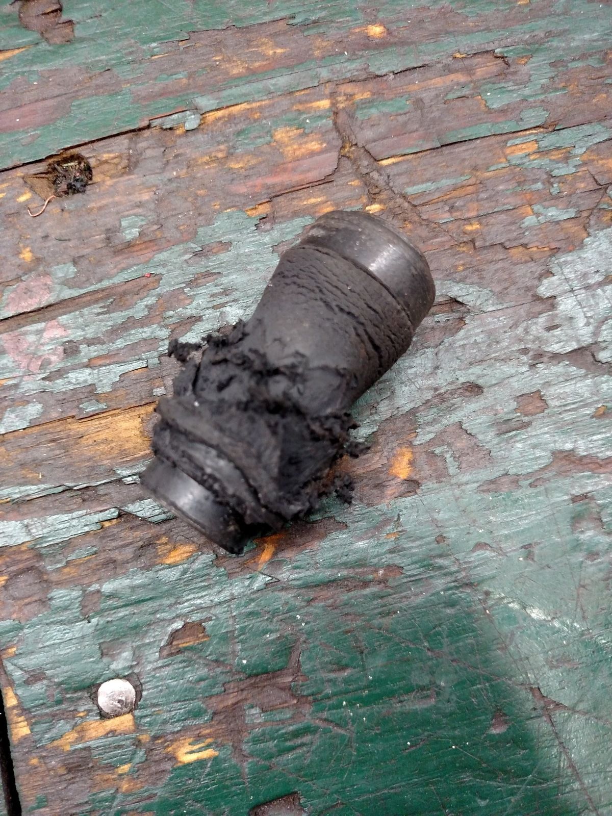

We were only able to get one control arm done. When trying to push out the stock bushing on the other one it took the outer race with it. We are in the process of finding something of similar size, or fabbing up a new outer race, so that we can finish up that control arm.
Here's the original bushing that came out of the first control arm.
