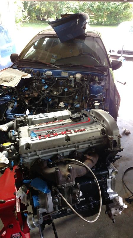

Some recent updates.

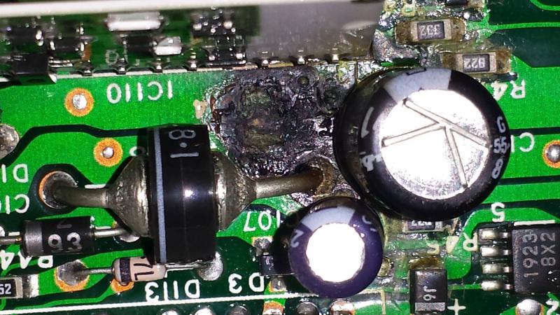

Power train is out. I was able to get the car to run, but poorly. Here is what I found to likely be the issue:

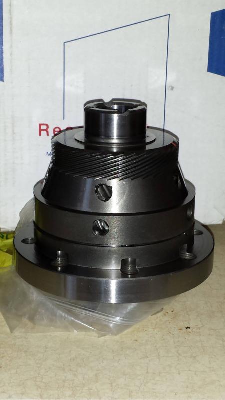

Also picked up an LSD:
Nice buy, looks like you are going to make it pretty solid. I might have a 1G ECU around here if that is fried... I will check. I am interested in what you find about the Feal coilovers. When I talked to them last month, they said they don't make them for the 1G anymore, so hopefully they still will make them... Here was their reply to me...

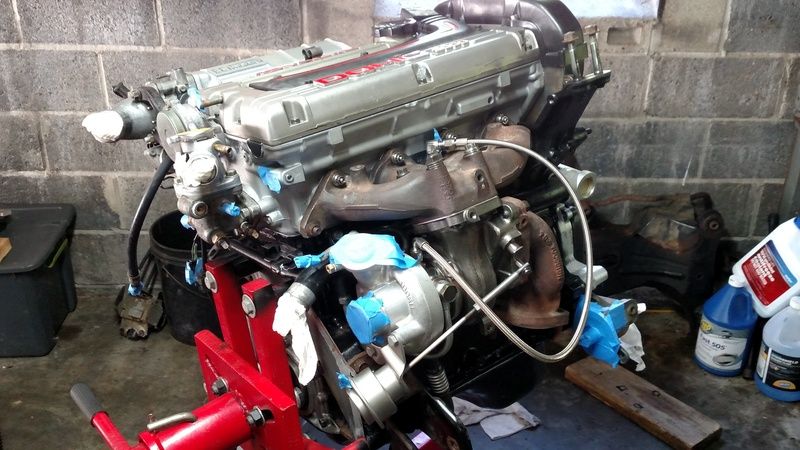

No updates in a while,so here we go.
The motor is just about ready to mate to the trans. Just waiting on a few odds and ends that I would like to take care of in the engine bay before the motor and trans are in.

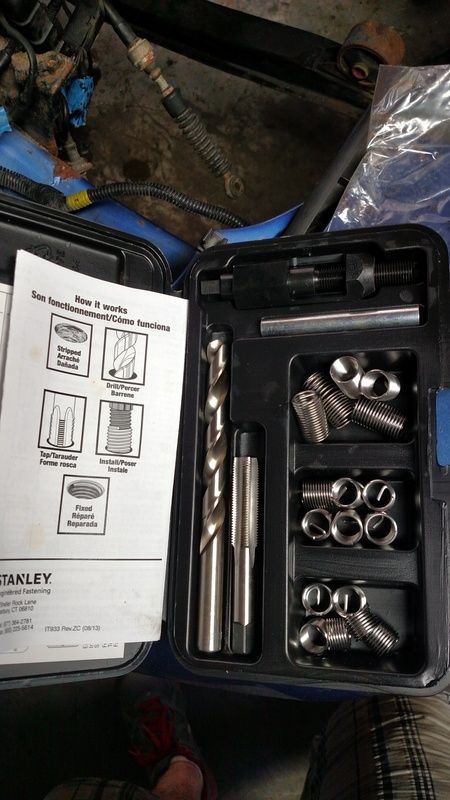

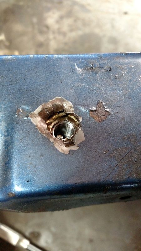

Of course, there are those fun things you encounter. Such as a snapped bolt for the front cross member. After completing the repair, the area was repainted to prevent rusting.
Heli Coil to the rescue:

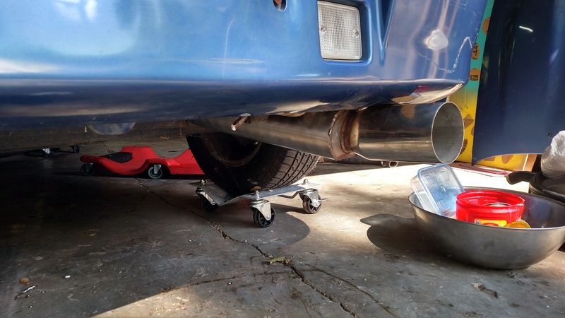

Got the exhaust installed. Impressed with the fitment!

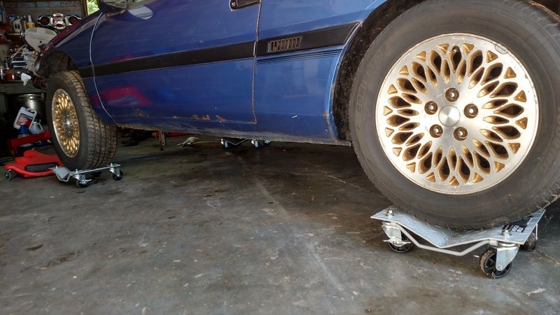

These dollies are the best tool purchase I have made in a while!
