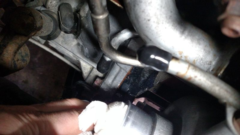

Well, in a quest to find the easiest route to complete tasks, I have come across another revelation that may help others in the future. In a recent turbo swap due to shaft play, I was looking to reduce the amount of work needed to swap it out. Besides being thankful I used nickel-based the last time I had the exhaust components apart, I thought about how I could plug the cooling lines. I have various vacuum plugs at hand and decided to try it out. They worked quite well for blocking the coolant feed and return, reducing the amount of time needed to bump/refill the cooling system. However, if you have not serviced your cooling system in a while, I would suggest flushing it anyway..

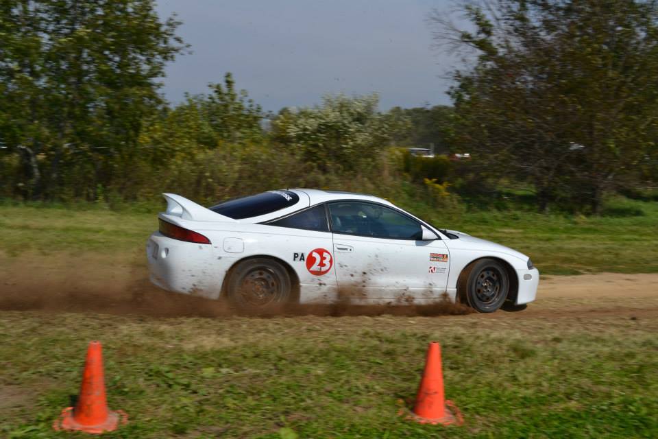

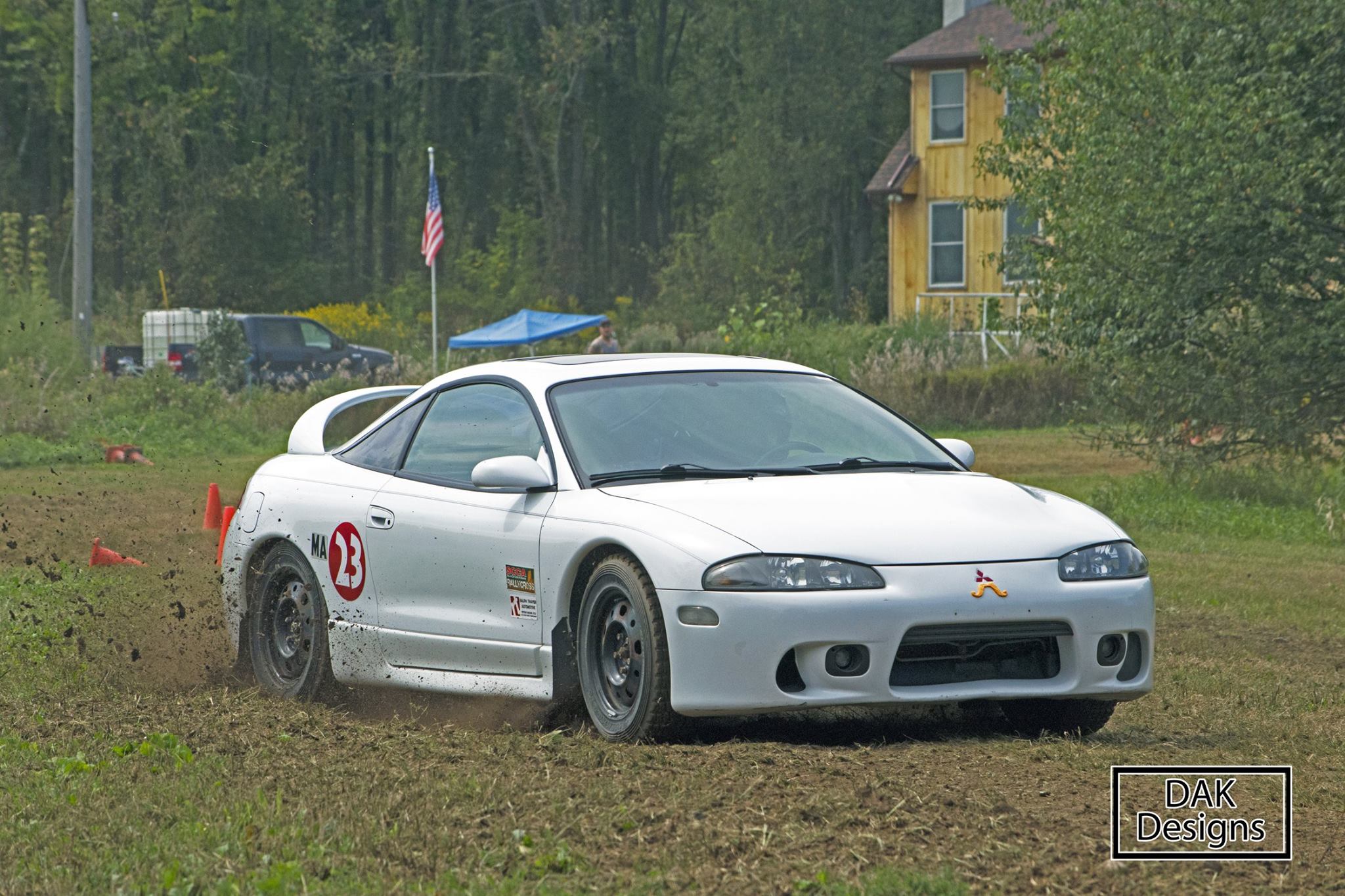

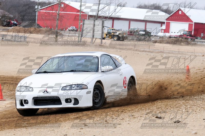

Well, another RallyCross season is in the books. It was a rather competitive season battling with a regular nationals contender (took 2nd at nationals this year). Extremely happy to have really honed my skills this year as I eek myself up the ranks. We managed to snatch 2nd place at the Season Ender RallyCross with the Detroit Region SCCA. As I learn more about the car, I discovered where under-steer occurred during the morning runs. This was at the cost of time, but the course is normally much more open than this event. The course was rather tight, making the power advantage rather useless. Conditions in the morning were very muddy keeping speeds rather low as traction was unpredictable at times. The gravel tires would have been the best choice had the temps been above 50 degrees, leaving winter tires the next best choice. The afternoon was much better suited to the car with much more competitive times and 4 consecutive clean runs. The new skid plate proved a worthwhile expense as it was put to the test with audible reminders were heard in the afternoon in some of the more rutted parts of the course.
For the season, second place overall was secured with three first place and three second place finishes (scored event points only). While not the first place finish I was aiming for, I feel as if this year has been my best as Prepared AWD is a very competitive class. Something that is really holding me back is a tow vehicle. Driving out to the events keeps me from taking more risk as I need to drive the car home.
