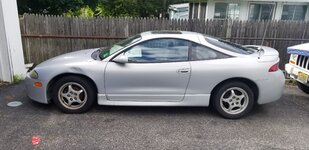

I have a 98 gs hatch and i want to make it a manual need a parts list and general how to go about it. New to front wheel drive tranny conversions so info and tips would be greatly apreciated
