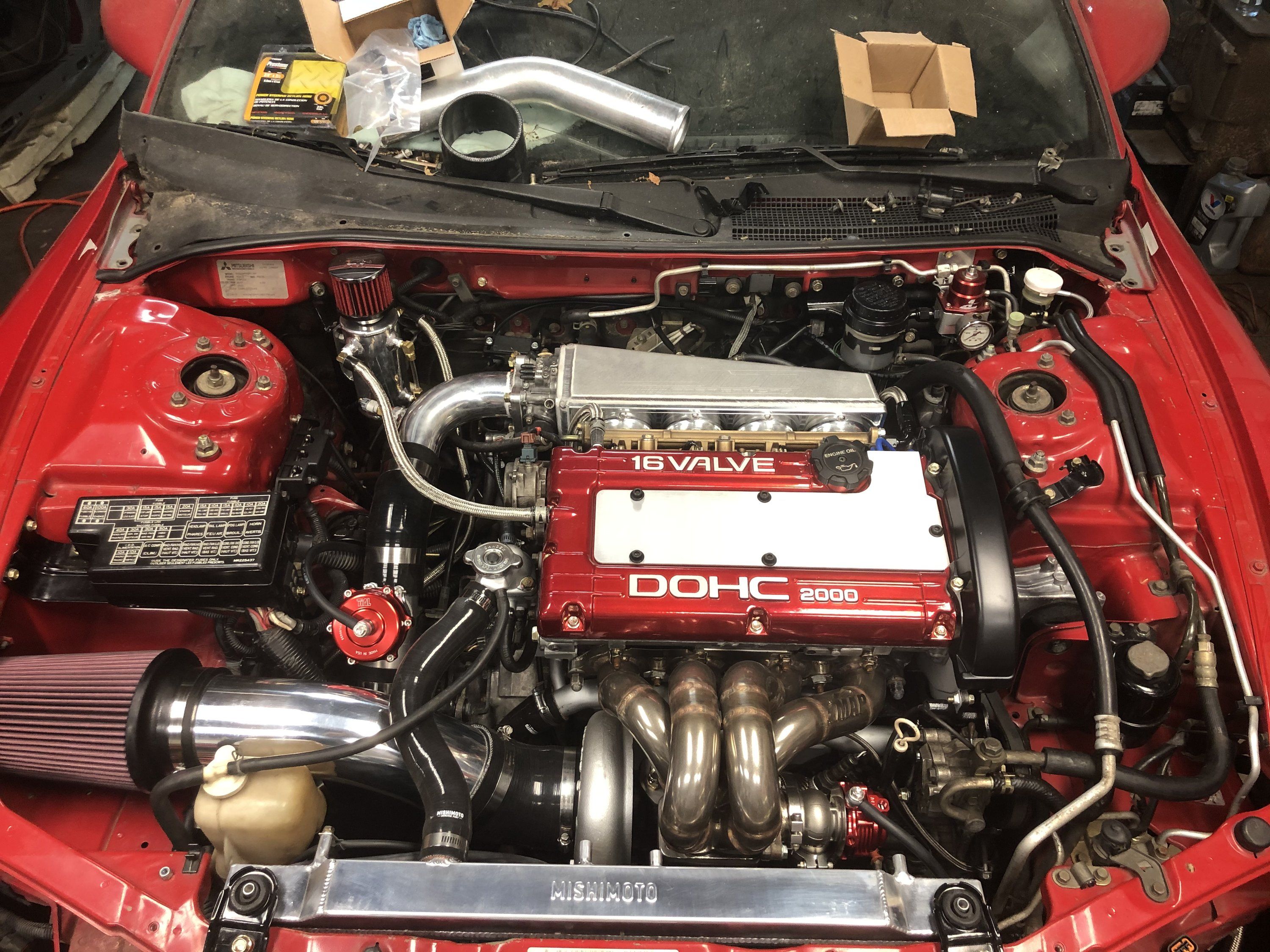

Well quite a bit of mods have been done.
MAP header
Hx35 .70 ar - built by Justin Whitsell
Comp 101200
Manley springs and retainers
3g lifters
Self fabricated down pipe
Jmf intake manifold w/ 1g throttle body
Tial 38mm wastegate and 50mm bov
Aeromotive fpr
FIC 1650s
ACT 2900 w/ street disc & braided line
ACT flywheel
Oem throw out bearing
1990 oil filter housing
B&M oil cooler
Jmf catch can
NGK plug wires
Mishimoto 1g radiator w/ hoses
Mishimoto intercooler
Aem boost, oil pressure, and afr guages
Ecmlink v3 w/ speed density
Battery relocation to trunk
Evo 8 recaros
Evo 9 shift knob
All redline fluids along with many other things I have forgotten. The car will be getting buttoned up in the next week or so, and be going out for some break in miles.
Are you still running active A/C on that setup?
Yes sir I am. I am running a 12 inch puller on the passenger side and a 10 inch pusher on the drivers side. The pusher is of course behind the intercooler facing the condenser. They’re both mishimoto fans.
