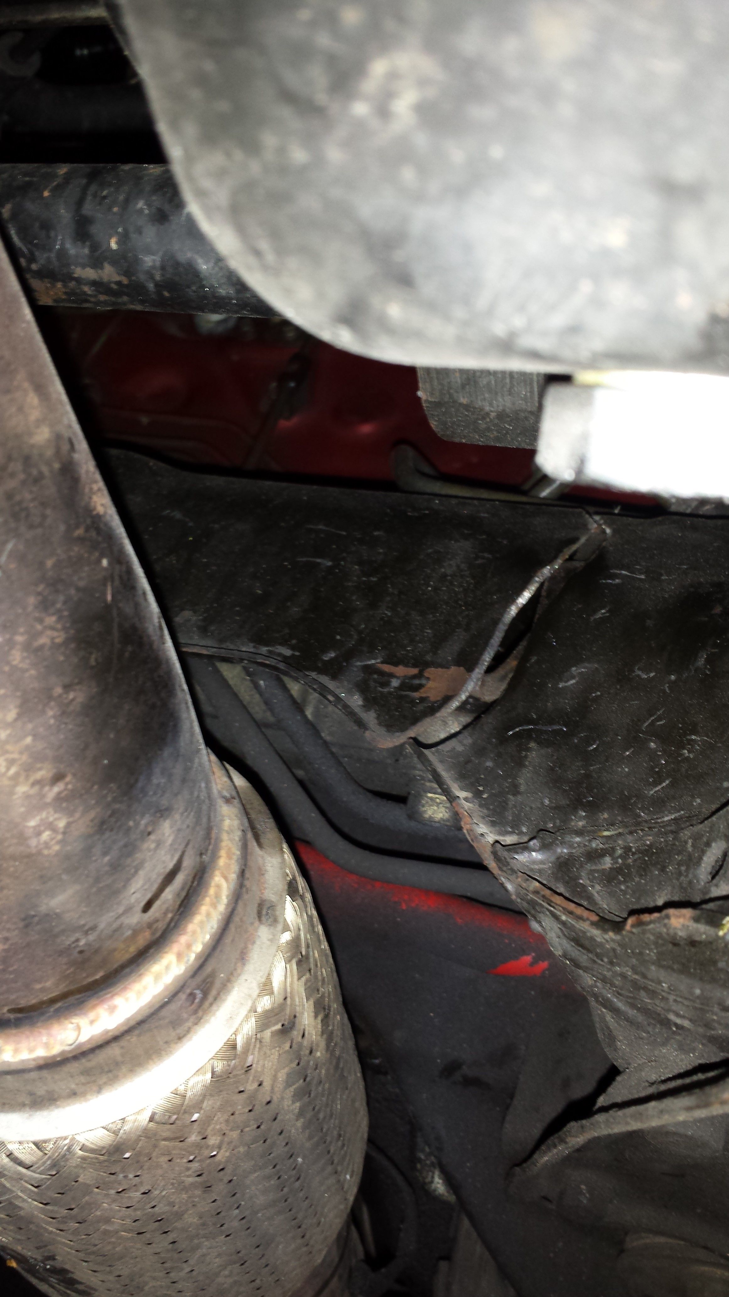

So this picture was taken 5-10 seconds prior to my 2nd gear becoming 2nd Neutral :cry:
Jacks "Stage 5" with Evo 3 input shaft and Evo 3 Gearset, maybe 20 autocross events on it.

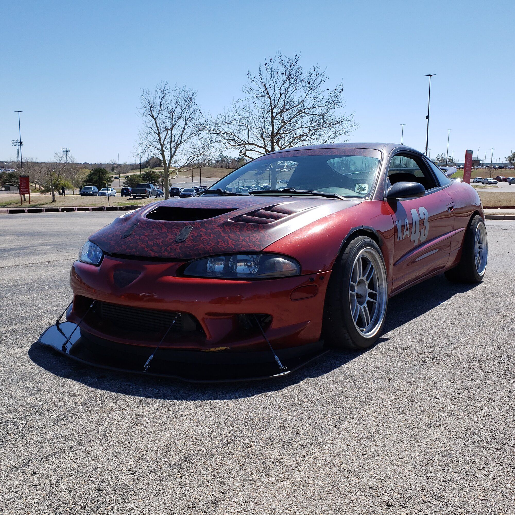

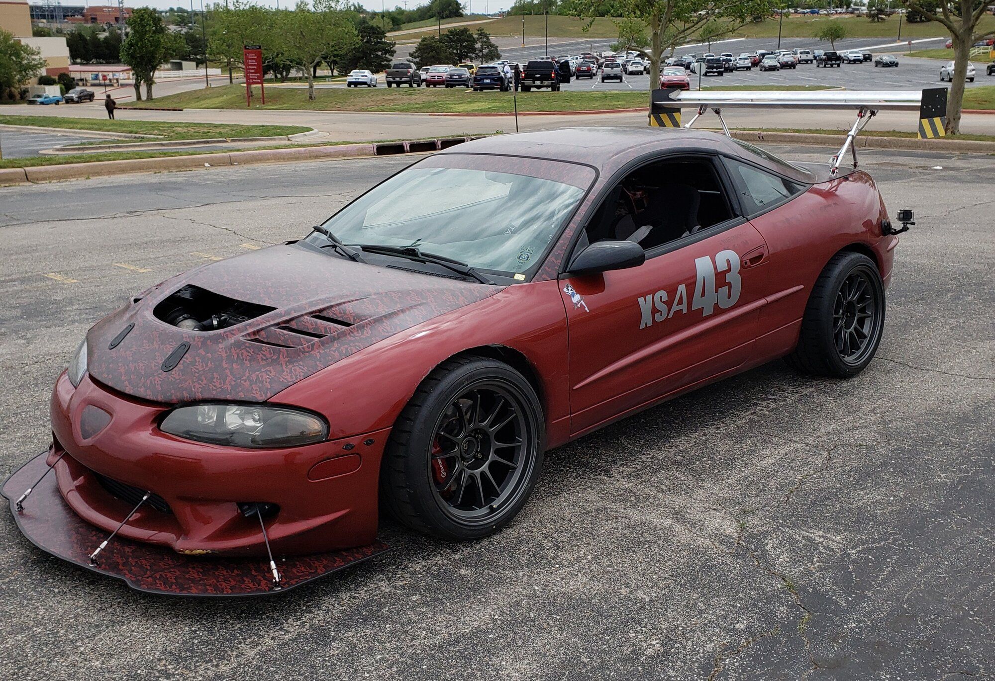

The upgrades for this off-season are aerodynamics. Got the splitter done, now I just need the wing to show up.

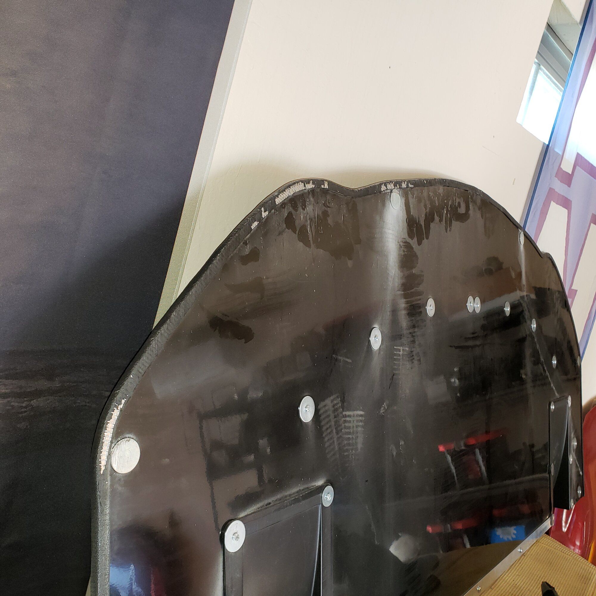

Built the splitter to the limits of the Autocross classes I run (SM or XSA): splitter cannot be wider than the car body and cannot extend further than 6" from the bumper as viewed from above.
Currently it sits 2" from the ground with a -.8 degree angle.
This will be splitter version 1, as I will be able to make it wider when I get around to fender flares.
Picked up the mounts, rods and diffusers from www.professionalawesome.com. Parts look great, great communication and they ship out fast.
The rubber airdam angle & edging were sourced from www.mcmaster.com
The splitter itself is 6mm alumalite purchased from a local sign supply store.

First, splitter looks great. For SM, it says the splitter has to be flat. "Aerodynamically functional vertical members are not allowed". It mentions diffusers or ducting being part of that. Looks like you bolted them on so I guess you could run them in XA and bolt in a plate for SM, maybe? I'm about to re-do my splitter too and checked the rules again and saw that.

When I ordered the diffusers, I was like, maybe I should check the rules, but naaah, so fast so furious. Easy enough to remedy when I start buying real tires again.

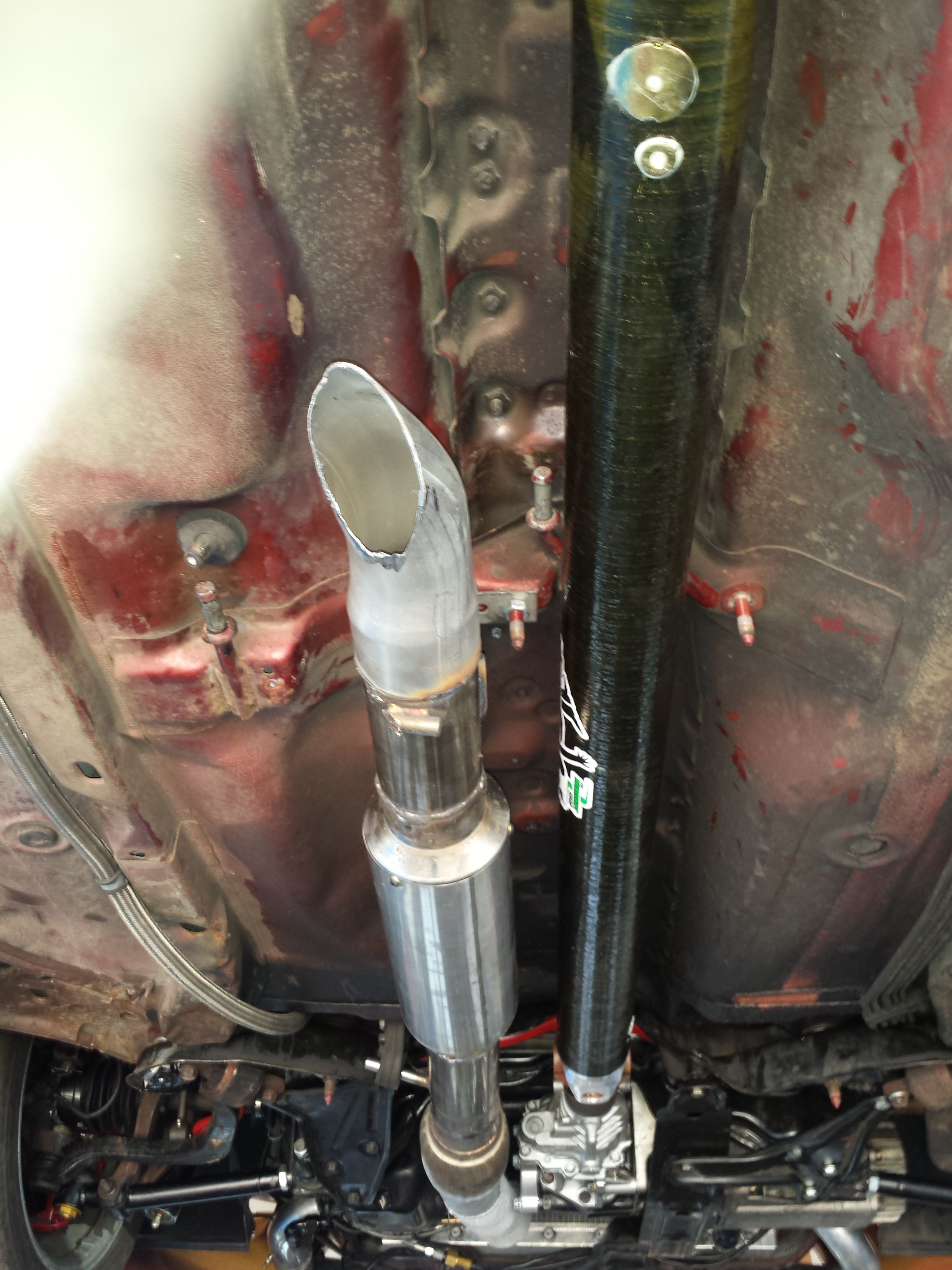

2 piece rotors are also on the wishlist. I want to offset the heavier wheel/tire combo as much as possible. Carbon driveshaft would be nice too

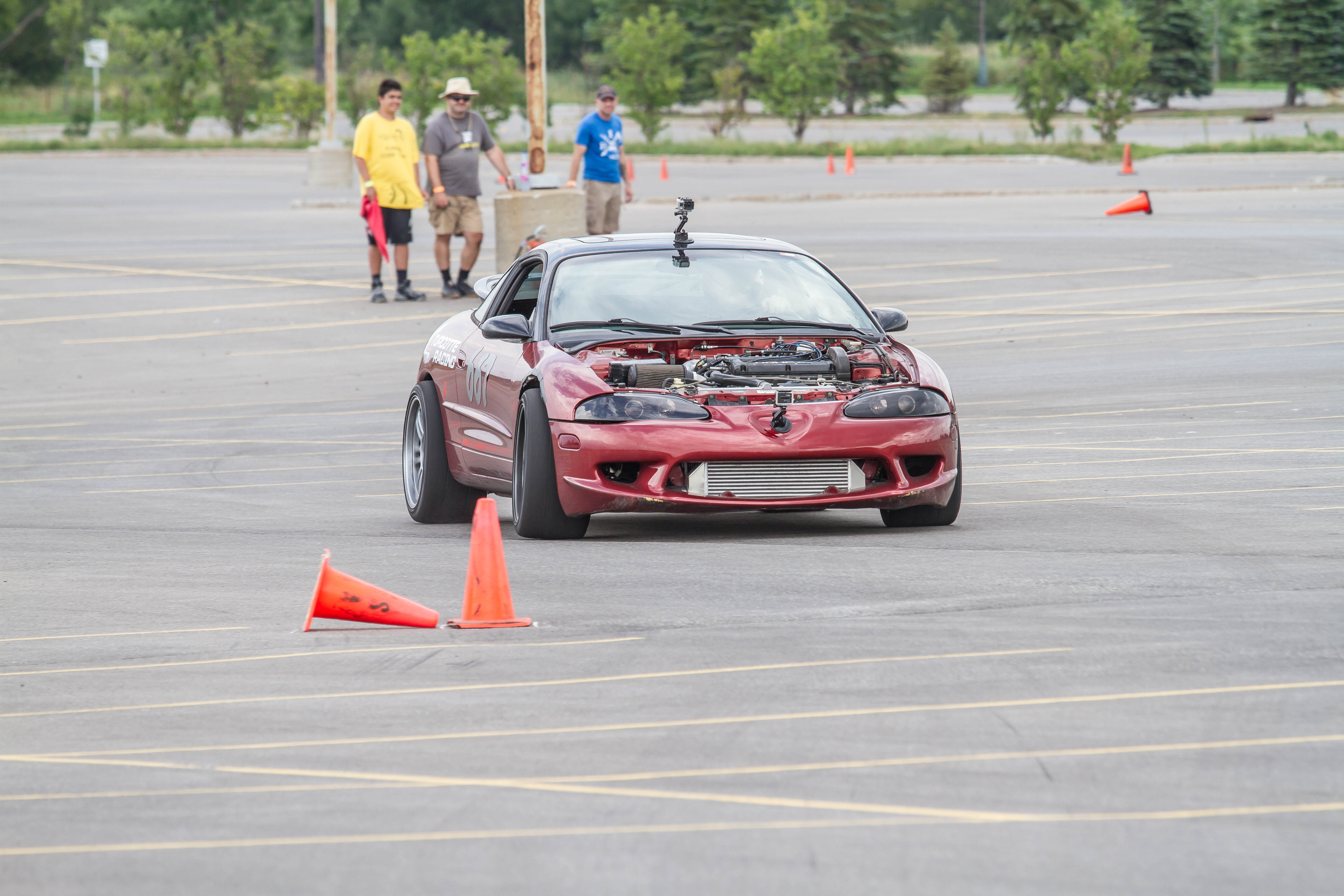

First event of the season in the books, defending my title of cone killer looks to be in jeopardy, currently tied for 19th.
FTD and top PAX time takes away the sting.

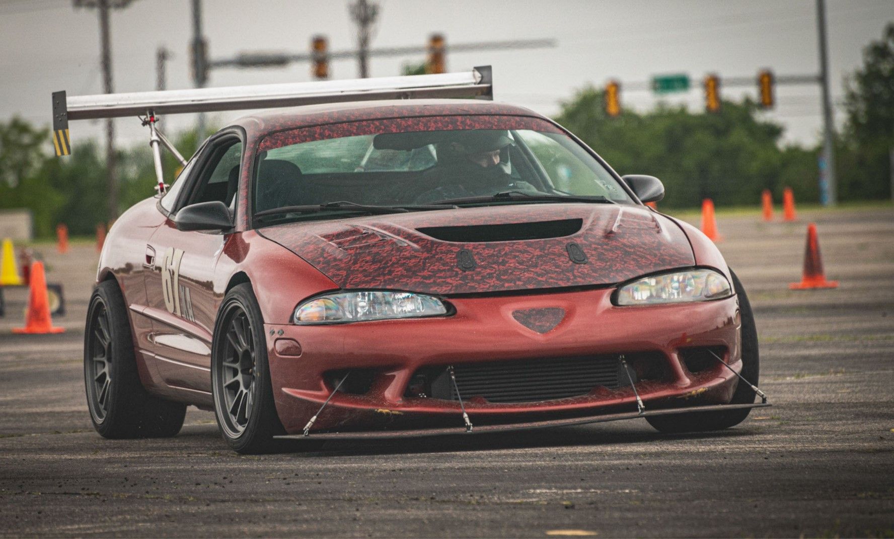

Also, turns out 2" is a bit too low on the splitter.
For the time it was on the car, the butt dyno says it is doing something, namely making the rear end too loose. Big rear wing will fix that.

Raised the splitter half an inch, still not enough. Time to raise it again.

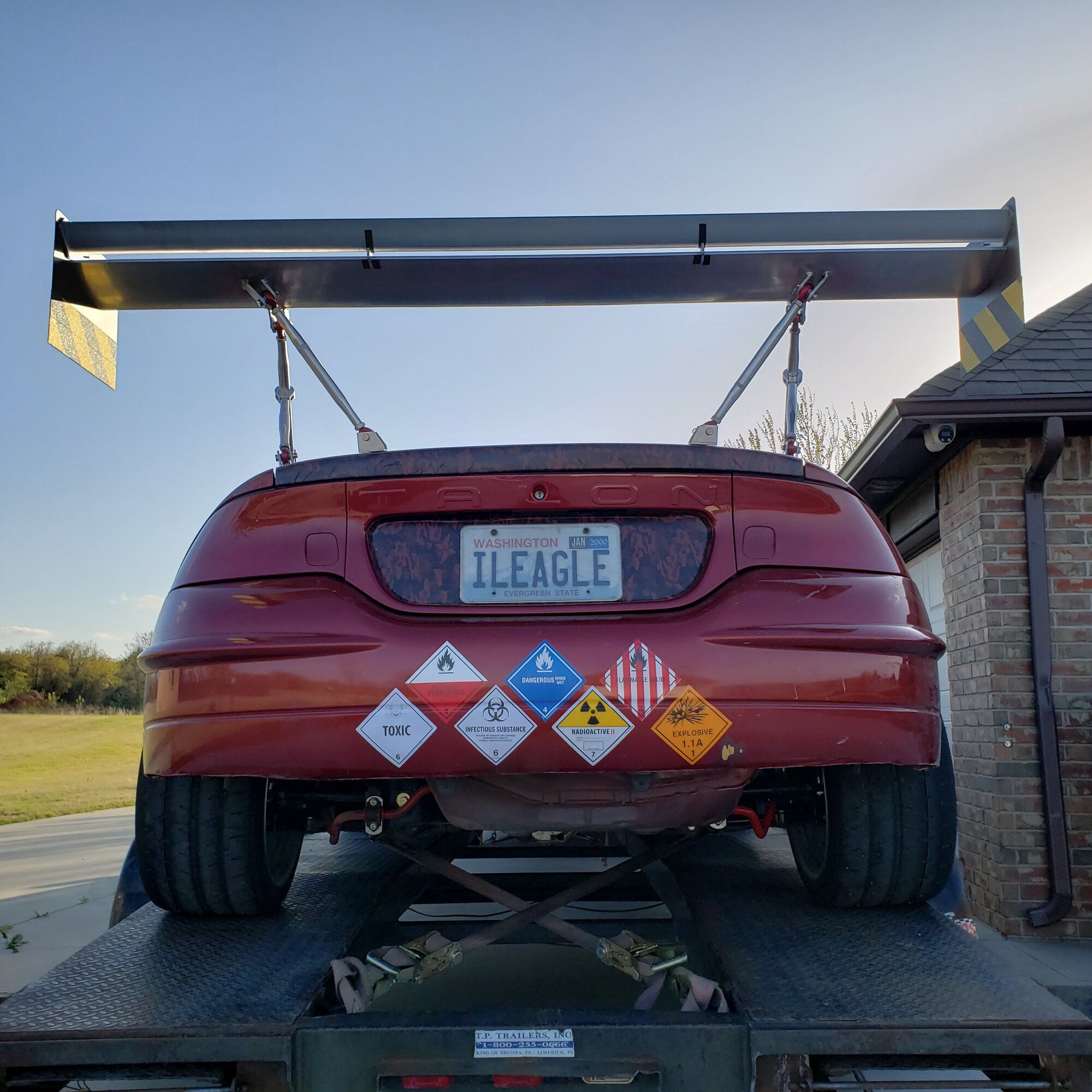

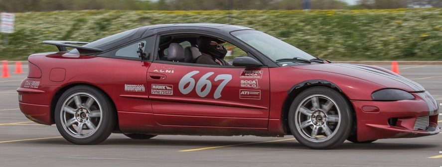

Got the wing installed. I don't think I've seen a similar mounting method. Probably because it is dumb, infinitely adjustable for no reason, LOL.
I think I have some suspension tuning to do with the new aero, car got a little pushy on corner exit. Still good enough for 2nd raw (to an XP Miata) and 5th on Pax.
Also put the spare rear bumper cover on, took a first pass at trimming it to eliminate any parachute effect since I don't run the rear fender liners.
