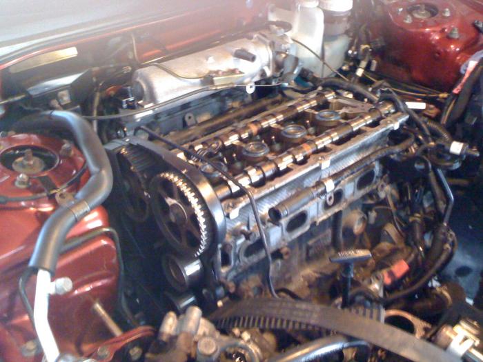

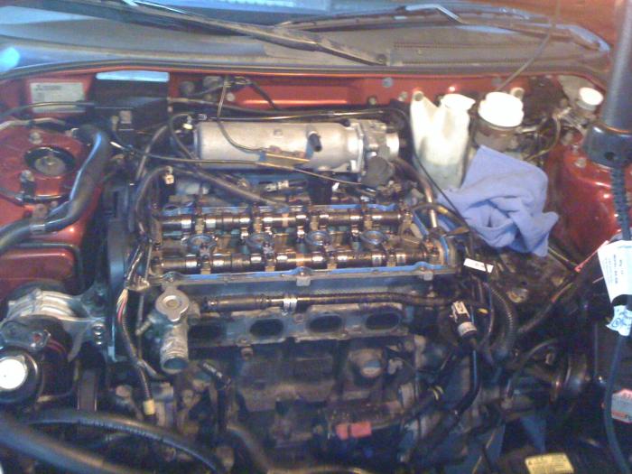

So we bought it and took it for a drive and I knew I had a long road Ahead. I got home and disconnected the battery and started by disconnecting all wiring and I have Labeled them all. removed the valve cover timing belt and,cams.

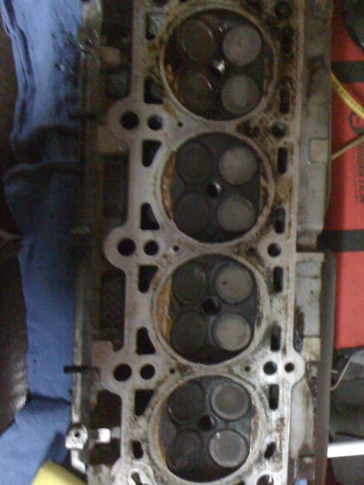

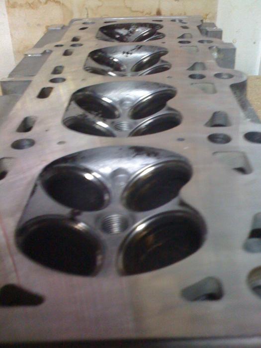

I have taken the cylinder head to a machine shop and had them do a cleaning and surface. I just ordered Manley Springs and, TI retainers. that is where I am currently at.

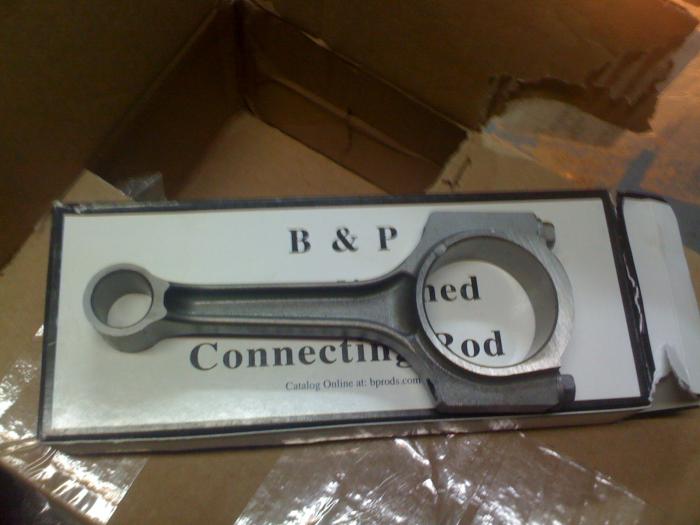

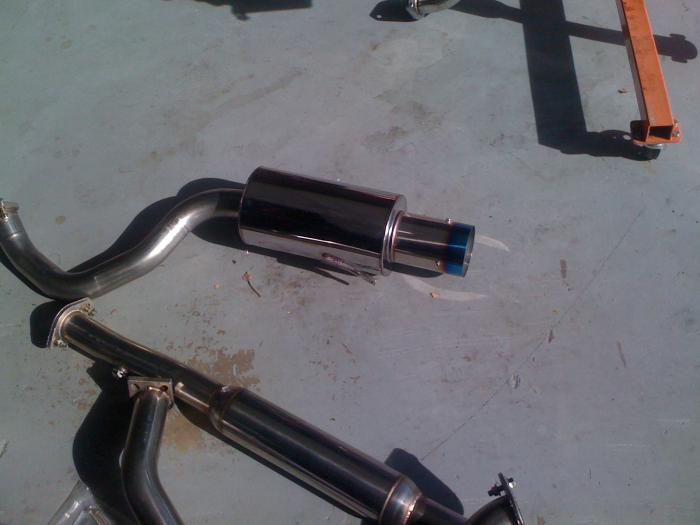

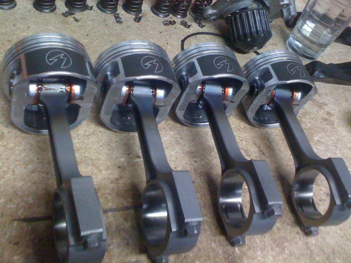

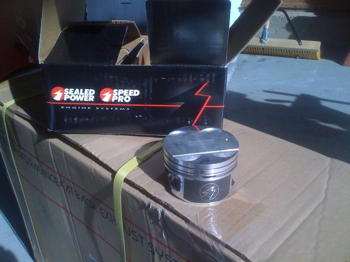

It's Been a while since I had posted any progress on the build of "curley" (the wife made me name the car) since my last post I have changed things up a bit. instead of forged internals I went with hypereutectic pistons and Re-manufactured rods. OEM rods are made of "powder metals" = not strong I did the reman's are made of cast iron. anyhow did this to save a few bucks for boost and amongst other mods I would like to make. I also ordered A Spec D tuning Cat back exhaust for $116.00<--very nice Cat back system for the price.) a new high flow cat. as well as Meagan Racing Headers (I know what you're thinking) I did this so I can start the car and drive it until I can have all of the turbo application parts installed. which I do not have. I was told that the Sealed power Piston is a 10:2 CR piston (i will see about that) will have a CR test done to see if this is true. I also ran into some trouble with DSM GY on shipping and wrong parts being shipped that was a major month of ClusterF***s. For those that are interested I will have the car running next week and will post a video of the first start stay tuned.:thumb:
Getting close just a few more things to do right on schedule :hellyeah:
Best of luck, but this right here is a recipe for disaster.... If anything at all, internals are the last thing you want to cheap out on... also, may just be the way that picture looks, but that one rod looks kind of bent.
Yeah the old OEM Rod was bent. Hydrolock the previous owner of the car drove it into a fat puddle with cold air intake. The new rods are not bent. As far as the Exhaust goes if you type in Nitrokid98 on you tube, he reviewed the exhaust and his review helped me alot on the decsion. I hope the rods will hold up. I guess we will see... PM me if you want the info of where I got the exhaust from.
Hypereutectic Pistons are by far an upgrade over cast. and if you run forged where i live with out an engine heater that could be disastrous. the reason for going with a re manufactured rod is that the pistons are not full floating. so I had to run this rod otherwise I would have ran an eagle. I do Understand where you are coming from though.
