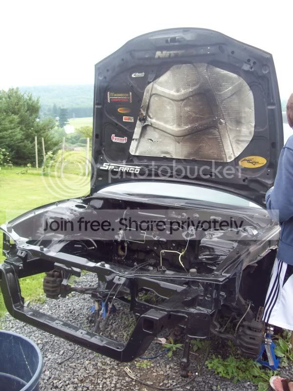

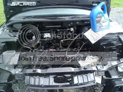

I got the bay painted with a hood mod, still need to get hydraulic struts:

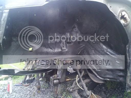

Fender wells undercoated:

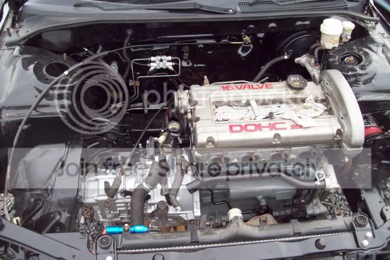

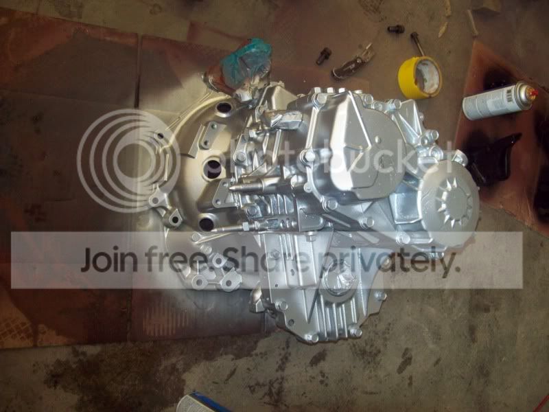

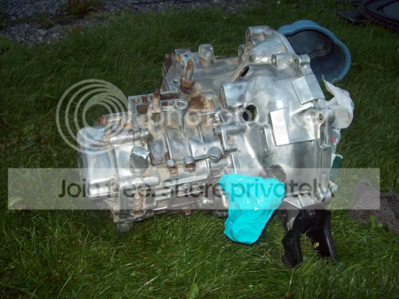

Cleaned the transmission with a wire wheel then painted:

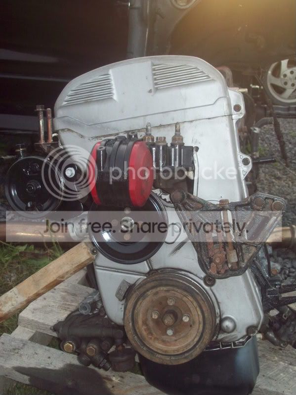

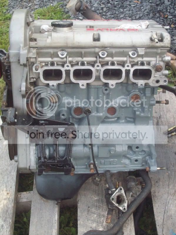

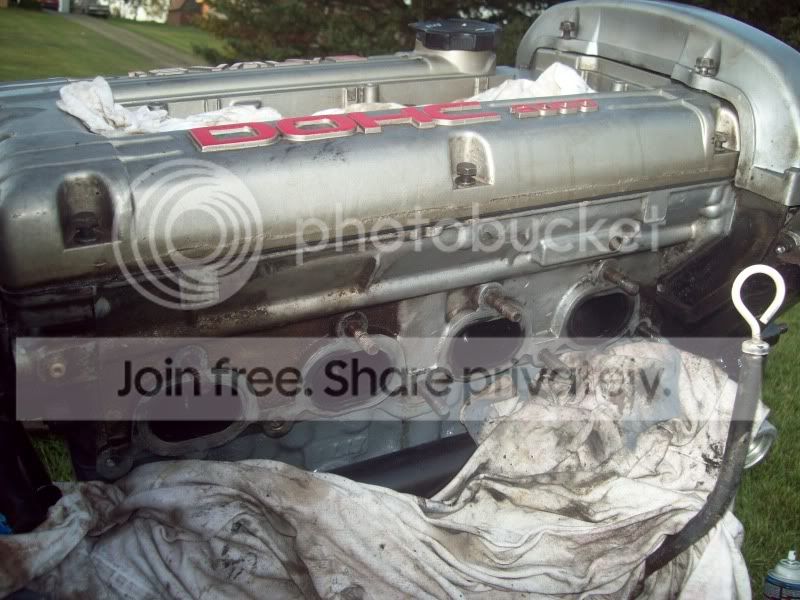

Motor cleaned up, all the regular grime all motors have was cleaned up really good, block was painted also.
You can see the difference between before and after in this pic:
Motor and trans installed:

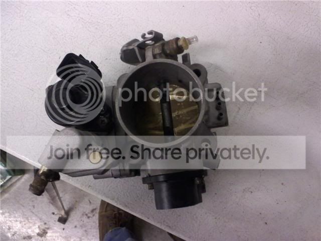

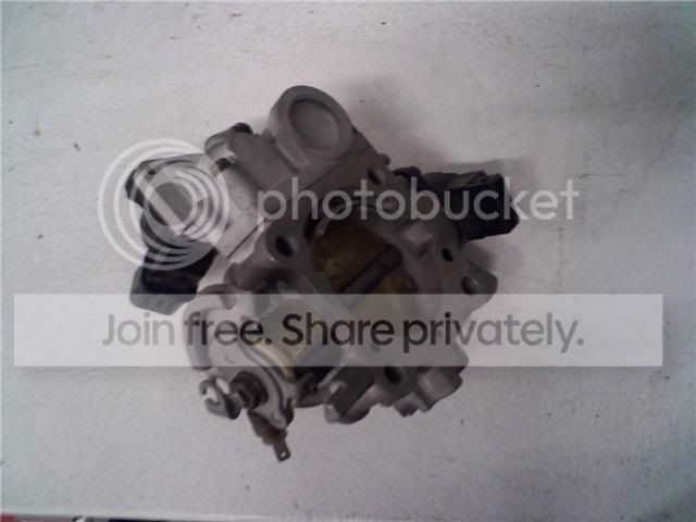

Picked up a NT TB and sandblasted and rebuilt it with MilSpec seals:

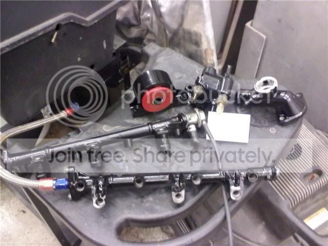

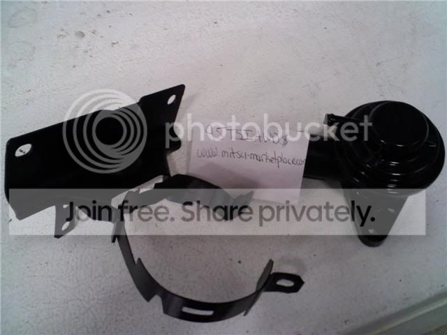

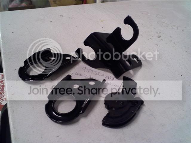

Picked up a powdercoating gun and started going to town on parts:

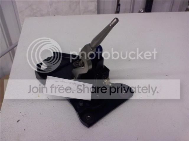

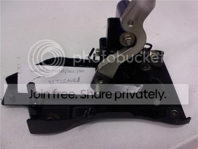

Coated the shifter assembly with my B&M short throw:

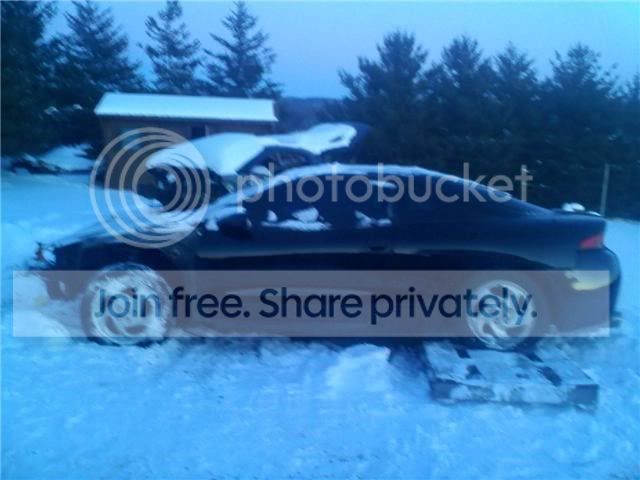

I finally got the car off the ground after it had fallen off the jackstands. 6 months later and it is finally back on all 4 flat tires LOL. Should be taking it out to my friends garage to store this week where I'll continue to do the rest of the work in a heated garage :)

Very clean! Was all the painting of the engine bay and undercoat on the fender wells done by you?
I like that tranny clean up. Any prep work before paint?
Did you just wire wheel it and throw paint on it?

Yes I painted the bay and did the fender wells, took a lot of work but it was worth it. I ended up using spray paint because I don't have an air compressor but it may get repainted with good paint in a few months. The fender wells is just some 3M undercoating, the biggest problem was removing all the tar/grease/grime in the wells before painting.
I just used a wire wheel, brash brushes and simple green for the transmission. It cleaned up pretty good. It's just 2 coat primer, 3 coat paint, 2 coat clear.
