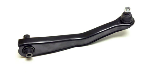

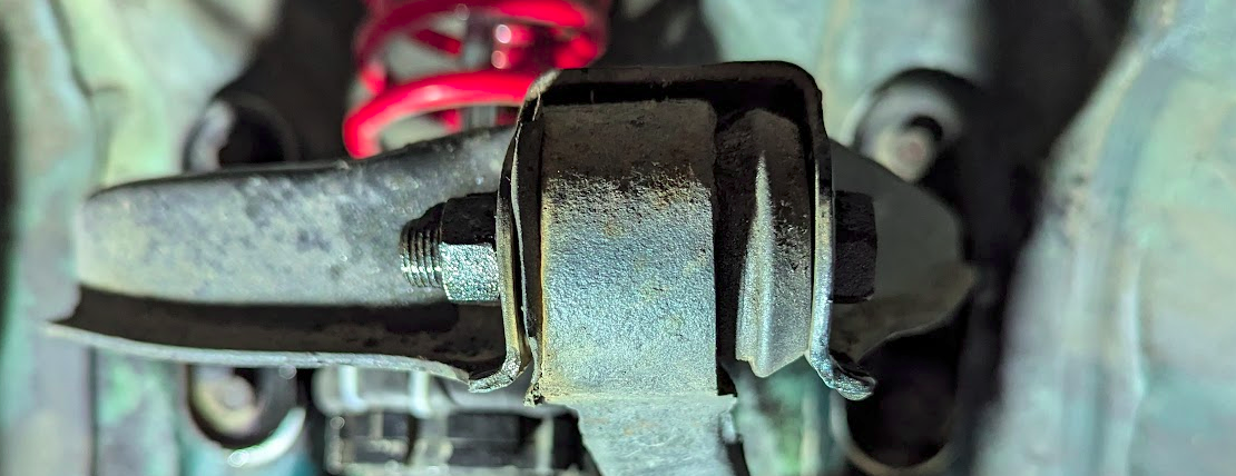

At the time I didn't knew it, but the car had energy bushings on the back
And they were done done, they made a horrible noise on all bumps, so I bought a new kit and installed all bushings on the rear, I thought the kit was going to include ALL bushings but some are missing, for example

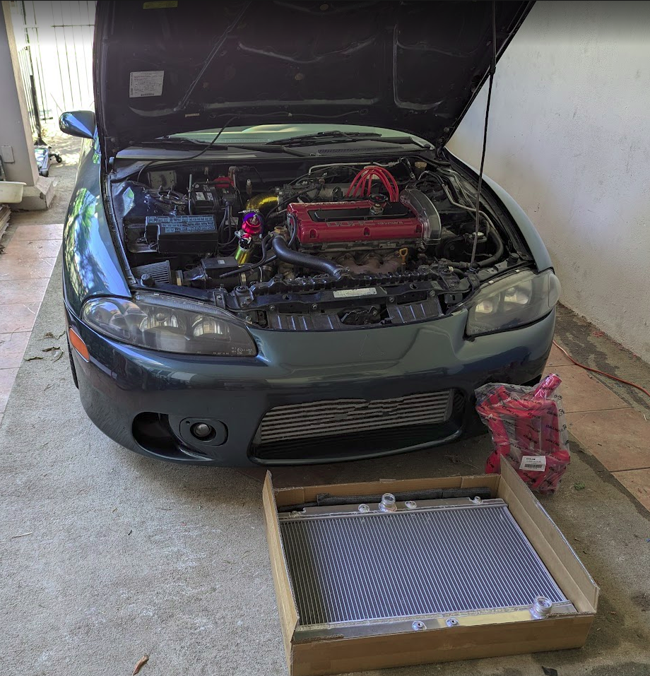

Alongside that, I also bought the silicone radiator hoses and an aluminum radiator
And that was like the preparation for a small track event, I also wanted to upgrade brakes but the parts didn't arrive on time.

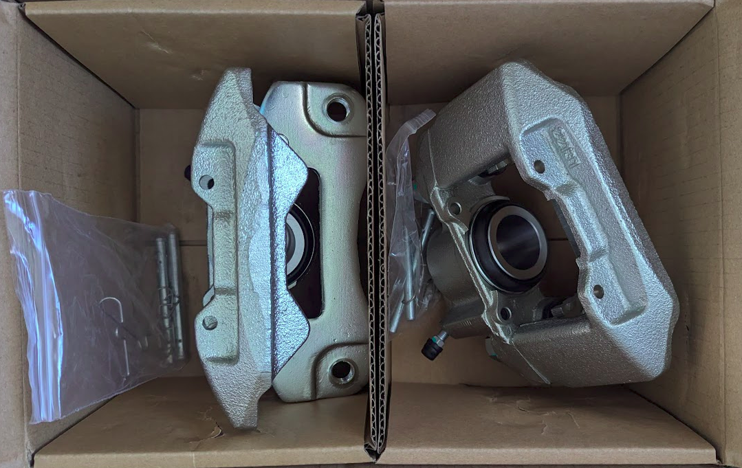

When doing that I started loosening the front bleed ports, and when I was at the last one at the back, it broke. And i did the dumbest thing after that, trying to take it off using an extractor. It didn't work and I weaken the bleed port. So thanks to that I ruined a rear caliper, and I wasn't feeling as replacing just one. So I thought of changing for another set of rear calipers since I was going to do the same on the front.

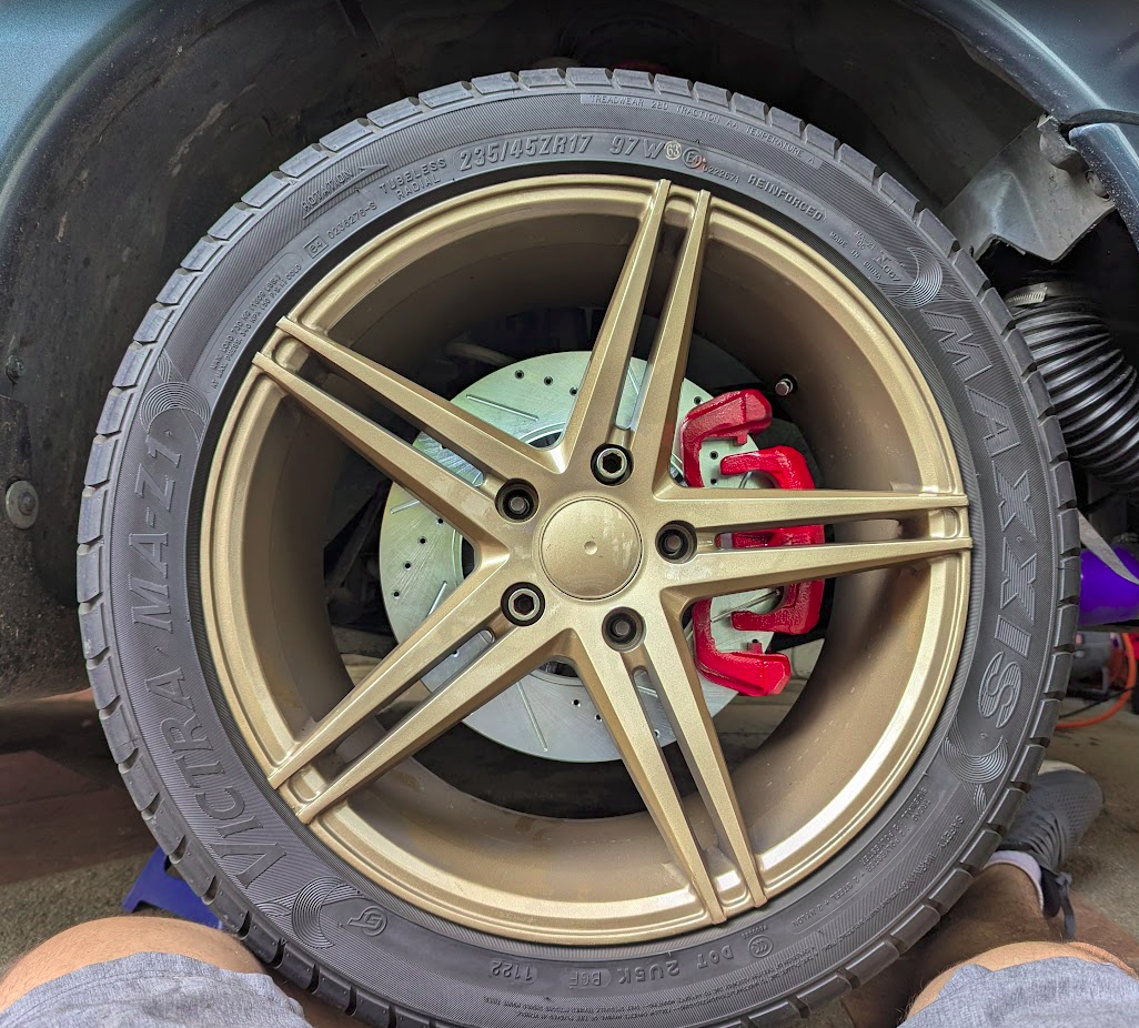

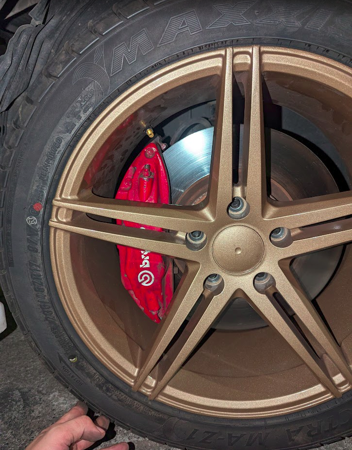

On the front I'll be putting the 05 outlander double piston set. In here I was making sure it didn't hit the rims
Previously I was going to put the VR4 front 4 piston brakes from a friend, but that was hitting with my rims and I can't put a spacers since the fitment is already on point.
I also tried with some evo brakes my friend has and that also didn't work.

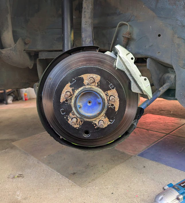

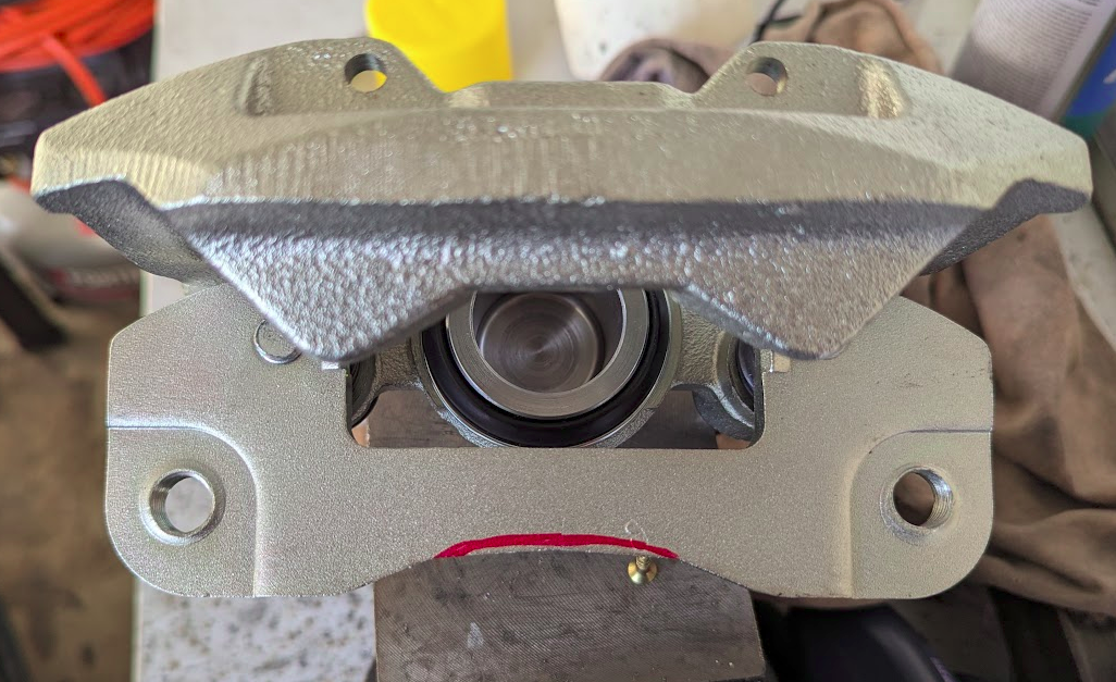

So on the rear I started looking for mitsubishi models and I came across the montero rear brakes. I think some new models are also using those ones.
As far as I know no one has put those brakes on a DSM, and later I found why
The very first thing you have to modify is the bolt size, it goes up from 12 to 14 (or 10 to 12 I don't remember but it goes up a size)
And in here I was testing how it looked
In there I realized I had to trim down a little bit this piece

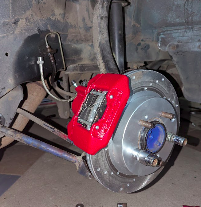

And later found a lot of things I had to do to make it work, from fabricating custom lines to modify a lot the bases, I thought of doing a write up on how to do it, but I don't think it's worth the hassle
In here you can see the brakes with a set of VR4 rear rotors
