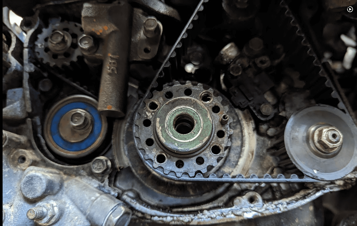

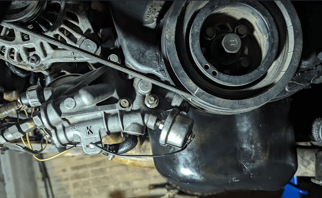

The timing components were pretty dirty, this is a picture after cleaning it 4 times with degreaser

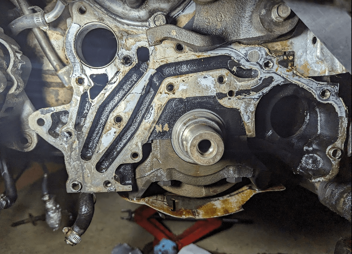

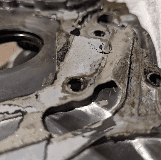

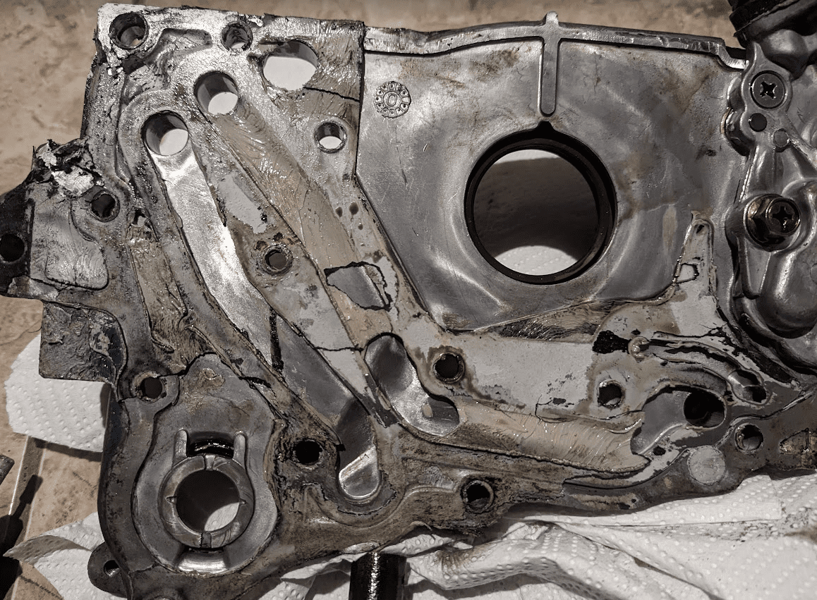

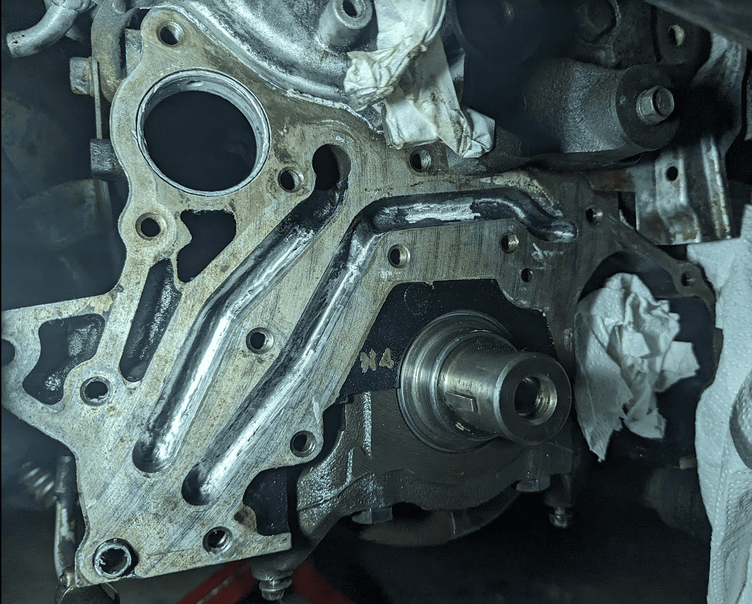

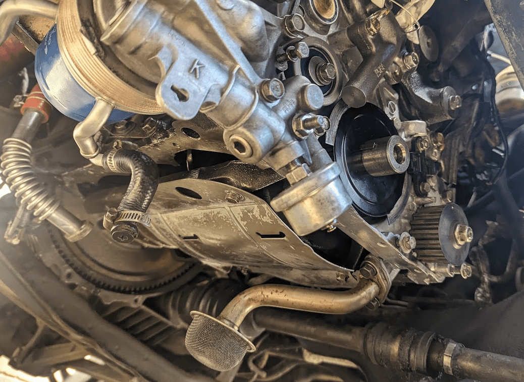

After removing the oil pump the situation was not that better, previous mechanic used a lot of silicone
Since the balance shafts were starting to freeze I decided to do a balance shaft delete, and also with the oil galleries exposed I decided to smooth some surfaces. I don't have pictures on how I masked everything, but I tried to make sure nothing entered in the oil galleries, that's why I didn't touch the surfaces near to it (they were covered)

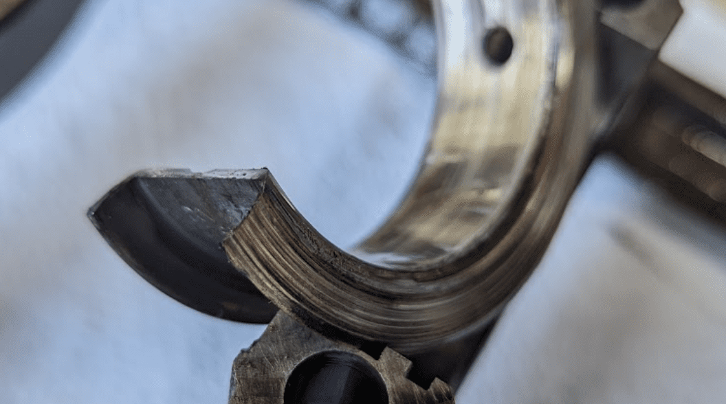

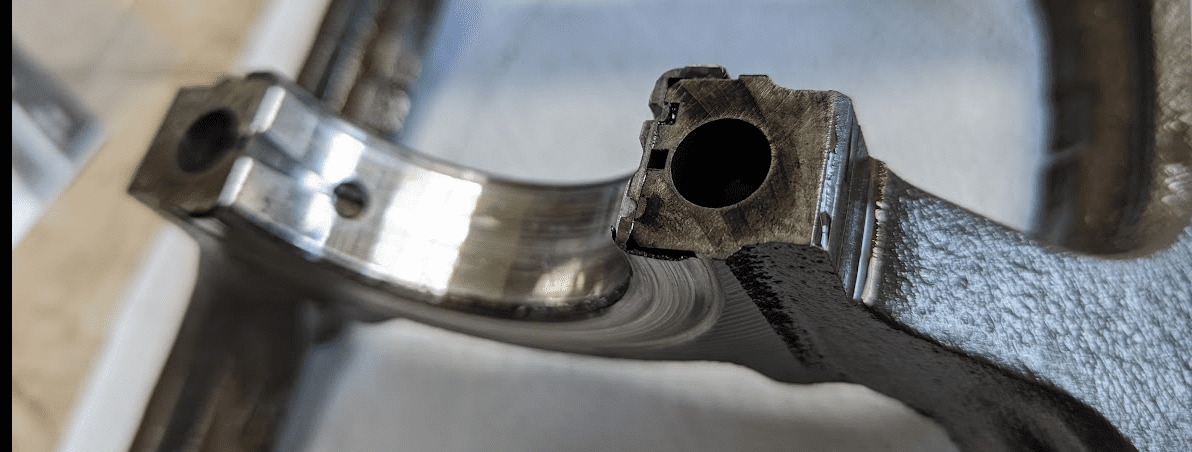

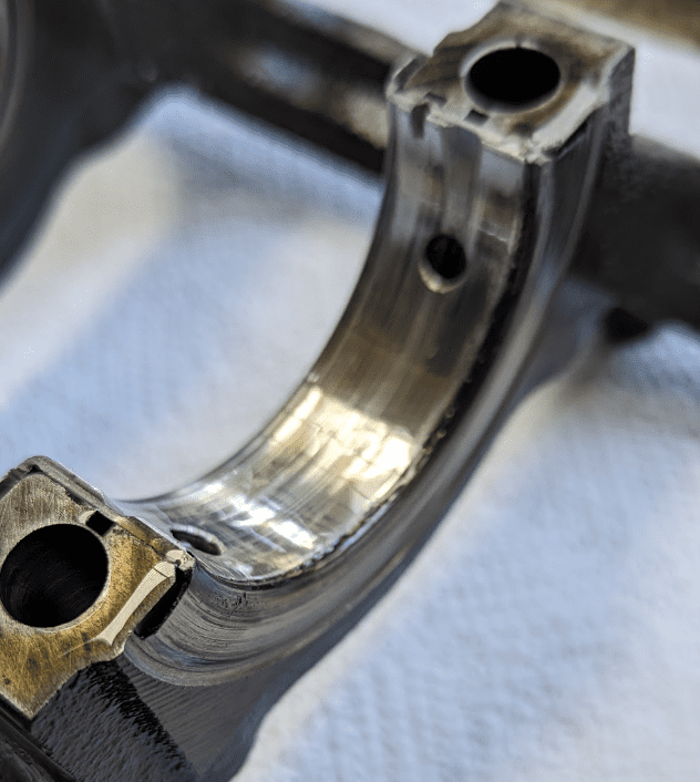

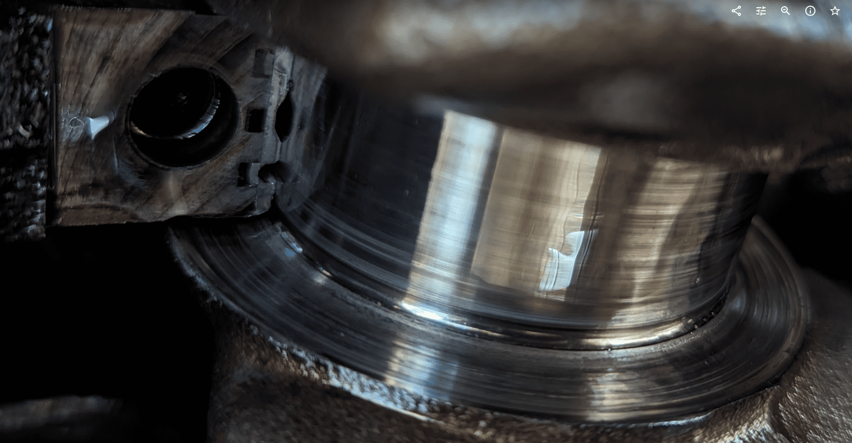

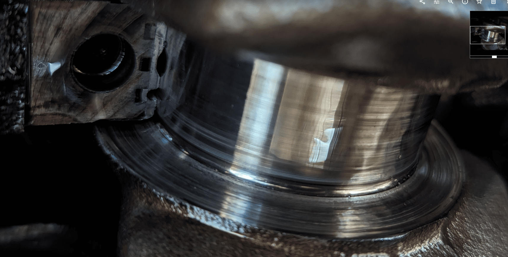

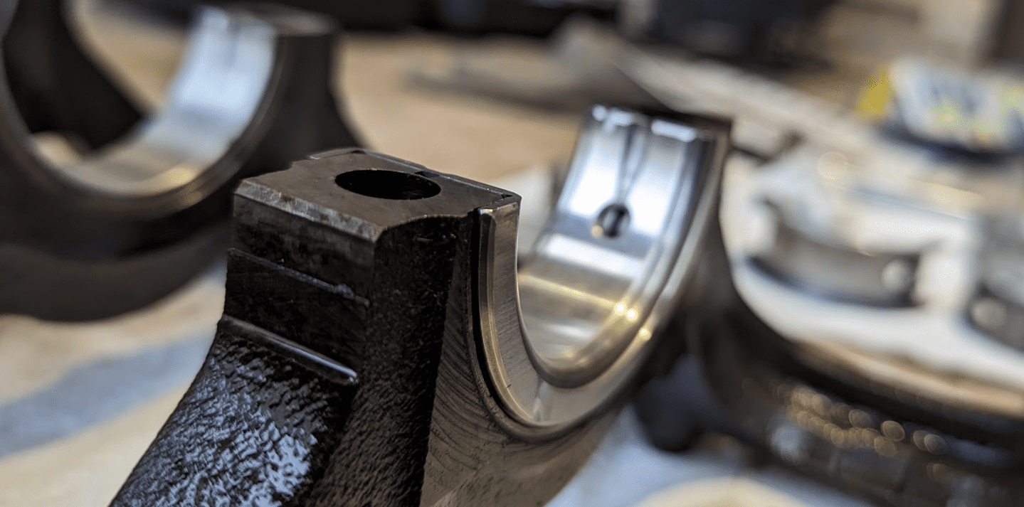

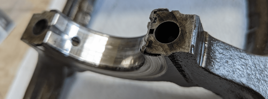

At that moment is when I took the crankwalk video, and I decided to change the main bearings (I know it won't last long)
The new bearings:

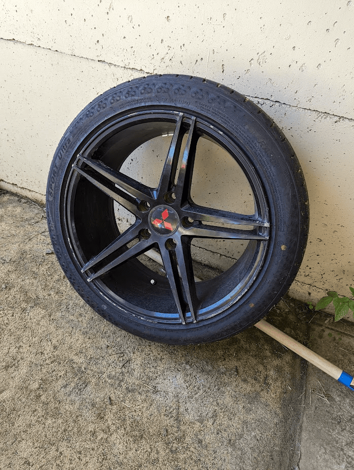

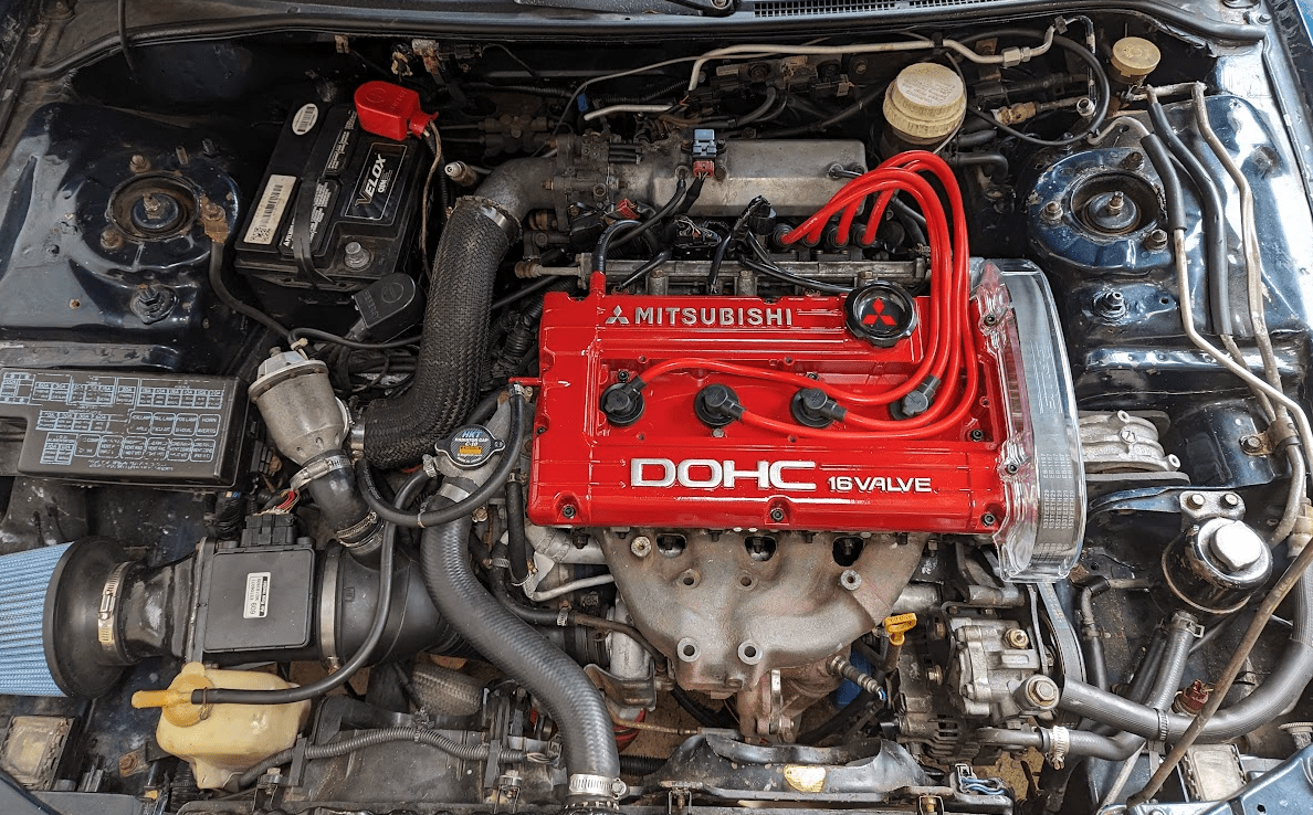

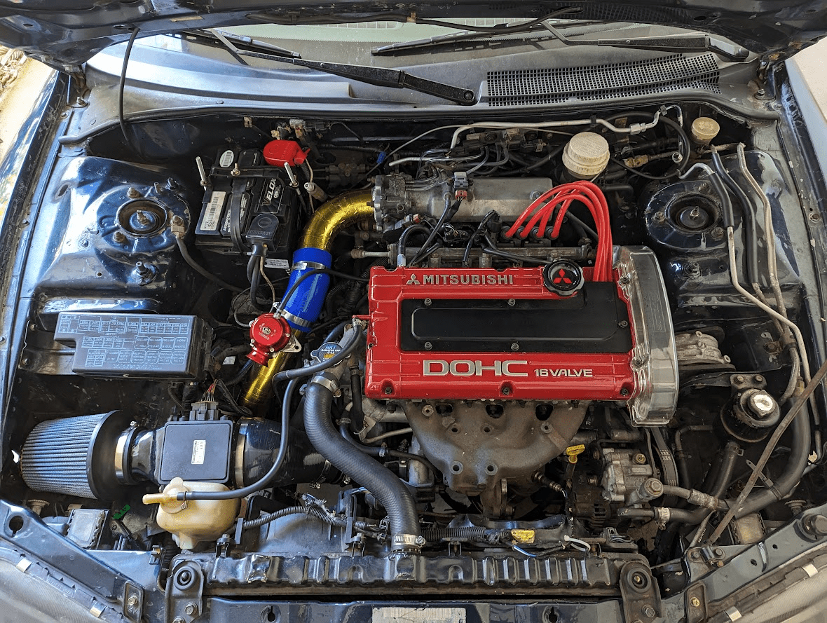

Now with the car running I bought the wheel center caps and added a mitsubishi logo

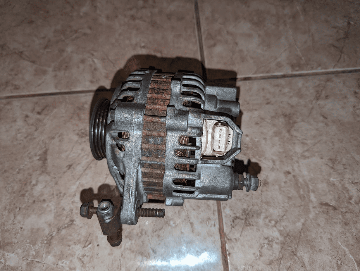

During this time the alternator stopped working, and I had the luck on finding one used at a good price

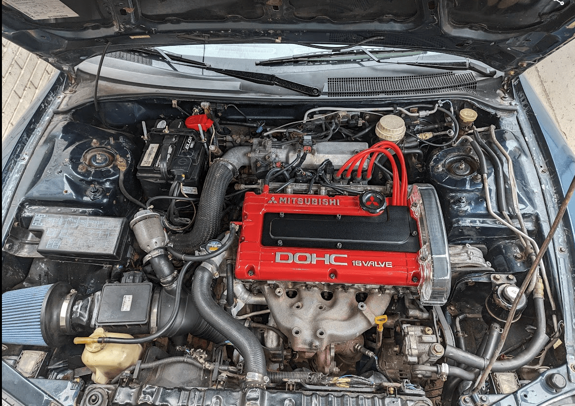

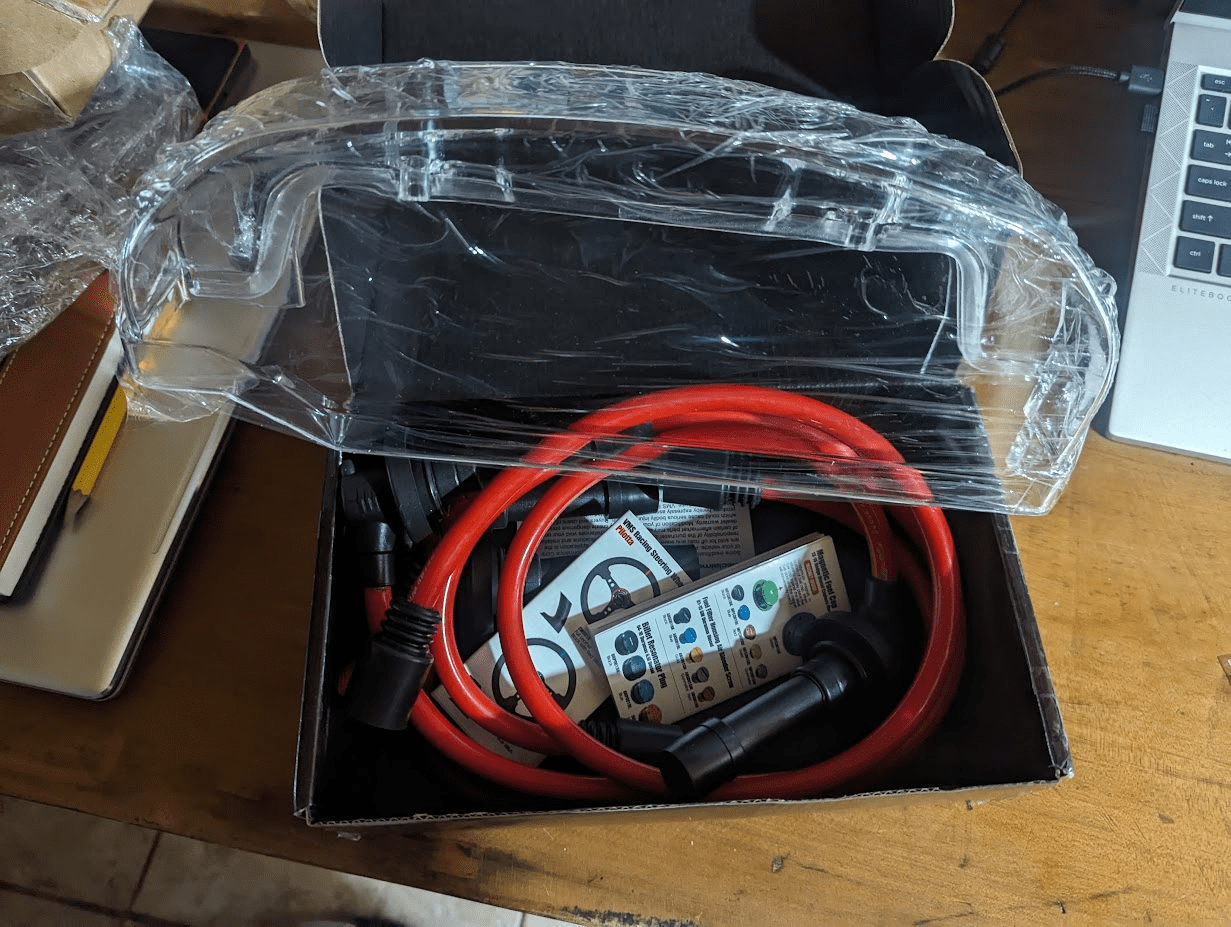

I also bought new spark plug wires, since the old ones were in rough shape, and the timing belt cover

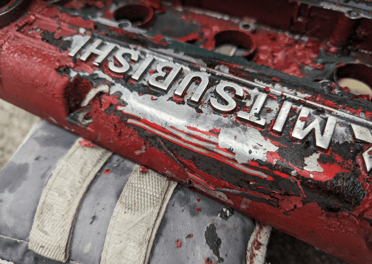

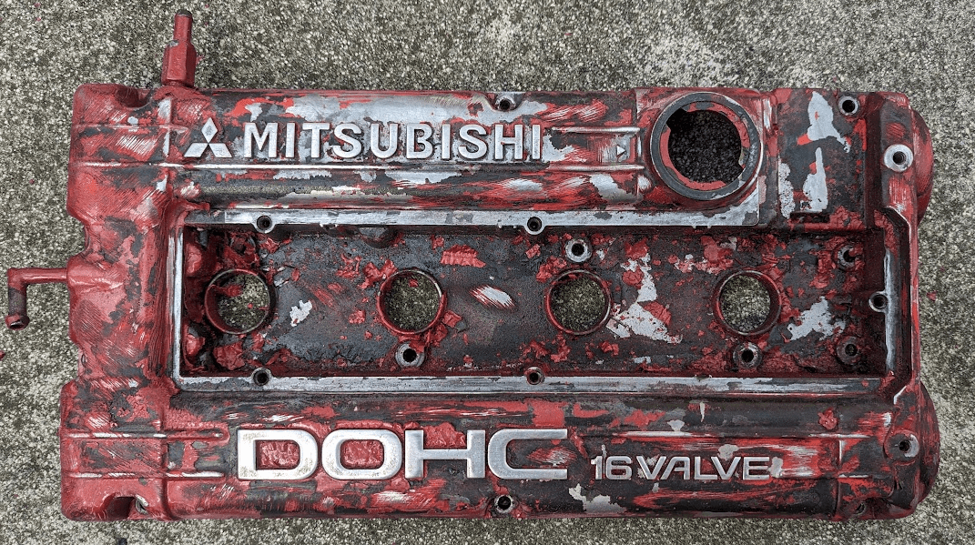

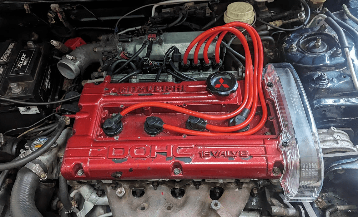

After that I decided to paint the valve cover
It had 3 different paint colors
And this is the end result

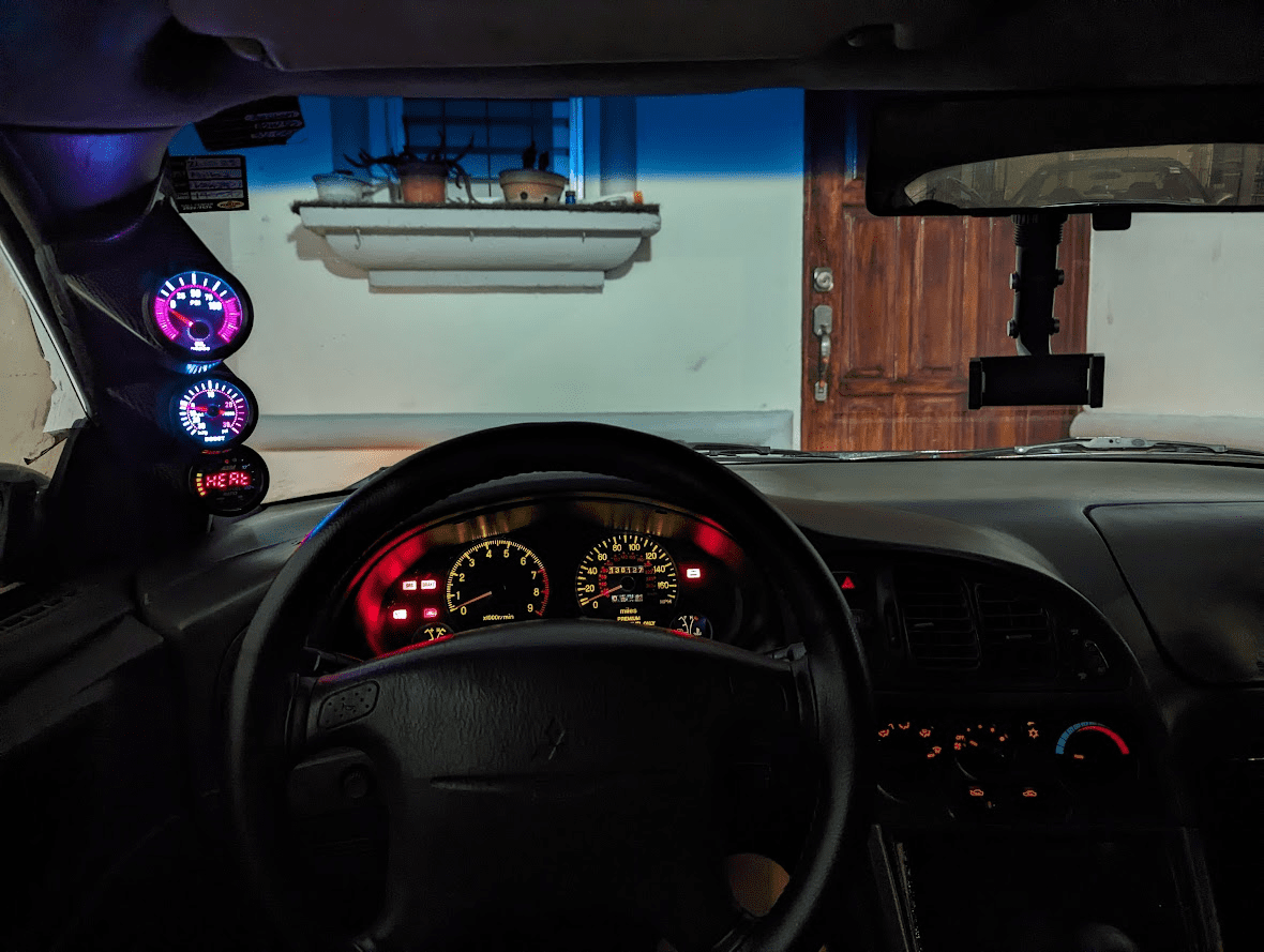

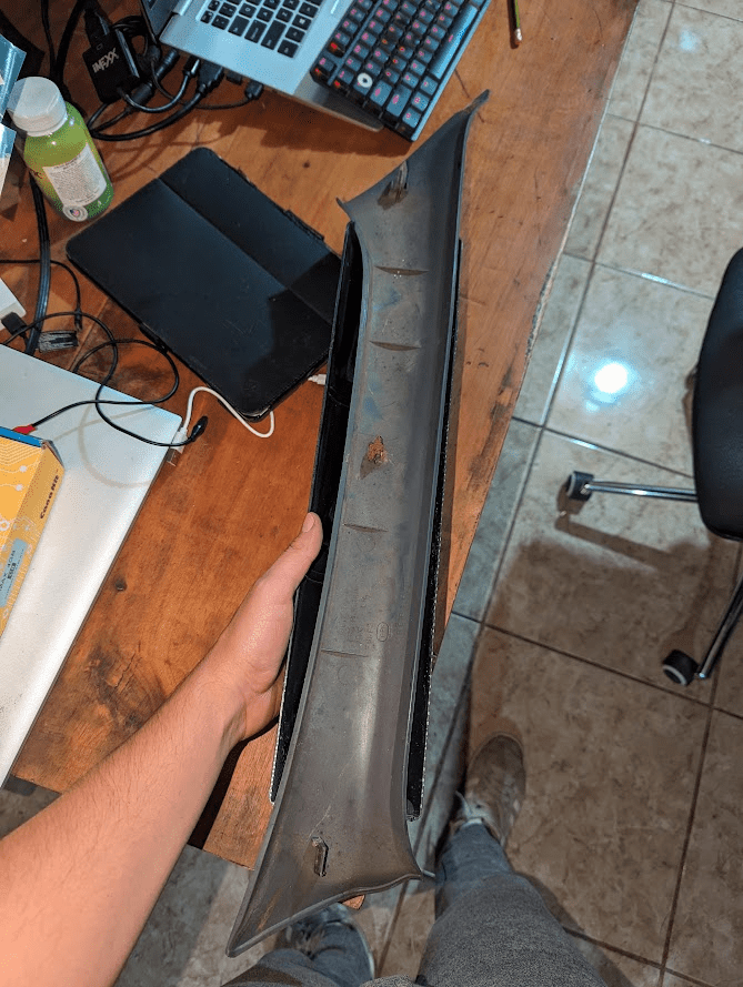

After that I bought a cheap triple pillar gauge that was supposedly for the eclipse
Let's say that at the moment I also bought color matching boost and oil pressure gauges. After a lot of trimming and test-fitting the part, it fit ok enough.
And now the interior is looking way better than before.

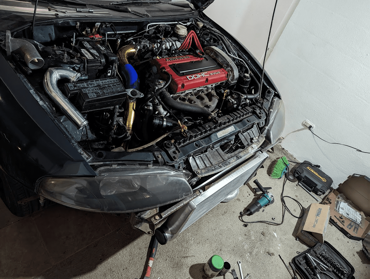

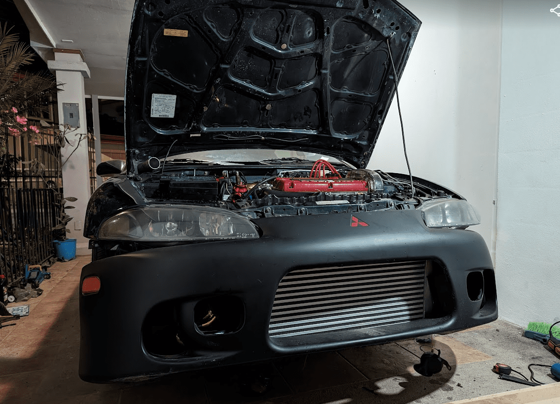

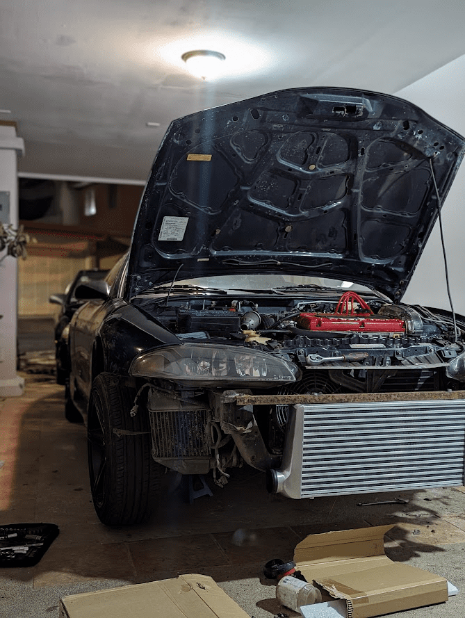

The most recent upgrade was the FMIC
First I tried centering it
After that I routed the pipes

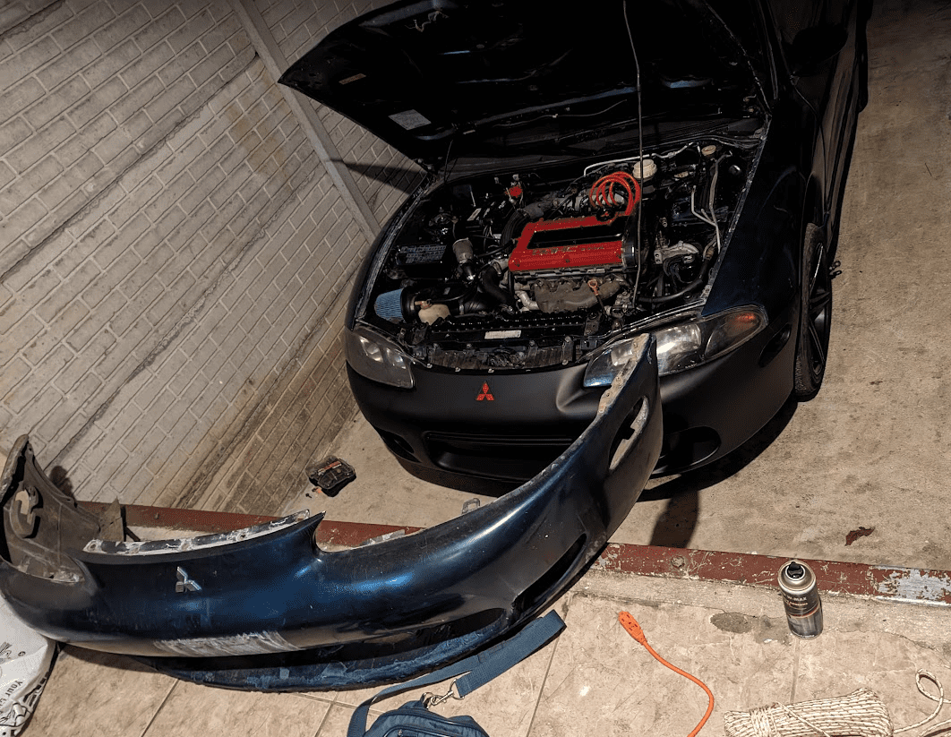

Test-fitting and trimming the front bumper

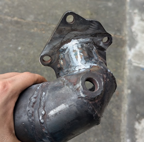

*I also took the opportunity to take a photo of the subaru style turbo that is installed trough a welded flange
Took the opportunity to install an adapter for a future cold air intake

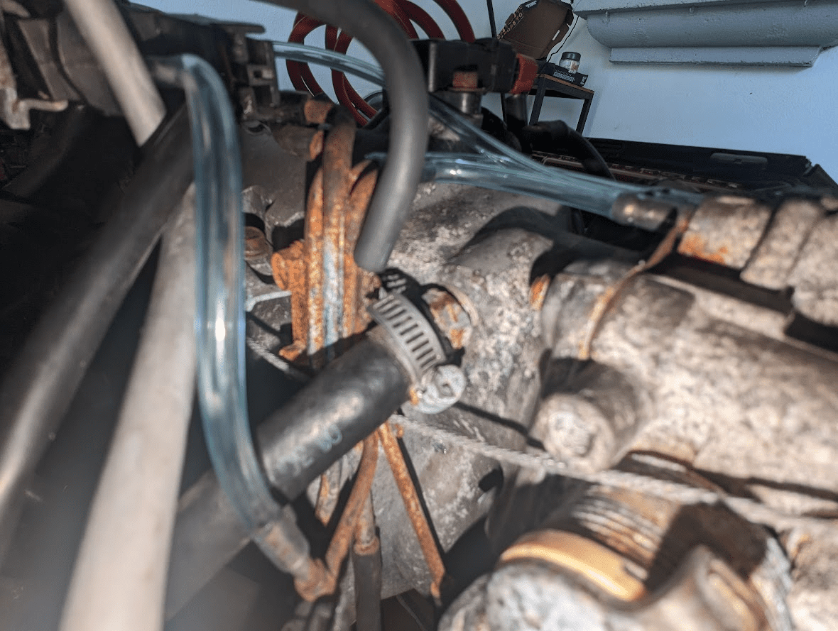

In the process I removed all vacuum lines and reconnected all of the vacuum lines
After that I put back together everything, adjusted the BOV and now the car runs great

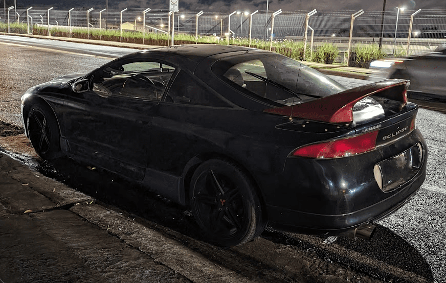

On the last post the car was on the nearest drag strip (2 hour drive from my house), that night was like an open track, so the track did not have trackbite. The car ended up running a 15.6 on cheap tires.

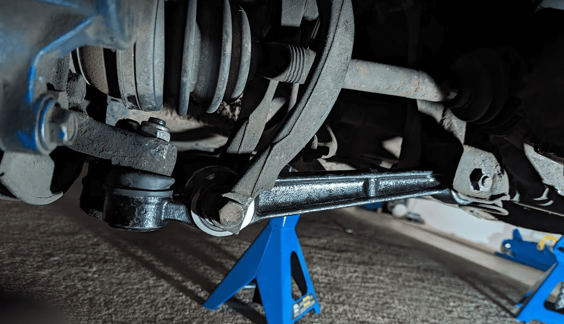

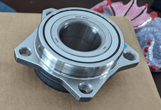

Not sure if that night the bearing hubs stopped working, but a couple of weeks later I ended up changing the front hubs.

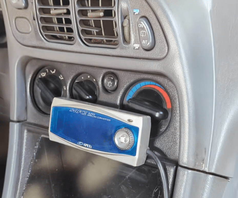

A couple of months ago I bought a SAFC, I wanted to read the documentations and also to look at some tutorials before installing it, so after I did that I installed the SAFC2
This is where is located now, I just slide it into the vent slot
And now this is the POV

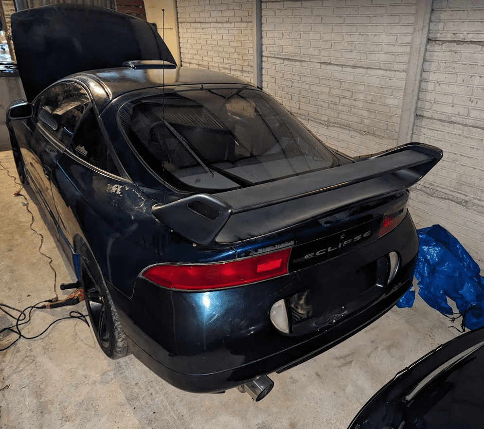

I forgot to add to the last photo that I finally removed the roofscoop, and that the rear wing was looking better for my eyes, at first I wasn't that sure, but for me it started to look good, and then an opportunity to buy the original high rise spoiler came out and I took it, to this day I'm not sure if I made the best decision

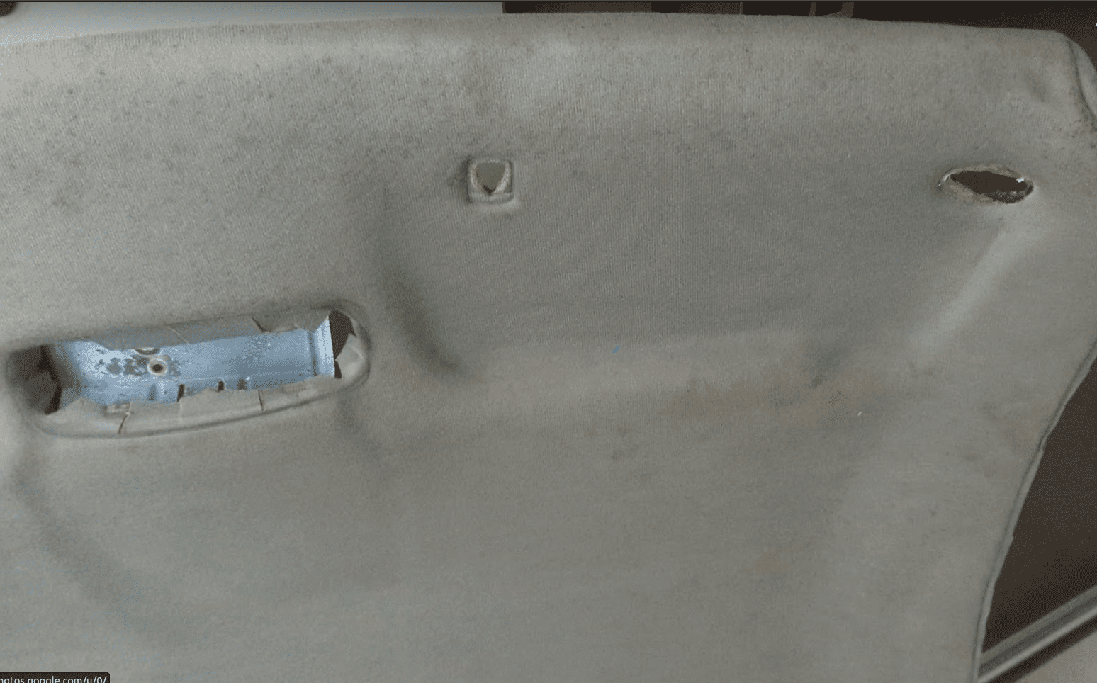

This is how the headliner was, it was moldish and it seemed dirty
I don't have a picture right now, but now it is a dark gray solid color.

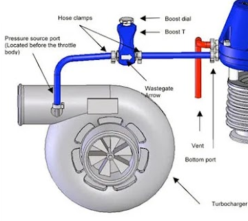

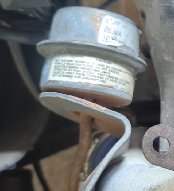

The car has always boosted 10psi, and some time ago I bought a MBC, so I wanted to start playing with that.
At first I tried this configuration
And it kind of worked, the very first time I had an improper setup and the car boosted to 20 psi, It was in third gear and around 4000rpms so nothing bad happened. After talking to a friend he told me to use this other setup
But It doesn't matter how loose/tight is the screw I was getting 10 psi.

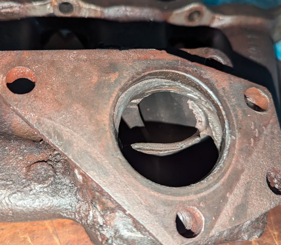

In the process of testing, this happened:

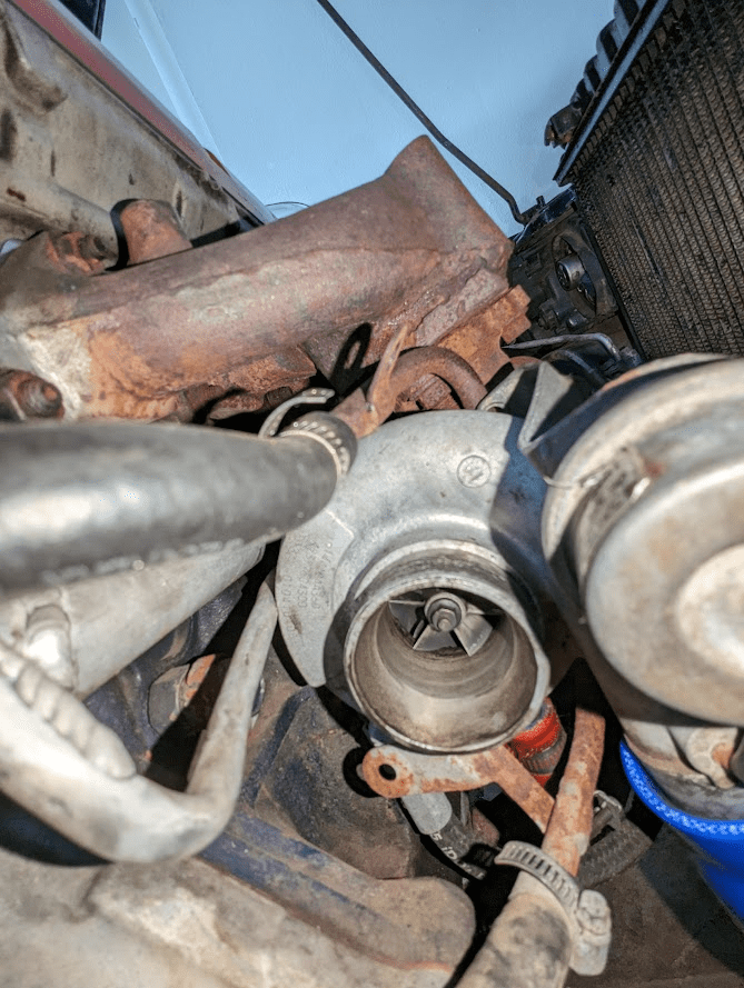

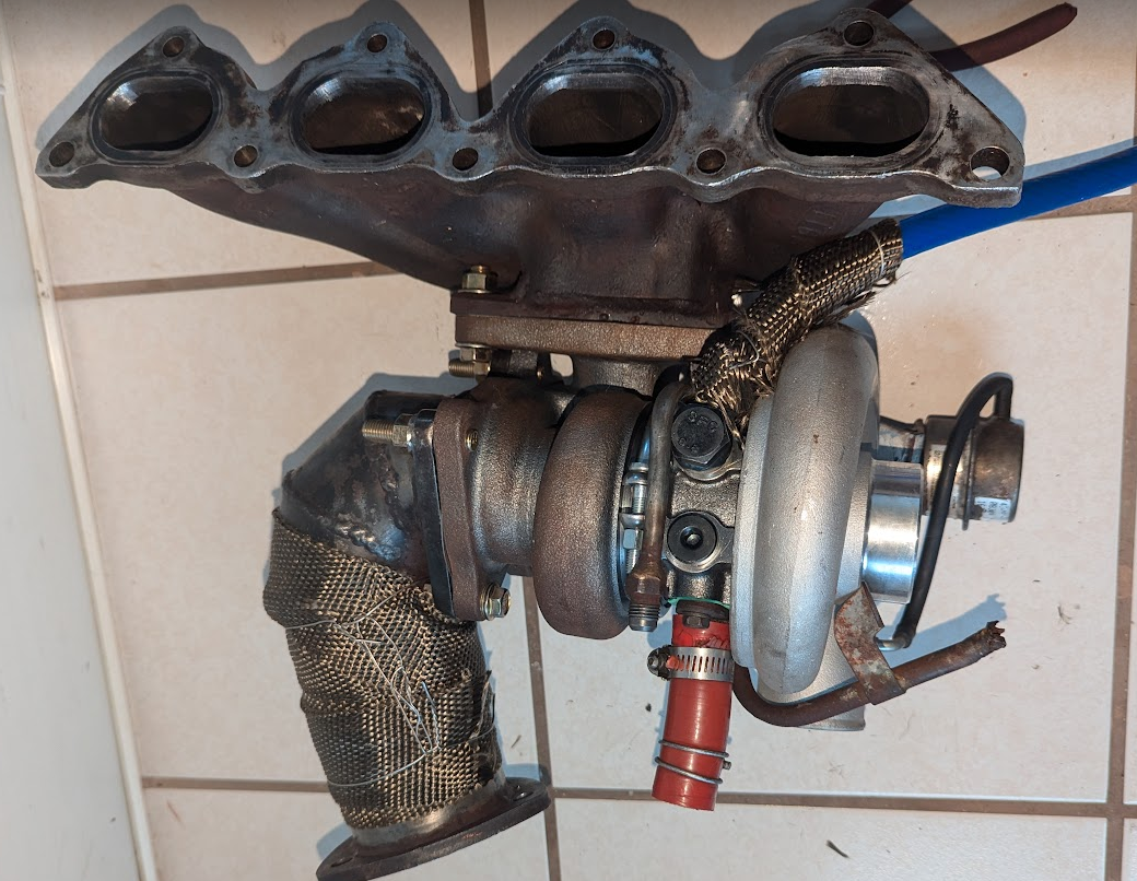

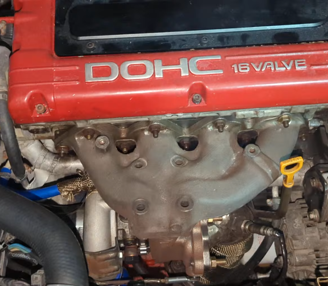

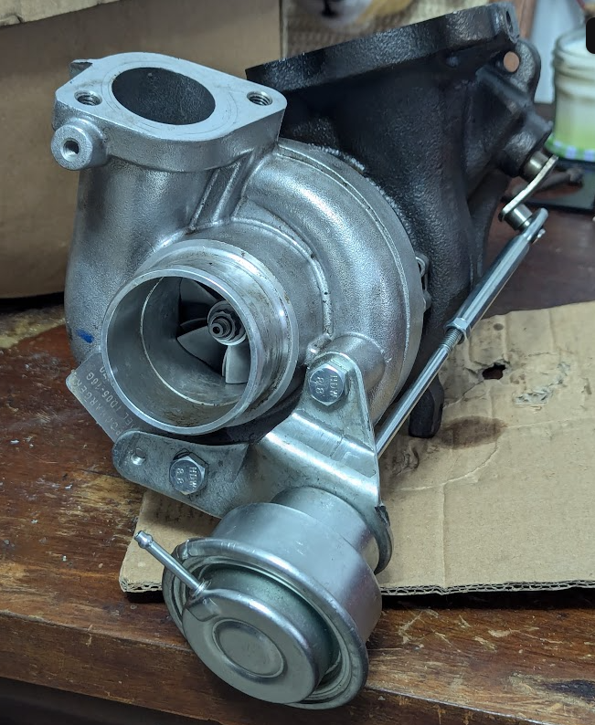

So I got a little bit worried, and for me I had the perfect excuse for swapping the turbo that I bought some time ago.
And as always, some bolts, nuts and studs were done.

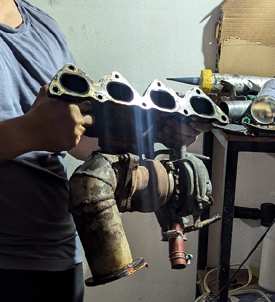

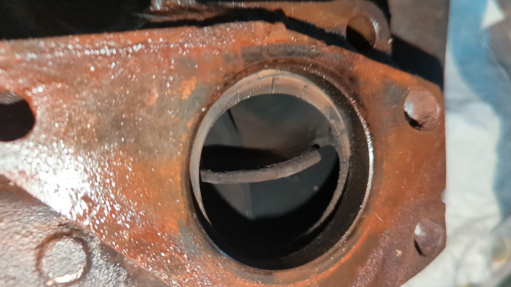

As you see, that is a Subaru style turbo, and that is the case because the previous owner did a "MacGyver", for me at this point it was easier to just throw another subie turbo than sourcing the manifold, the turbo, the 02 housing and the downpipe.
This is how the MacGyver" looked
I tried porting it a little bit, this is not the final result, but I did not take a picture, but that was pretty much how it looked at the end.

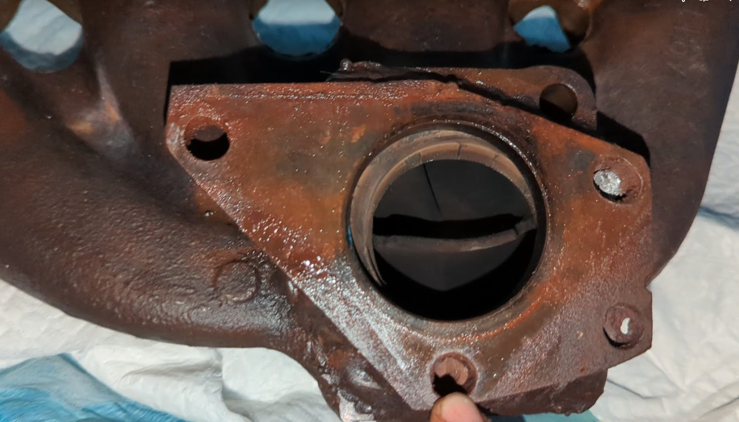

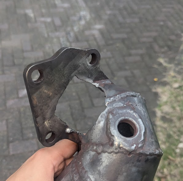

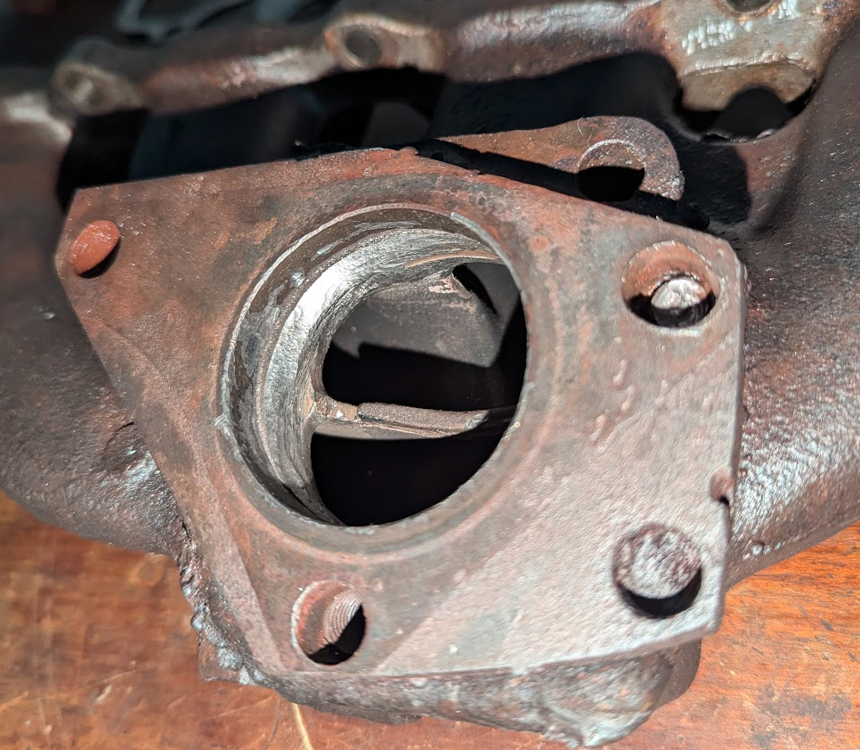

The old downpipe had a sketchy situation going on on the wastegate, so I fixed that

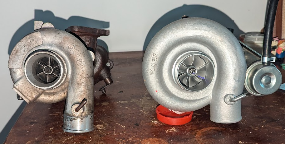

This is side-by-side of the turbos

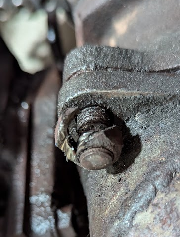

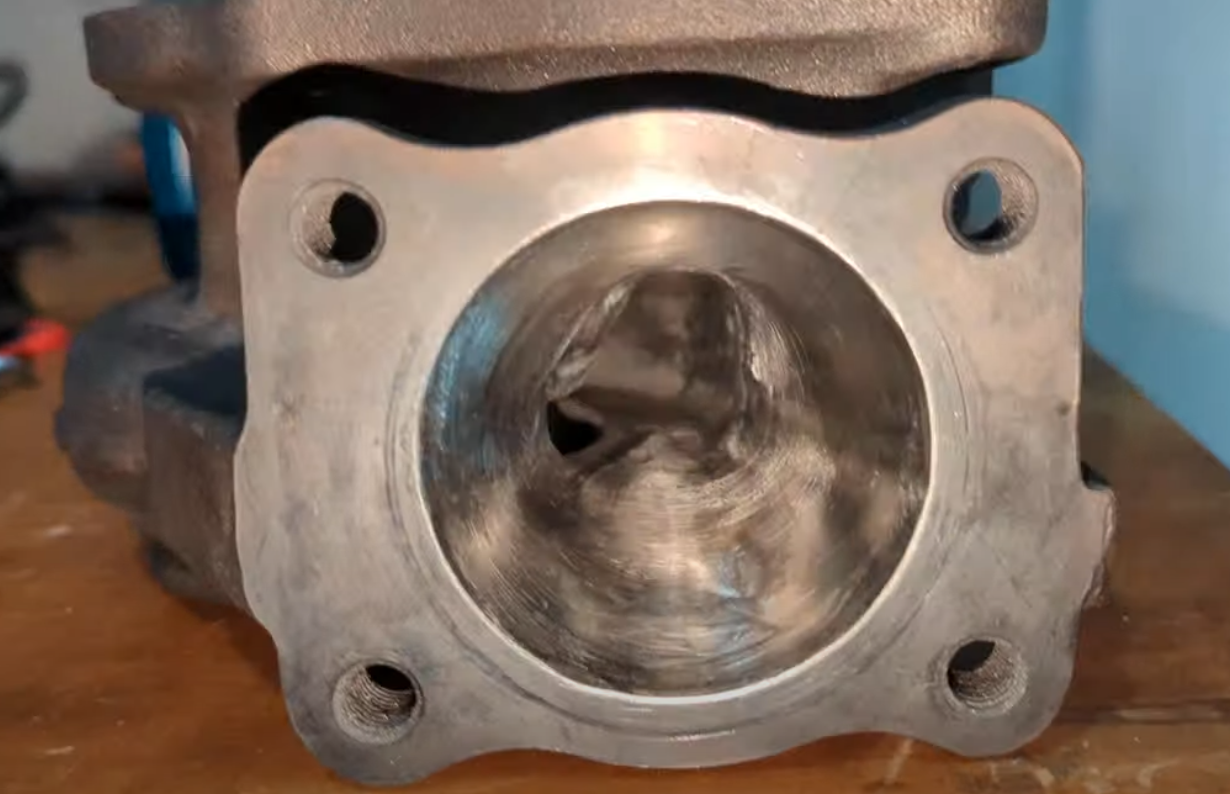

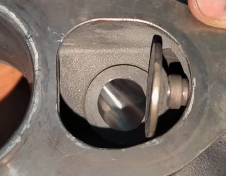

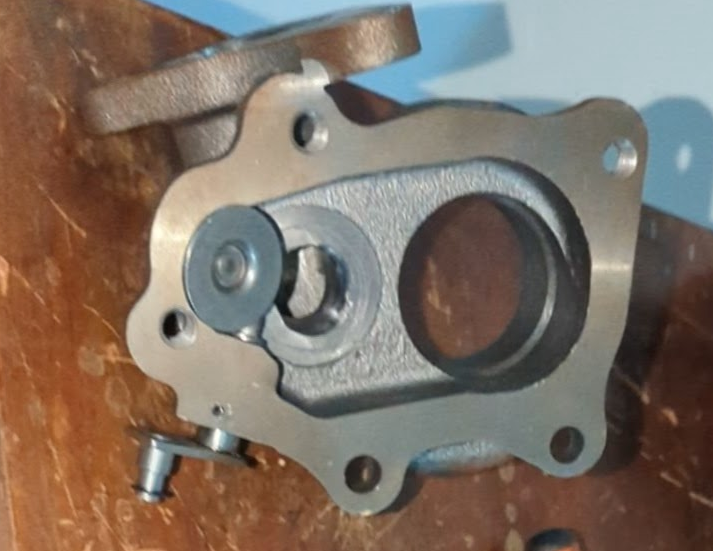

I searched a little bit and found that it is a goo idea to port the internal wastegate to prevent boost creep, so I did just that
I made sure the flap had more than 1.5mm of sealing surface
One of the metal water lines broke, so I replaced it with a fitting and a hose, I tried wrapping around thermal tape the hose so it doesn't get toasted.
And that is how it looks in the car, now the car has a little bit more lag but it pulls for more time. Right now it is still at 10psi, but I may change that once I go to the dyno.

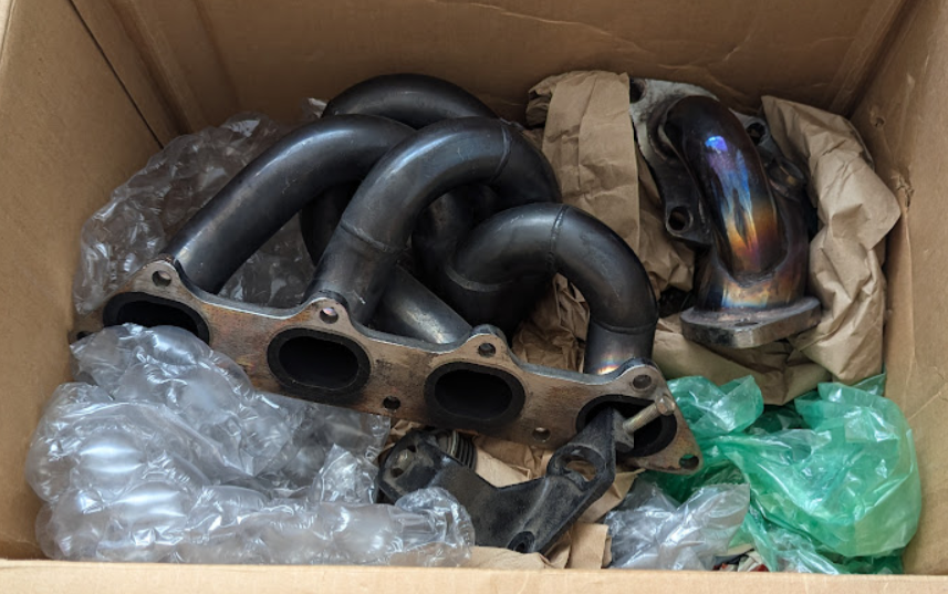

Some time ago I bought to a member a manifold, an o2 housing and the time belt tensioner. It seems like all of this things are part of the future work pending for this year.

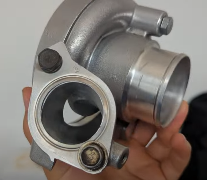

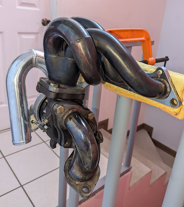

Later I found a cheap 16G turbo that was leaking oil. It had no shaft play and was practically brand new, so I bet for it being ok and now is waiting for a good moment to be bolt onto the car.
I ported the o2 housing so it matched the output of the turbo, and also so it has a better transition. I also gasket matched the compressor outlet and in general worked on the system transitions
And I also opened up a little the wastegate to avoid problems
Test fitting the components
Also took the opportunity to clock the turbo so the oil outlet is pointing downwards

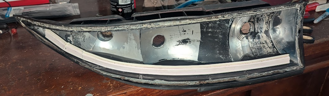

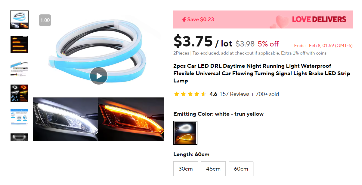

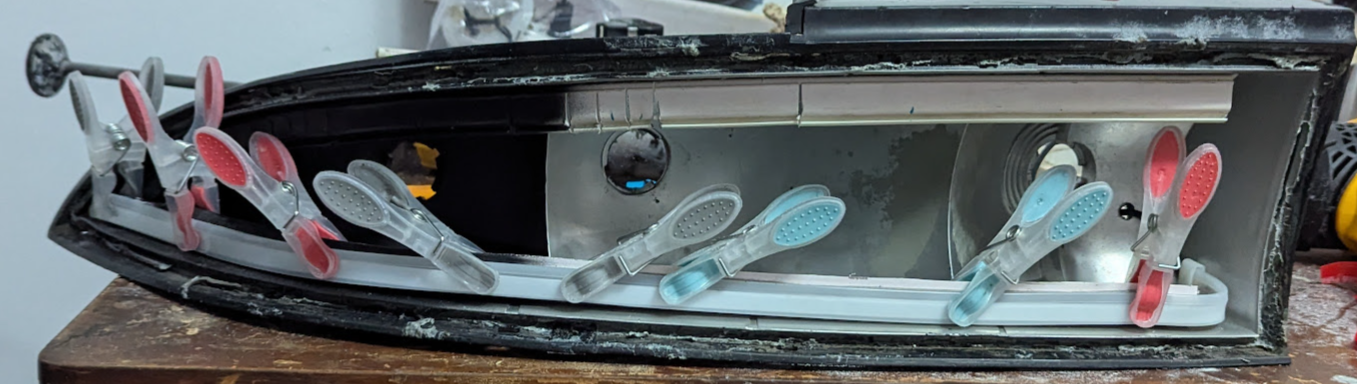

I bought some cheap sequential strip lights, and this was the beginning of the process of mounting them to the car
I made some questionable mounts for the strip lights
And also mounted them in a questionable way
I really liked the look of the car with the modified tail lights
But it had the annoying part that when you pressed the brake pedal it seemed like you had on the hazard lights.

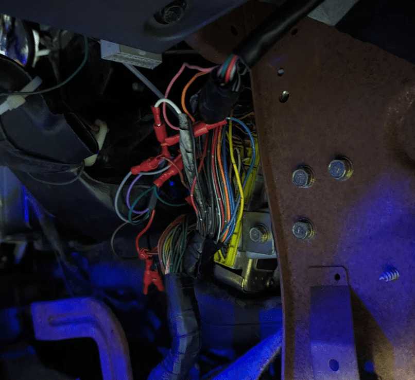

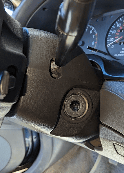

The next complementary modification was adding the strip lights to the center trim, and implementing the changes so it behaves as the euro model. I saw a thread that helped me do just that.

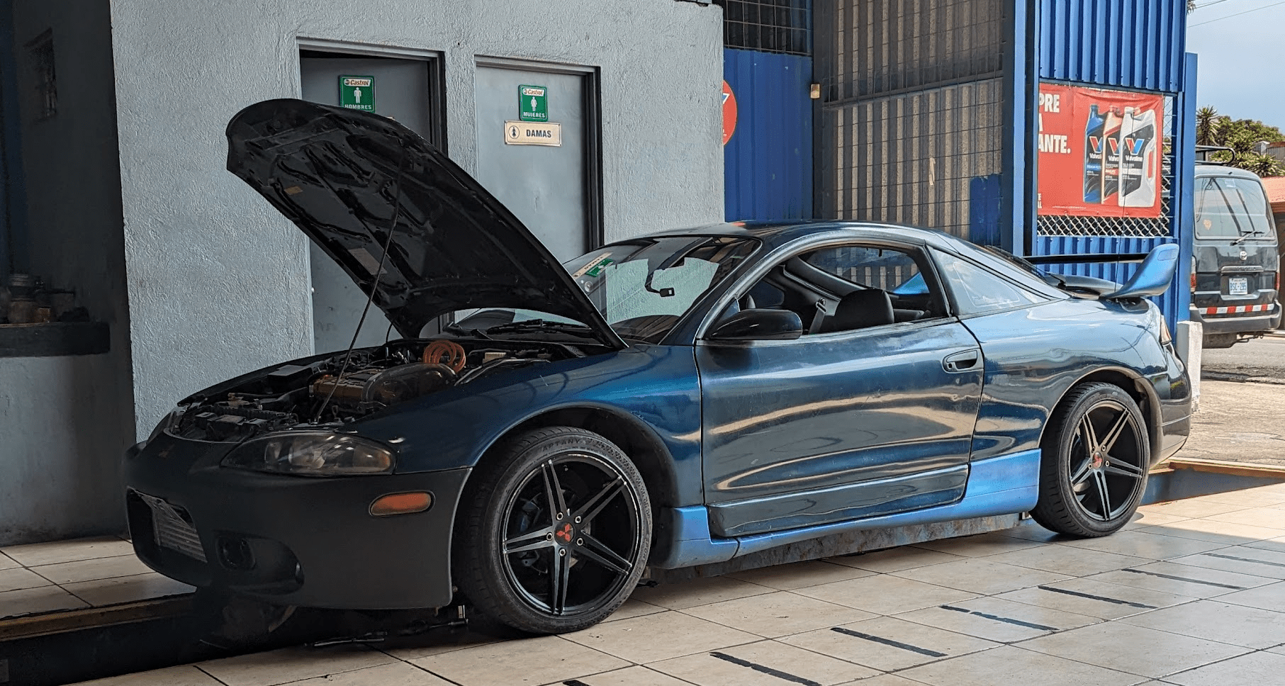

After finishing the tail lights I kept enjoying the car and in december I bought one of the things that has made the biggest change, tires. I changed the old cheap tires for a set of maxxis victra maz1 235/45/17 and I loved how they fit the car. With the previous tires if you pushed -slightly- the car on curvy roads they would start squeaking and slipping very easy, so that was a no-go. Now this victra tires grip very good and I'm more confident with the car.

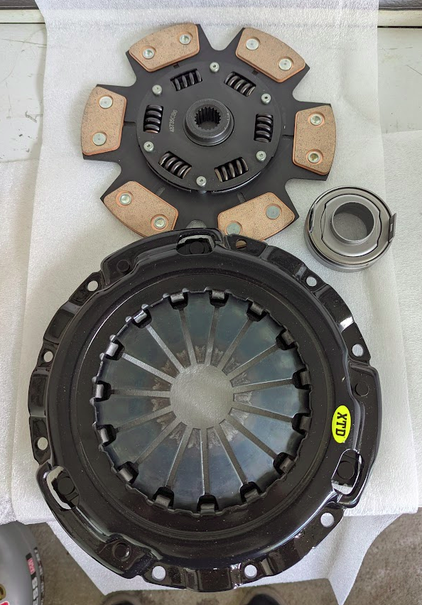

Back when I changed the turbo the clutch was not properly adjusted, and since the car has some serious crankwalk, the clutch is impossible to adjust properly.
Given that situation, I think the clutch was getting hot and loosing grip, so I bought this clutch kit in January.
I was plannig to change it along the crankshaft but after trying to adjust the clutch, the clutch kind of started to work better, still not ideal but good enough so I didn't have to change the clutch (and possibly the crankshaft) at the time.
