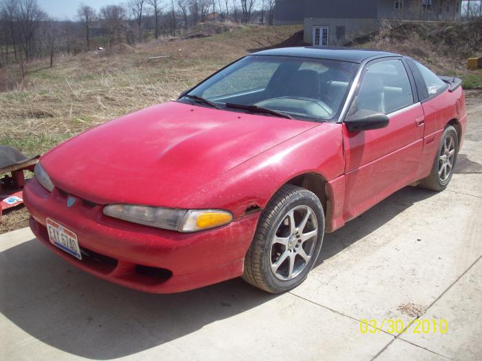

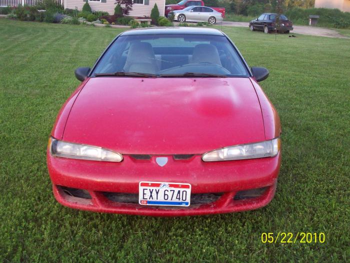

This is the car at the end of its street life
She was a ok street car not the best though she is ready to start her dream as a dsm though and thats to kick some hondas butts on a legal feild of racing

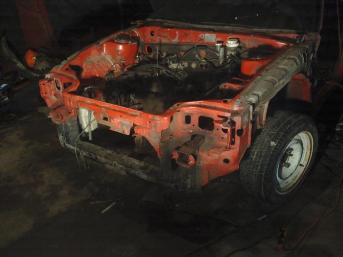

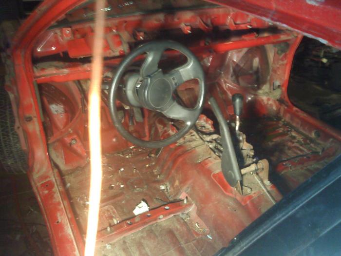

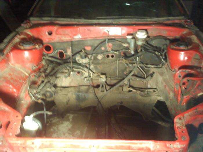

There is still alot more gutting to go still about 150 more pounds to cut off. Notice that theres is not a wire left in the car. I will not have any wires left from the dash harness when im done. I will just have the main motor harness and some toggle switches and push button start.
A couple things I left inside will be all the pedals,steering wheel, shifting linkage and the emergency brake it can be nice on really small tracks. Also where the fuel pump wires come into the drivers side of the chassis I cut the wires right of at the plug in those are the only wires left in the car now. Later I will wire them directly up to a toggle switch as required by local rules.

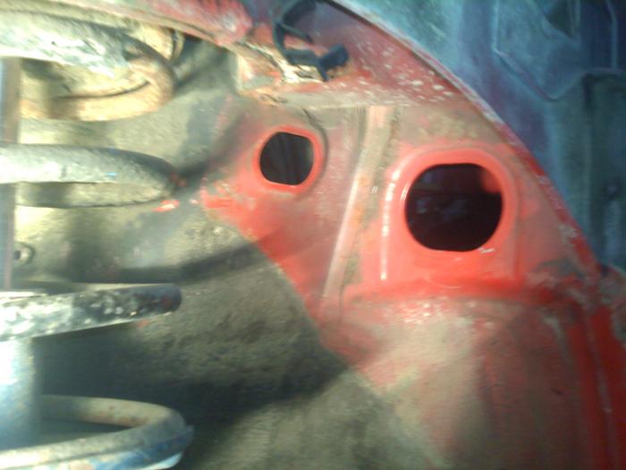

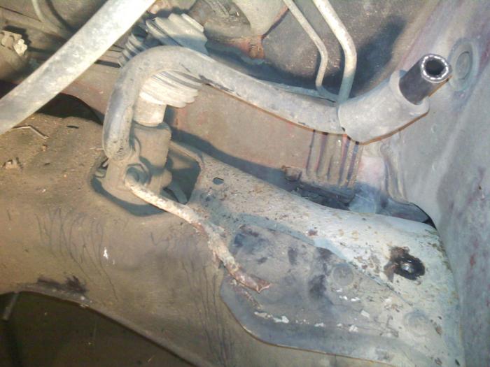

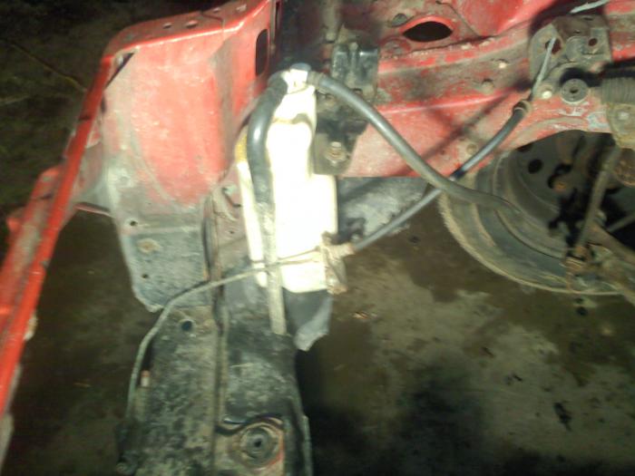

In the engine bay you can see I left the overflow tank which is vital since we have alot of problems with cars over heating and cant buy a $400 radiator since they get smashed alot. You will also see I cut the power steering lines I will loop them together later there for eliminting the power steering. The engine bay also still needs more work.

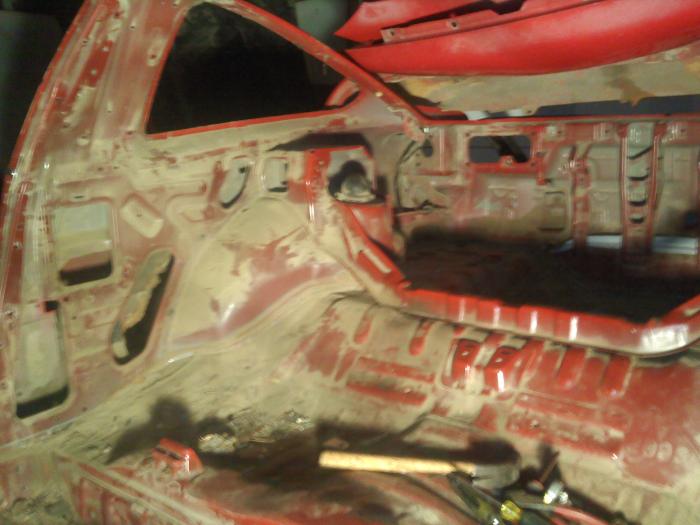

Been very busy last couple days so havent done much. On monday I plan on getting windsheild out, then ill work on tearing out sound deading material on floor boards which i have a way that makes that part easy ill show you. Then I plan on grinding off that white glue in a couple spots and reweld the seems to add more front end strenght to the car at the strut towers after I bend the car to my specification. In front of the strut towers I will take a hole saw and cut some holes in the frame. I do this because I try very hard to keep the cars geometry the same as what im going to modify it to by drilling the holes it will allow the car to smash the front end before it tweaks the strut towers any. I would rather do that and reweld a whole new front end on then build a new car because the towers got tweaked. I will try posting pics by wensday.
I fogot to say I will also be taking out all the spot welded stuff in the car like the rear strut tower brace for example and I will also start torching out around the spare tire well in the rear of the car
May I suggest before removing the rear brace, weld a brace to the top of the towers and when you cut do not remove the spot welds cut just outside of them, that will leave you with 2 layers of metal instead of 1, leave the very top of the rear brace, cut around the brace that goes up to the rear window and leave that brace there.
I am doing the same to mine, but not taking brace out until start of roll cage.
I dont want the strut towers to stay were they are at the very moment, this is because later I will be torching the frame of the car so that the left front is lower then the right front and the right rear is lower then the left rear. I already have a roll cage built when I put the cage in I have a strut tower brace welded to it I will keep the car torched how I want it until Im done welding roll cage to the car so the car cant flex back very much. The reason I torch the car is to make it set better on the track also to try to get the car to carry the left rear around the corner with out touching the ground this improves the handling of the car a tremendous amount. Ive let alot of people drive my car and never had any one say there car handled better LOL they all want to know what im doing to it to make it handle so well.
