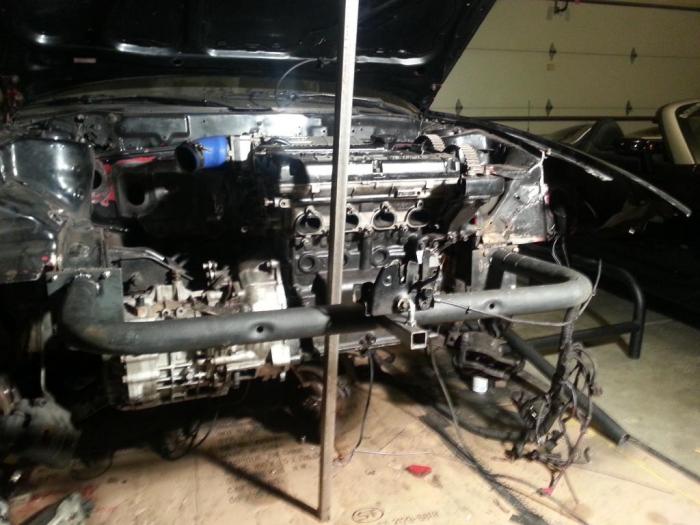

Alright guys.. iv been meaning to make a build thread her it is.
ok.. im not going to bore you guys to death with the cars life story so ill just give ya some details on the build.
iv been wanting to do a tube core support for a while now and now that im done with school and have time i can finally do it...
i have 2 motors going together..
2L - reconditioned 6 bolt rods with arp bolts, evo 9 pistons
2.1Llong rod de stroked 2.4- Manley turbo tuff rods, wiseco hd pistons as of now.. it may change
the reason im doing 2 motors.. i want one block that i will always have so i can toss it in if needed. the 2.0 will be in it till the 2.1 is done.

and this is it as of tonight

hey guys.. sorry i left this thread to die but iv been quite busy and havent had time for my car till now... since last time iv posted i started working at a performance shop in PA called street lethal performance so that had me busy for a while but now that things are slowing down out there i have time to work on my own car.
i just started recently but heres a pic atleast.. more to come
