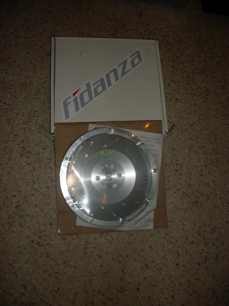

Fidanza 6 Bolt Flywheel

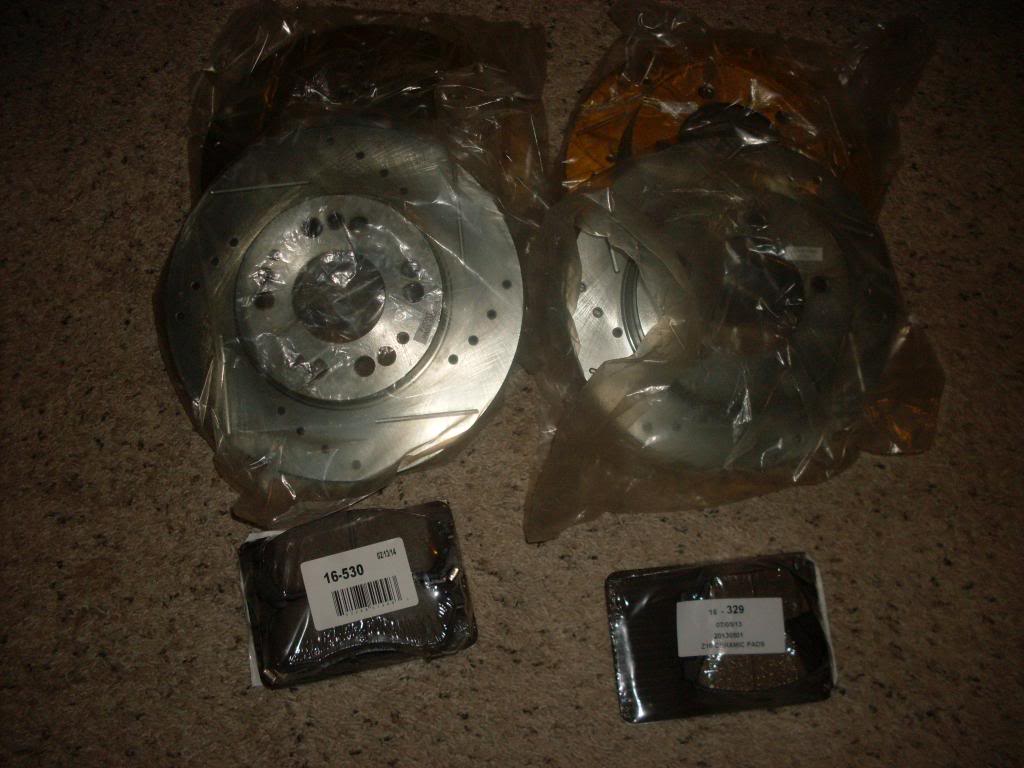

Rotors and Pads

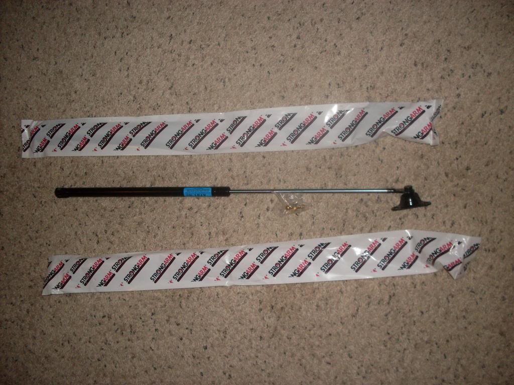

Hatch Struts

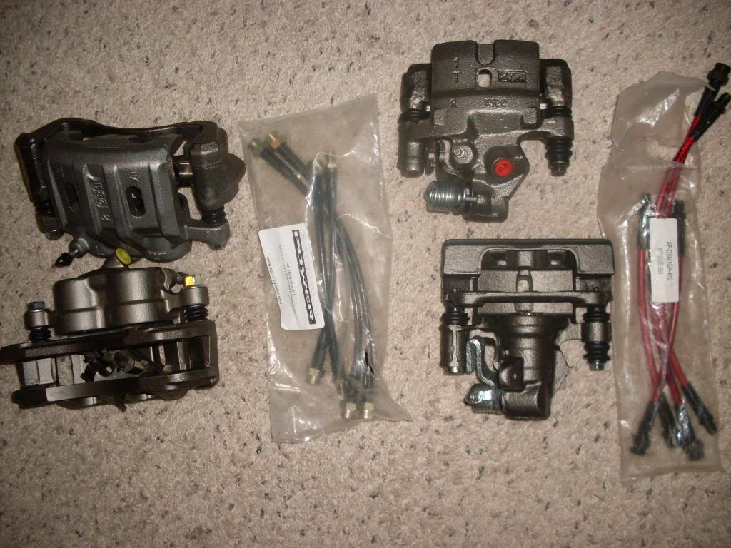

1gb Front and rear calipers and lines.

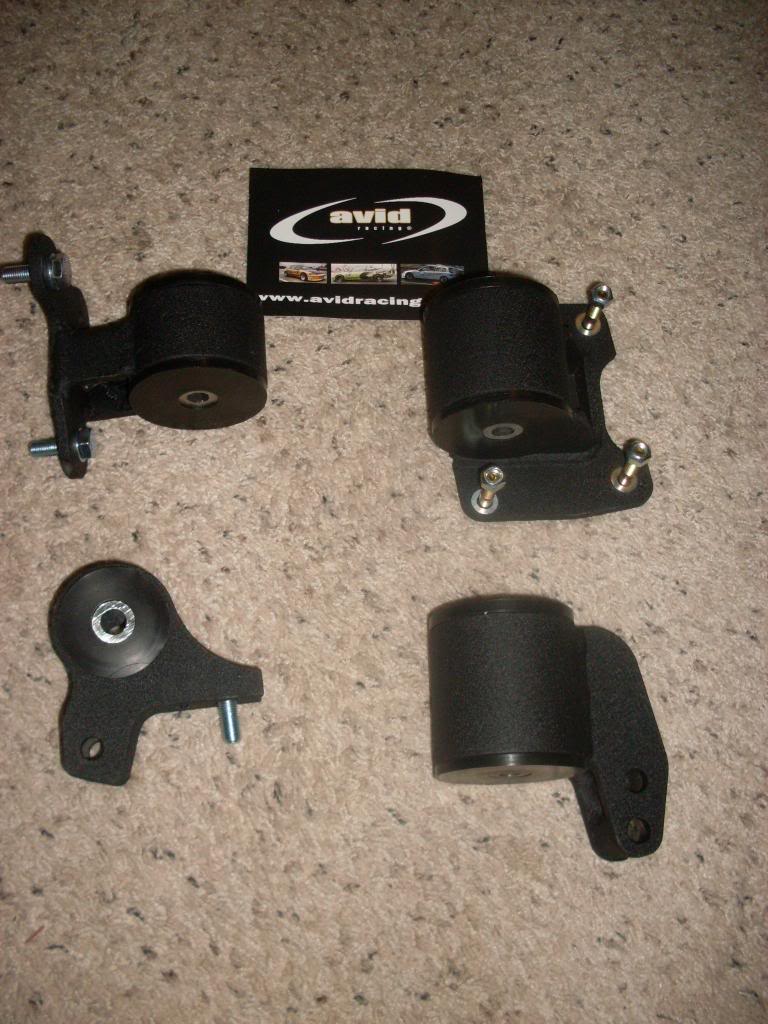

Avid Racing "Tuner Series" Motor Mounts

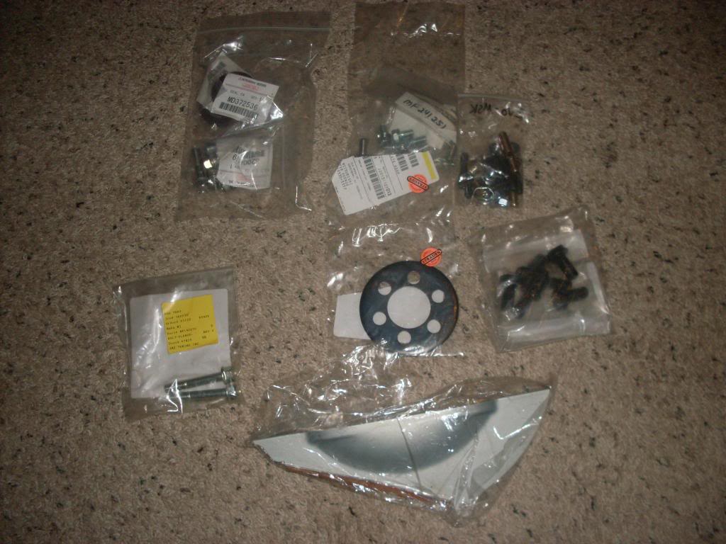

Trans bolts

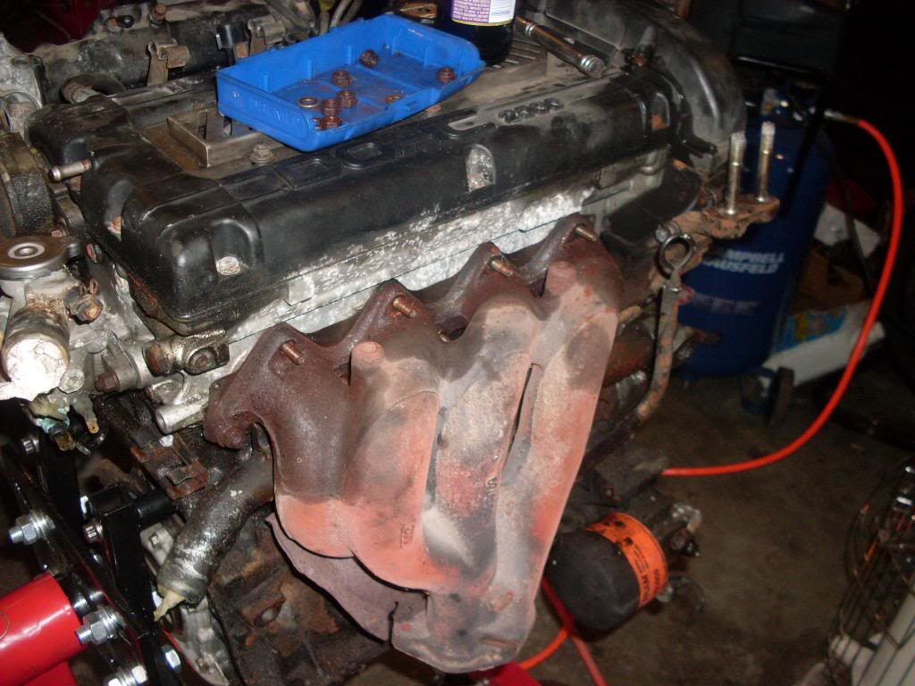

exhaust studs
Dowel - Crank to Flywheel MD005994
Flywheel Shim MD952138
Longer Flywheel Bolts MD008839
Press Plate to Flywheel Bolts MF241251
Dowel Press Plate to Flywheel MF472404
Dowel block to trans MD020260
Inspection Bolts MD012109

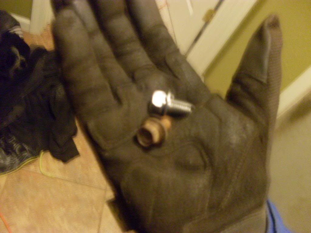

Inspection Bolt MF140021
Inspection Cover MD095656
Starter Bolts MF140270

Looks like it'll be a good dd project. Since you bought new rotors/calipers, why didn't you upgrade to something larger?
I went with the 1gb 2 piston calipers, that is more than good enough for a dd. The raybestos rebuilt calipers went for $50 a side.
Left Caliper Raybestos FRC10295 $50.53
Right Caliper Raybestos FRC10296 $48.55

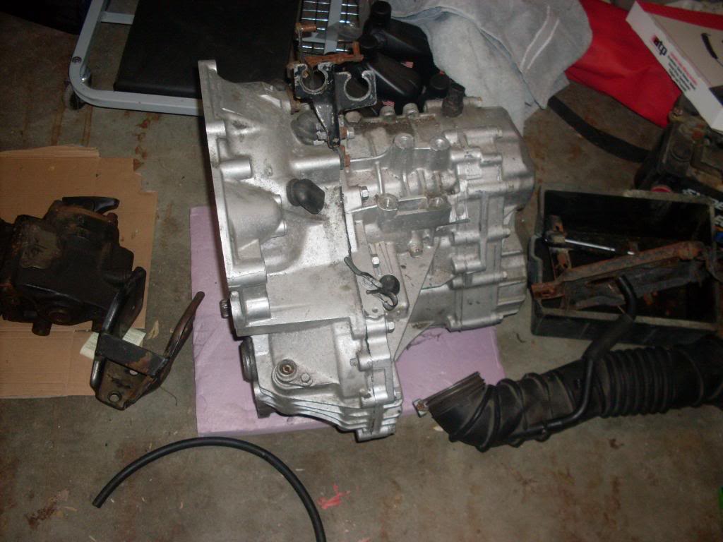

AWD Manual transmission is in.

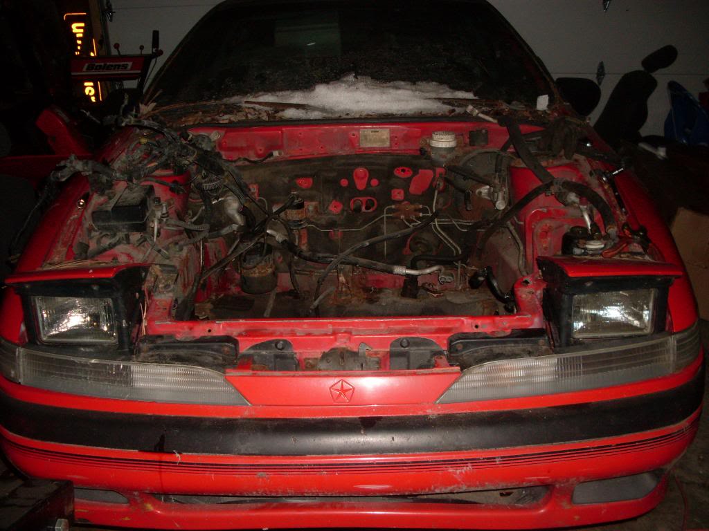

Donor car has been worked on

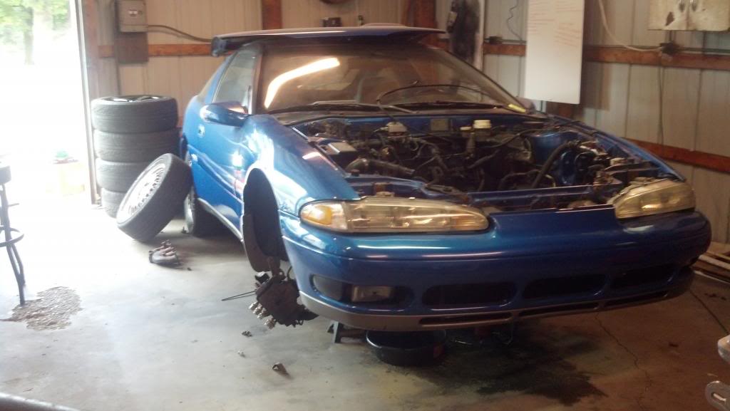

Here she is some parts already pulled off. Wire harness stripped back.

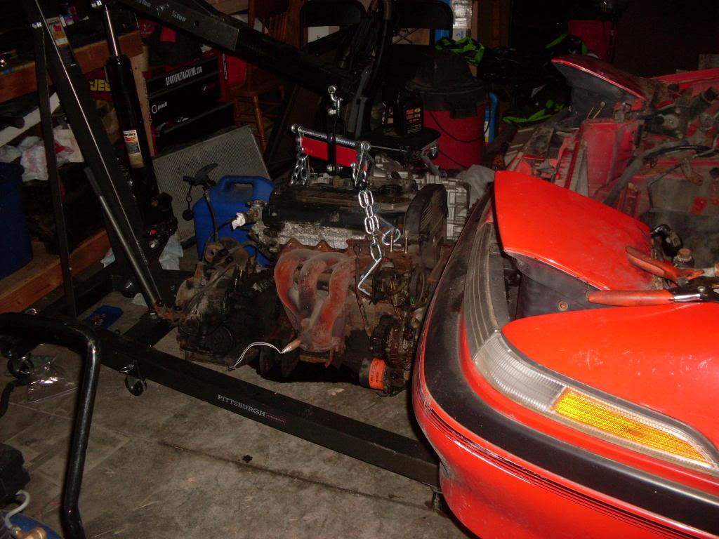

Engine / Trans pulled
Just need to get that wire harness and ECU.

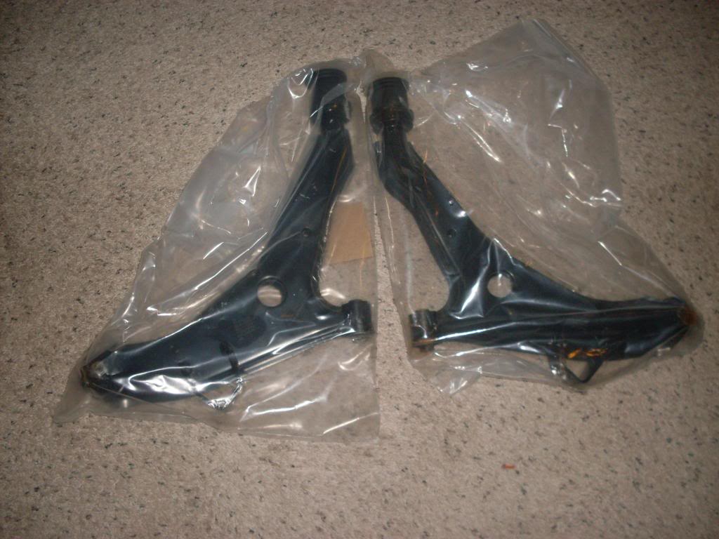

Front control arms

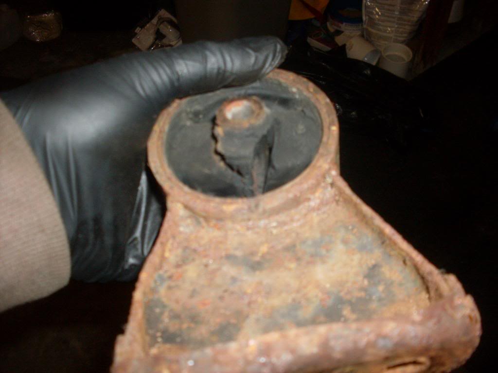

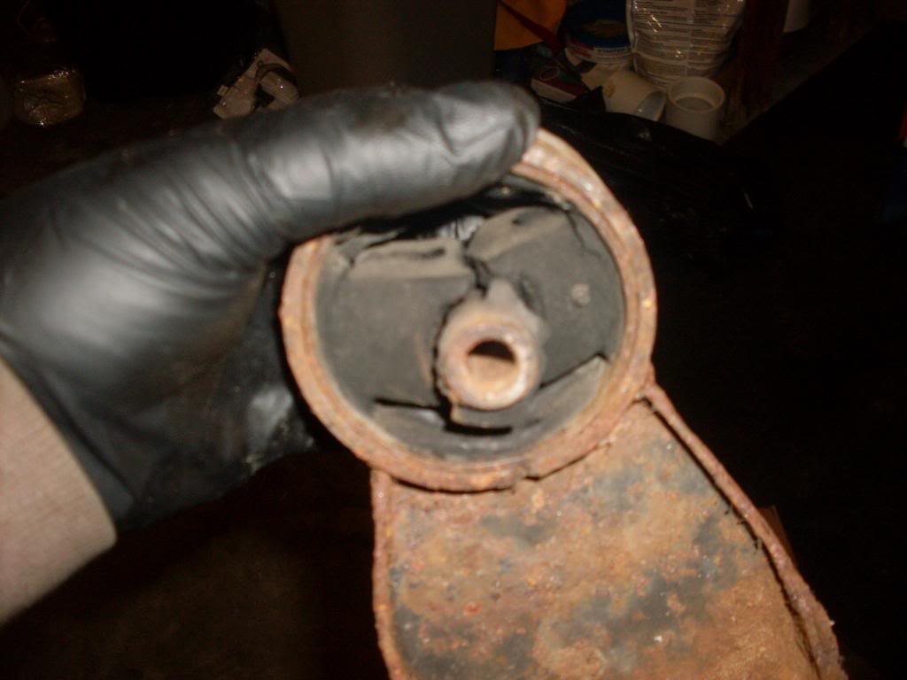

Front and rear mounts off my old DD.... LULZ!!!

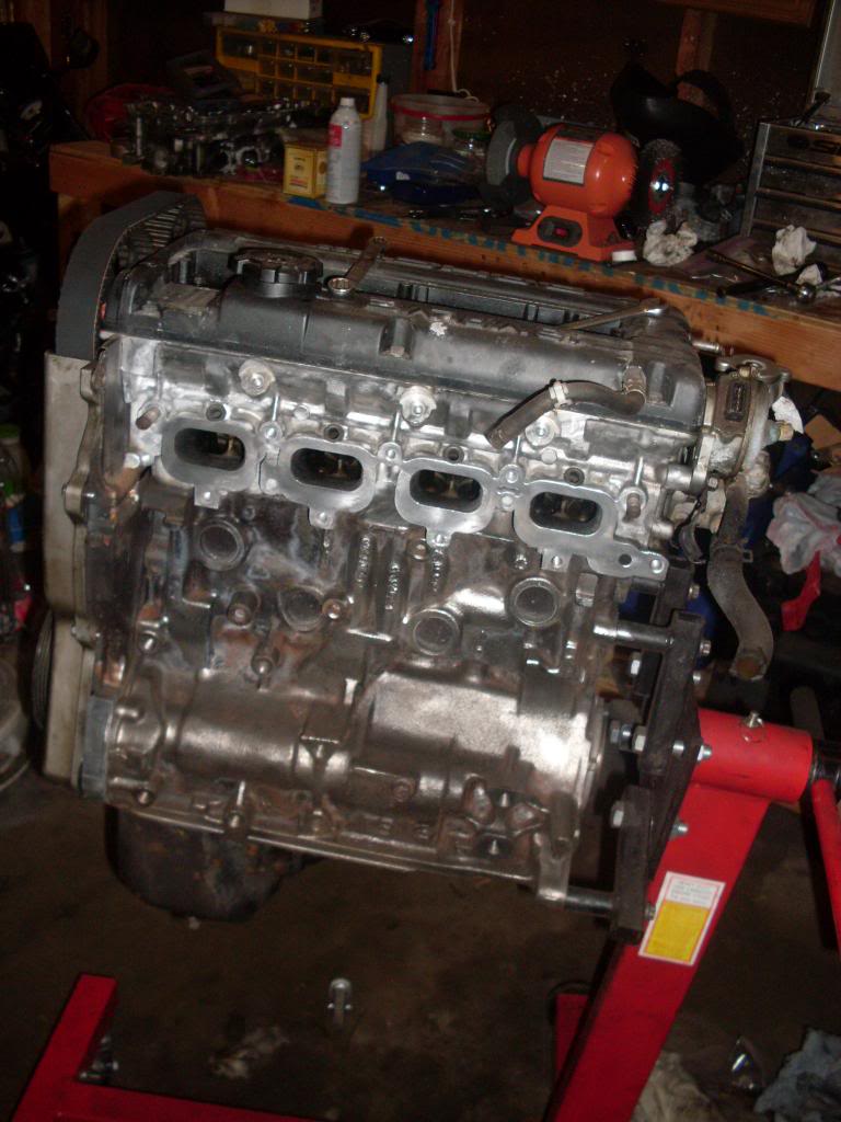

Engine on stand. Ready for me to pull apart for clean up.
Oh joy...... this isn't dirty at all.
Da hell is going on with the head surface.
Initial pass at head surface cleanup

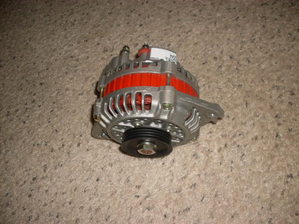

Alternator

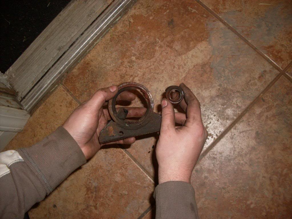

Intermediate shaft carrier bearing and seal

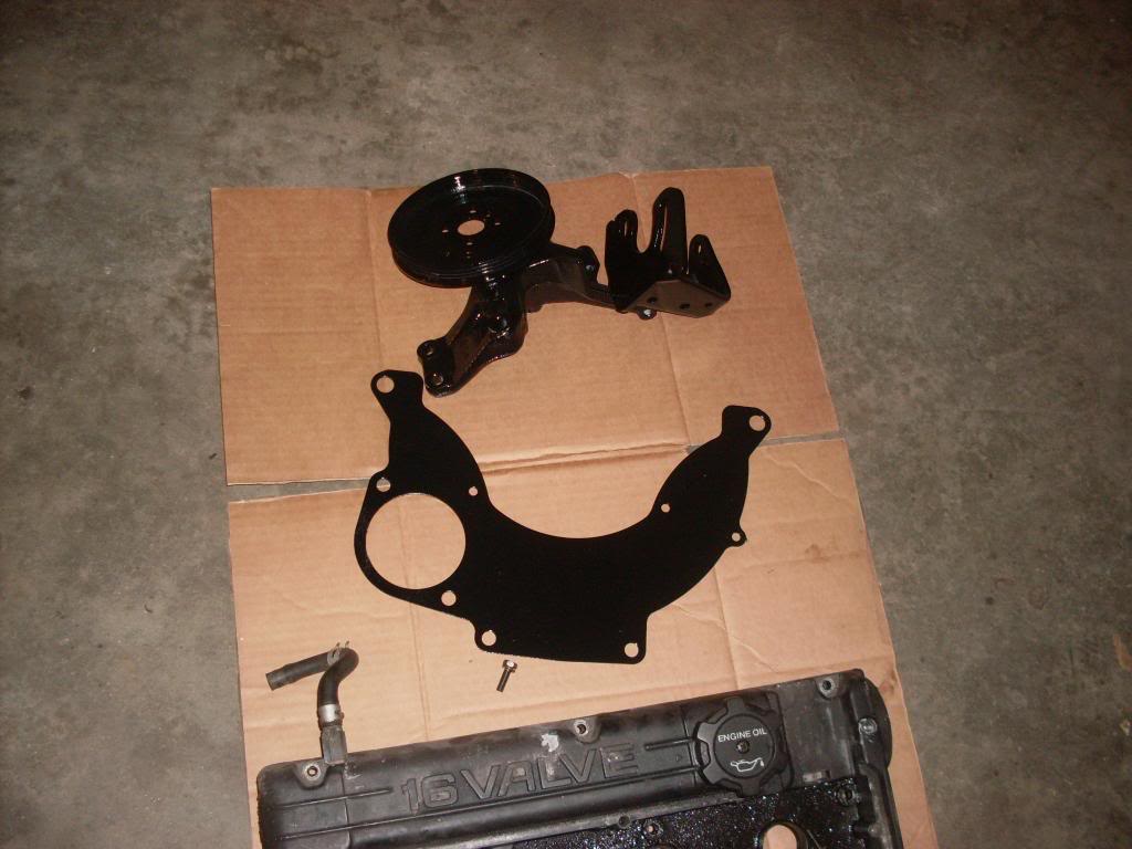

Painting some parts
7 Bolt head looking real nice.
Valve cover gasket replaced / New valve cover put on. Using JNZ hardware
