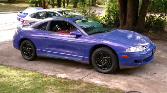

I picked up a 1996 Eclipse GS-X from the second owner for $1450 about 90 days ago. It was originally the Celtic Blue Pearl paint code, but some time in the Colorado sun has turned it into a more purple/blue. Something I wasn't too stoked on when I first saw the car, but I couldn't pass up on the price and the color has grown on me :)

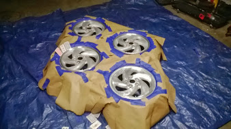

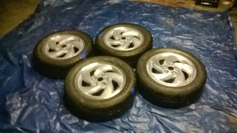

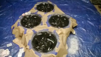

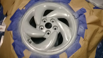

One of the first things I did was paint up those stock swirly's. They were the factory gray with quite a bit of brake dust burnt on, and just in overall poor shape.
Pre-Paint
Sanded down and taped off
Primer for days!
Little glossy black. Much better.

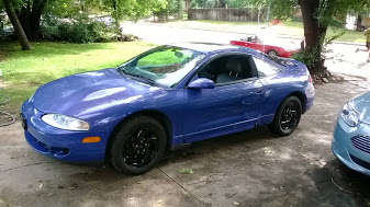

Final Product

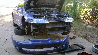

Taking that bumper off

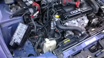

Kind of a bad picture, but the stock IC pipes were COATED in oil. The T25 was dead.

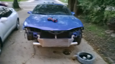

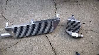

VRSF FMIC vs Stock Sidemount
Middle of turbo pull. I painted my VC a while back when I did my tune up.
Got the FMIC back from my welder yesterday. He moved one of the outlet pipes to the side (core for a 1g originally). And here's the loose fitment.

Update on the build. Got the turbo installed and piping outlined. I need to cut the length of the SS oil return line.

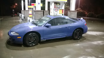

Bridget is running like a dream. NO CEL, perfect idle, no smoke, passed emissions with flying colors. Holding 16psi on the ported 14b.
I've been driving a WRX for the past month while this has been up on blocks and it feels too damned good to be back in a DSM. I took it for a late night drive up the mountains last night and it started snowing halfway up the canyon. I love the DWS tires I have on there, but once that road was ice there was little holding me on the road....AWD or not.
