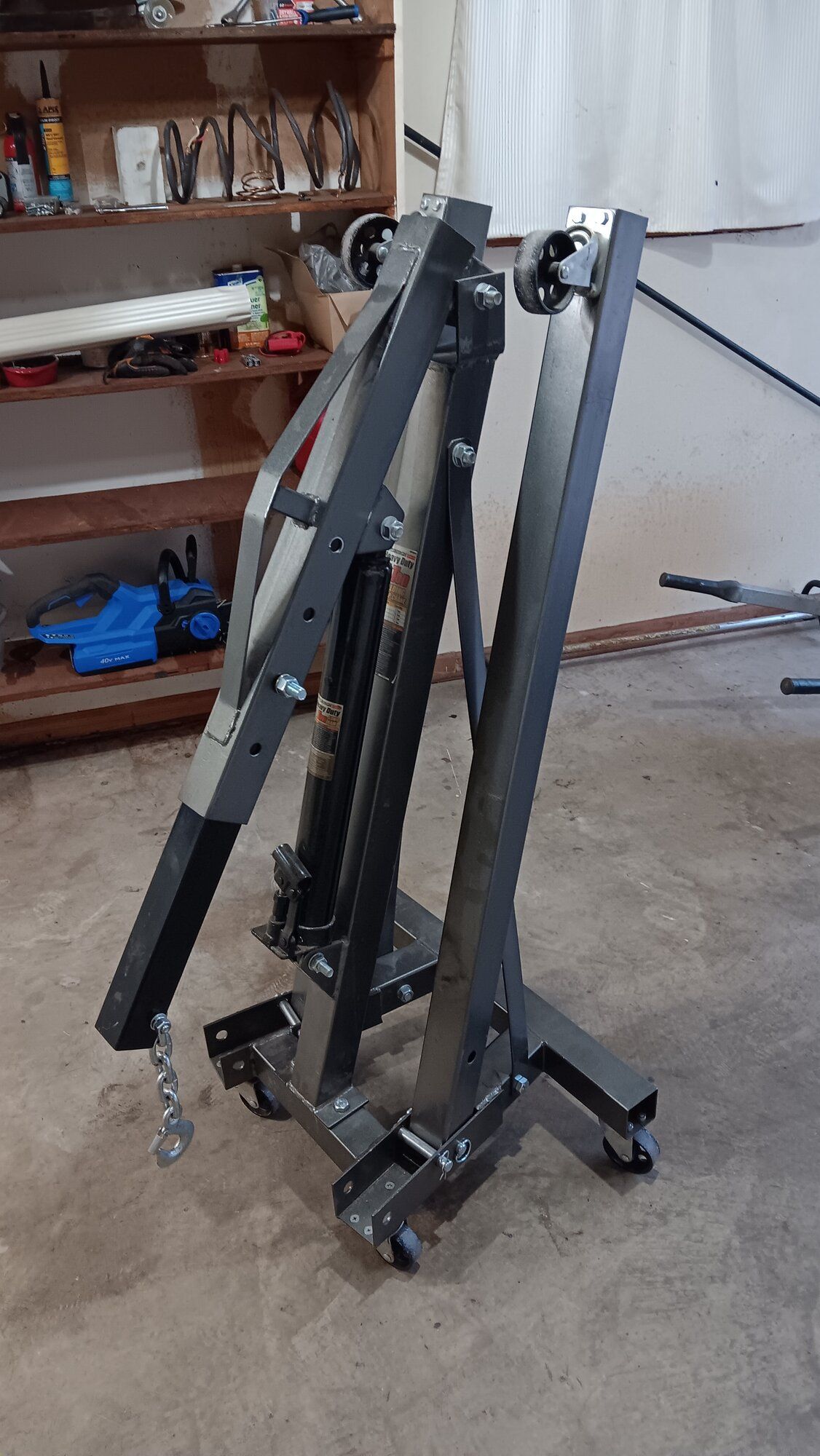

Just picked up a barely used engine crane for $40. Amazing price I thought. We're about to see how well it works. I bought this one for the convenience of being inside my in-home garage. My other is out in the shop, where different projects happen.

Good deal! Marketplace find?

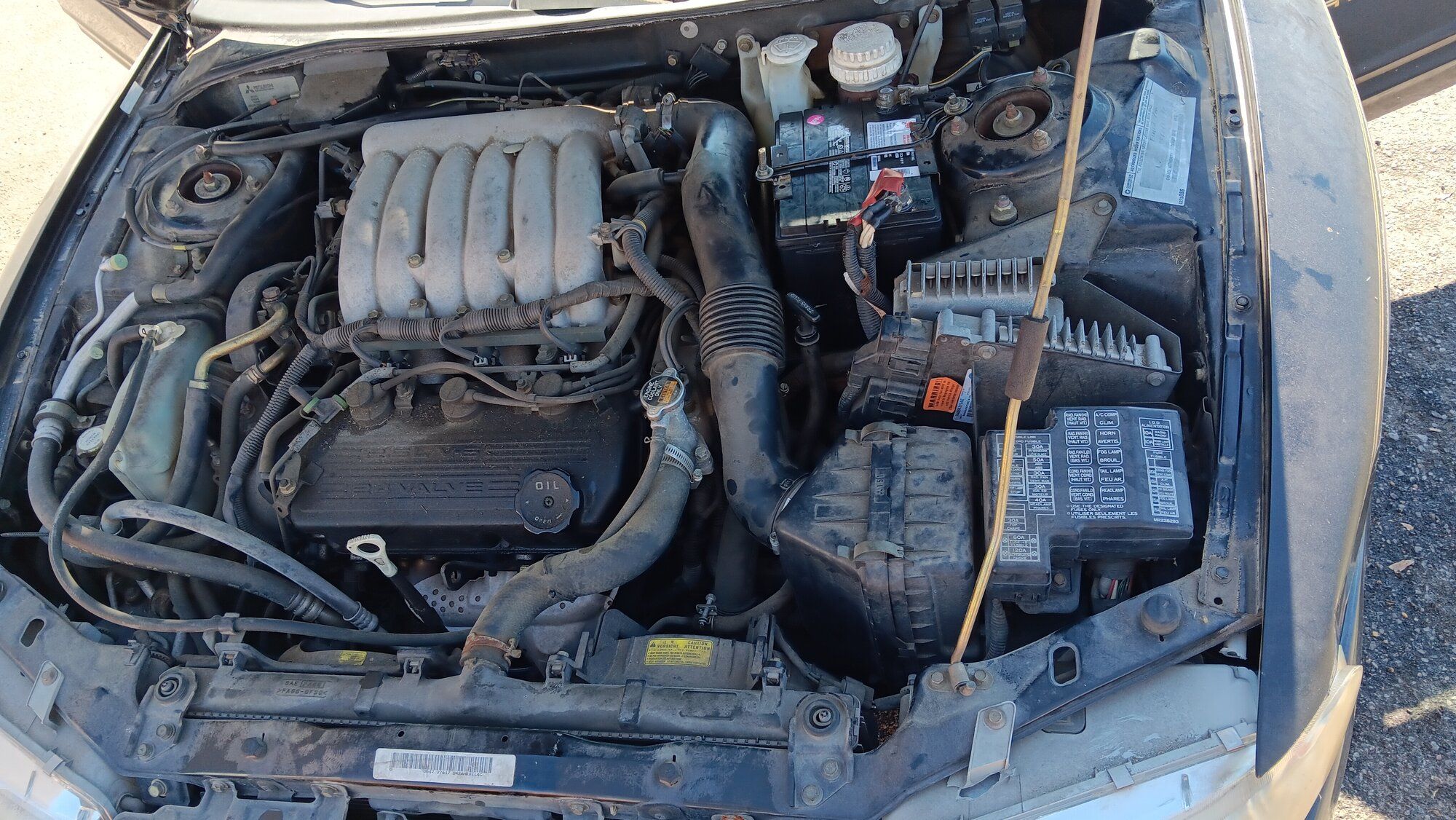

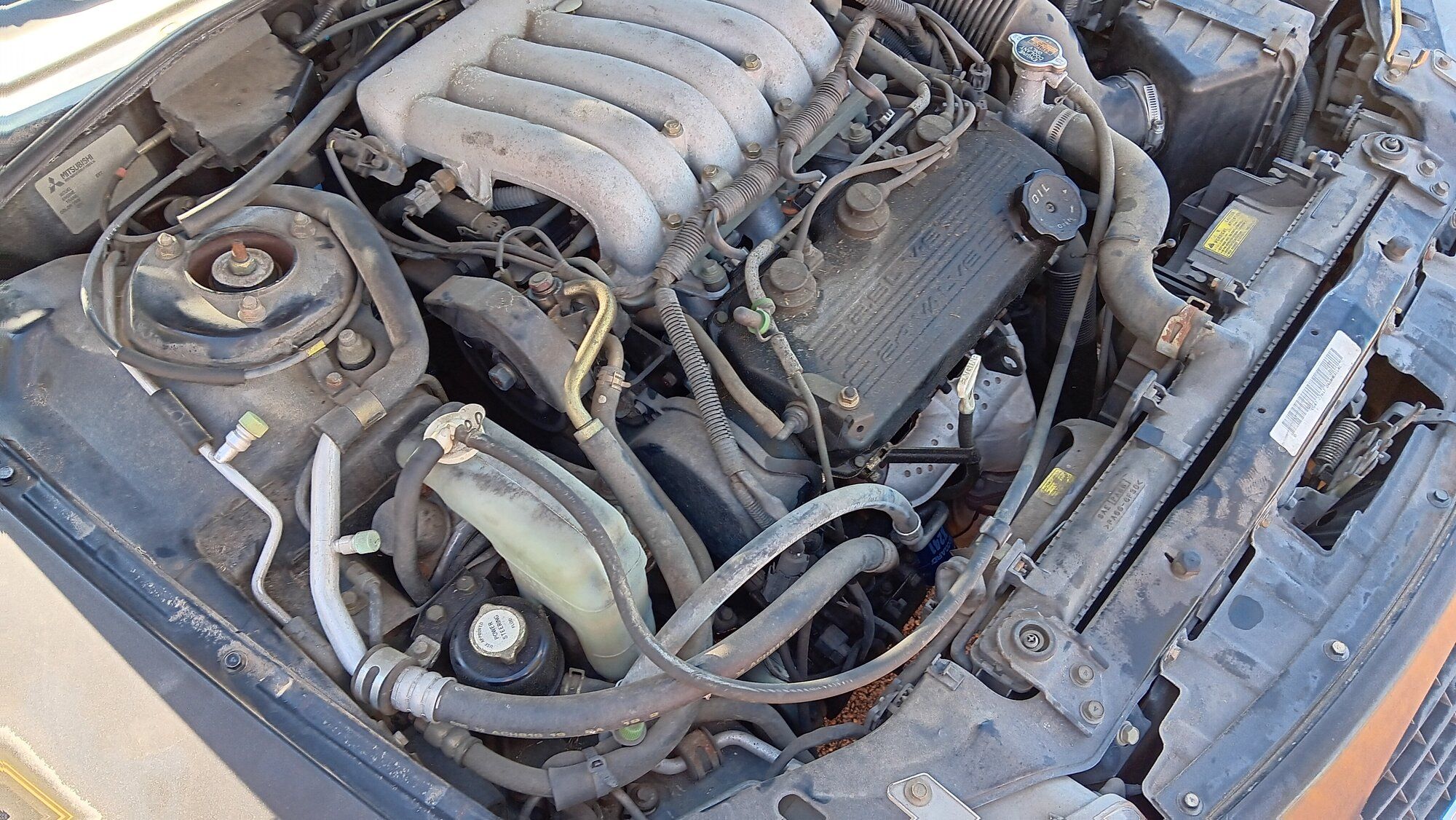

Very small updates. I've been running the Sebring for a little while. Trying to determine the health of the drivetrain so I know what I need to dig into during the swap. With only 82k miles on the odometer, the engine smokes quite a bit. The engine oil looked and smelled like varnish when I drained it. There is also a tapping noise from the front cylinder head. I was told the car sat in a storage unit for 9 years so that probably has something to do with it. I'd imagine crunchy valve seals and stuck rings. So bare minimum the cylinder heads are getting rebuilt. I may go as far as stripping to bare block and starting fresh. Time will tell. I foolishly picked up another Honda Accord a few days ago, as if I don't already have 4 unfinished projects sitting around. I swear I've gone crazy.
My bet is dried up valve seals that might even come back to life after some use. My “new” 6 bolt for my 1g had a stuck ring or 3 from sitting, a fresh oil change with the cheapest 15w40 Walmart had along with a couple gallons of fresh ethanol free recreational gas and a can of Berrymans b12 and a few minutes they came right back to life. Started it in the donor car with that mixture, let it run up to temp and revved the piss out of it a few times and it came right out of it, no more smoke and great compression numbers. Most in this community cry blasphemy over stuff like that but when you come from a family that tends to leave stuff parked 5+ years at a time without running it you learn the tricks. My 78 f250 sat for the better part of 20 years, same deal in it except being carbureted I fed it the berrymans right down the carb, runs as good as it did in 2003 and no smoke! (First start after it’s long hibernation yielded a lot of smoke and by the gallop when it cranked I can assure several piston rings weren’t piston ringing)
I do believe a thorough flushing of the crankcase and cooling system would mostly bring it back to life. But I've faced the fact that this engine was assembled in 1996. 2 years shy of being vintage. At this point all rubber components, including gaskets and seals, are due for replacement. I'd hate to go through the trouble of swapping this engine into a vehicle it doesn't belong just to have it smoking or leaking and then pull it back out soon after. I'd also like to go a size up with the valves, see if I can fit a larger TB, cut the heads down a bit etc. See if I can't squeeze close to 200whp out of it. It's also probably going to take some time to find the manual transmission that I need and I'll want to test fit out of the vehicle.
Oh definitely worth doing gaskets and seals while it’s out and easy to access, really as inexpensive and simple as it is to re-gasket and deep clean an engine while it’s on a stand it always seemed foolish to me not to. However I wouldn’t go doing a full rebuild on anything just because it sat, and as far as flushing the case I wouldn’t even go to that extent while it’s in the Sebring unless it’s been a hard and neglected 82k miles. The thing you have to remember with oil is it doesn’t go bad, this doesn’t mean it’s wrong to change it or it wasn’t at the end of its life cycle when it was parked but sitting for 9 years didn’t hurt it. When I wake something up after a long hibernation unless there’s a big red flag like the oil is pitch black and doesn’t have any viscocity left or there’s water in it I don’t change it right away, I prefer to start it and run it up to temp a time or 2 to stir stuff around a bit before I change it. Again a Ford FE engine and Mitsu 6G are 2 different things, but referencing my 78 it had last had an oil change at a wal mart somewhere in West Virginia in 2002, and that oil was still pretty clean and well within its service limit so I ran it a few times on that before I changed it and really started to exercise on it. Same deal with a 93 Bronco with 62k on it we have in the family, parked for 5 years, woke it up and freshened it up a bit, loaded it down with a trailer with a 4 wheeler and lawn equipment and sent it 200 miles into the mountains the next day. If nothing was seriously wrong with them when they were parked the 100% best thing you can do aside from the basic stuff is run them a bit and they really start coming back to life. Again, not knocking your approach here and I’d definitely clean it up a bit and re seal it before it finds its way into the 2g if it was me, but while you have it running in the Sebring after some basic routine maintenance I’d just daily it a little bit and do it some good, if it has a catastrophic internal failure at that point it was bound to have that same catastrophic failure 9 years ago before it sat.
