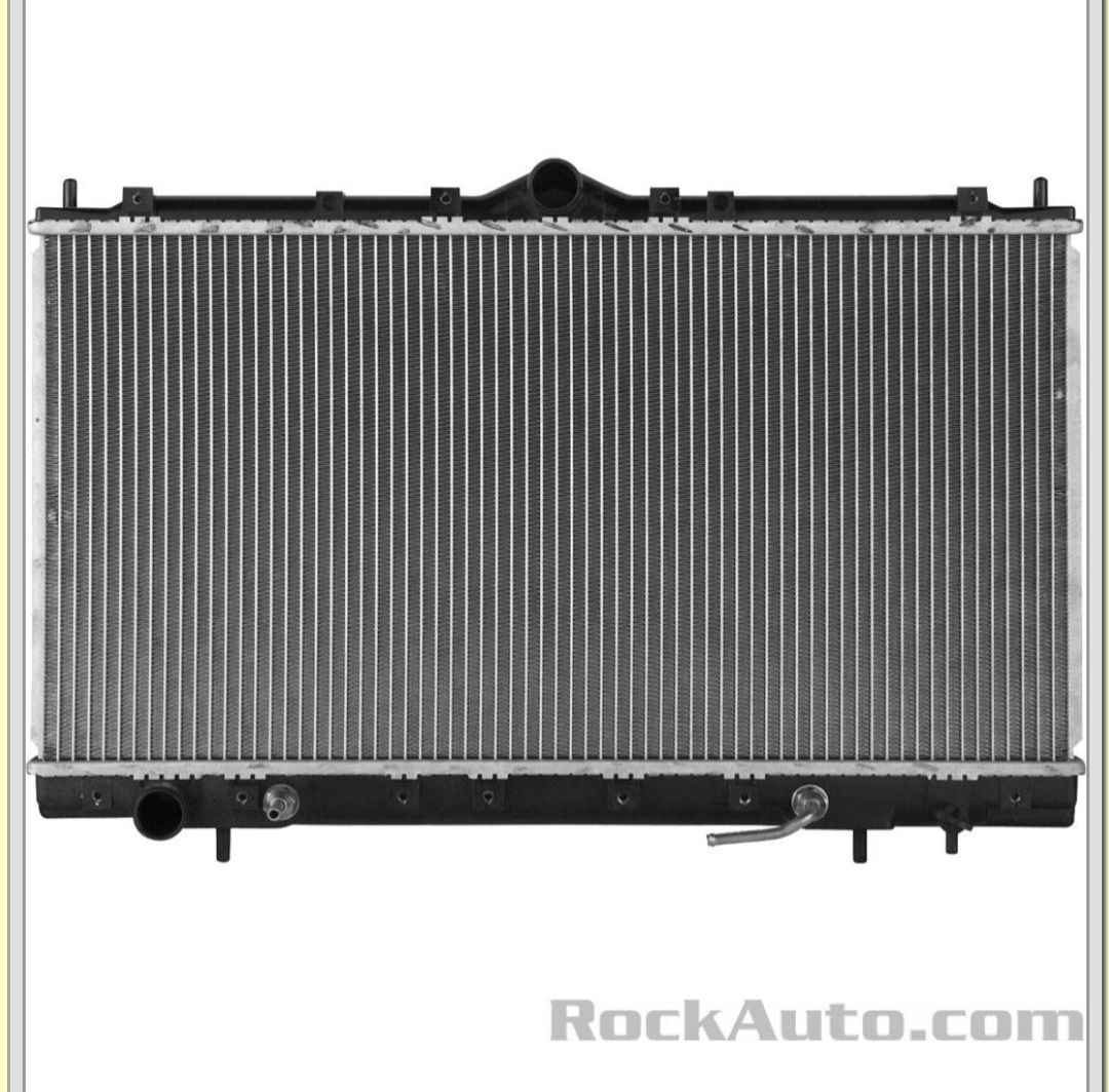

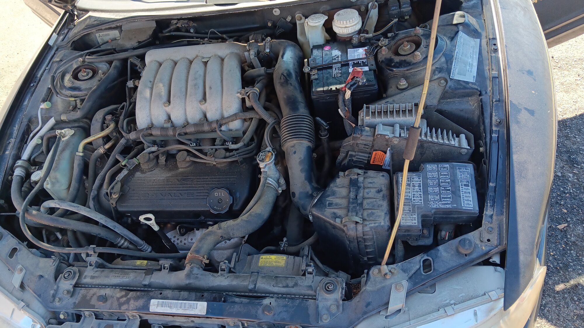

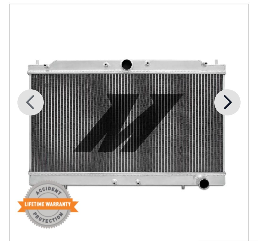

I'm so far ahead of myself, I'm already trying to find a radiator for the car. I definitely do not want to attempt reusing an old plastic tank radiator from donor car. So my first glance at the radiator "wait is that a turbo DSM radiator?" Nope. Unfortunately the lower water pipe is exactly opposite. So it looks like full aluminum is out of the question without waterpipe modification. I guess plastic tank it is. I do wonder about a Honda half radiator, but we'll figure this out later.

As for the radiator I wouldn't worry about spending the coin on an all aluminum one when you aren't going to overheat the stock one with 160hp. And if you really want to it's pretty obvious the radiators are the same minus the outlet port location. Nothing a welder couldn't fix in 30 minutes.
