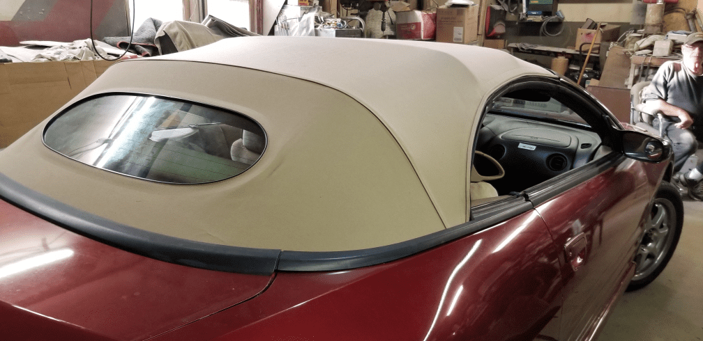

I just put a new top on my 01 last summer and for the life of me I can not remember the exact position of the straps. Unfortunately my car is in storage so I can`t go look right now.
By the pics you provided I think your elastic is stretched and should be replaced also . That big long strap that runs down the side above the windows should be fastened to the bows. starting at the header and then all the way to the back bow . I`m not sure if the 2G has the wide strap that the goes from the last bow down to the rear body line..I am hoping you did not order a Key top.. Robbins or Ez-on are the best tops . Any ways I want to get my car from storage on the first of April so hit me up then and I will try to help as much as I can long distance.. And no brother .. this would not be an April fools joke.. I am a retired upholsterer of 45 years...
