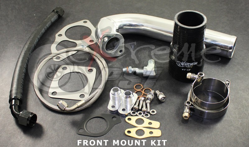

Will this kit work for the 14b turbo? I’d assume so because they share the same TD05 compressor housing?
Yes that kit will work with your 14b.
You have a front mount intercooler already? That J pipe is for a FMIC. If your using your stock sidemount, you will need a different j pipe. Its cheaper directly from extremepsi by the way...
Yea I have the front mount. Thanks for looking out, already ordered it from stm like a dummy LOL.
AND as a bonus you would have actually gotten it from Extreme Psi in a reasonable time frame.:banghead:
