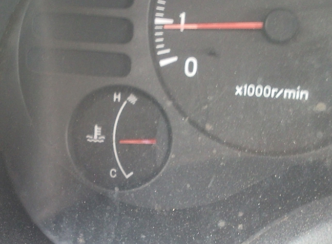

Apparently it was the thermostat. Installed a new 180F thermostat today, and the temp gauge needle holds steady at idle and in normal driving.
I'm going to keep testing it though under different types of loads and see how the cooling system handles it. I don't know if the fan temp cutoff differences from the FSM are due to differences in ECUs, or if the one I have is faulty there. The fans in there look like the original 15-yo OEM fans. Eventually I'd like to have some performance system that can handle extreme conditions that can happen in parts of Cali and SW US.
How are you accurately monitoring coolant temperature? Just with the dash gauge?
I have an OBD-II bluetooth transmitter, and ScanMaster-ELM on my laptop. I'm having trouble getting a connection today, but should be able to set it back up soon.
About the cooling system problems, I think I acquired the car with a bad thermostat, or maybe it was a 195F thermostat, and it finally got clogged/ stuck closed at some point in the heatwave. The needle would always move up a bit under load. Now, it doesn't budge at all from this spot no matter what load I put on it. That I believe is 198F.
