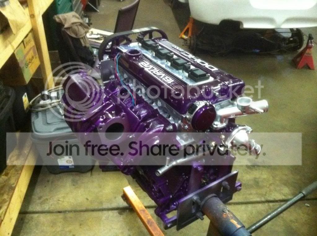

I had a beautiful teal 1997 gsx, till I got in a accident on Christmas eve of last year. I swore I would not get another DSM for a bit and save my money. Well my buddy had a clean 1997 gst. It of course was white and had a great price tag so I jumped on it. We were going to just build a stock motor, then decided to do a evo 8/9 combo. Well I wanted more. We now are doing this.
2.3 stroker 7bolt
Block
• Forged steel crank
• Scat rods
• Ross 9.0:1 racing pistons
• Acl race bearings
• ARP Hardware
Head
• Evo 9 springs, retainers, rockers, lash adjusters
• Evo2 cams and cam gears
• Arp head studs
• Multilayer head gasket
Fuel/tuning/ect
• 1000 cc injectors
• Walbro 255 rewired
• 98/99 flashable ecu
• Tactrix 2.0 cable with cedymods for tuning
• Evo3 16g turbo
• FMIC with short route piping
• C.O.P set up
This is just start. I will be spending money each month on this thing till It is perfect. But here is where I am at now.

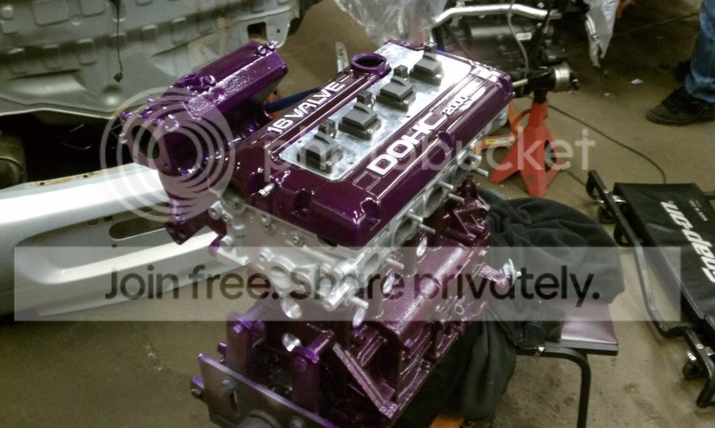

This is where it sits as of the moment. I am going to be getting it running on stock fuel,ecu, and side mount. This is just because my daily driver is not running. Then once I get time it will be time to bolt everything else on and tune.
I am lucky as hell to have a buddy who knows this much about these things, we are getting a lot done. motor is getting close to being all wired up. Ultimate goal is to at least have it started by this weekend, but that is with the limited time we have that our schedule's are both open at the same time. We may be able to do some stuff on it this week but most likley not this this weekend. I will update with pics and hopefully videos if we get that far!
