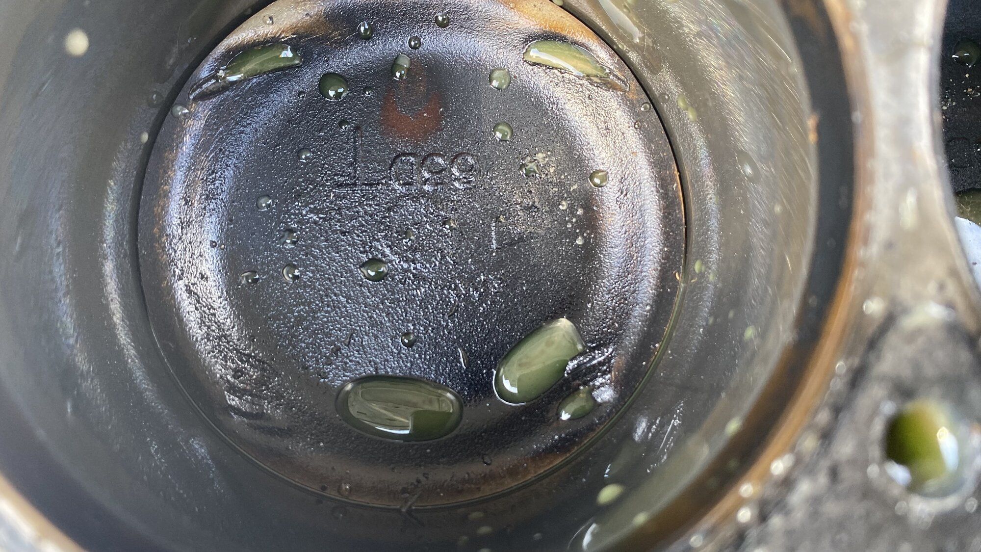

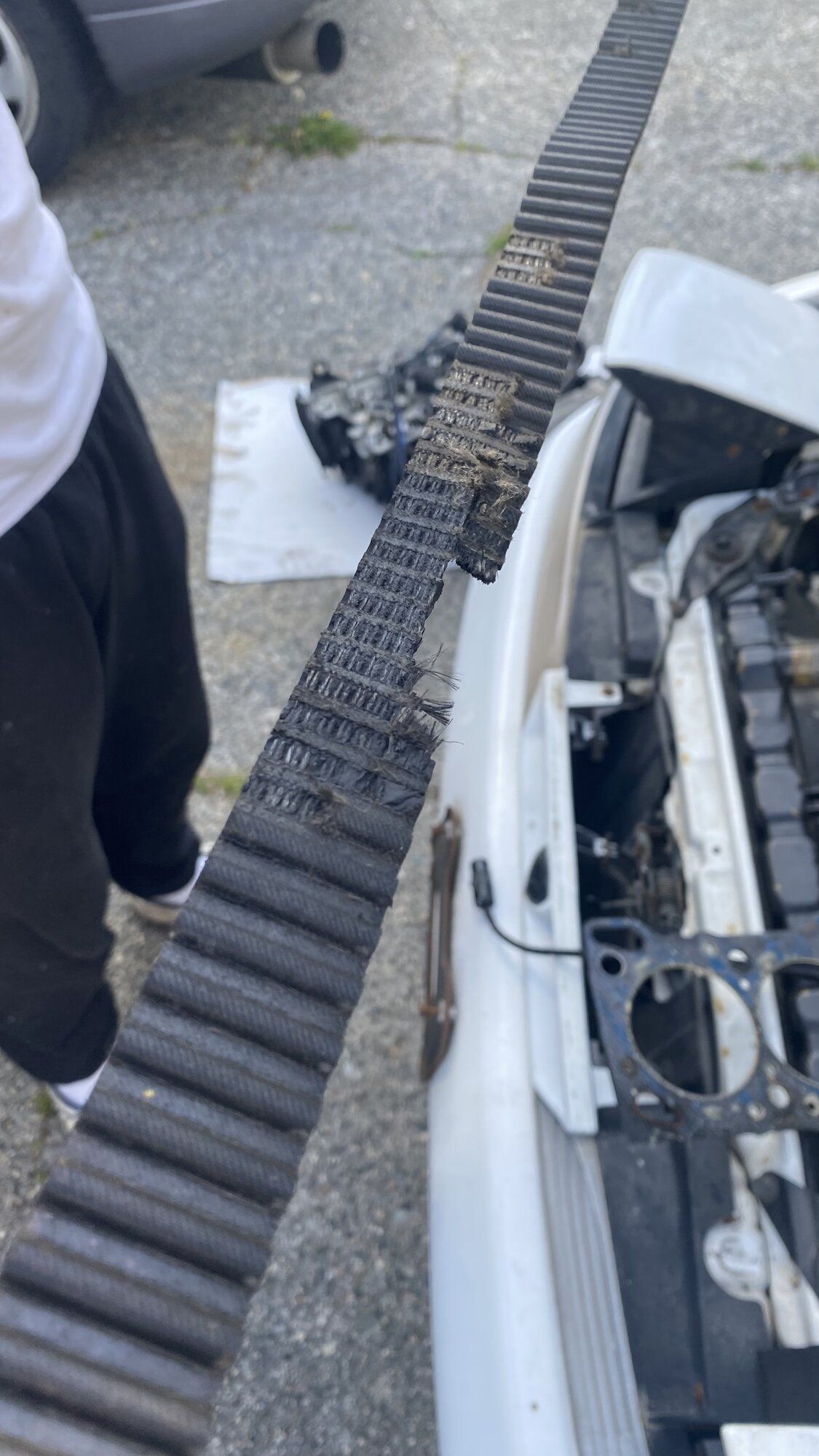

Bought this car for $1100, supposedly had no spark.. swapped the ECU, CAS, PT, MOI relay and still no spark when cranking over. Compression test showed 30-0-0-0, turns out the timing belt had completely shredded on the previous owner, and the crank was not even turning the cam gears over at all hence no spark.

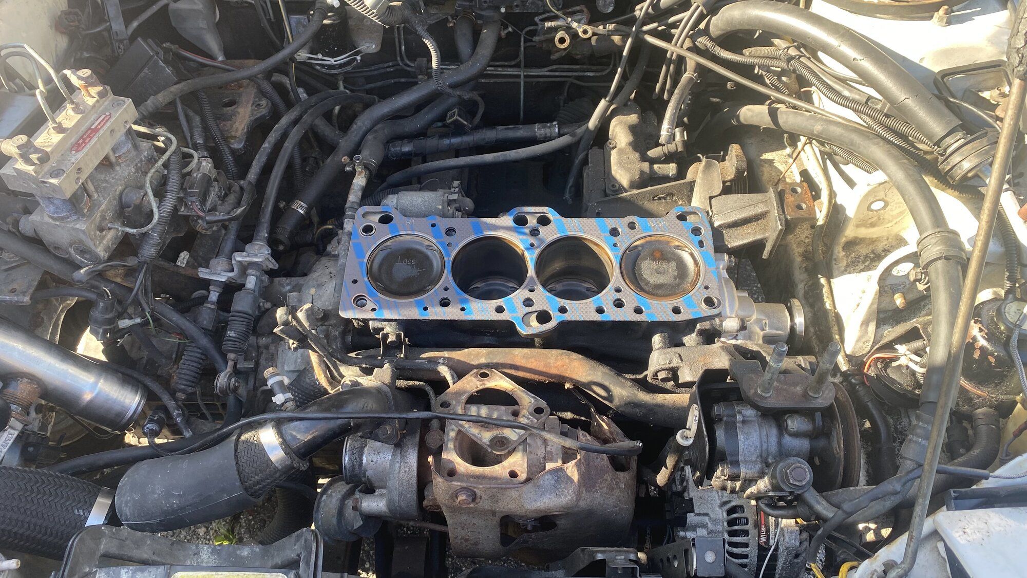

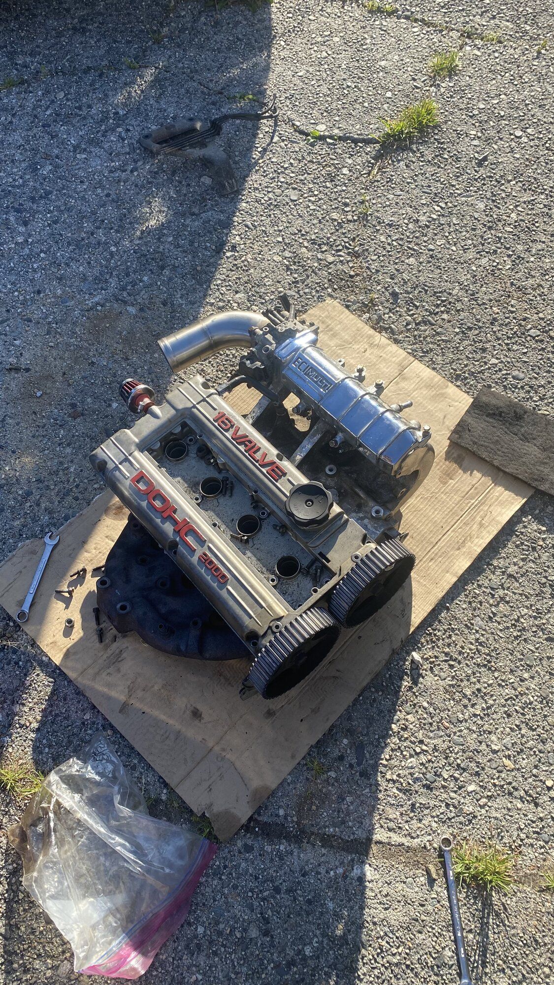

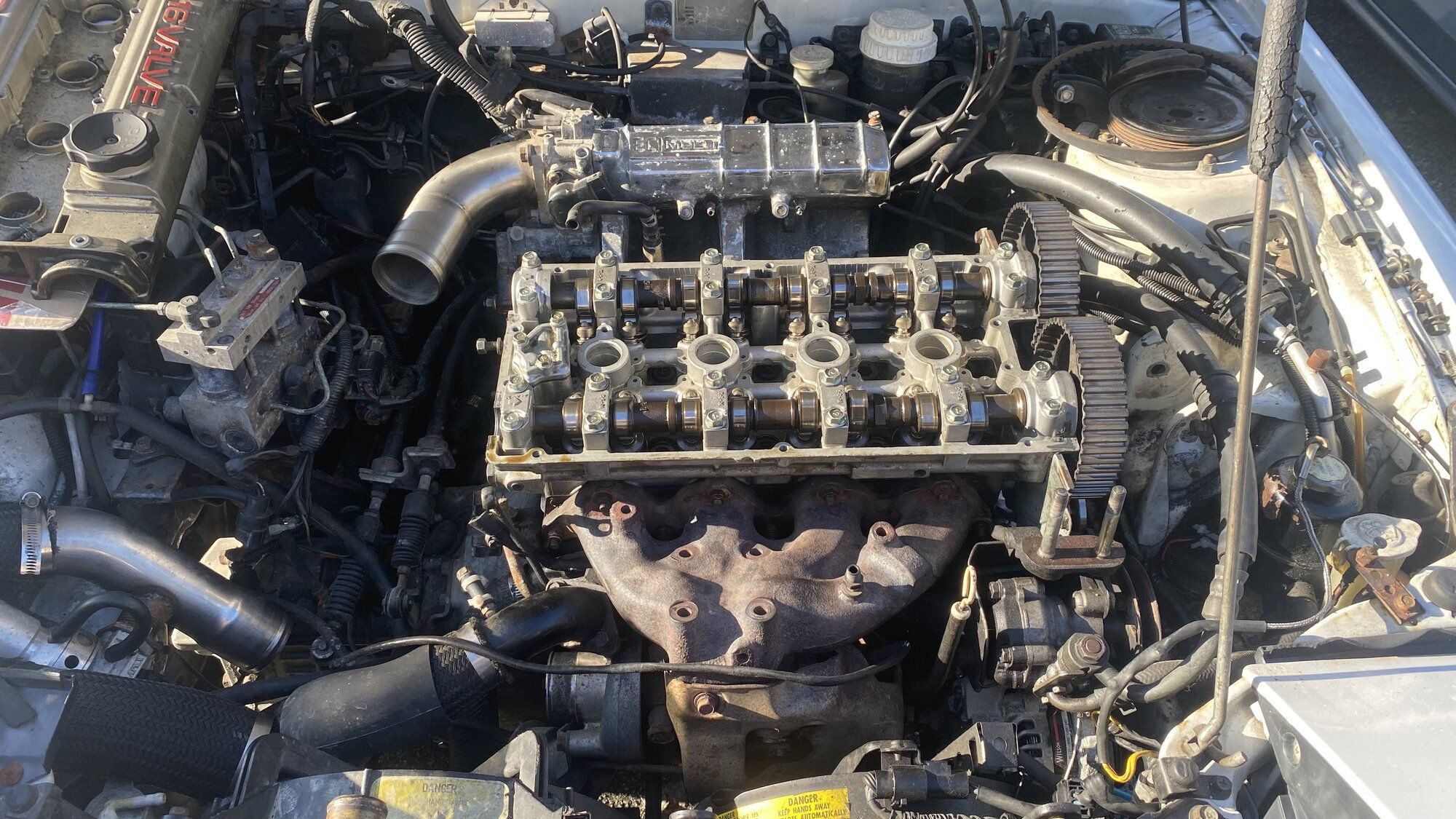

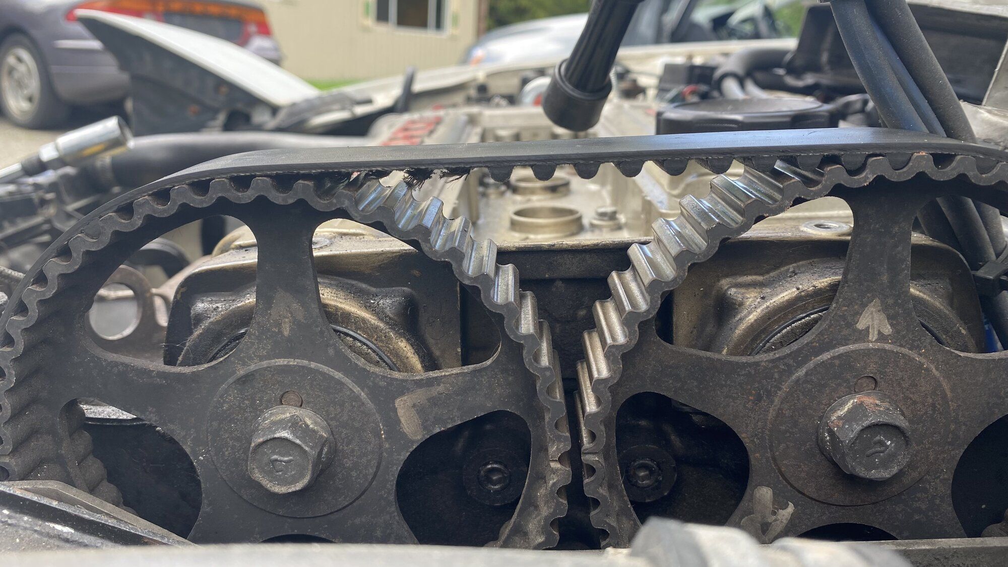

Took the head off and slapped a new head on, was a pretty straight forward job. The timing belt somehow melted on one area.
