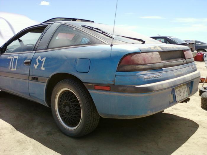

I'm going to start off with the story of the find, which was pretty cool. This 2g was listed on Craigslist in November of 2018 and my friend was looking to get into the DSM game. We drove an hour away to see it and it was in pretty rough shape especially for only 100k on the clock. It was at that time a second owner car, but the current guy lived in a lake community so it was stored outside on the grass, under huge trees. One could only imagine how dirty the car was. He did produce a huge book filled with dealer records from the original owner. The story was that it belonged to a woman who wanted a 3000gt but could not afford it. When she came into the dealership to haggle for one, she fell for this black 1997 GSX which was on the show room floor. Coolest part... the 2nd set of keys was never used! Given to us brand new in a bag. Although the exterior was in rough shape the interior was a time capsule, honestly a 8/10. The car was also bone stock with the exception of Konig wheels and an aftermarket clutch line (which replaced a blown stock rubber one). We picked up the car for I believe $3,800 bucks, and drove it home. Here's some pics of day one with us...View attachment 631462View attachment 631463

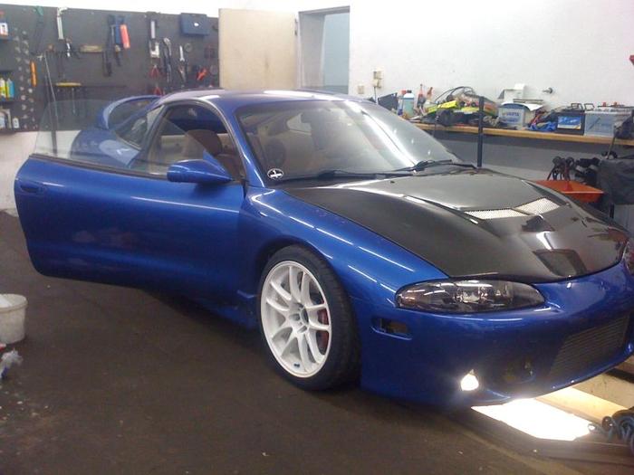

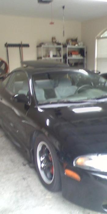

Right after this I began to get the DSM bug back. My 1998 GSX had been sitting for 10 years unused, and in need of a replacement due to body issues (a Virginia salvage vehicle). So I started looking for a replacement car for myself... I was able to find a very clean 1999 GSX which had a bunch of great mods done to it. Best part was, I didn't need any of them. My friend and I came up with a solution... We would purchase the 1999 together, I would get the body, and he would get whatever he needed to transform his stock gsx back to something road worthy.
Another cool story to this is project is that the 1999 we purchased was owned by Turbo Tony of Season 1's fastest car!
Yes, we bought the car from this guy:
This car would later donate the following to the 1997: DSMlink v3, EvoIII 16G, Tokico suspension, VRSF front mount intercooler, Headlights, Catch Can, Short route Intercooler piping, HKS BOV, Speed density setup, 1g Throttlebody, 550cc injector, fuel pump, as well as other countless parts. Any other parts would come off of my 1998, and that is how the "Salvation Army/Good Will Racer" was born. Almost all parts going to the 1997 were re-used from other vehicles.
