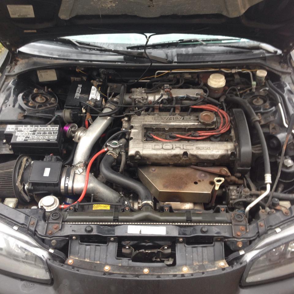

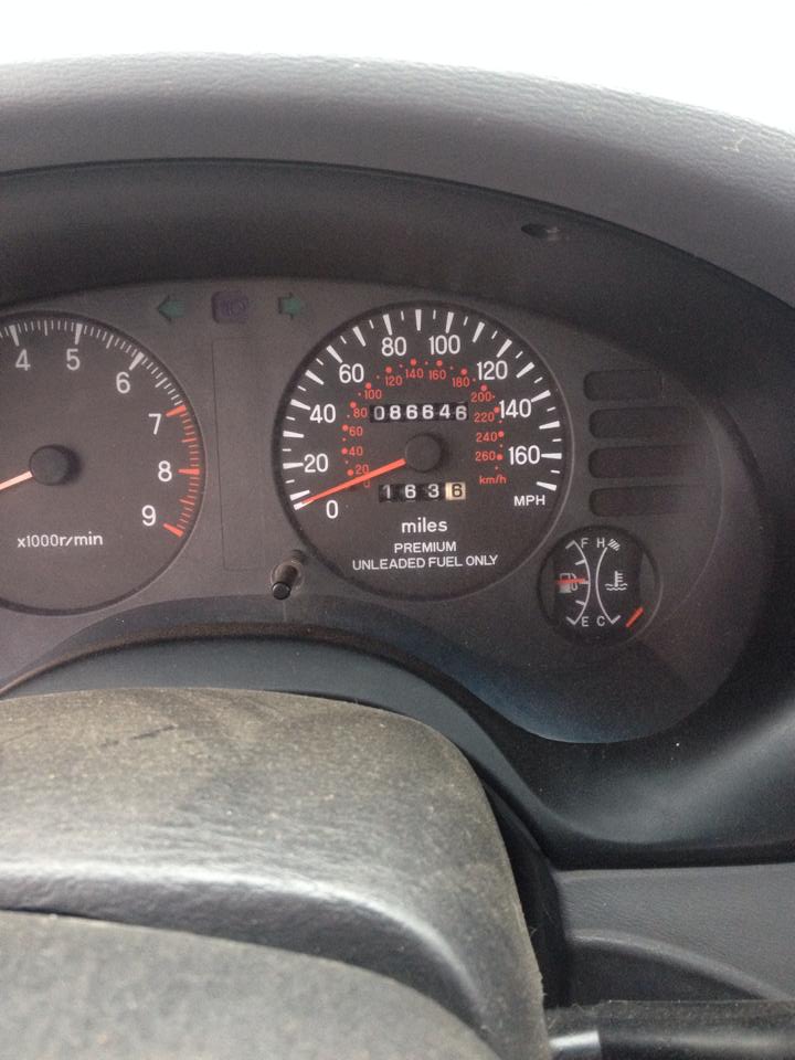

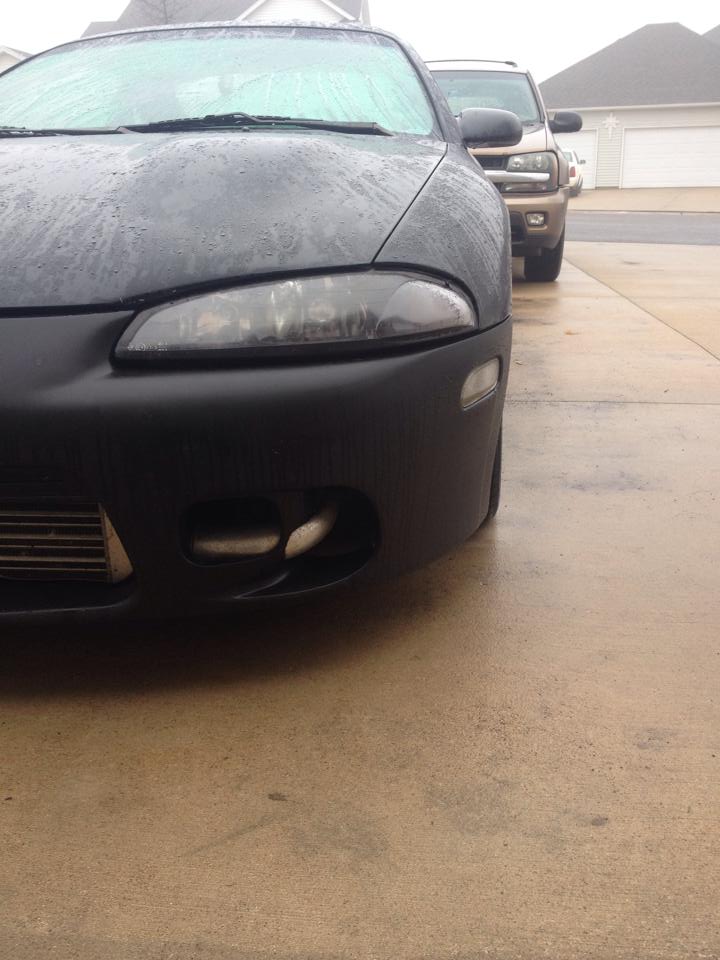

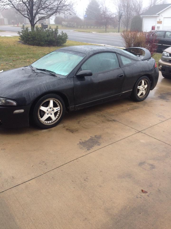

Well, after 3 years almost of being out of the DSM game, I'm back. I was referred to the seller of this car when a friend of mine informed me that a guy about 2 hours away was thinking about crushing a GSX with 86,XXX miles on it and it ran.
When I arrived I found a neglected but gorgeous Kalapana DSM. Of course the starter was crap but when I started it by popping the clutch it started right up and idled perfectly. So I pulled the trigger seeing how the price was less than $2,000.
After I brought it home I made an assessment of where the car stands
1) Has one or more collapsed lifters

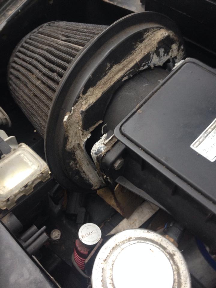

2) Has a hacked together airbox and miscellaneous hacked wires that need to be cleaned up or replaced.
3) The Glowshift gauges have to go
4) Theres duct tape on the front control arm for some reason
5) The O-Ring on the power steering pump needs to be replaced or I need a new pump, period.
6) The valve cover gasket is leaking and needs to be replaced.
7) The starter motor is shot and needs to be replaced
8) All of the accessory belts are good
9) The exhaust needs to be replaced
10) The paint is fading in many places and the clearcoat on the hood is pretty bad
11) most importantly, I am still in absolute love with this car.

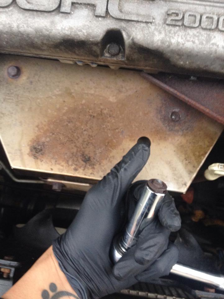

Well I started getting into the car today to see where I stand and of course 5 seconds in a snap a bolt from this stupid exhaust manifold shield. Its a good thing its not the one I planned on keeping, huh?

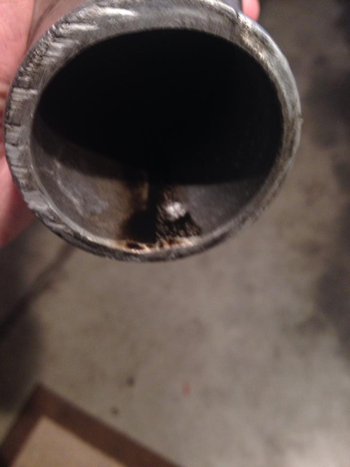

Also I took the hard intake piping off and the hacked intake only to find oil sitting at the bottom of it which I can only assume came from the cold side of the turbo.. I'm more excited to see what other surprises I have in store for me upon further inspection.. NOT

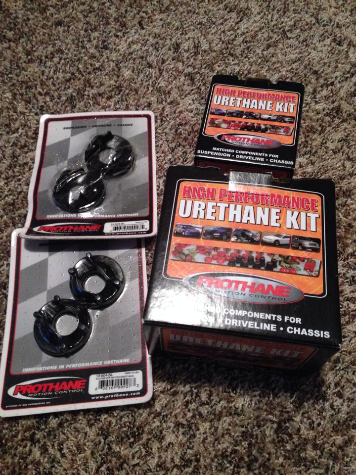

My polyurethane motor mounts came into today! The ones currently on the car are rotted to hell so I pulled the trigger on these Prothane brand polyurethane mounts. The quality of drive can't be much worse than what it was so its got to be an improvement!

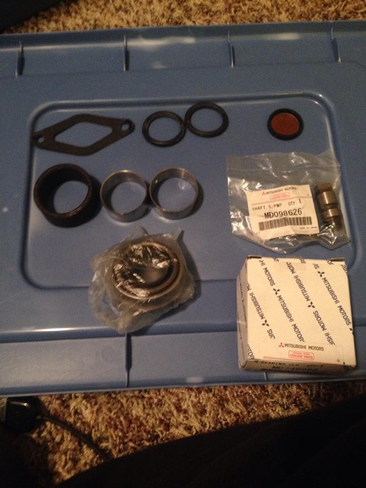

And I received my Balance Shaft Eliminator Kit today which I'm pretty stoked about.

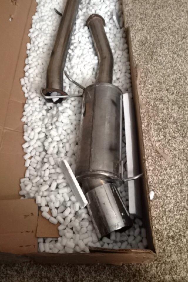

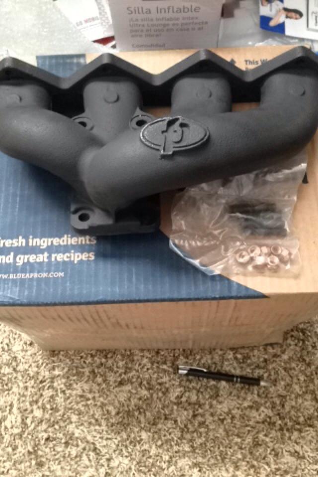

Its been too damn cold to work on the car so I'm just compiling parts. I got my Thermal R&D exhaust today so I am now in the hunt for a the best downpipe to match. I know I'll have to have an exhaust shop do some fabbing. I also got my FP exhaust manifold back from being ceramic coated so I'm pretty stoked about that.
