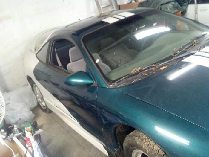

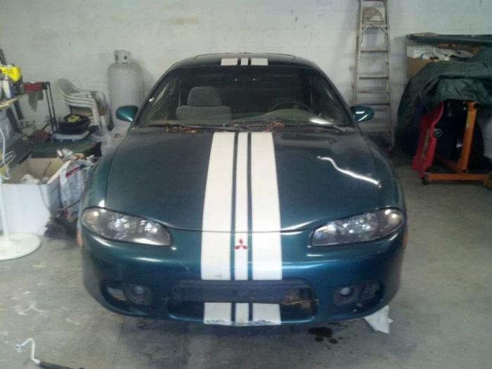

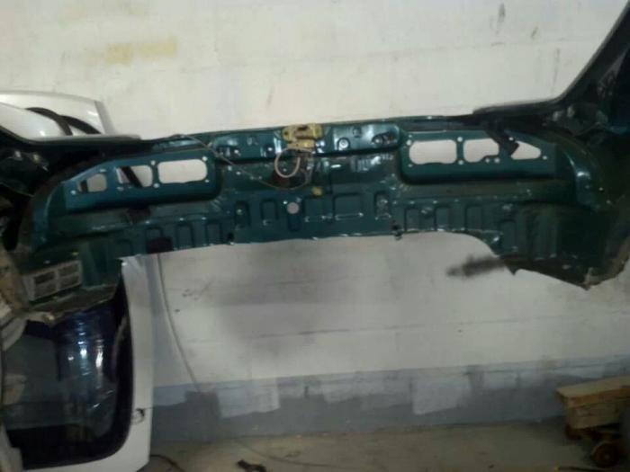

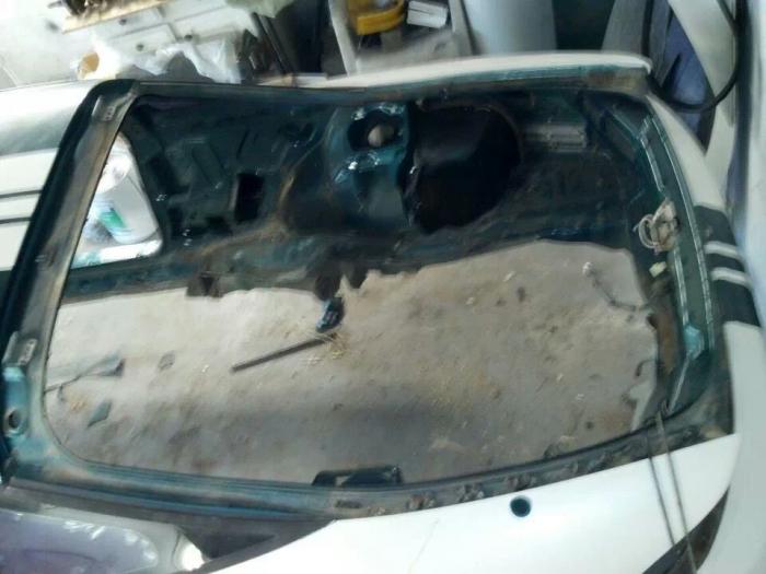

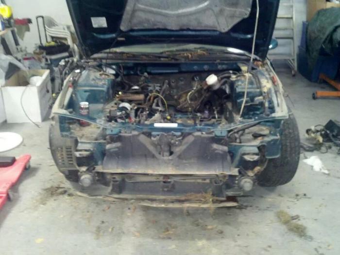

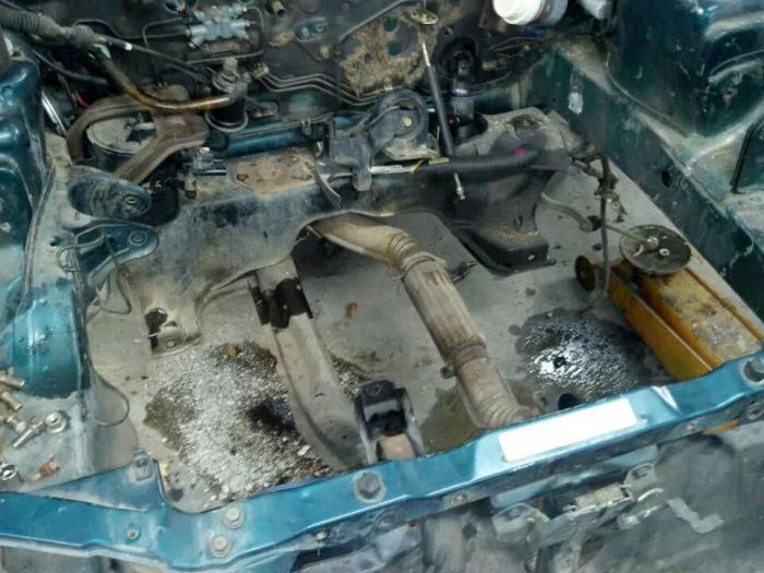

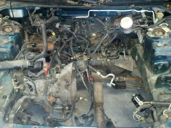

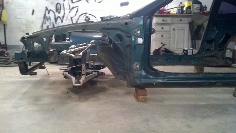

First set of pictures. The day we got her home.

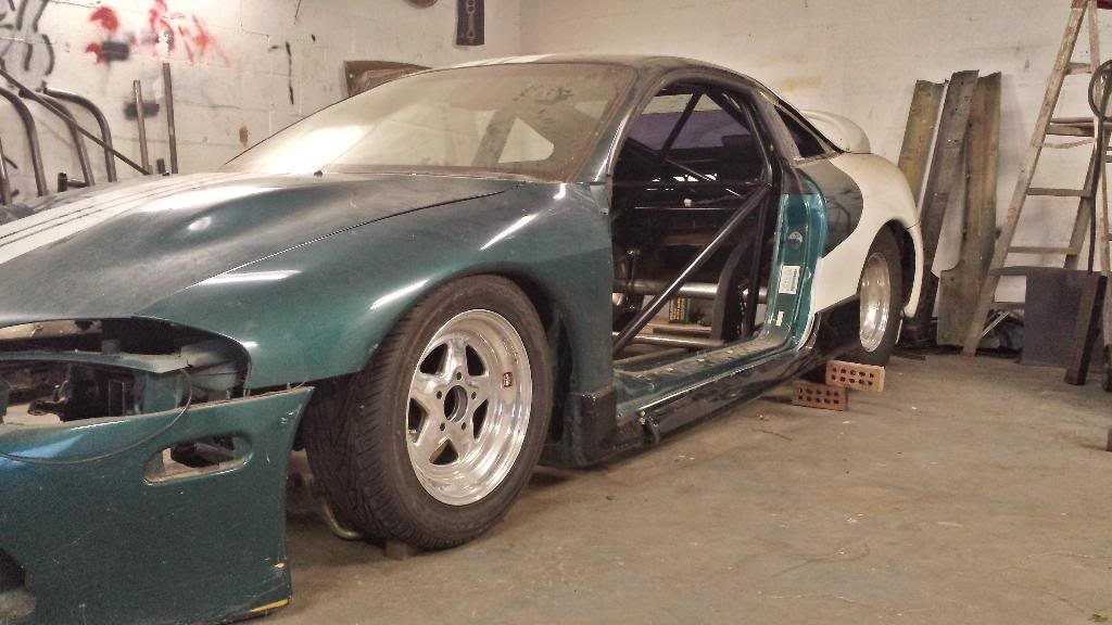

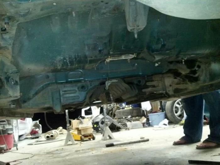

Oh I have a few more of these little quick updates since we're about 6 months actual working time into this build already. Actual elapsed time is probably about a year and a half but it's slowed down a little bit due to me buying my first house. And at first we had decided to go with and LT1 because I bought the whole front end from a C4 corvette to run as the front suspension and cross member in the car but the more we thought about the more we wanted more modern. So we sold the LT1 and bought an LM7(basically a 5.3l LS1)

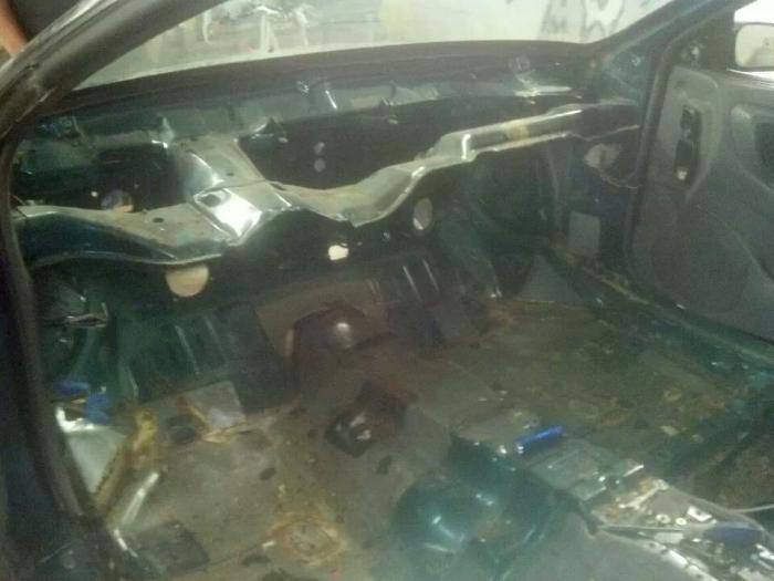

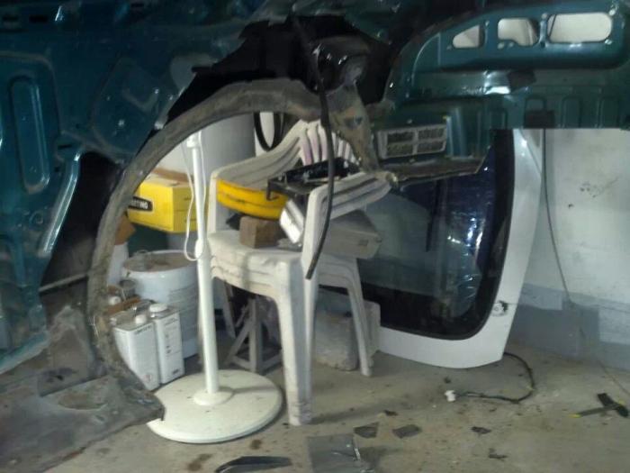

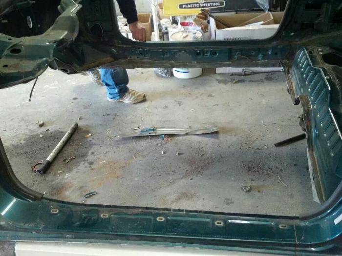

Won't seem to let me upload anymore pictures though. Says I'm over my quota and I have a good bit of progress to show from chopping the floor pan out. Any advice for me or is it because I'm still a probationary member?

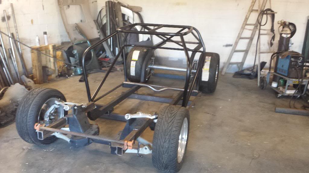

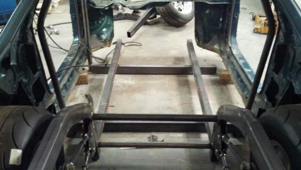

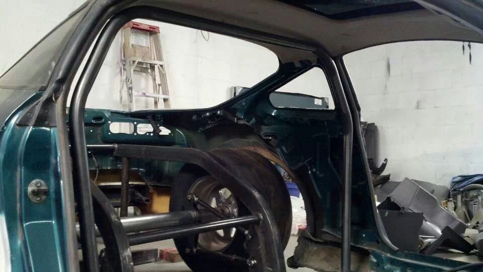

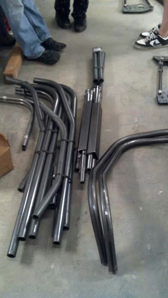

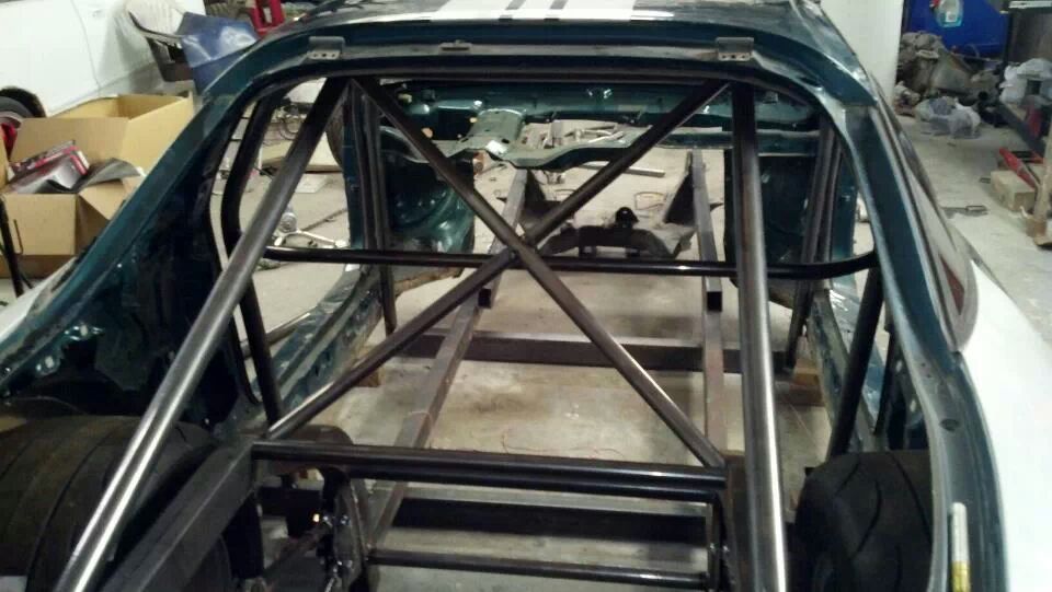

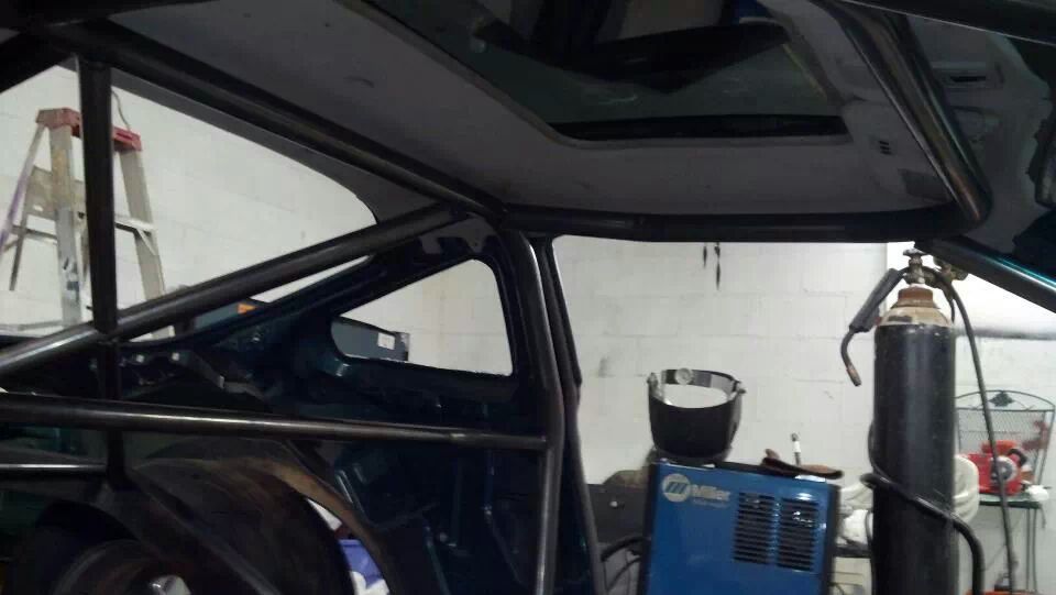

Alright cool. I appreciate it! So next up for photos I have a little bit of everything a few of the roll cage as we got more and more of it in.

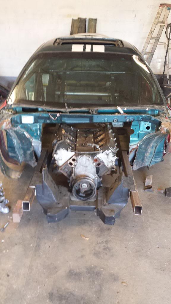

And some pictures that show the corvette front end were repurposing
This is one of my favorites just because at this point people had 0 clue that this fits in an eclipse.

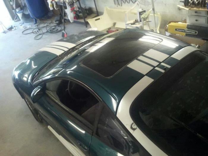

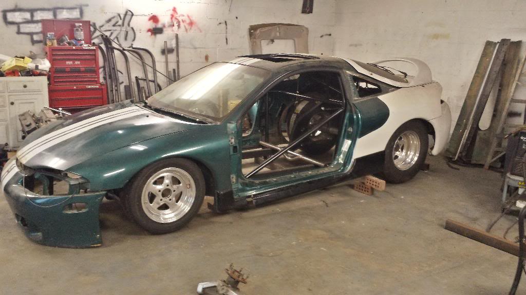

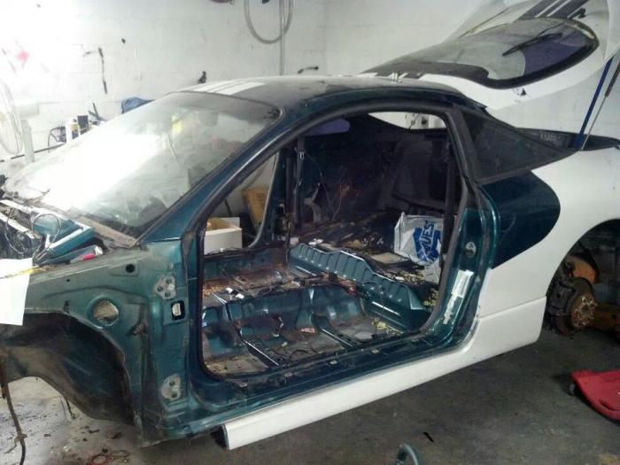

And finally pictures from pretty recent. Finally have the body sat down on the frame and the cage welded up good. Oh and also a big note here. We don't want the car getting crazy when we're at the track so we decided to do a little stretching. In these pictures it's only about 4 inches(102 inches total) but to keep the engine from sitting damn near in the car our wheelbase will be about 108 inches when complete. To get a good idea of what that is a 2000 Camaro only has a 102 inch wheelbase.
