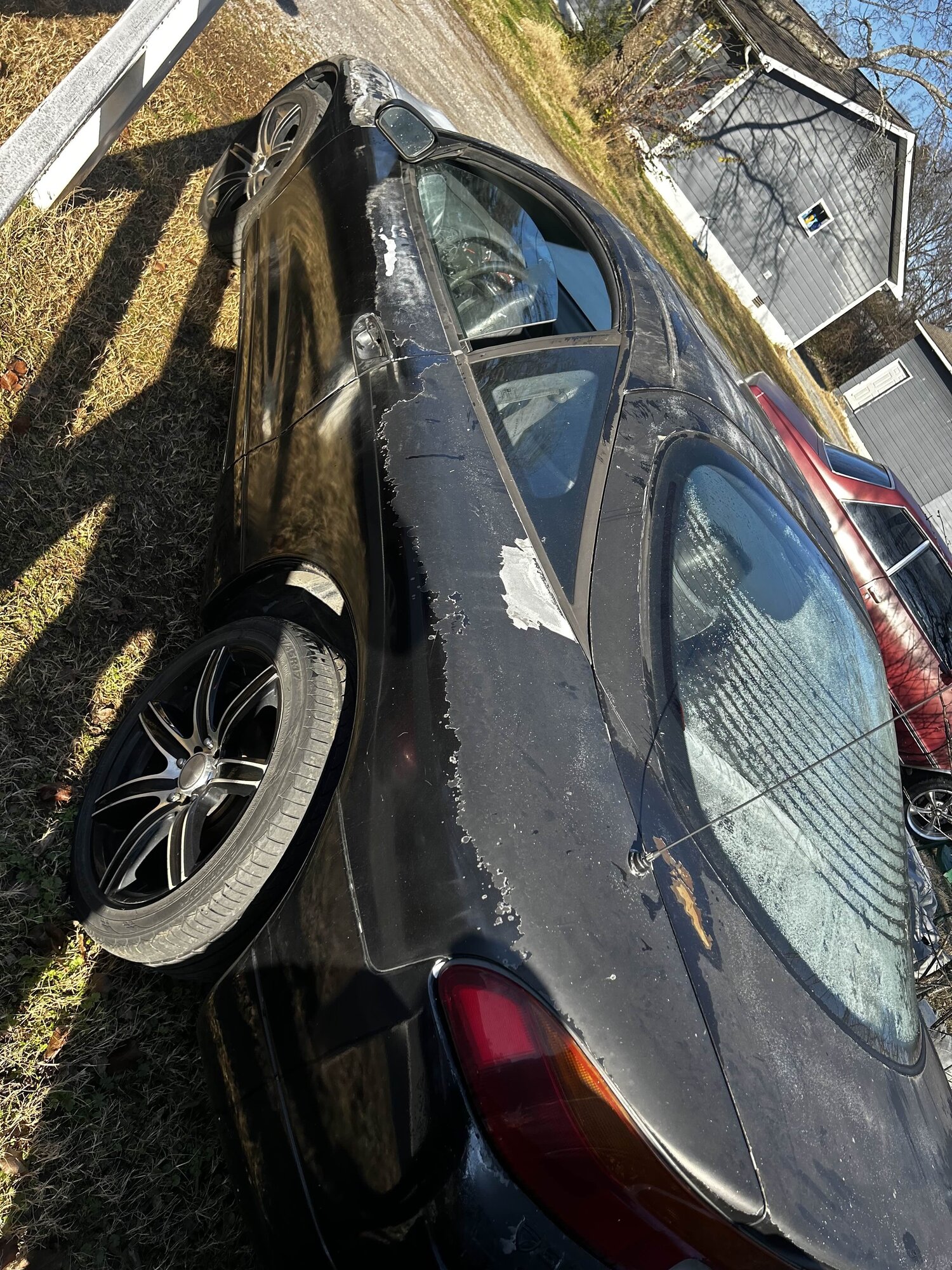

  • The paint. Enough said LOL

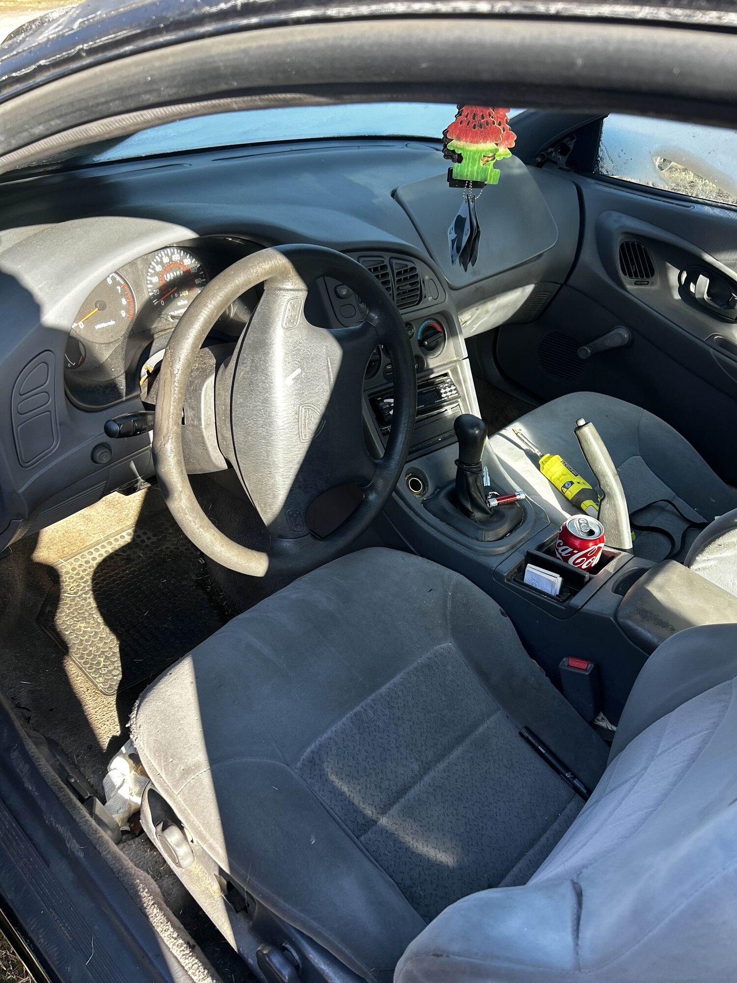

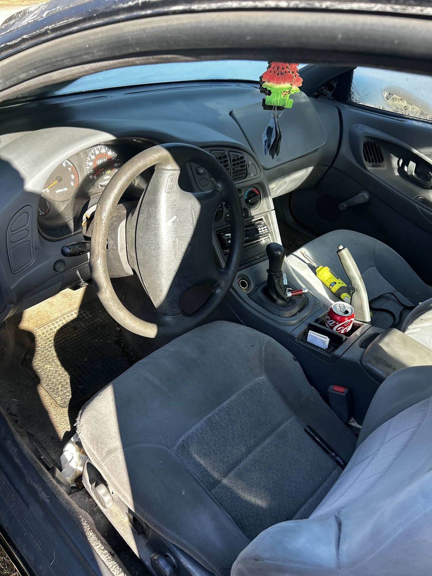

  • Random interior/exterior bits are broken or missing. Trunk latch release handle on the inside is straight up gone, glovebox doesn't stay up, both exterior doorhandles are completely f'ed up, and more I'm likely forgetting.
  • The key is bent. Still manages to start the car after some jiggling, but doesn't fit in any of the lock cylinders.
  • Radio looks shot.
  • Wheels are ugly and one of the 4 is broken, meaning the rear left wheel is mismatched to the others.
  • Muffler rusted off (but is that too much of a problem?)
  • Tires are worse than useless.
  • Sunroof mechanism isn't great shape.
  • Despite the interior being complete, the headliner and visors could certainly use some love.
  • Battery is trash.
  • No power steering, and no explanation for why other than it doesn't work.

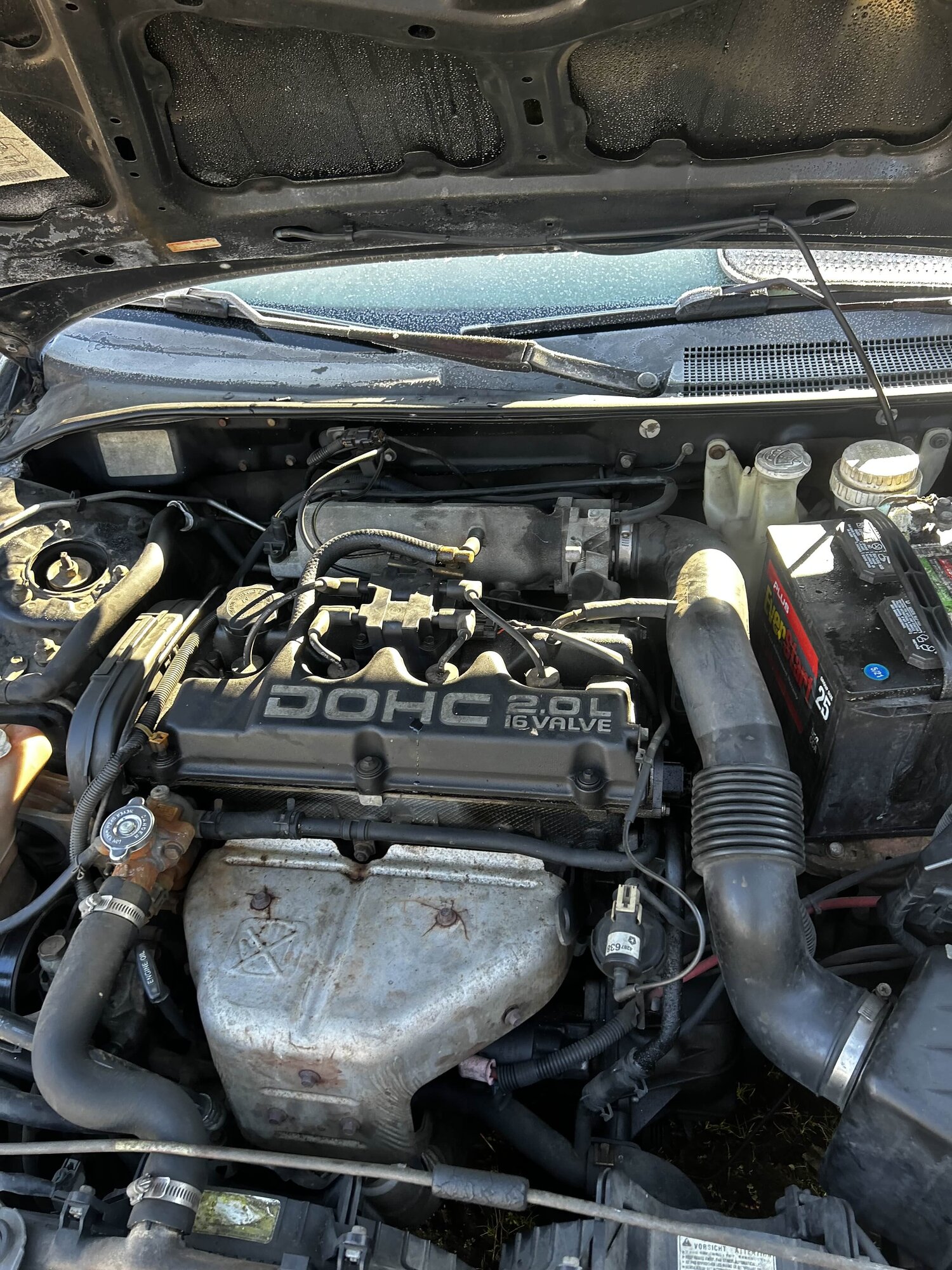

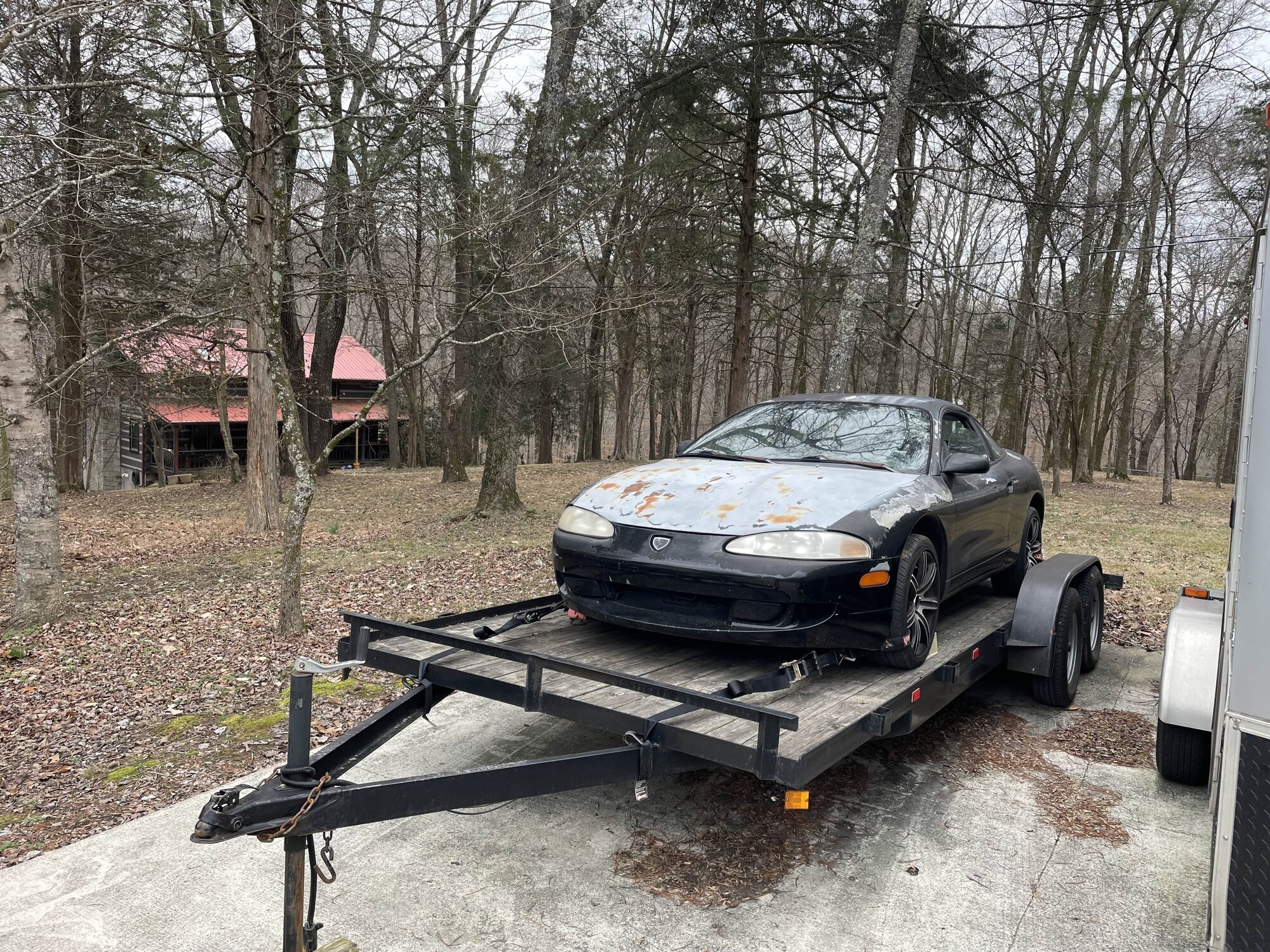

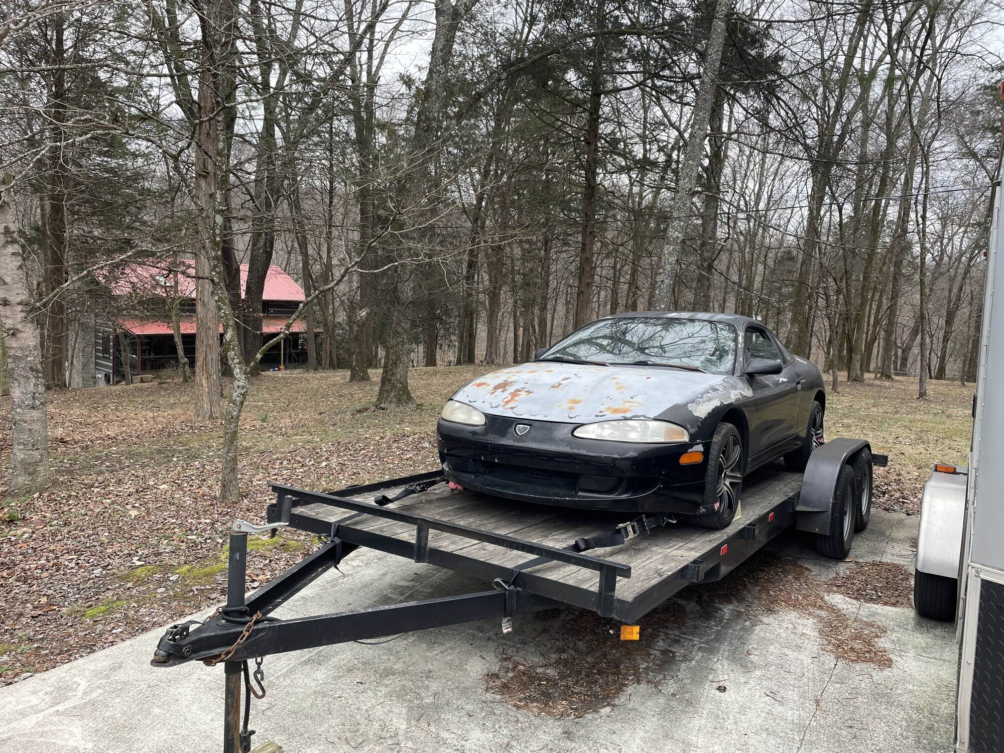

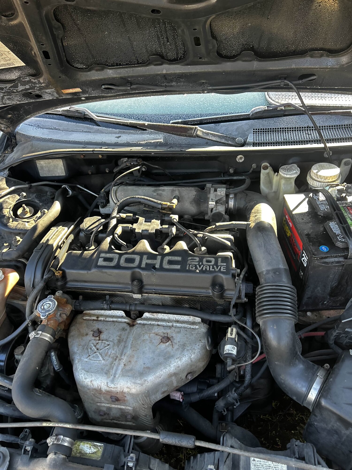

Finally back at home in TN for my spring break! Ended up taking the car cover off of this car to clean it out a bit and take a look at some of the paperwork. Also took a look under the hood to take stock of what parts need to be ordered to get this thing running again. Thankfully, it doesn't seem to be too much! The car was also registered in Feb of 2023 with the tags expiring in 2024, so in theory the car ran at least for some of 2023 and gives me confidence that it won't take too much to get running :cool:
Plan is to roll the car off the trailer it's parked on and get to work cleaning it out a little bit better, as well as installing the exterior doorhandles that my dad picked up today. Thanks @IHeartMyHonda !

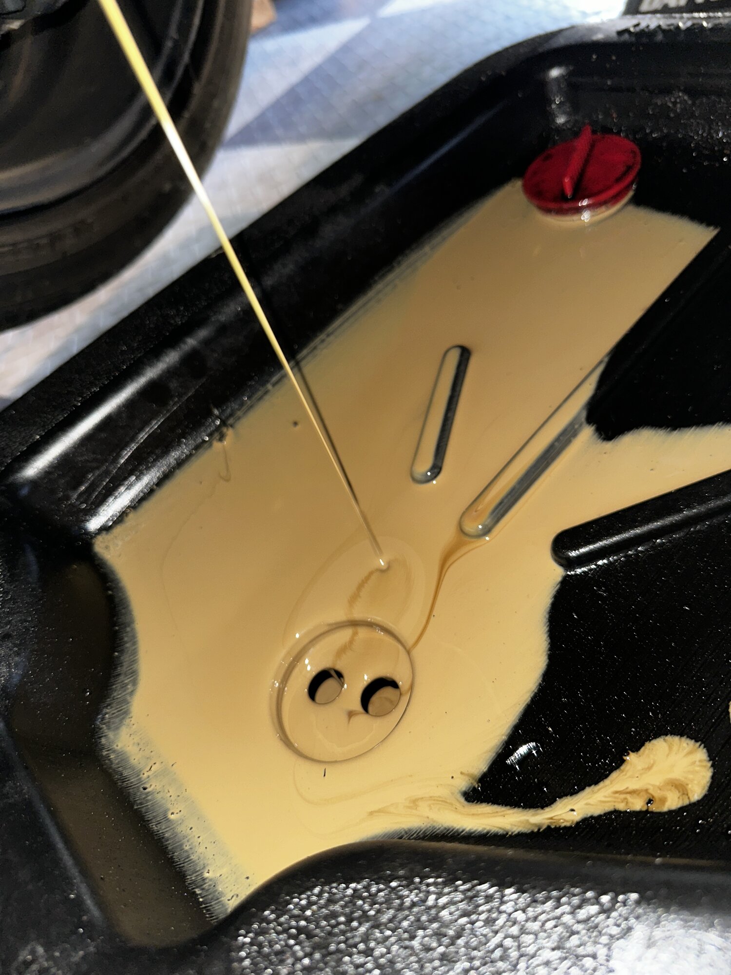

I can pretty confidently say its likely got a few vacuum leaks, but I started addressing other things like fluids after letting it run for a sec. Sadly, this image is what “other things” happened to be.
Ive got some rad hoses and other things on the way since things started breaking like crazy when removing them, and then i’ll re-fill it with fluids to see if the headgasket is bad or not. Bummer, but at least im not relying on it as a daily :p
Don't waste the fluids. Rule out where oil and coolant can mix. Leakdown alone will likely point out headgasket. Other possible areas are oil cooler and turbo. Both are easy to bypass or test to see if problem returns.
This is a 420a car so no turbo or oil cooler to look into, but yeah thats definitely some good advice.

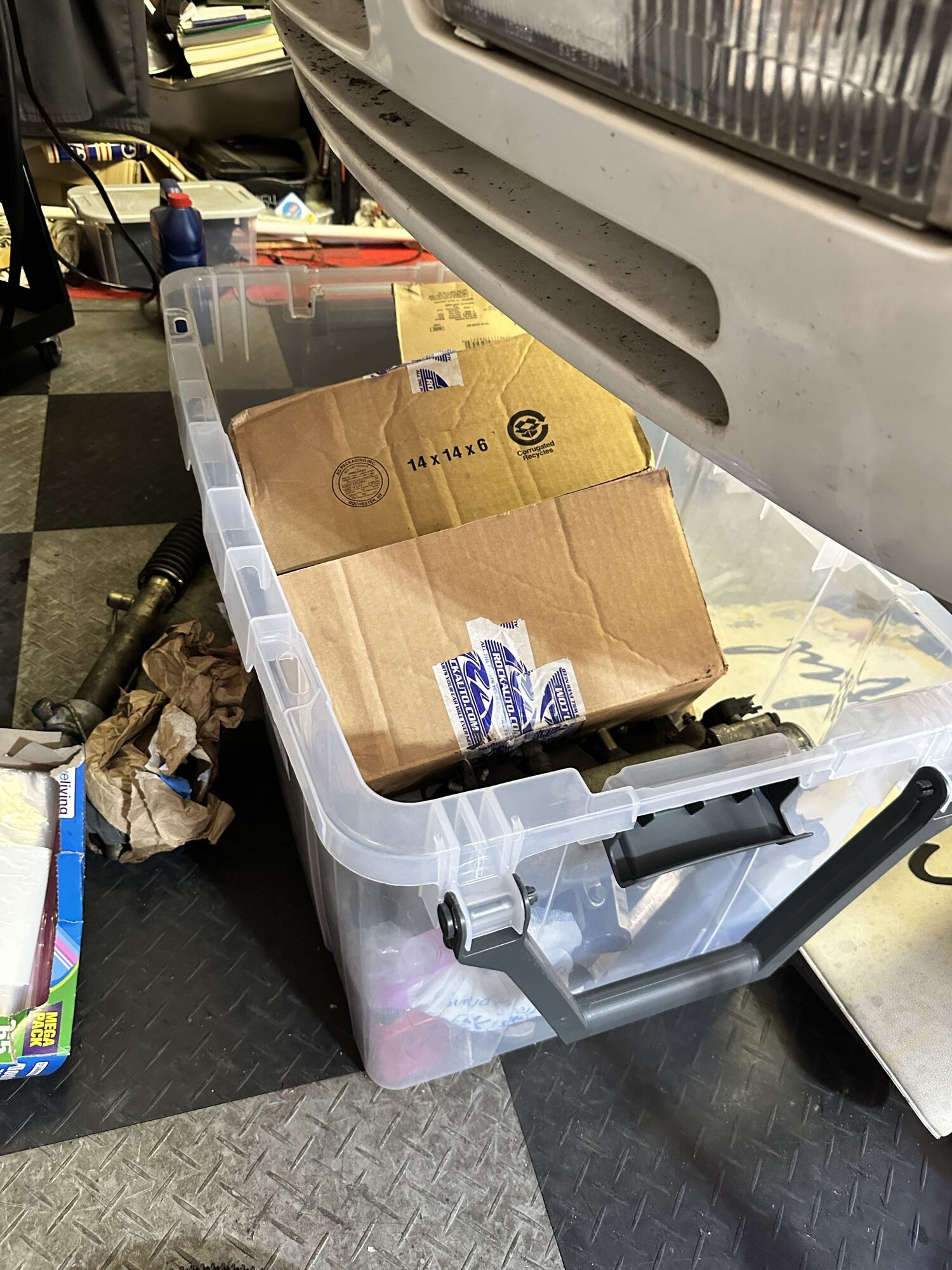

Collected all the parts I have for this thing together, ready to go to their future home alongside the car. Well, everything mechanical at least. Theres much more still sitting in the car.
Its really a bummer that this car hasn't sold yet. I was hoping to move this car along to someone who wanted it more and would put the pieces back, but haven't had much luck to be honest.
I don't have too much longer to hold on to this thing either, its taking up too much space in my parents driveway and we're getting to a point where they aren't able to be as patient with me anymore especially with the new Eclipse.
Re-posting it in the classifieds again soon. $500 gets it and every part I've accumulated for the 420a platform.
