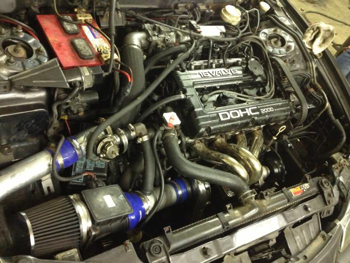

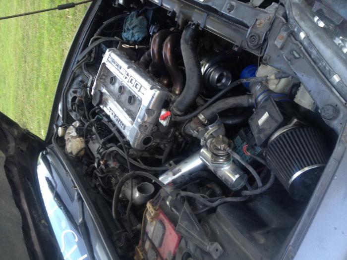

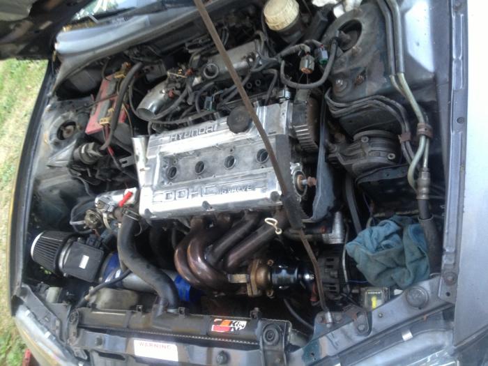

I don't think my picture posted..

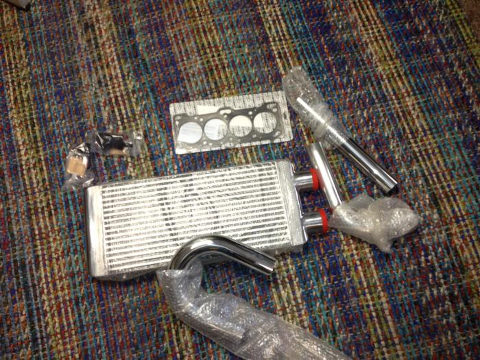

got some more parts in! If I could just sell my bike already, I'd have it finished very shortly after.
The intercooler you got there and the pipes will not get u to 500hp ! The intercooler is junk and the pipes don't even have beads on the ends . The cuppler is gunna just shoot off
I live in fort wayne indiana but i dont know how much help i would be, i have never built my car for that hight of hp but im willing to try to answer any of your questions! good lick with the build man!!!
yeah LOL thats a drive from me, Im from Greencastle, cars in Brazil..
-Buddy of mine makes 446WHP on cheaper IC, and pipes. Not knocking your advice, I have a tool to make the lip on the pipes if need be, but theyre getting welded together. to make two pipes with only a couple couplers. If the don't hold up, ill get some nice ones when it comes time.
Oh. and I didnt buy an "intercooler kit" LOL. This whole car is being pieced togehter slowly
That intercooler is probably going to be a bottleneck in your system if you are shooting for almost 600whp. Judging by the design, it looks like it will get heatsoaked fairly quick and if you can't keep those intake temps down, you will never have consistent power.
I would look into a VRSF front mount kit. They get the best reviews and for $309.99 a kit you can't beat them.
I can agree with this. The more and more i see other peoples builds, and research. Im gonna be looking into getting a new one, and yeah I've heard good things about the VRSF. Honestly probably going to be the route i take.

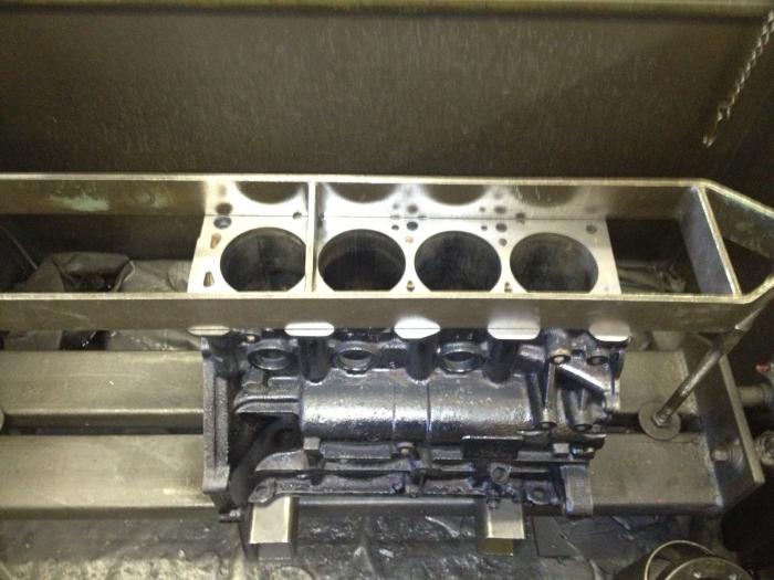

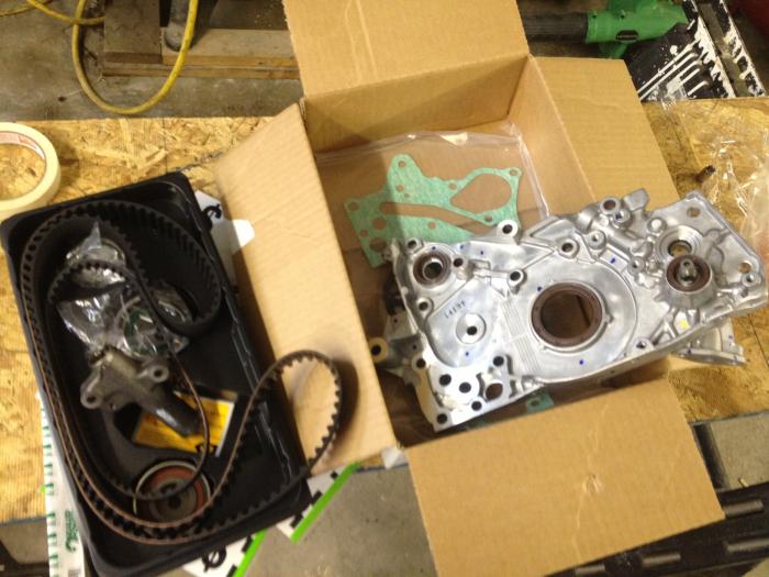

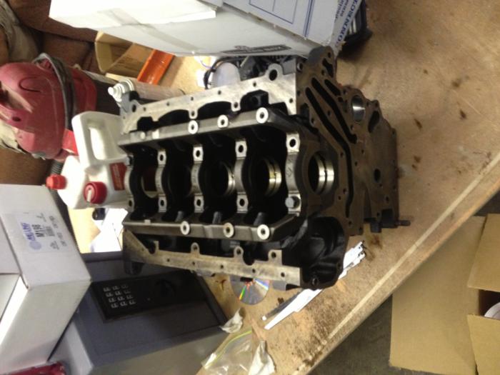

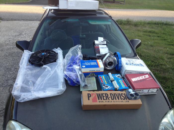

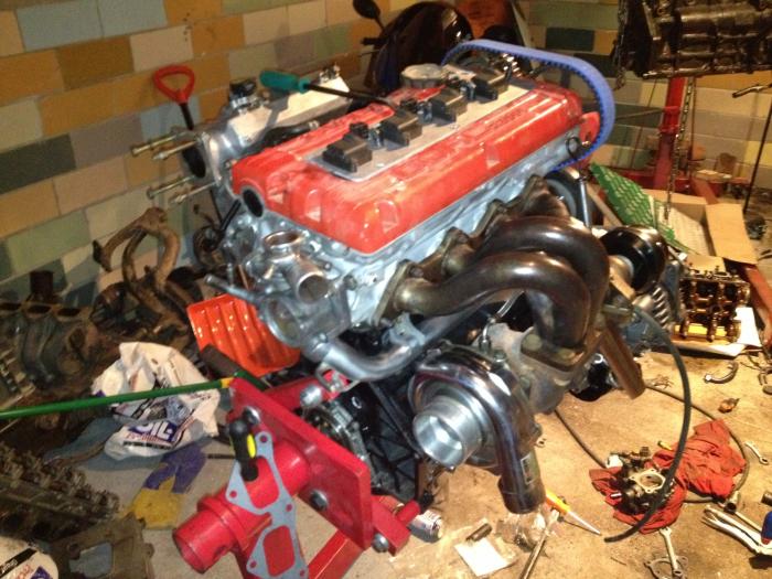

Its SLOWLY coming along. Dont have much time to work on it, and funds are running low from my other dumb hobbies LOL. Heres some new parts that came in. Looking to have the engine assembled in the next month or so. Block is going off to the machine shop shortly. Getting a fresh hone, deck, and possibly line bore (if needed). Not using this Tbelt. have a gates racing (timing kit is gates) oil pump is oe
oh, one more thing. I have also decided not to go with the BSE pictured above, I ordered OE parts to piece one together.

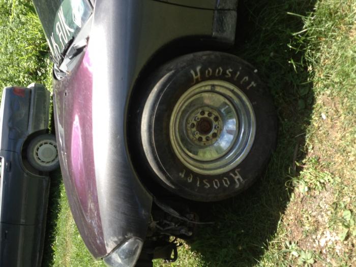

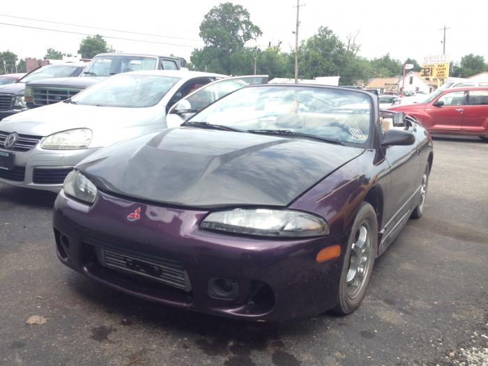

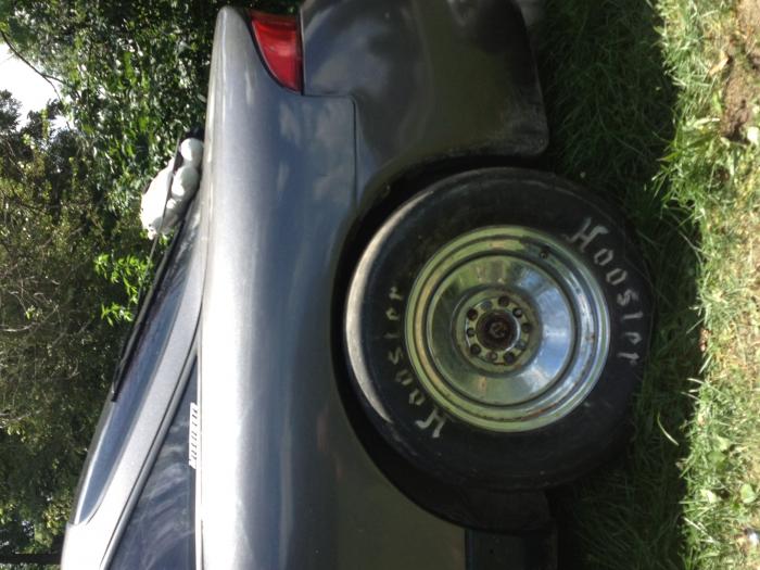

I think Im gonn go VRSF. And yeah ill post some pics of the actual car, and whats still on the car currently very soon :) I have two slicks on it now, LOL no hating just checking for fitment.

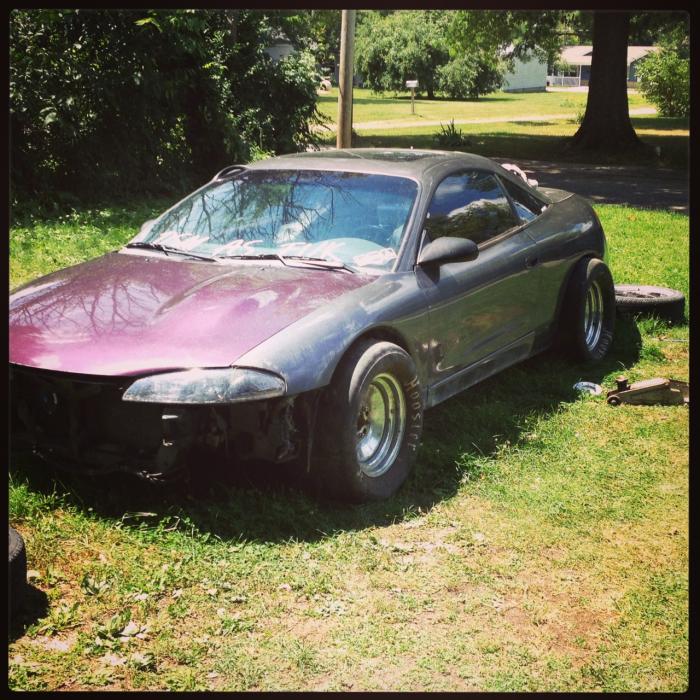

I may have posted some twice, so I apologize if so LOL.. HERE is what I'm sinking all my money into LOL. Dont mind the sticker, I was a dumb teen once LOL. The purple gst spyder is my female friends, hood is mine LOL.
Oh. and all of the pictures above are just whats done to it now. My list way at the top, is whats being sunk into the car. Should be fun for a while.

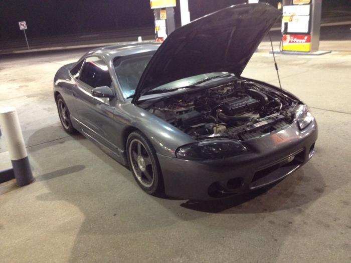

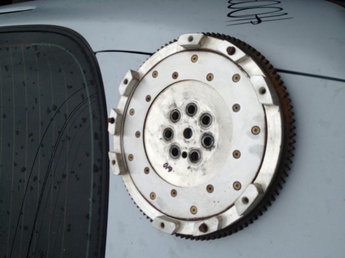

heres some more pics of the car as it sits, parts should be getting finished up in the machine shop within the next couple weeks :hellyeah:

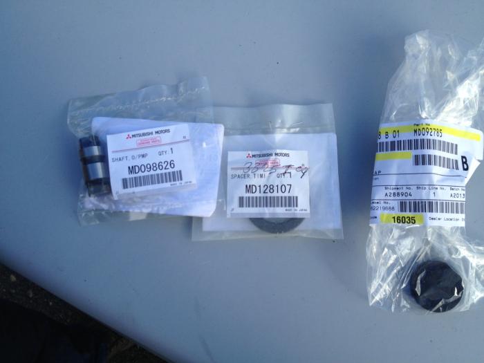

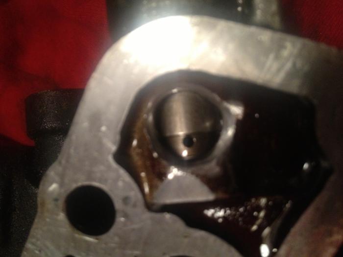

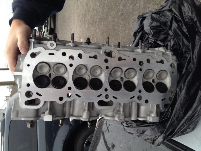

threw that junk BSE kit away, ordered some OEM parts from the dealer (got this list from a thread on here
can anyone confirm i got the correct parts above :) ^^^^^^

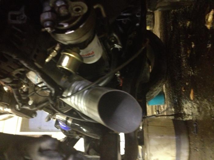

hey, how bout some pics of how you ran your exhaust? Im wanting to keep my ac and have a very short 3" vband. I dont want to be breathing exhaust fumes at a light though. Im thinking of dumping mine downward right past the firewall so its only about 5ft long total.
nvm, i know how you did it, you didnt have to worry about IC piping. Its wide open for you to dump down right there.
Well the IC pictured up there isn't bring use anymore, I went with the vrsf kit. It's just going to be a 90 right off the turbo, down a couple inches and another 90 heading towards the driver side as its going to exit the bumper LOL. It's not going to be a daily daily. Track and weekend toy.
You've probably figured it out by now, but yes those are the correct OEM BSE parts. Great build!
yeah LOL, i just have no confidence in myself, so Im slowly freaking the fu*k out cause its going together like next week. LOL. Still need to brush up on timing, BSE install, what i can and can not delete off my firewall, and just alot of stuff.

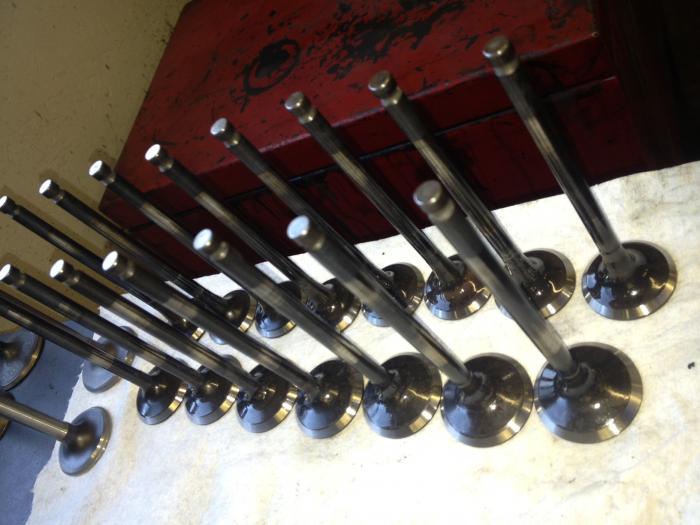

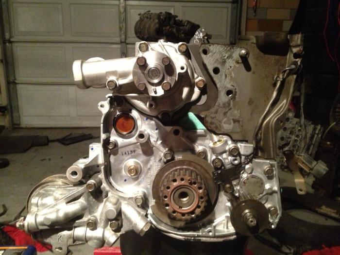

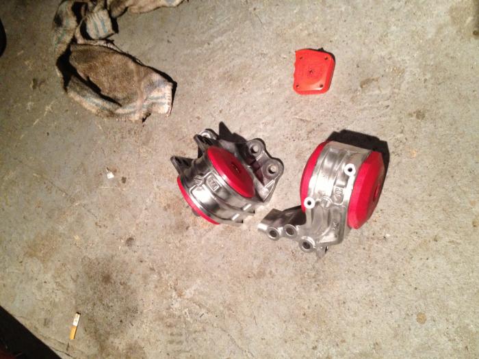

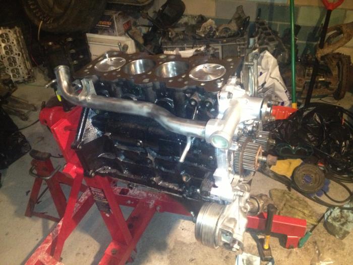

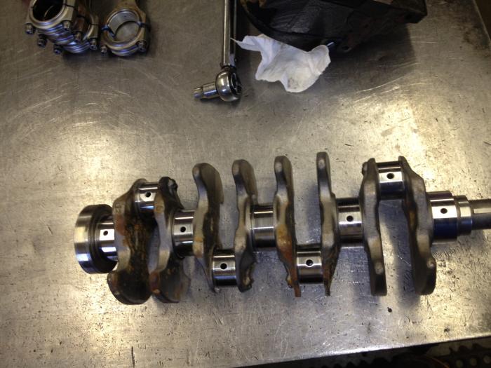

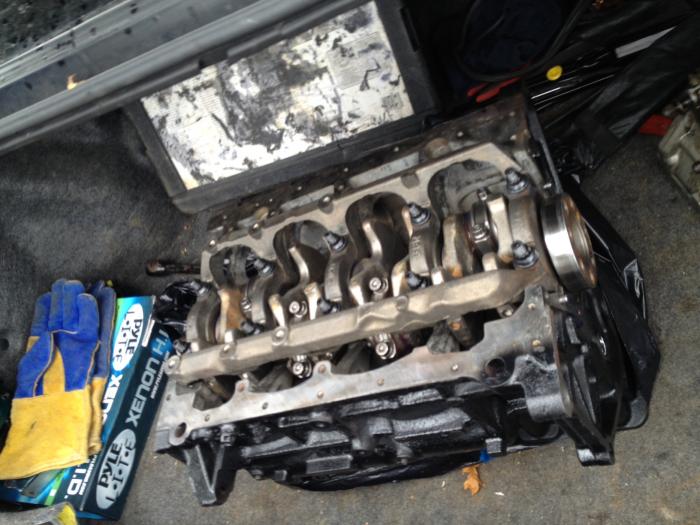

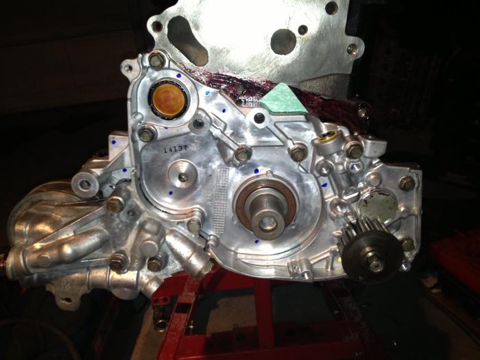

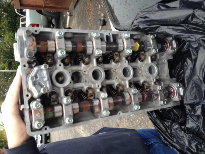

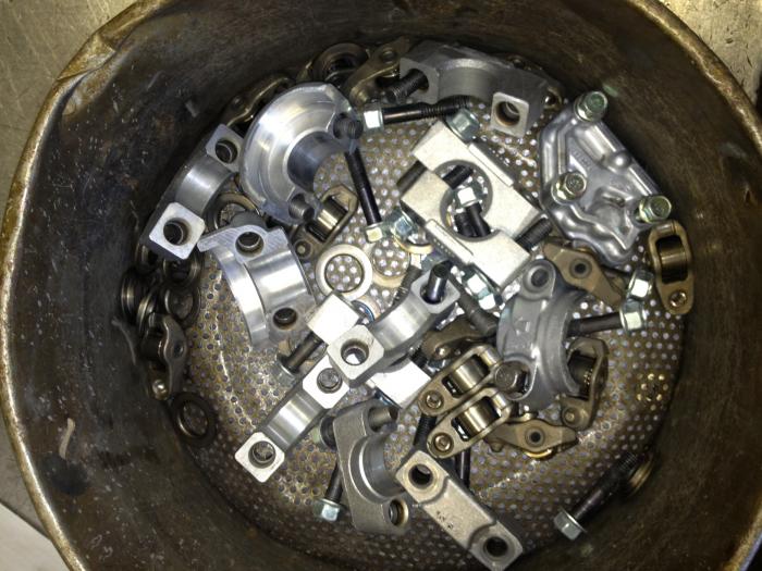

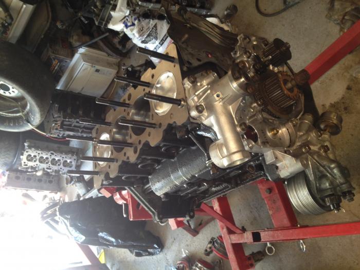

motor mounts :)

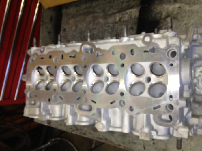

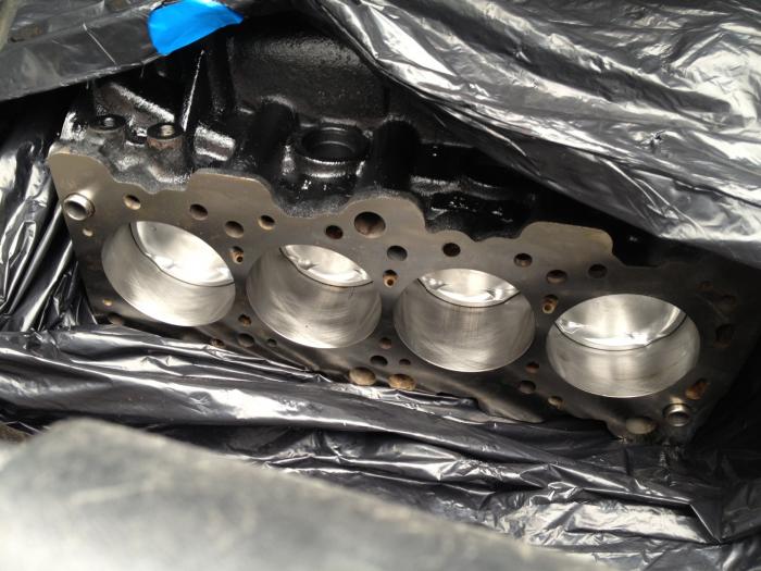

$1140.65 later its all back and ready to get assembled. :hellyeah:
:pray: :pray: :pray: this all works like its supposed to ROFL

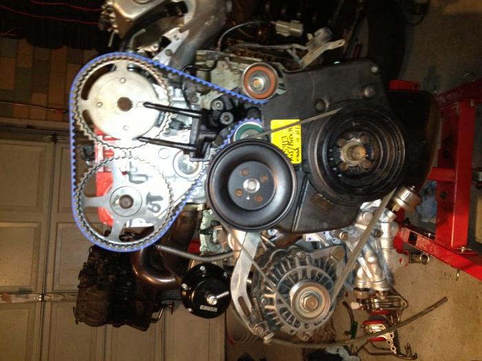

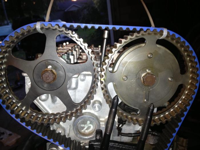

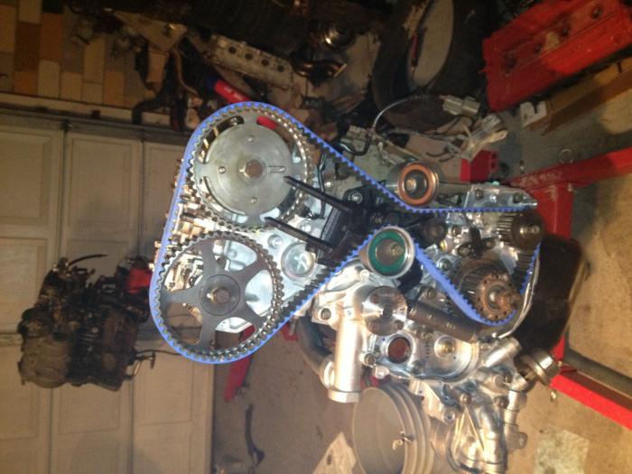

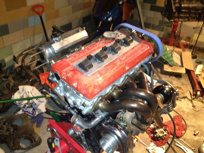

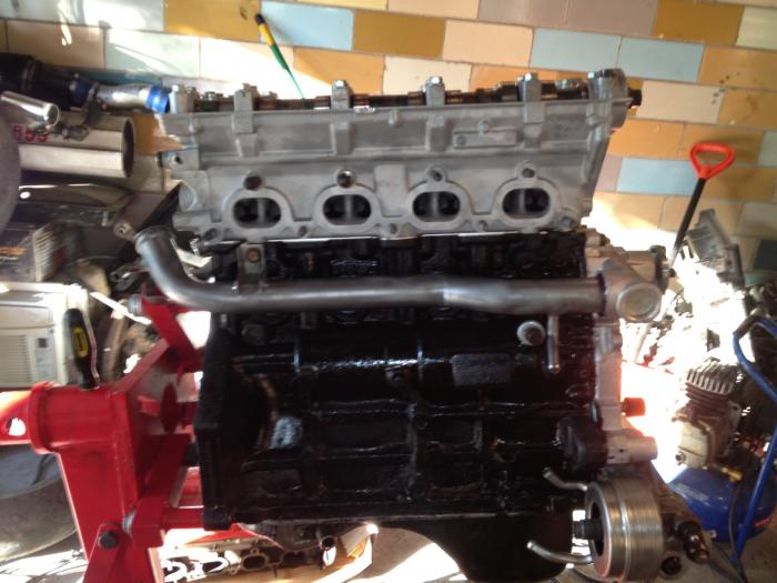

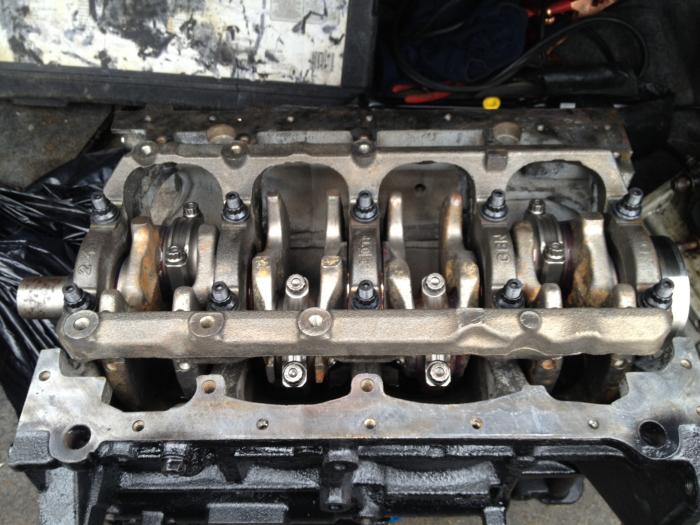

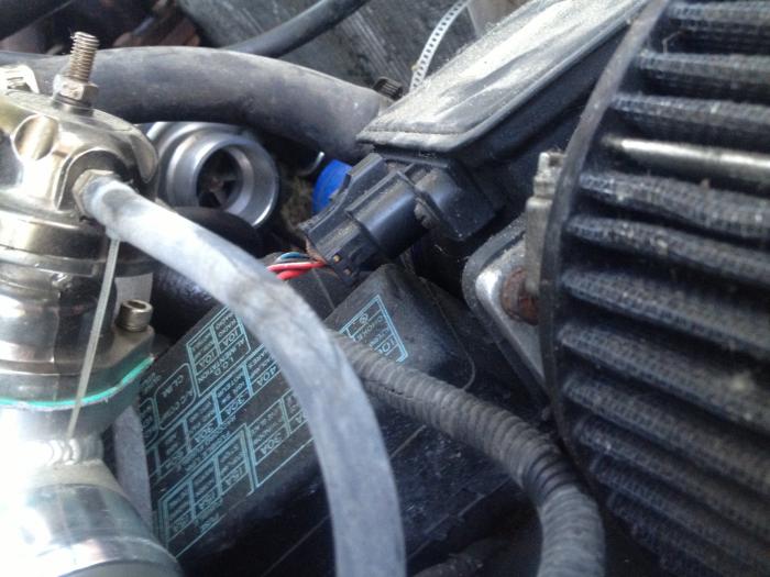

Ive been working on it for a couple days now, hadnt had much extra time. But heres what ive gotten together in the past couple days. Still alot of work to be put into the car and such, but its slowly becoming a car again. image (3).jpg

Using an innovate LC1, I'll be running aeromotive fpr, and stainless lines (not 100% on size) and either dual Wally 255s, or an aem E-pump, andI have full Polly mounts.
