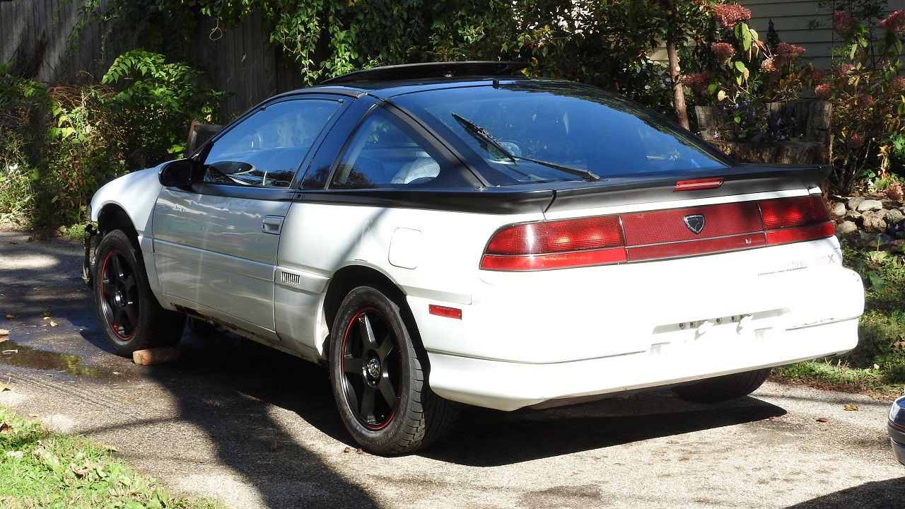

Exterior Modifications

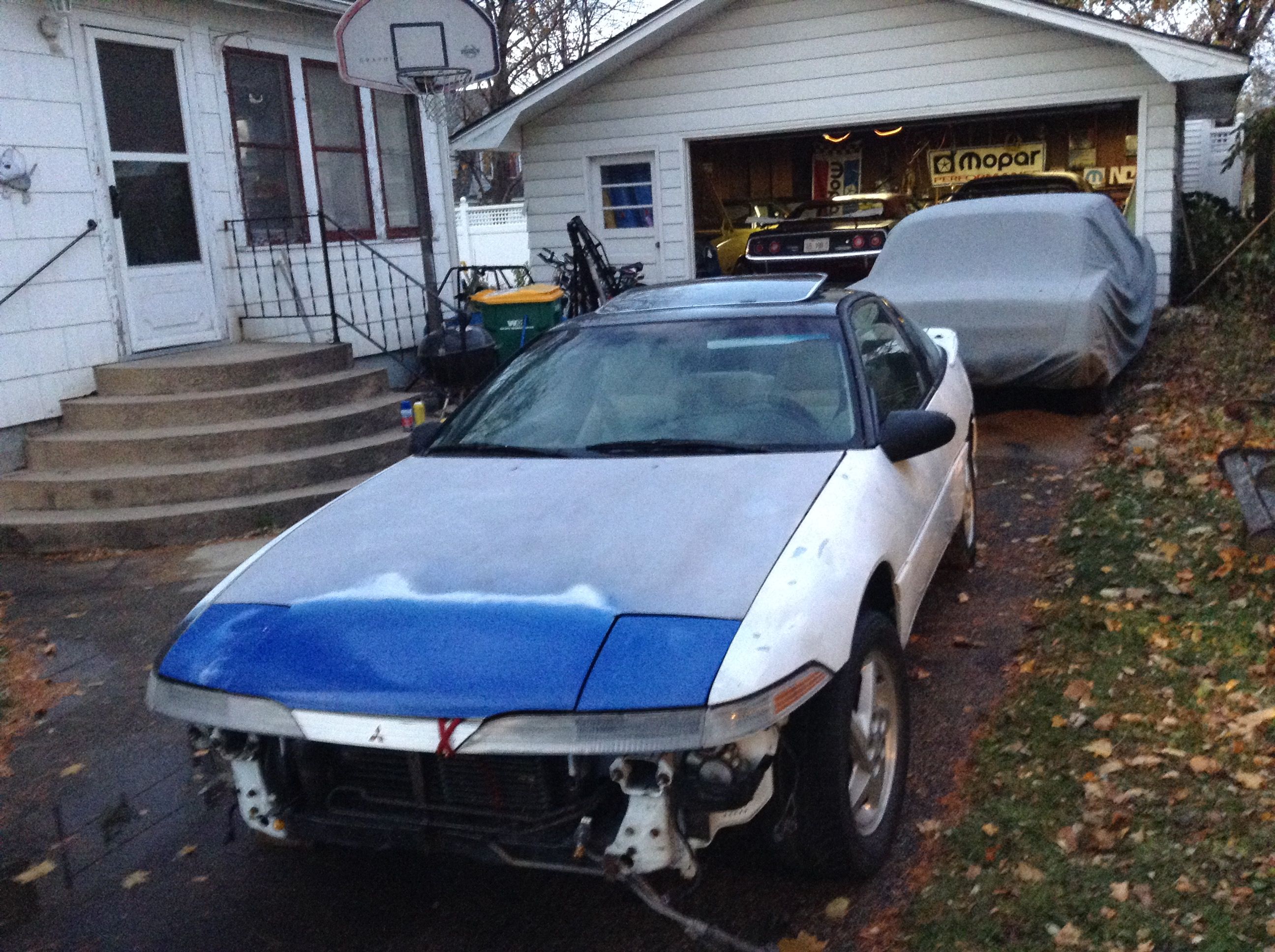

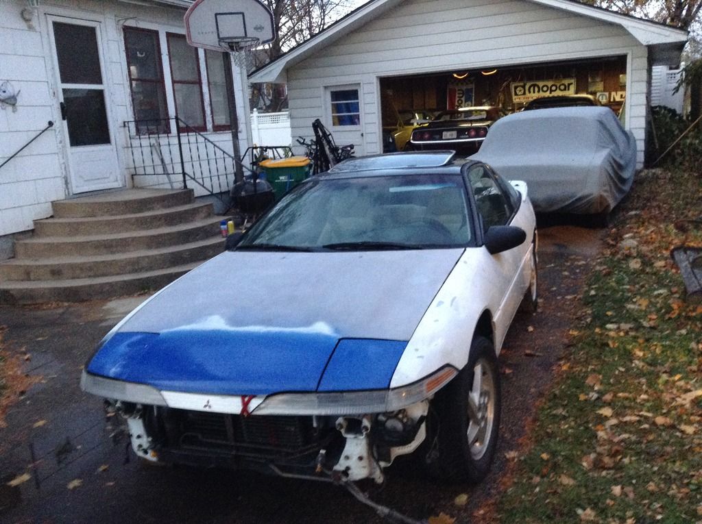

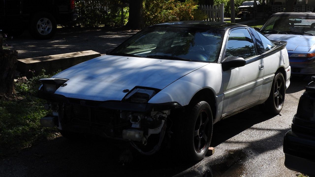

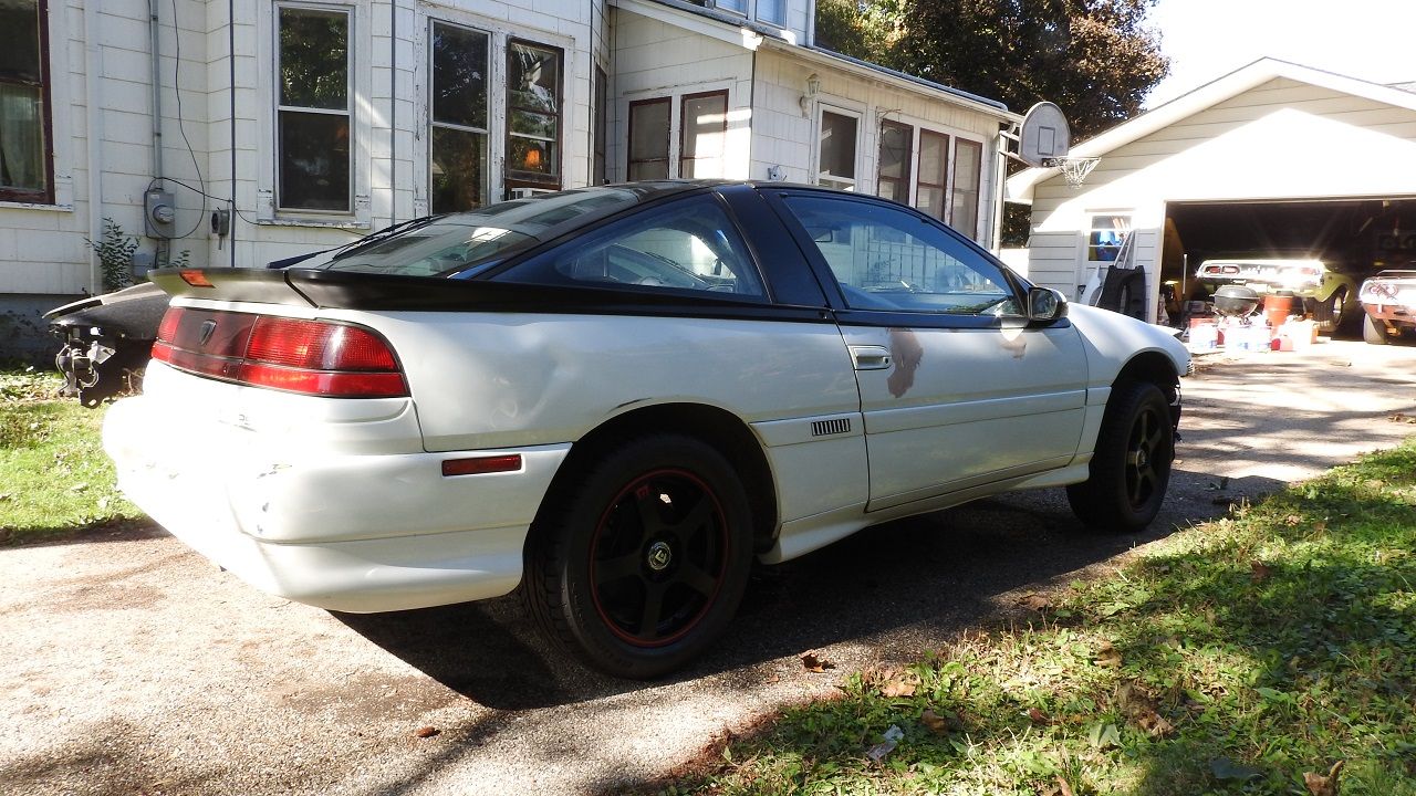

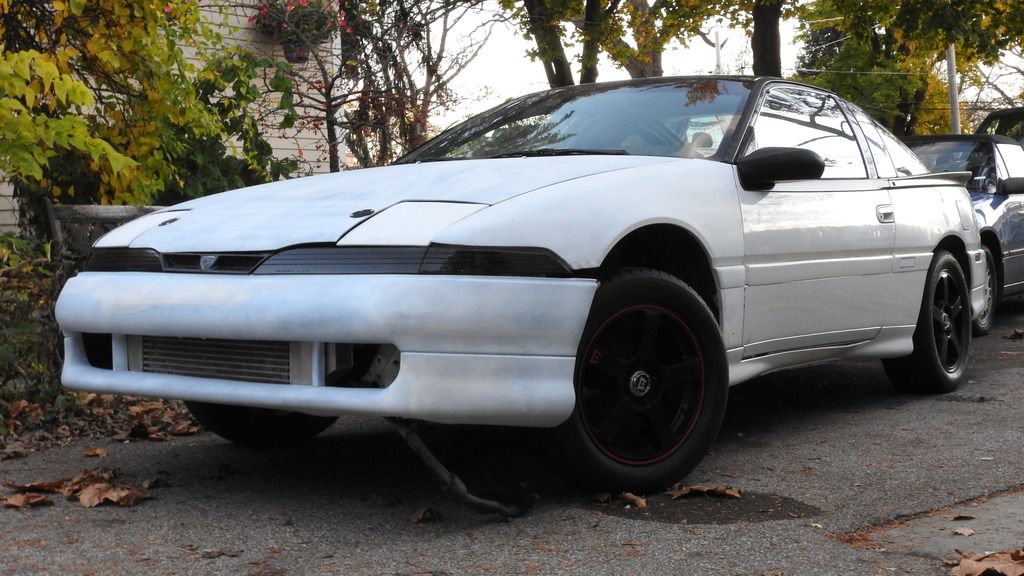

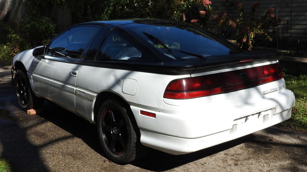

When I purchased the car it was far from pretty, but for a 25 year old car the actual problems like rust wasn't too bad... but I definitely wasn't going to leave it the way it was.
The Bad
  • Rocker Panel Rust
  • Random Blue Paint(Pretty sure I saved the car from beginning to be riced out when I purchased the car)
  • Many dents
  • Scraped Rear Bumper
  • No front bumper(although it came with a duraflex fiberglass bumper mounted with zipties, pretty ricey looking too)
  • Front Grille Tabs broken
  • Eclipse Trim(Just my opinion, not bad quality)
The Good
  • 90% of panels
  • No frame damage
  • Only 1 Major Rust spot
  • Panda-Honestly who can resist the white/black combo ;)
  • No sunroof leak
Updates
  • Motegi MR116 Rims(Wasn't crazy about the red outline but it looks better than expected, hard to beat the price)
  • BF Goodrich Sport Comp 2 225/?/16*I'll update aspect ratio when I remember

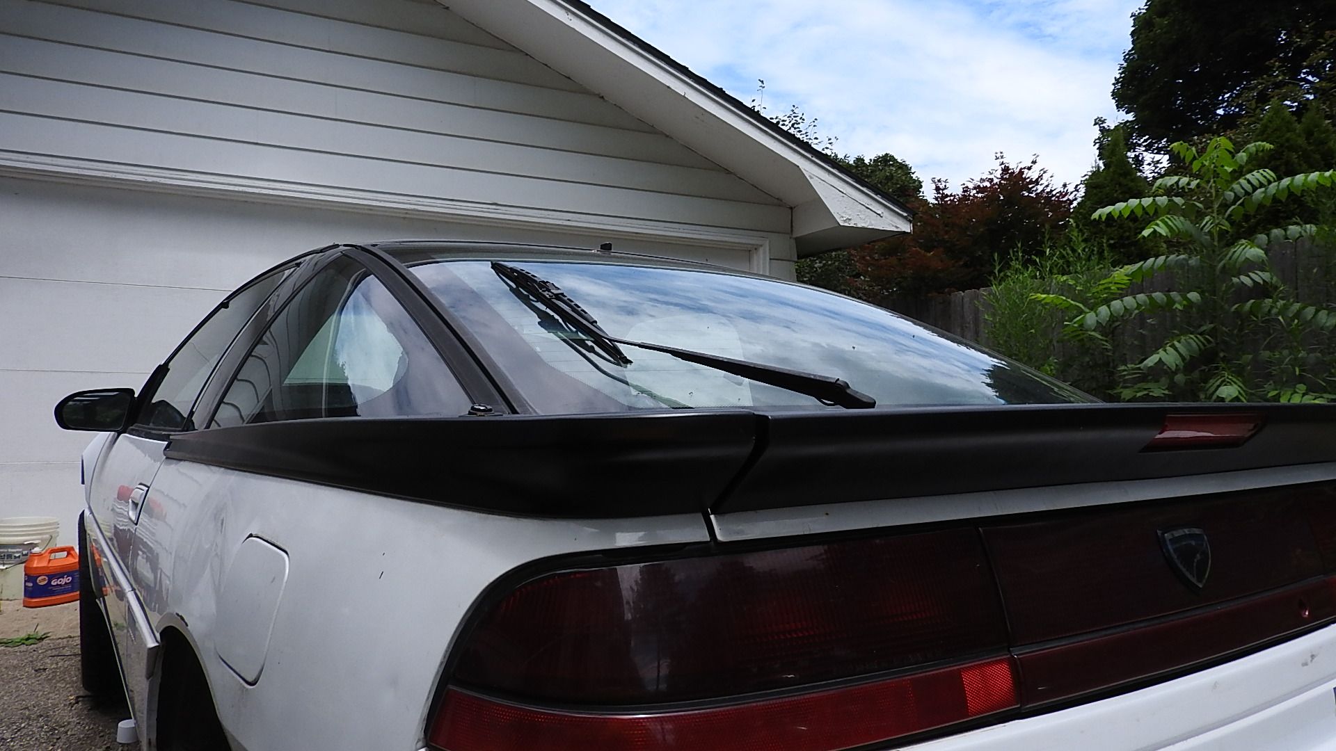

  • 5pc Spoiler(Painted Satin Black)
  • Talon Grille(Satin Black)
  • Talon Tail Lights
  • Better condition fenders(primed)
  • Fiberglass hood(primed)
  • Bumper(Cracked but then professionally fixed and would never know, also primed)
  • Nightshaded Marker Lights
  • Oldstyle ETS FMIC
  • Ram Air/Velocity Stack(Not installed but will be when I drop the engine in)

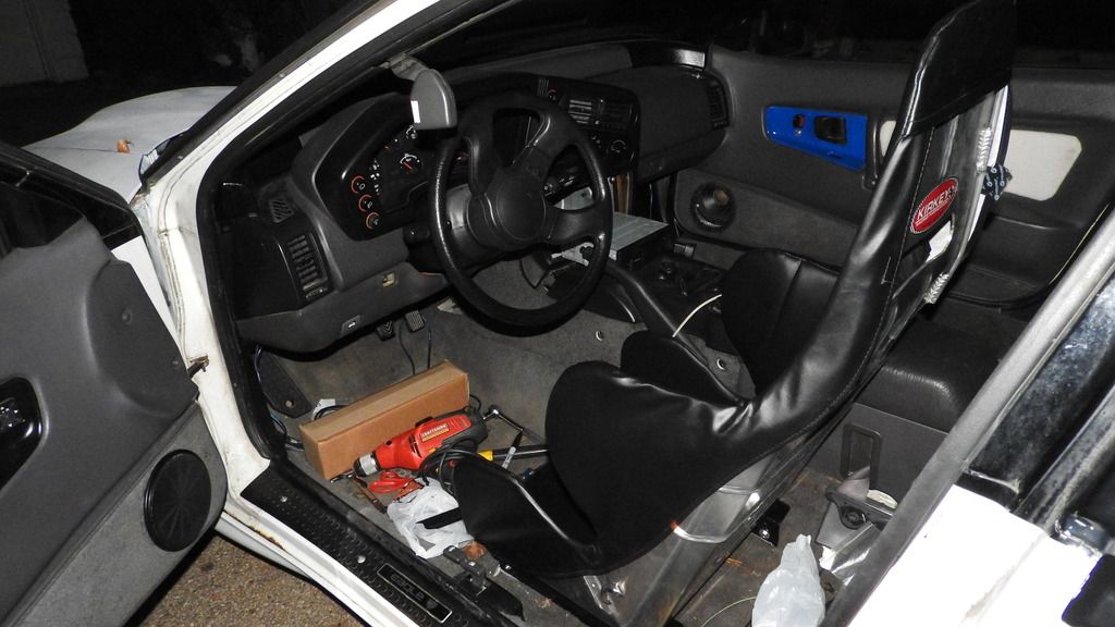

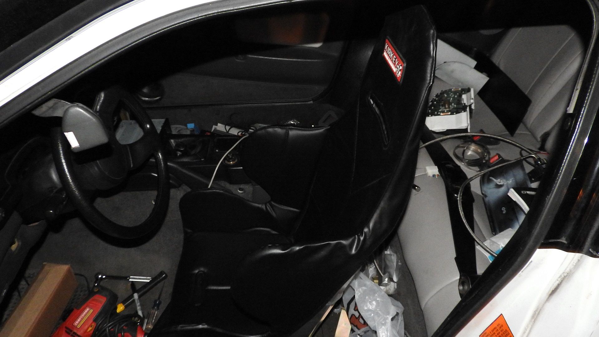

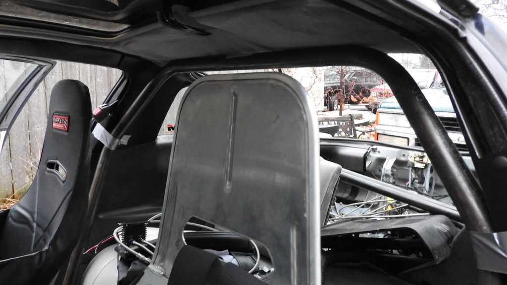

Interior
Car came with decent interior, wasn't a major concern to me though. This section also explains why I believe he was starting to rice it...
The Bad
  • No Headunit/stereo
  • Seats were good condition leather with cloth centers(However once again sprayed blue, which failed and looked like smurf piss)
  • Door handle backing plate was blue
  • Door Speaker Covers were blue
  • Trim piece between console and stereo compartment was blue
  • Wires to the trunk I'm assuming for a sub...
The Good
  • Has boston accoustics in door(OEM?) and MTX near the backseat.
  • Perfect condition tan leather rear seats
  • dash, console, and carpet is in fair condition
Updates
  • Privacy Hatch Cover
  • All but one door trim has been painted to black

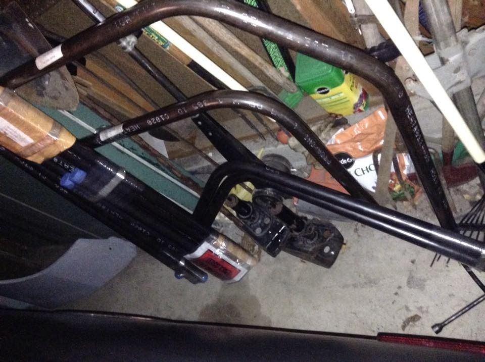

  • Removed spare tire, and frame/wood

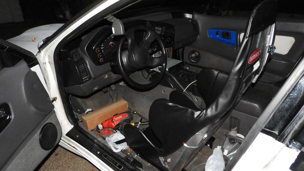

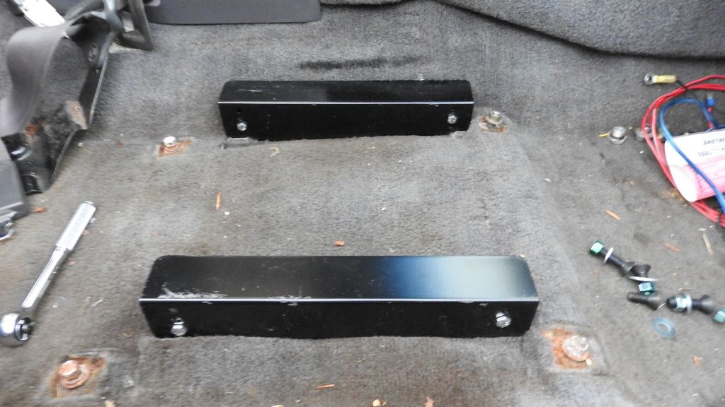

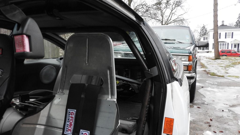

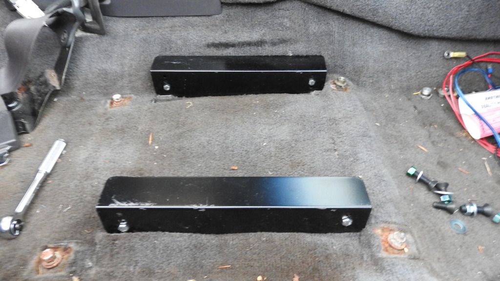

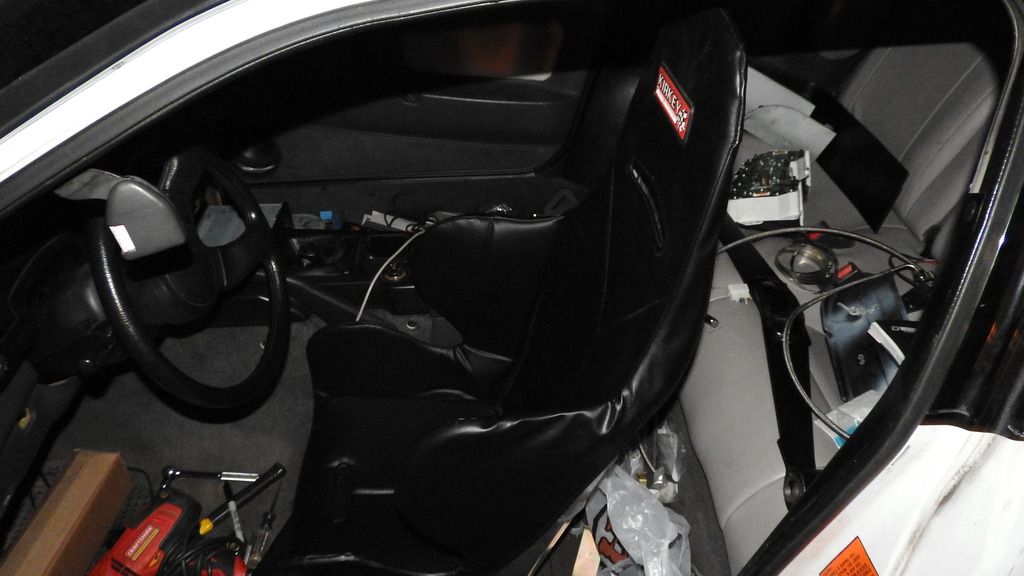

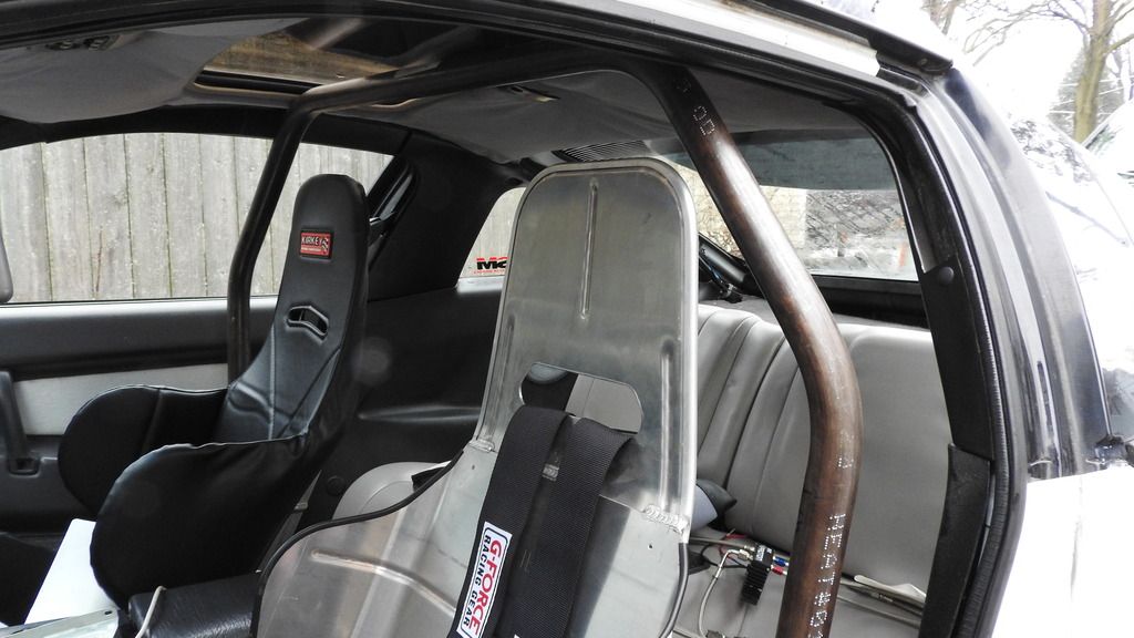

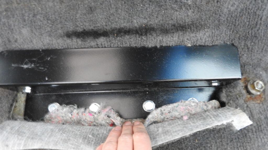

  • Kirkey Seats
  • Manual Shifter Removed
  • Pedal assembly removed/reinstalled due to wrong automatic pedals...
  • Pioneer Headunit
  • Talon Door Trim
  • Talon steering wheel center
Yes I know it shouldn't be held on by bolts, but until I can get welded... Plus it's still better held on than stock brackets.

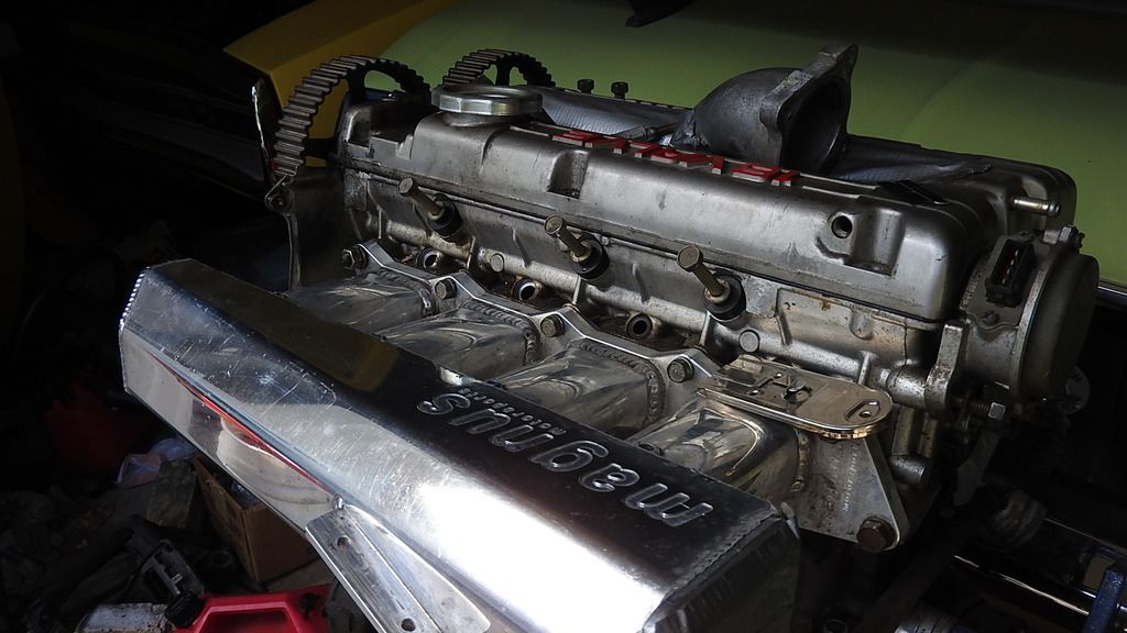

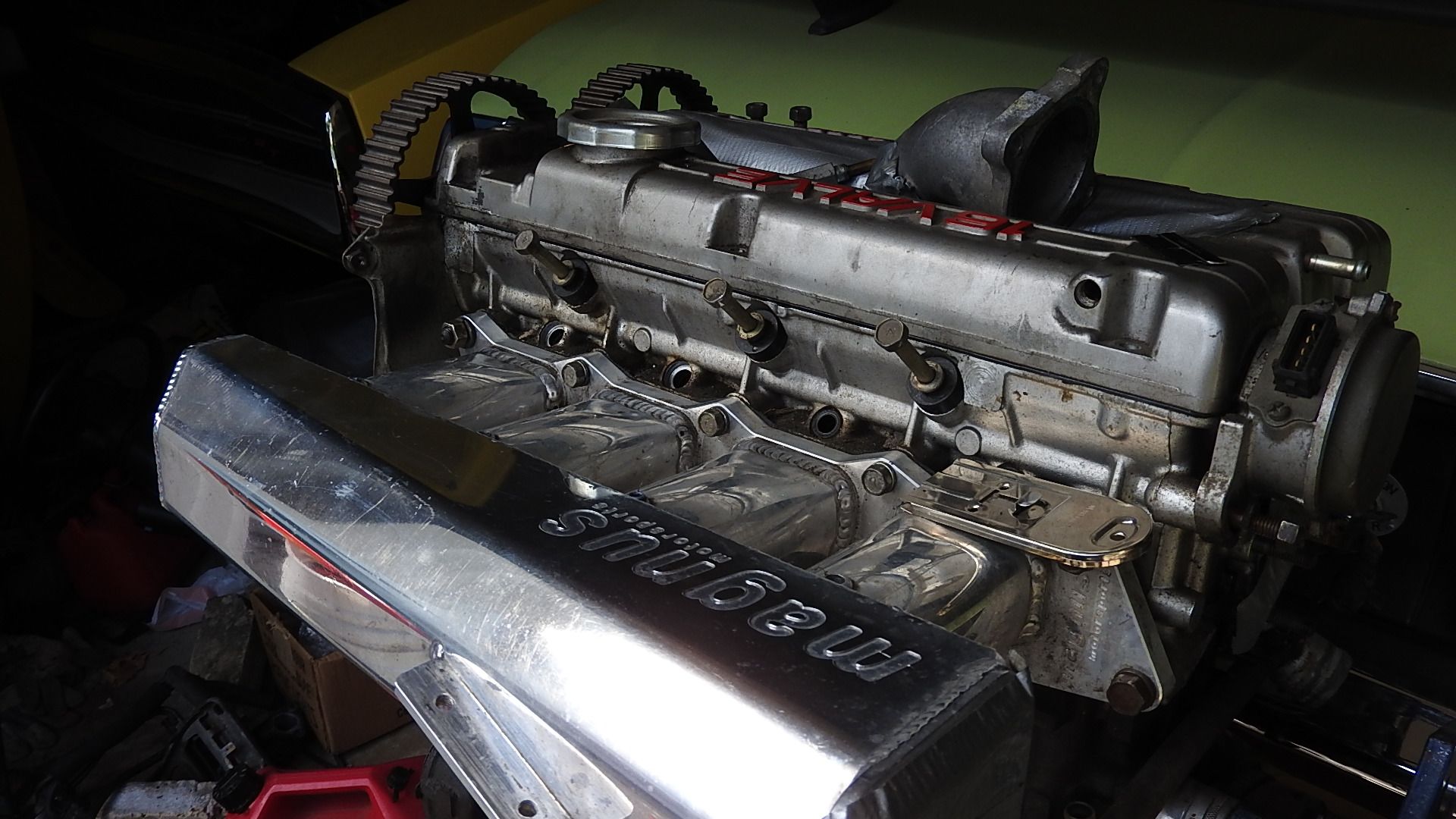

Picked up a 91 6bolt from Michigan
I won't lie in this section however I may not have all modifications listed as I don't want all information public due to purpose of this build.
Current Parts
  • Holset Turbo
  • Old-Style ETS FMIC
  • COP w/plate(Aaron Gregory's old one)
  • Magnus SMIM V2 w/bungs for N2O
  • NX Proton Kit
  • AEM EMS V1
To be Purchased when money/deal arrives
  • ERL t3 Manifold or other manifold for holset
  • Kelford 272's
  • Kiggly HLA
  • N2O Intercooler Purge Kit
  • Dynatek Arc-2 CDI

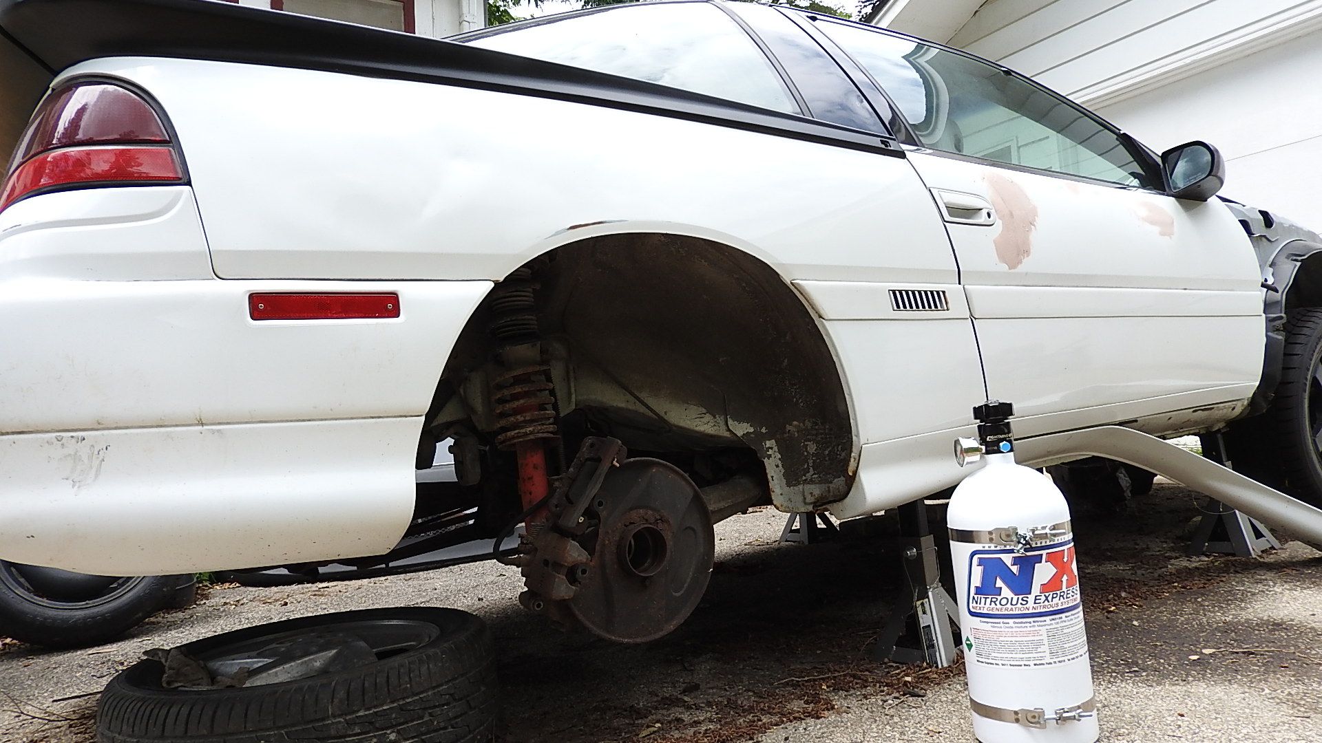

Driveline
Well here is where things got all mixed up... Originally was gonna be a manual due to the misinformation of forums, saying that the manuals were better built... Then I was supposed to swap with a guy that wanted to do manual, but when all that was left for both of us to remove was pedals he fell of the planet, so after months of waiting I said screw it. Also bought a rear end that was supposed to be an auto 4 bolt, but since I was buying multiple parts, and he showed up late with a 69 Camaro on a trailer, I forgot to check gear ratios*Facepalm* and it was a manual...
Upgrades
  • Driveshaft Shop Stage 2 Axles(Front and Rear)
  • Automatic Trans/tcase
  • Auto 4 Bolt
Future Upgrades
  • Driveshaft Shop 3.5" Aluminum Driveshaft
  • Torque Converter(Hoping a Bradco goes up for sale...)
  • IPT Rebuild/Upgrade Kit
  • Tcase Brace(maybe)
  • Poly Motor/Trans Mounts
Suspension
The other part I pretend to know... Any tips are appreciated here(Just shoot me a pm)
Current
  • Eibach/agx(rusted and looks sketchy)
Future
  • Ground Control/Eibach Combo(maybe, pending deal with local I've done business with previously)
  • Poly Bushings

What did you do for a seat belt or harness for your kirkey seat?
Just installed the seats but no belts/harness yet, I'll be putting in a 5point eventually though

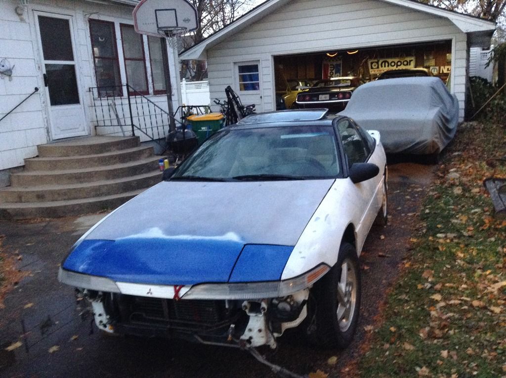

Nice build so far! And I'm drooling over the mopars in the background. Is that a 1970 Barracuda that's hidden in the garage?
