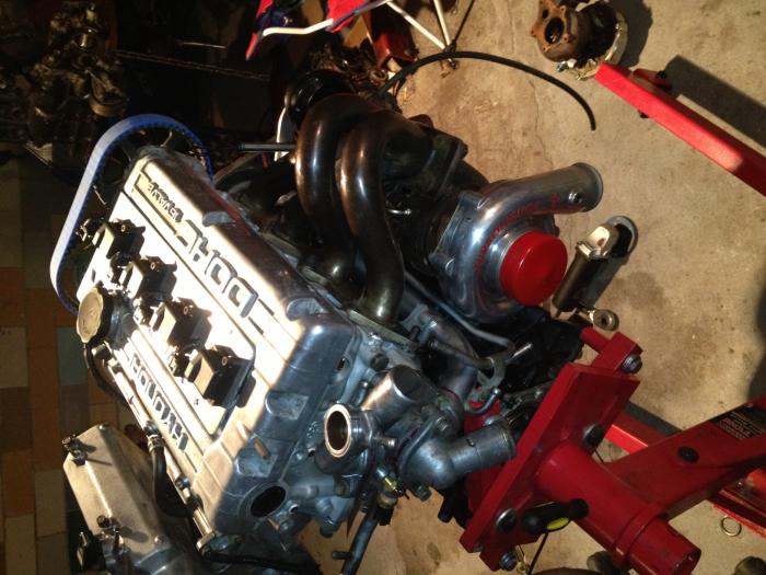

Updated pic. This IS the turbo and valve cover Ill be running :)! :rocks: :hellyeah:

Update on the car, motor is 85% assembled , trans just needs clutch fork installed, and still need to buy a clutch :ohdamn: Going to run stock tune, and stock 450cc for about 1000 miles, then its getting tuned. Still have to install my STM ABS delete kit, paint the bay, and install everything to make it drive LOL. Itll come together one day. :D Ill post some pics of some new stuff soon as I get around to taking them.

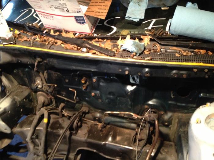

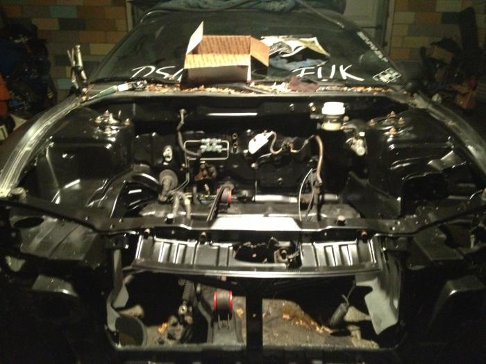

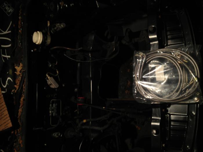

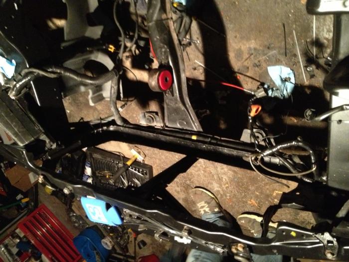

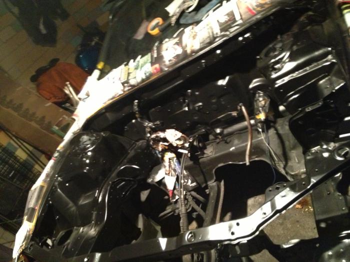

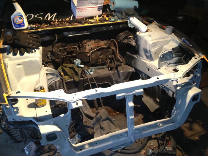

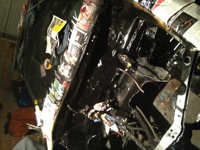

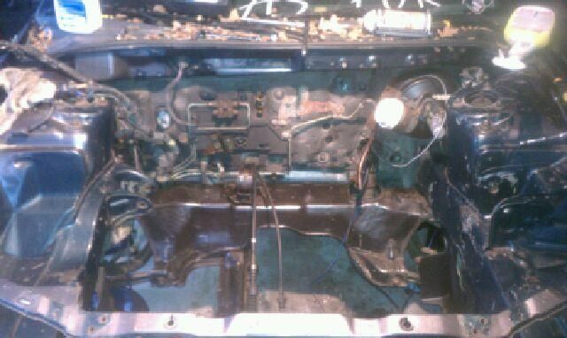

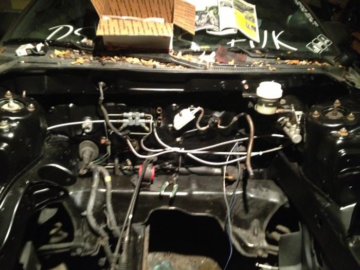

Finally got some work done on this thing. Got a new slave, slave master, STM ABS delete installed. Bay painted (turned out alright, but wish it woulda came out a little better) BUT its getting there!!!
extended the windshield wiper motor wires to tuck it back some. i like it :)

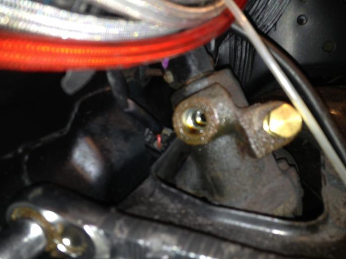

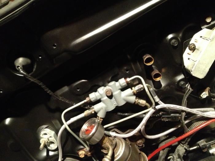

was going to plug the PS, but after some more opinions, and little more research i think im going to loop them after filling the rack.
