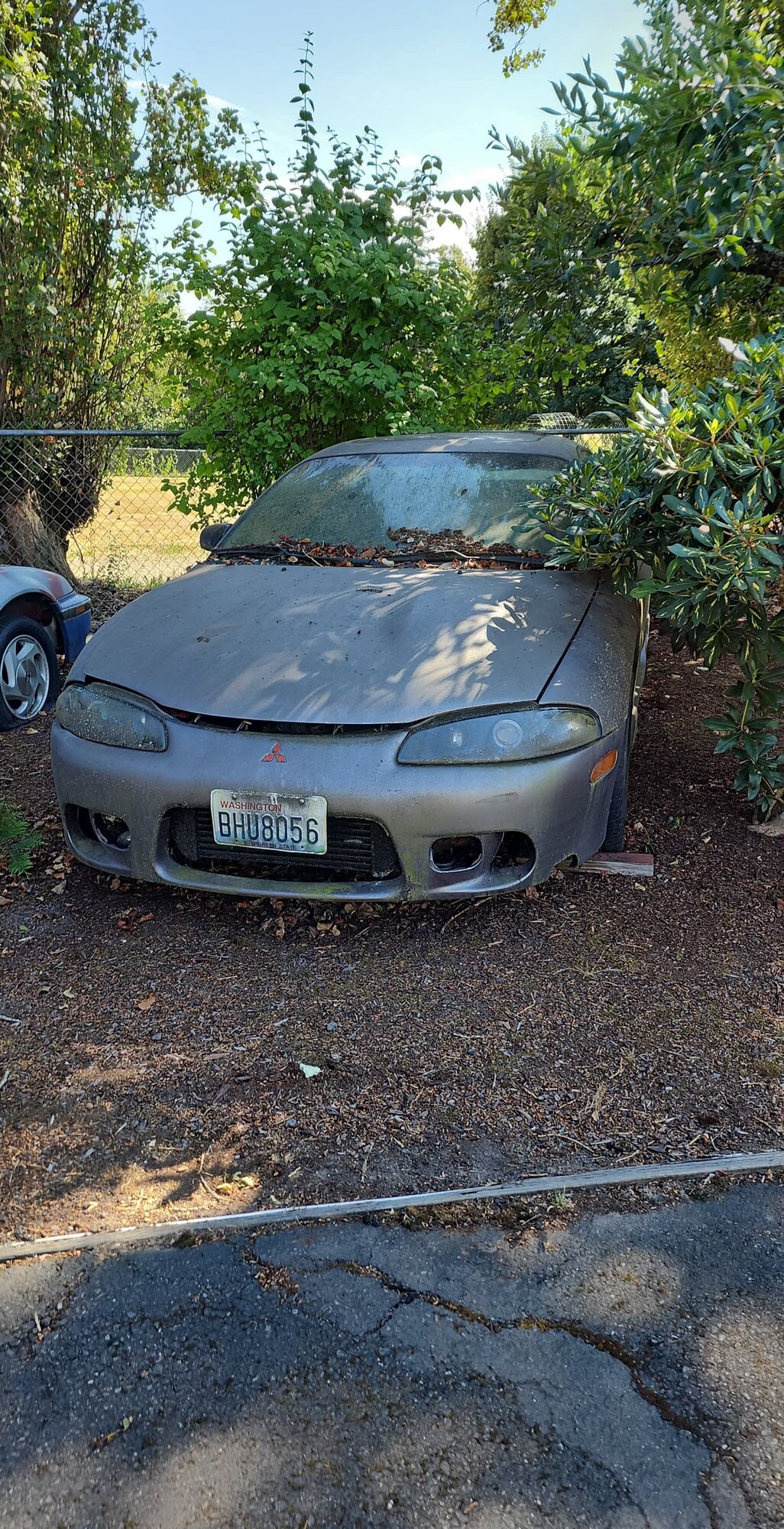

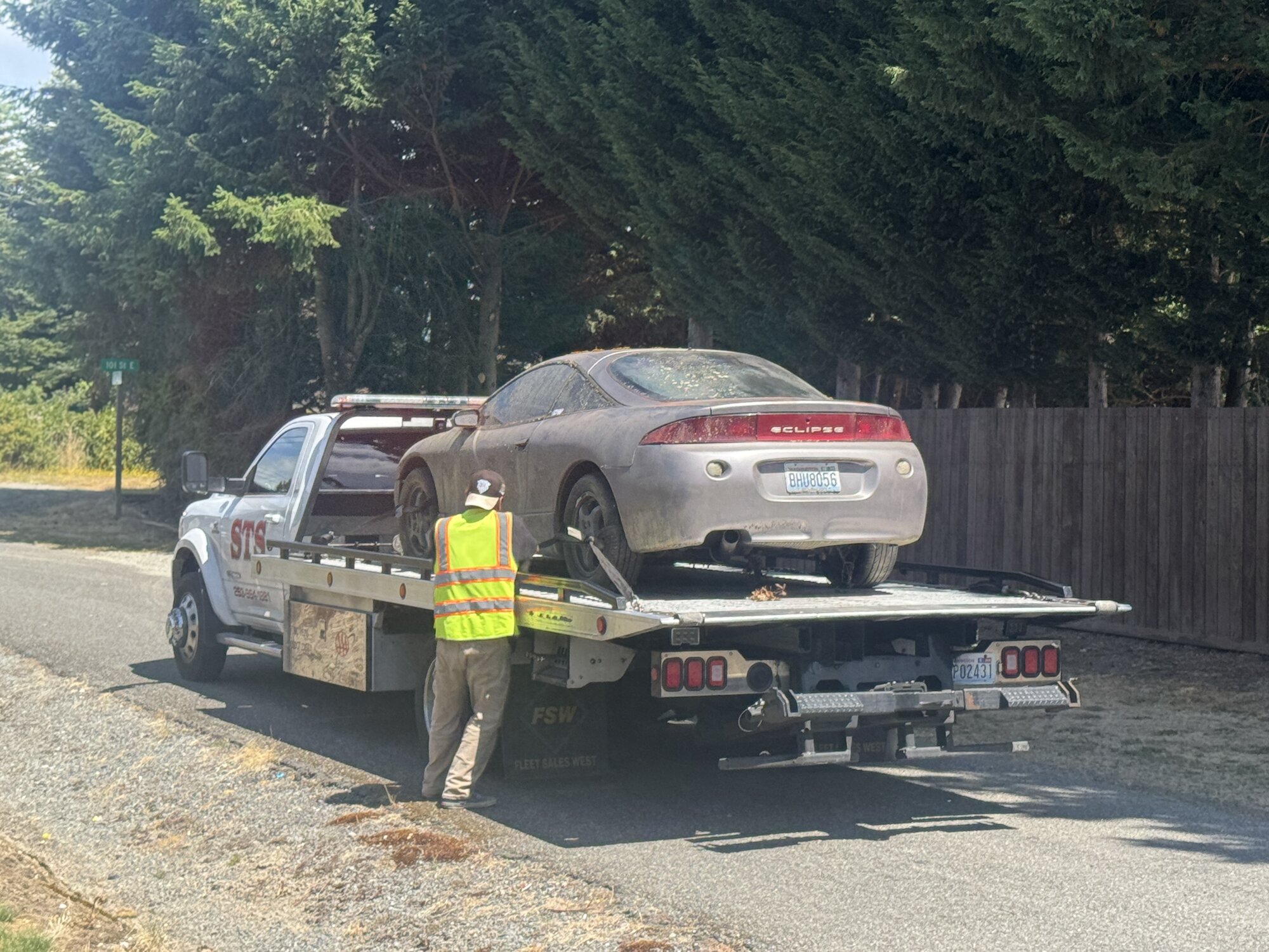

Back in July 2025 I purchased a Durango Copper Pearl GSX. This was the first opportunity I'd have had to own a rare color. So, I got an insane deal on the car and brought it home.
What I knew when I bought the car:
  • The timing belt needed to be done. It was previously done with generic parts and the belt appeared really worn
  • The turbo had been removed. This was why the car originally sat - the previous owner had blown the 16g up.
  • It was plastidipped - so seeing it's actual condition wasn't feasible at the time

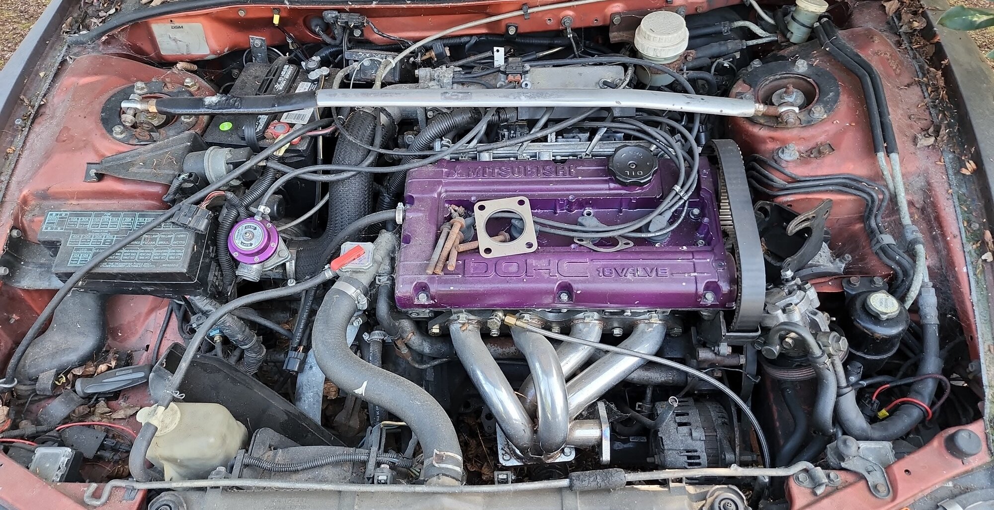

Mods that came with the car:
  • ECMLink V3
  • SAFC
  • Exhaust - of some sort
  • EBAY FMIC W/ Greddy Type S
  • 1000CC Injectors
  • AEM Fuel Pump
  • AEM Wideband
  • AEM Boost Gauge
  • 2GB Front and rear conversion

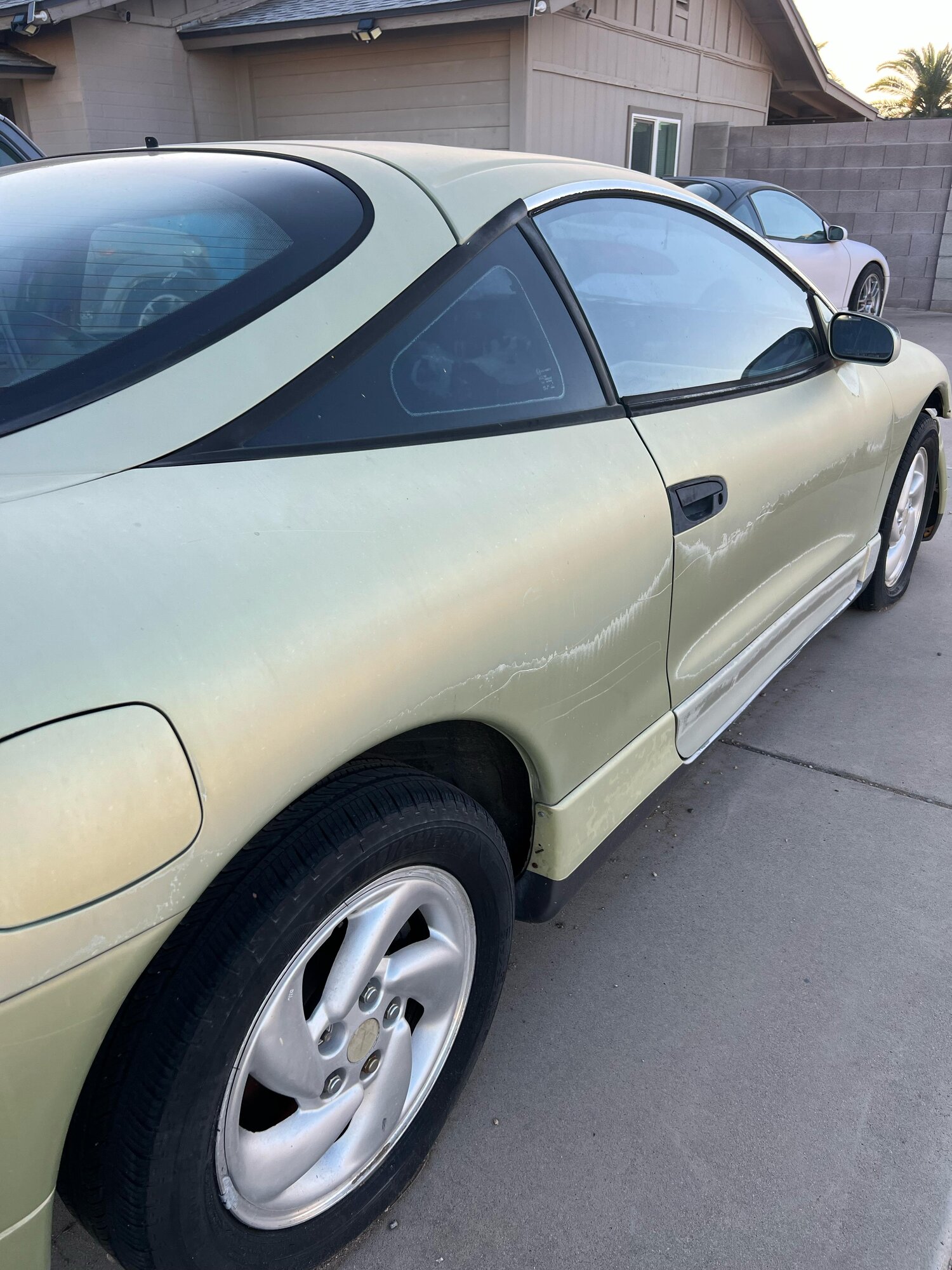

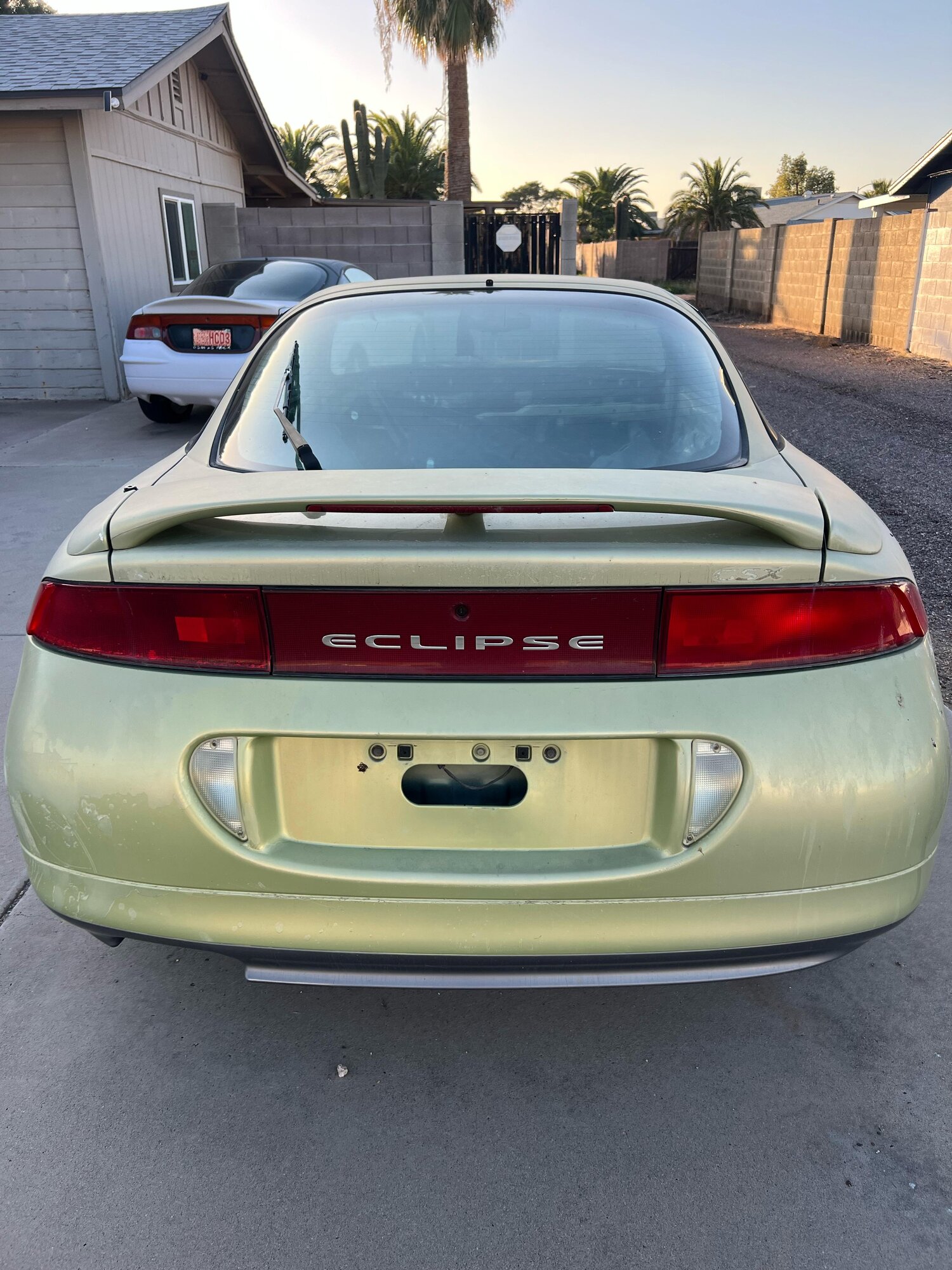

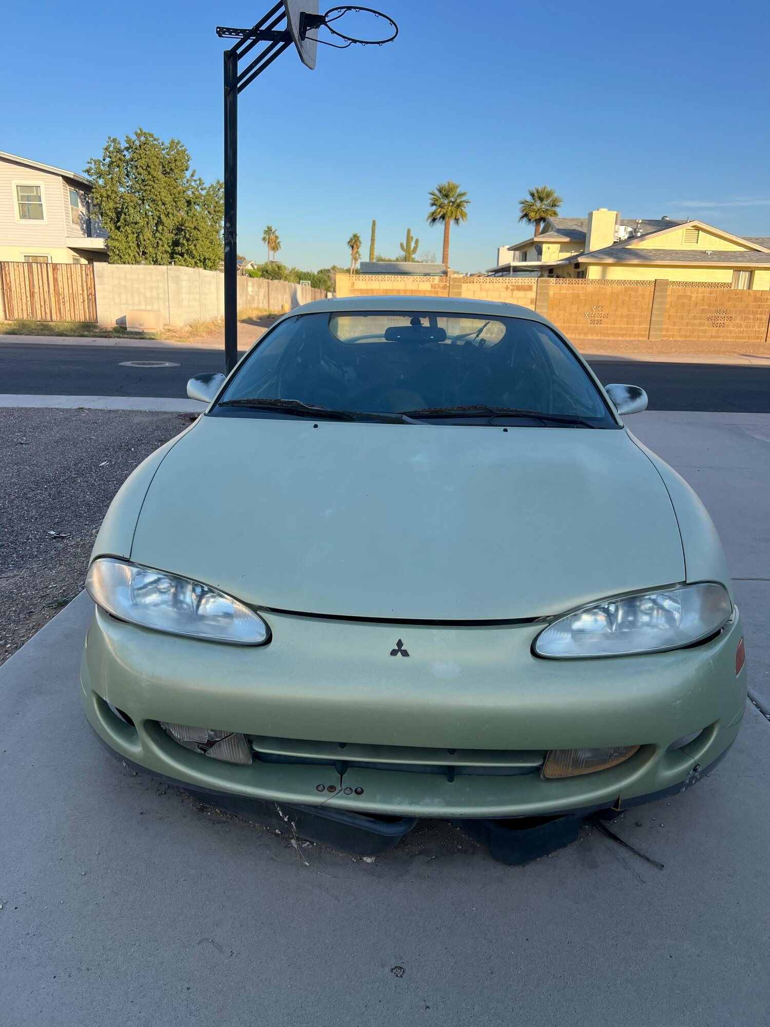

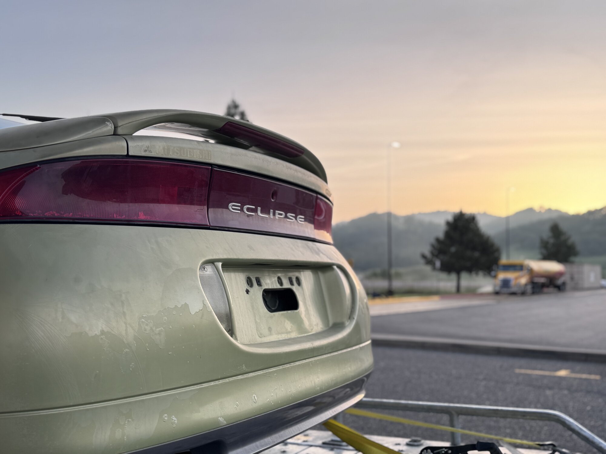

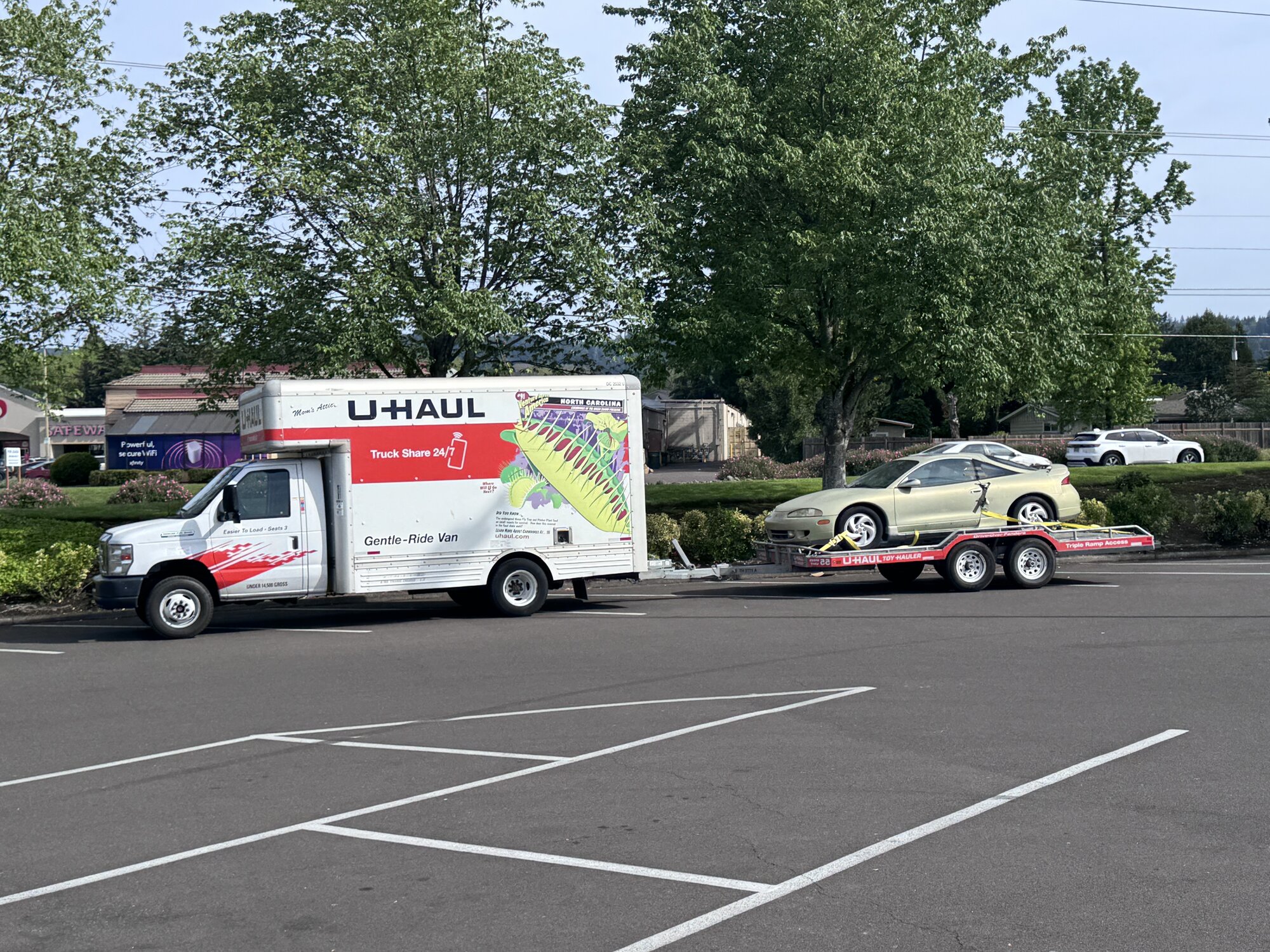

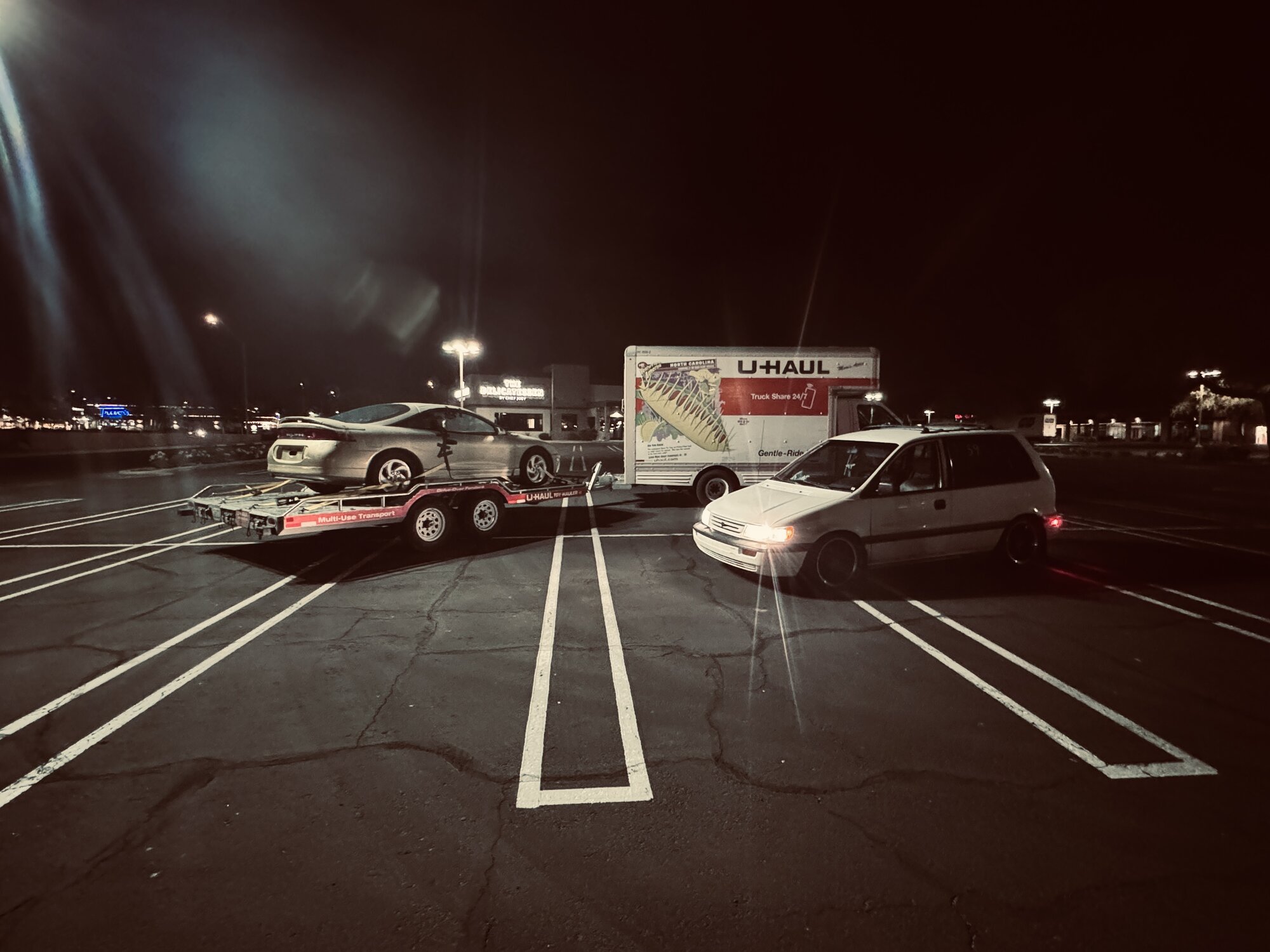

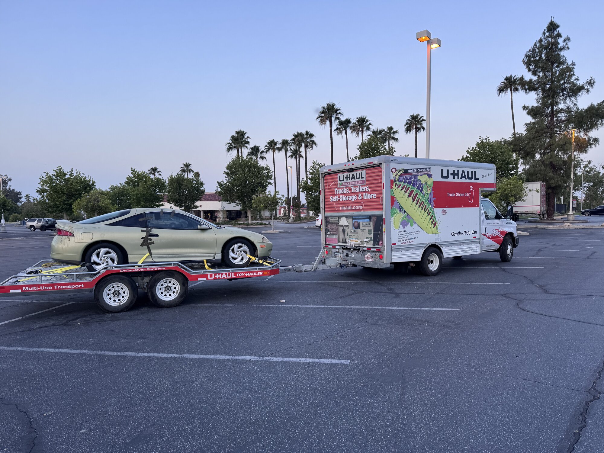

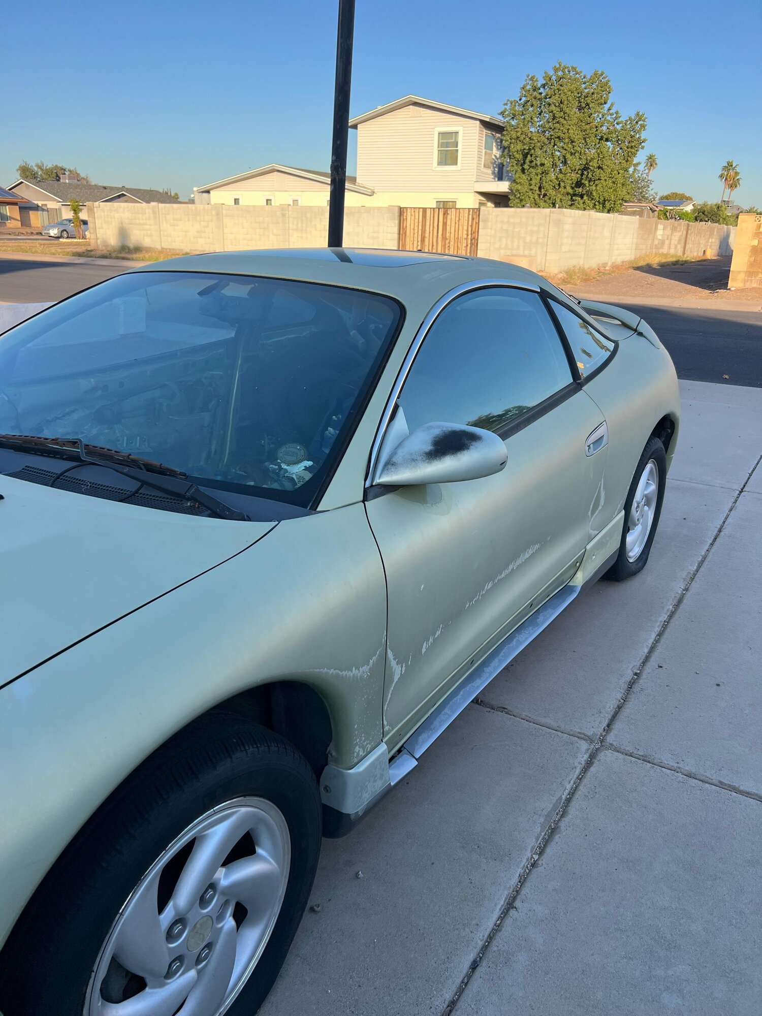

Well! May 7th came and went - we made it to Phoenix and back! Some photos from our trek.

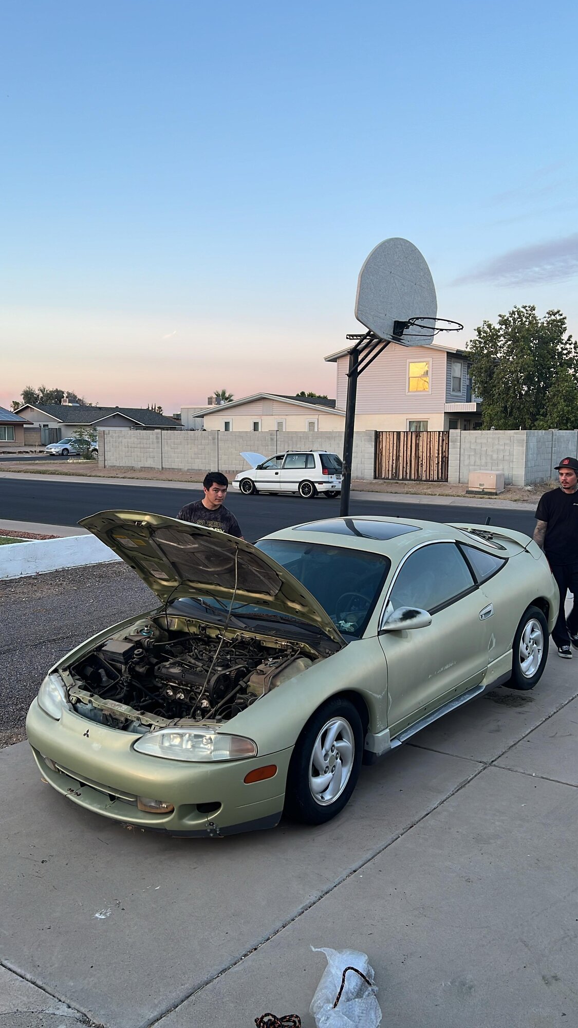

My brother and I flew out May 7th and arrived in Phoenix around 11AM. @Brandon Nicholson picked us up in his sweet summit and taxi'd us over to Uhaul to pick up the truck and trailer. We decided we wanted to trailer it back ourselves rather than ship the car, mainly because Brandon had some parts for us to bring back as well. Unfortunately Uhaul didn't provide us with any straps so we headed to Harbor Freight for some ratchet straps - so forgive us for the awful strap down job. After we grabbed straps we snagged some Whattaburger and headed to Brandon's.
At Brandon's place we picked up a couple long blocks, some coilovers, and an exhaust. All things we needed for the Biscayne car (and a long block for my Colt Vista 4g63 swap). We loaded all that up and swung over to Kevin's place to grab the car. We actually threw the coilovers on the car at Kevins and loaded the car up. This was when we got the chance to meet the legend @gofer, who donated some parts for the build! As it was getting late we decided to check out the local culinary scene and grab some of Phoenix's finest food, Chilis; which didn't disappoint.
After finishing up with dinner around 10:30/11PM, my bro and I headed out to LA.
Saying bye to Brandon!
Friday morning in LA. We took a quick nap here before heading out to pick up a transmission and some 8g galants parts.

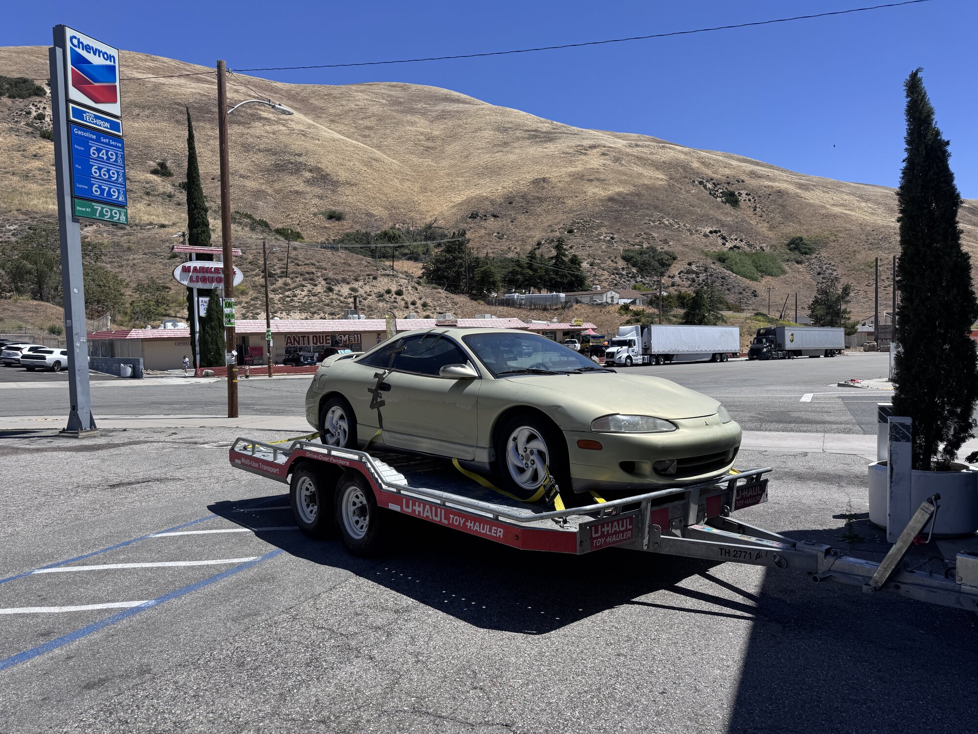

Gas stop in Gorman - check out those gas prices. Yikes.

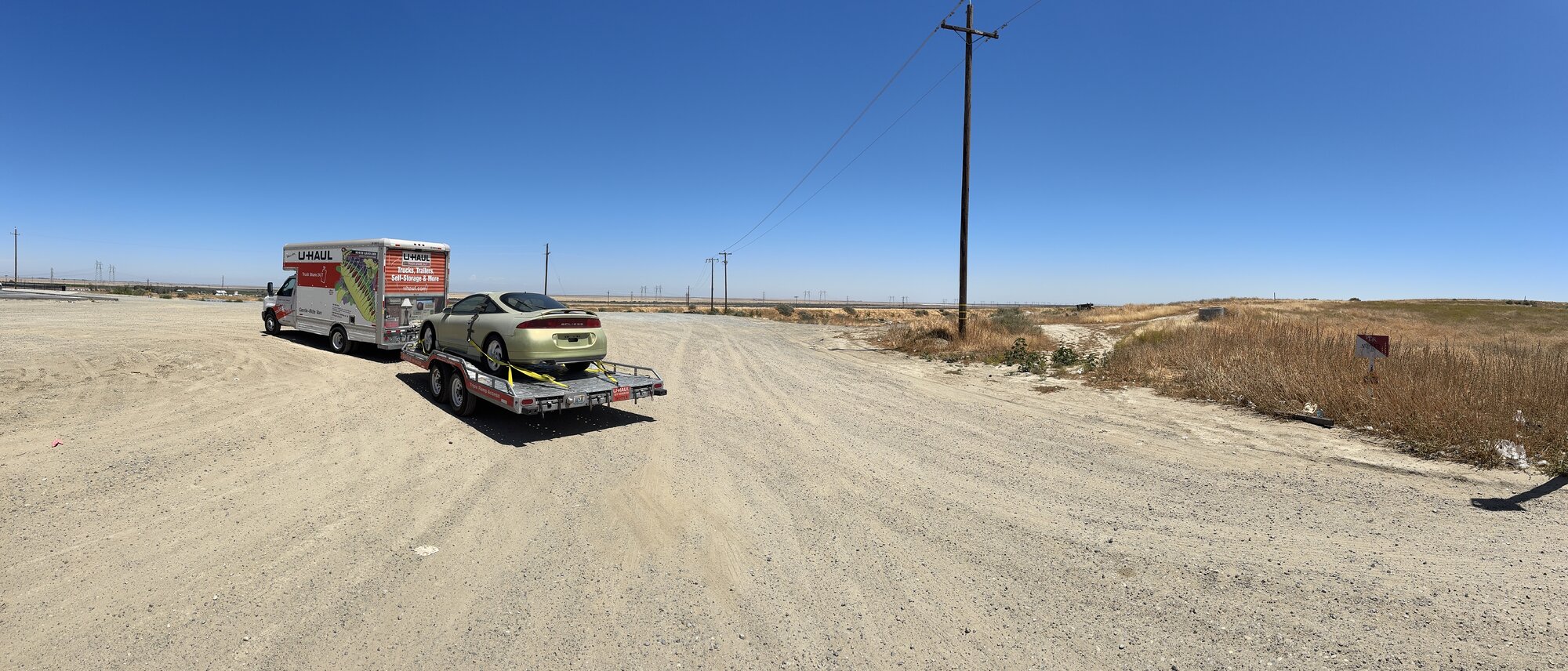

We stopped Kettleman City to grab some In and Out and take a break. From here we ended up shooting up to Sacramento and then down to Fremont to pick up some Evo parts for my brother at Illumaesthetic. After there - we stopped and grabbed Sushi in Vacaville with a good friend and headed out to Seattle.
Saturday Morning, in Medford! We made one other stop during the night in Weed, California.
Our last stop was in Newberg to pick up some 2gb Talon parts!
Ironically I didn't take many photos once we got back. We were both so tired we ended up unloading everything and getting situated and going to sleep. We covered around 1600 miles and 25 hours of driving over 35 hours. We were pretty tired. In the next week I plan to go through the car and whats there and give a update! Super excited to get moving on this project!
