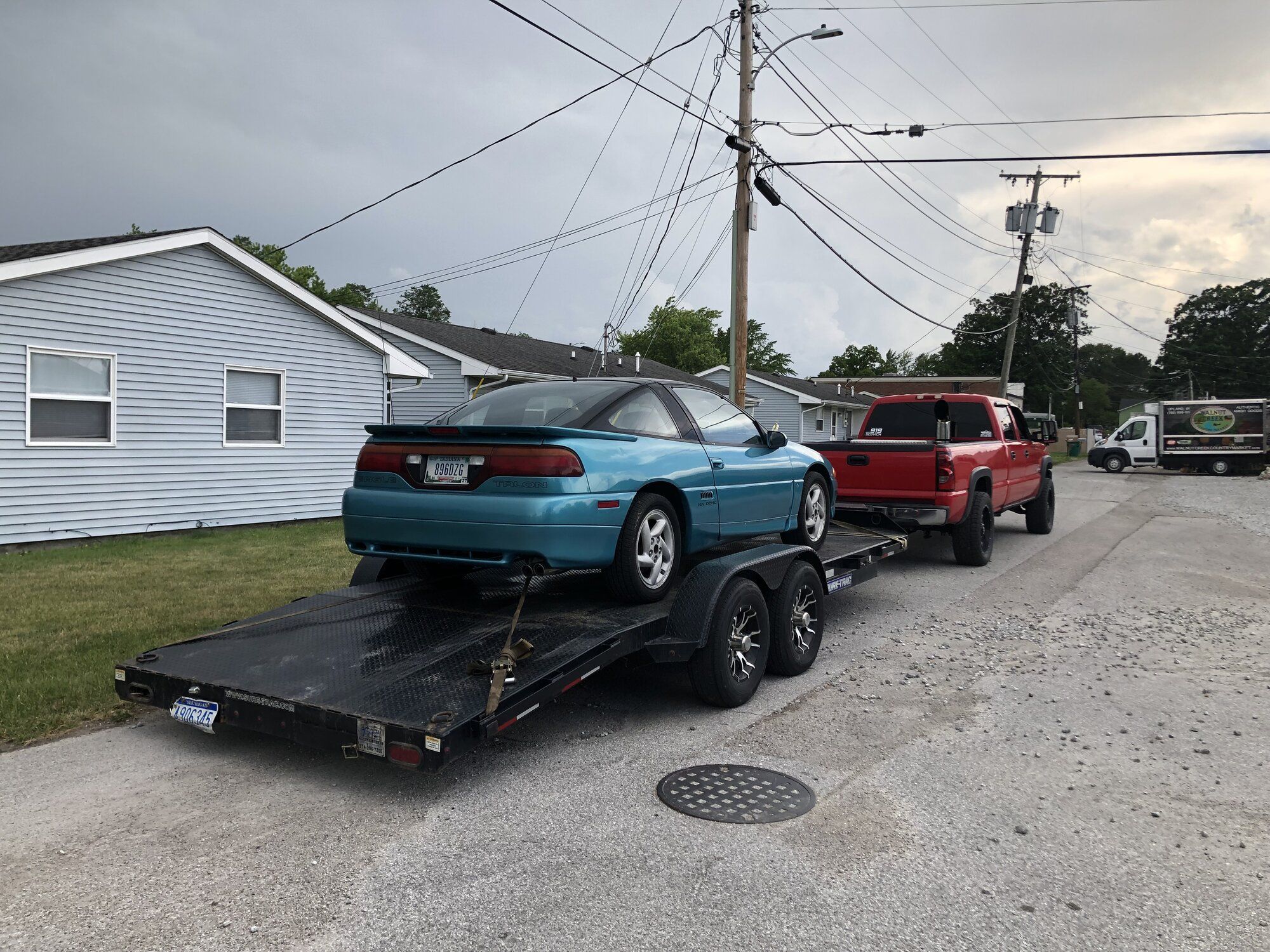

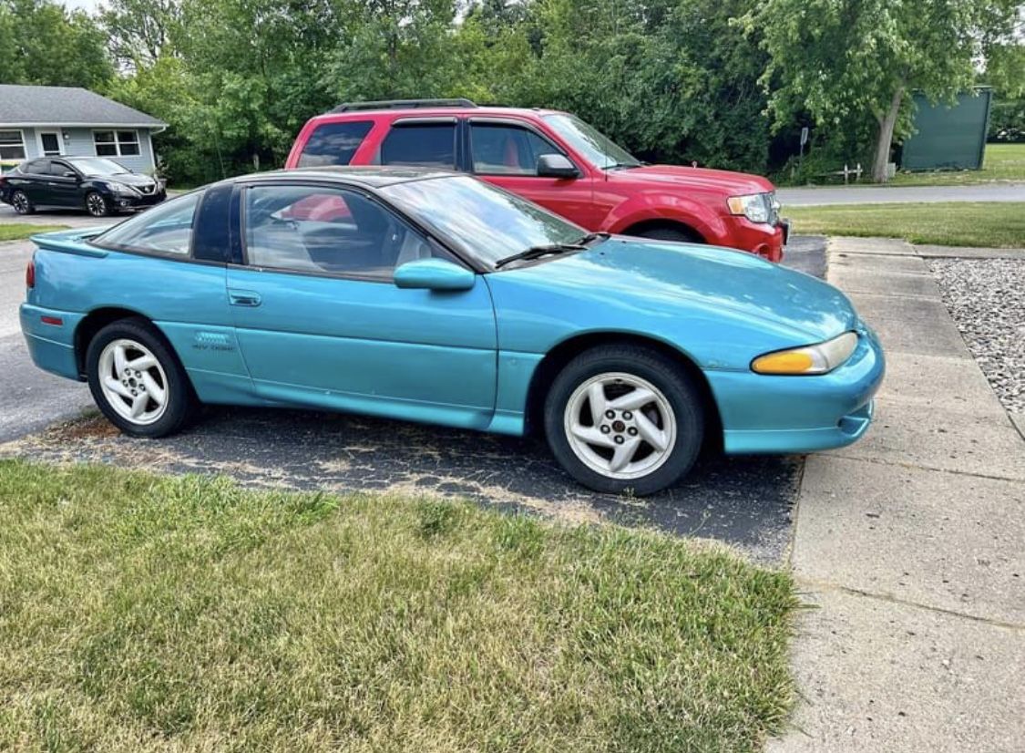

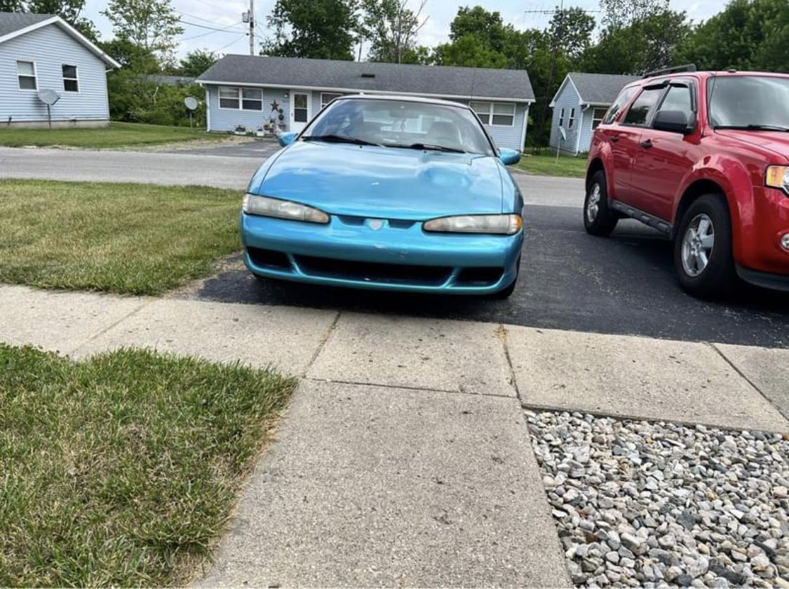

I stumbled across this car as I do many others on the beloved Facebook Marketplace! It was your typical vague information post with some terrible pictures, stating the car ran fine, had low mileage, needed brakes, all with a price tag of $1,200 Firm! The owner was supposedly waiting for the title in the mail as the ad had stated. So I messaged the guy and asked if he had received the title yet. He proceeds to tell me that he has but the car is pending sale at the moment. I told him to please let me know if the sale falls through and that I was interested in the car. Well a day goes by and the post is still up, so I go back and check my messages and I didn't see anything, so I messaged the guy again. He finally gets back to me and tells me that the car didn't sell. I then proceed to ask a few more questions, get him talked down on the price, and get a meet up time set so I can go take a look at this thing that's roughly 2 hours away from me. This all started on a Friday, went into Saturday, then Sunday comes and my buddy and I make the drive across Indiana to go check this Talon out. By the time we get there the guy unfortunately had to be at work, so we ended up dealing with his girlfriend, which to our surprise knew more about the car than he did. LOL

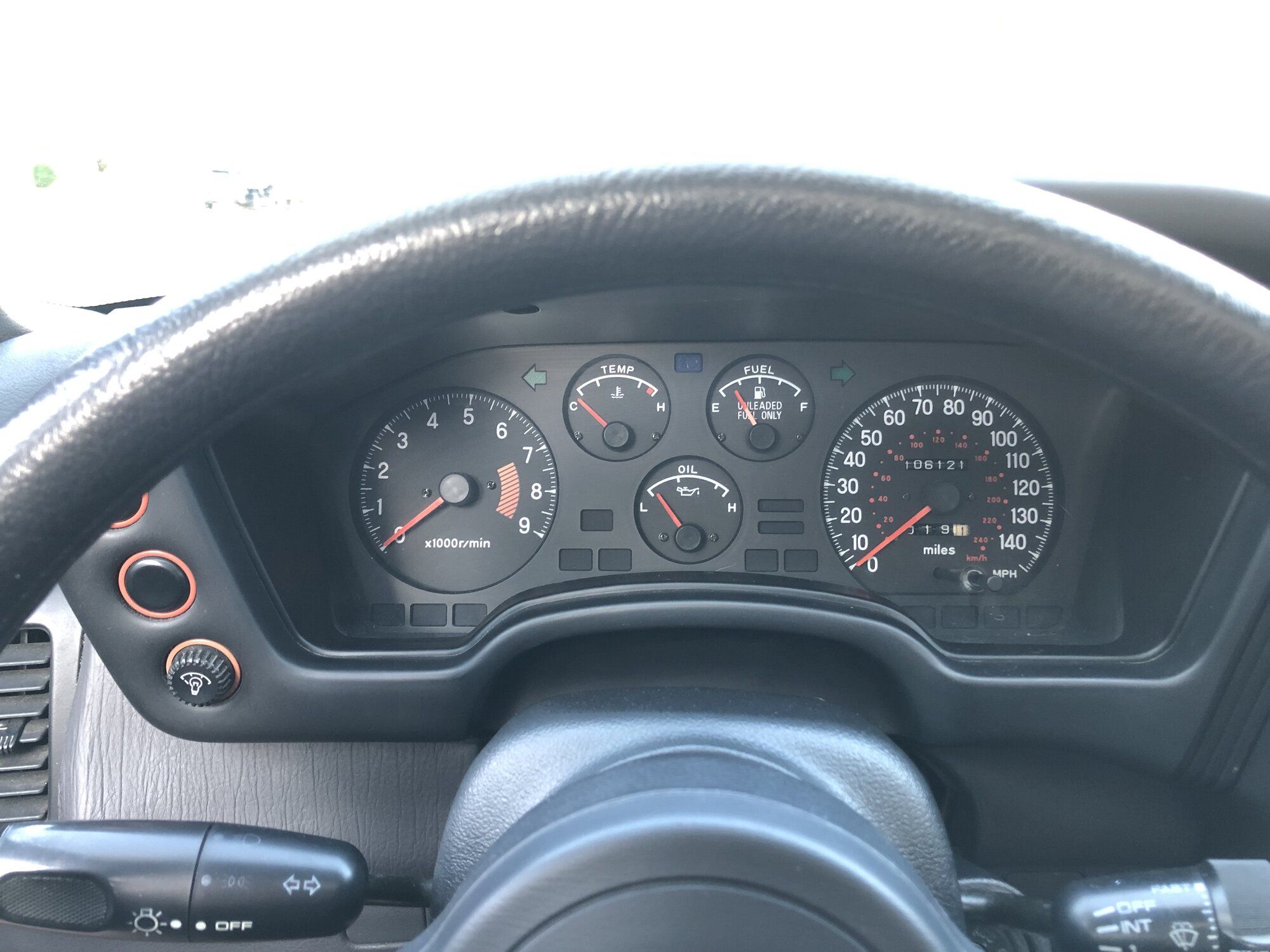

So after jump starting the car after a brief conversation, it starts but it's got the classic low coolant idle surge going on like a Honda with a bad IACV. The low coolant light's glowing on the dash, brake warning light is on, but it's running and it sounds pretty solid. I take it for a quick spin around the block, trans shifts smooth, steering feels decent, brake pedal goes straight to the floor, and they are grinding pretty bad while struggling to stop the car. So I bring the car back, did the title/money exchange, go to load the car up, and notice that it's starting to run over operating temp. So I hurry up and drive it up the trailer, we strap it down, and we were out of there with one pretty clean, all stock, Talon.

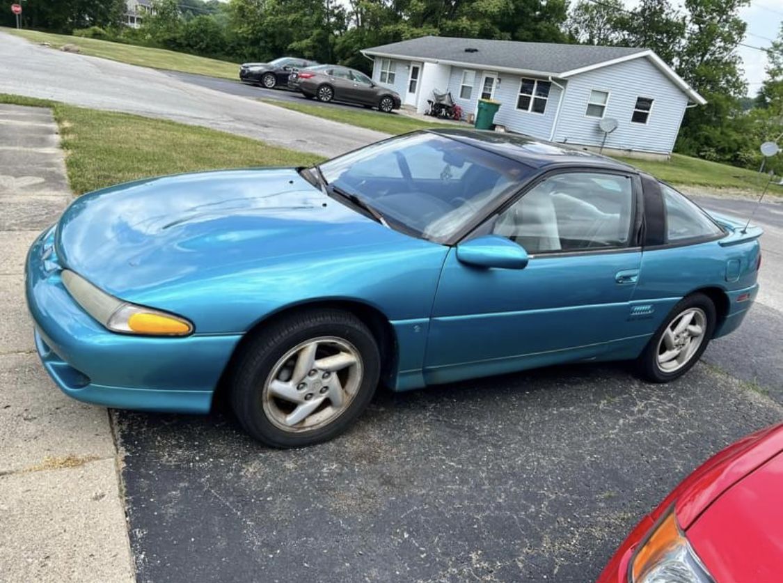

Looks to be a nice clean survivor car, love this color on 1g’s.
It's a super solid car, especially for being up north its whole life. It doesn't have any of the usual 1G rust spots or anything! But yeah I agree, this color has always been one of my favorites. Think I'm just going to clean this one up and just make a reliable, clean driver out of it.

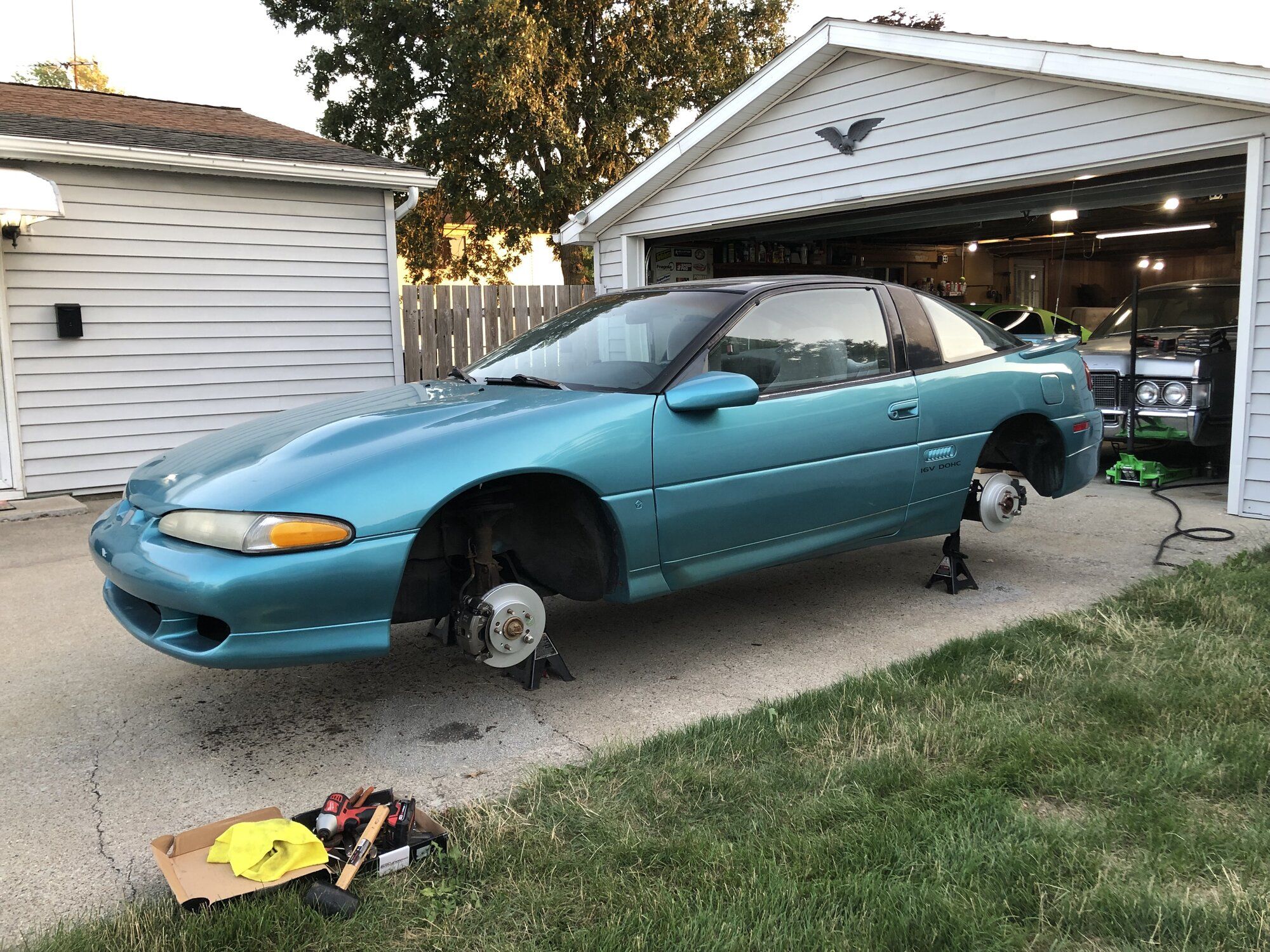

So after I got this thing home I went through the the normal inspection stuff. Checking fluids, belts, leaks, and so on.

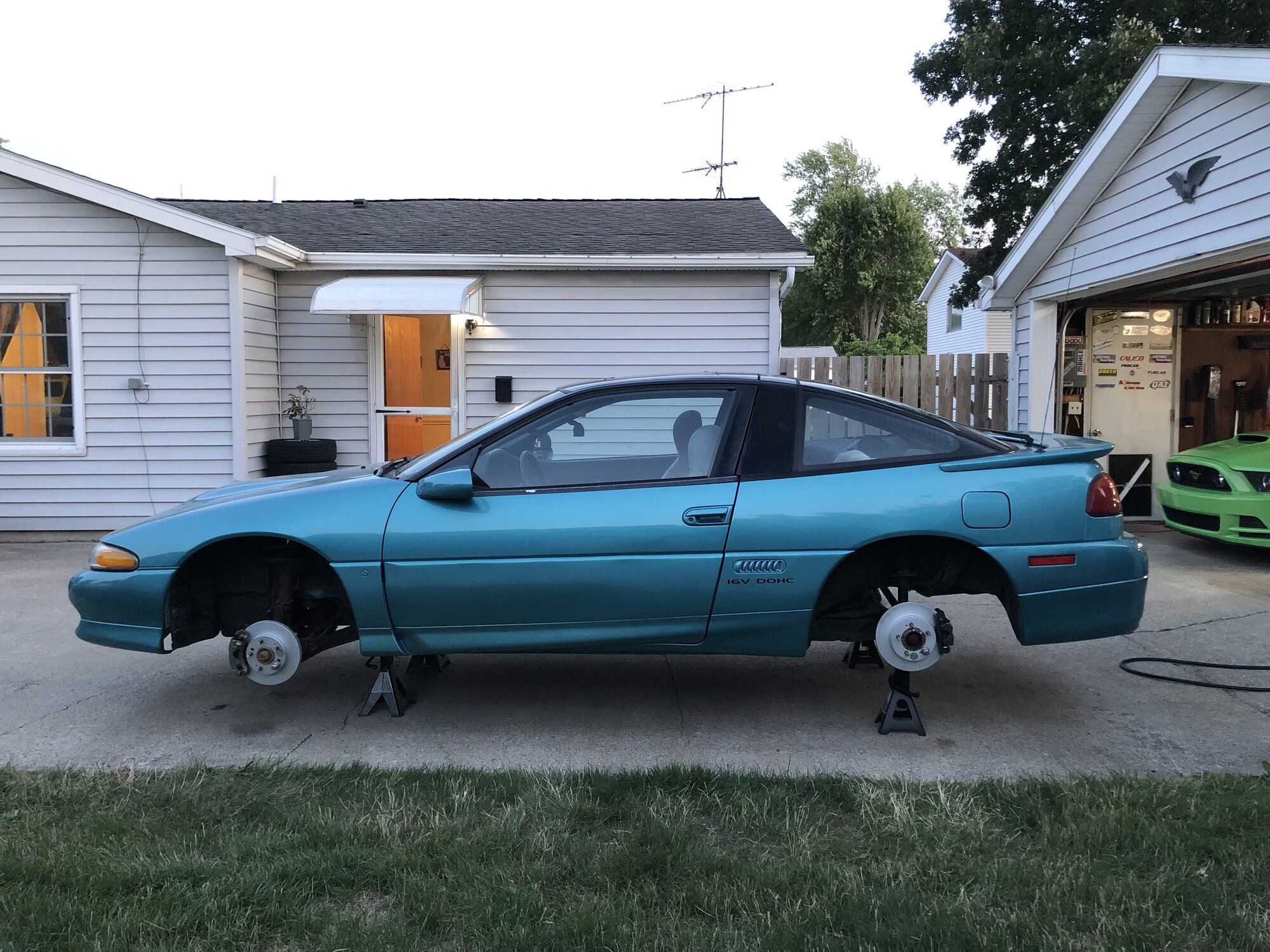

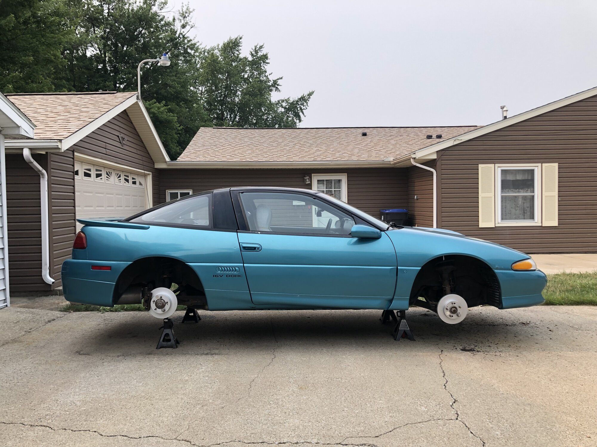

Found that the entire brake system was absolutely junk, seized rear calipers, left front had ejected the inner pad a long time ago, trashed the caliper, and the rotor as expected.
So I ordered 4 brand new calipers, new pads and rotors, then a master cylinder when it was all said and done.
Of course cleaning things up here and there while waiting on parts to show up.

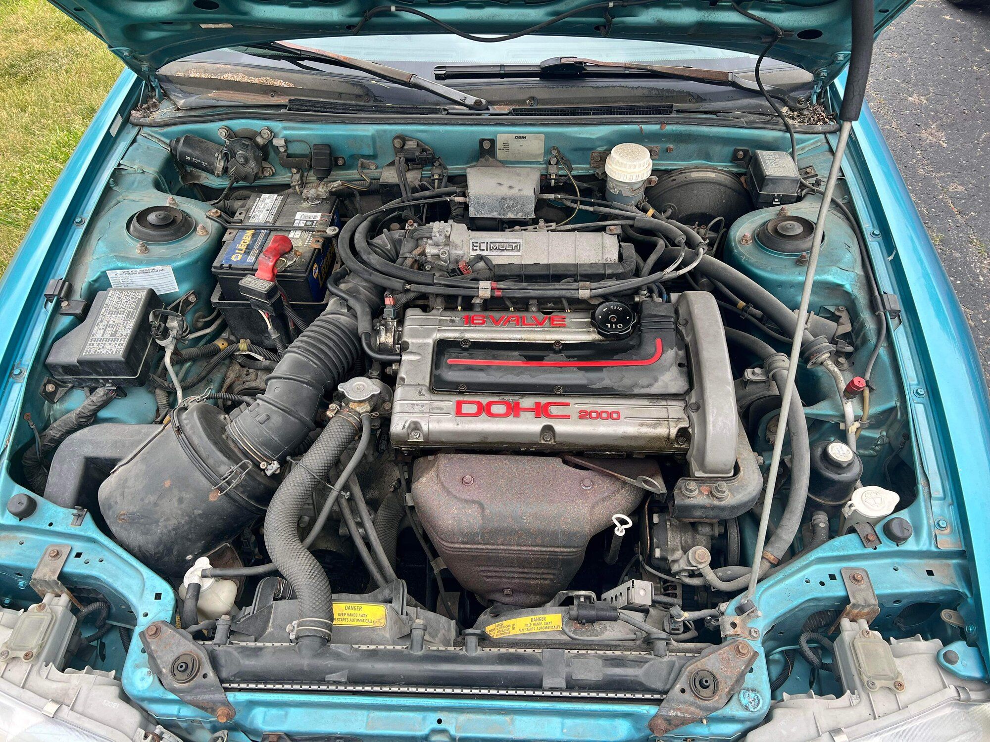

Well the weather has finally started to break here in Indiana so I took advantage of it and figured it was time to dive into diagnosing my poor running condition. Luckily it was something simple that I for whatever reason overlooked. I pulled the plug wires off one by one with the car running to find that cylinders 1 & 4 had no spark whatsoever. So I pulled the coil pack out of the car and ohm tested it to find that the 1/4 coil was way out of spec. After cleaning the coils up a bit from 30+ years of dust and gunk, I noticed that the coil had a pretty noticeable crack in it which probably was part of its failure I’d guess. So after replacing the coil pack and plug wires, she’s back to running on all 4 cylinders again.

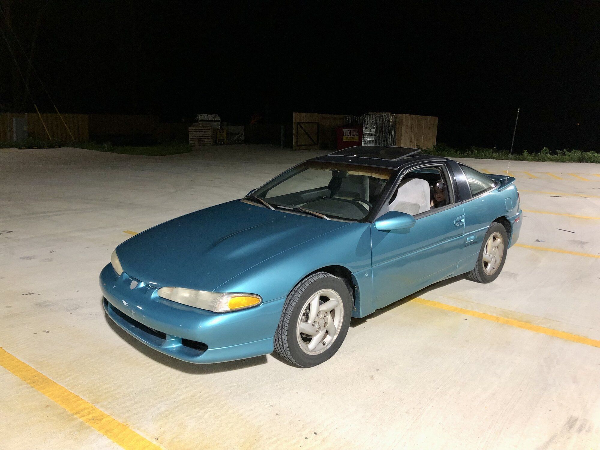

Also in addition to all of the new goodies, I forgot to post a pic of the car after I got the windows tinted shortly before the running issues took place!

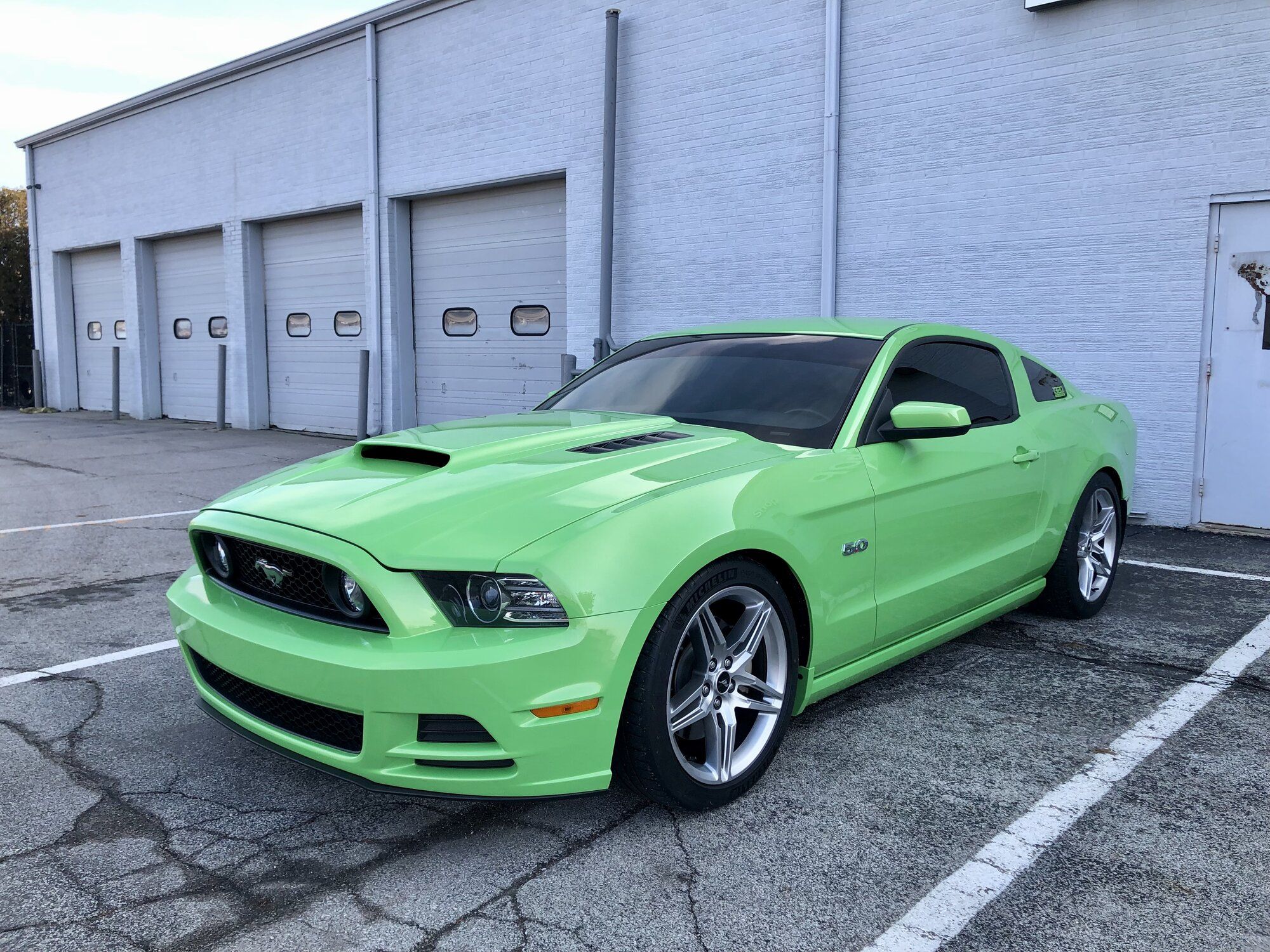

Here’s a better picture of my Mustang! I never was much of a Mustang fan until I drove a coyote car years ago. I picked this up about 3 years ago with 21,000 miles on it and I have absolutely no regrets whatsoever about it! It gets a ton of attention anytime I get it out and it’s an absolute blast to drive. Definitely one of my all time favorites for sure!
Nice! Ours is a 2014 California Special. She’s got 19k and change on the ticker now.
