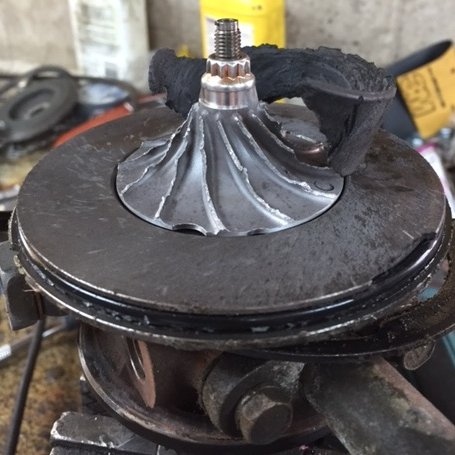

damn it. i just killed my 14b. i was doing underhood inspections and found a boostleak at my turbo. so i take off my intake pipe to check for shaft play, and its all good aside from some fin sandblasting. put it back together and went for a test drive. hit 16 psi and then the turbo quit. no boost and strange sound. went home, took off air intake pipe, and no fins left at all.
turns out i sucked in the 14b rubber reducer ring.
so 14b is dead and now i decide if i continue with a rebuilt 14b or go big16g. i have all the parts already. hmmm.
i decided to rebuild the 14b. i put a new compressor wheel on and took off and cleaned out all my intercooler pipes and intercooler. put it back together and so far so good.

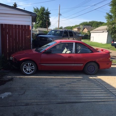

He also bought a 4g63t Colt swap to get a engine and wiring setup. It is currently sitting in my back driveway. 92 red sedan. Still fwd with oem colt trans in it. PO did a decent job putting it together 6 bolt 1990 engine. It still needed way too much work to make it RIGHT, but too much rust and it is incomplete so we are hoping to gut it this weekend to start getting parts together to build another 4g63t AWD Colt RVR.

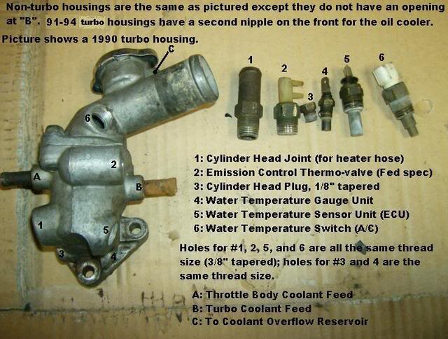

The temp sensor mod i did was i took out the vacuum thermo switch that is located on the 1g lower thermostat housing. Then I replaced it with the thermo sensor that is located at the bottom of the radiator. I extended the wires and plugged it back in and it made the fan activate at a lower temperature, as the rad fan activating sensor is now located in a hotter part of the cooling system.
I used port #2 in the picture to install the rad fan sensor. I removed the emission control thermo valve.

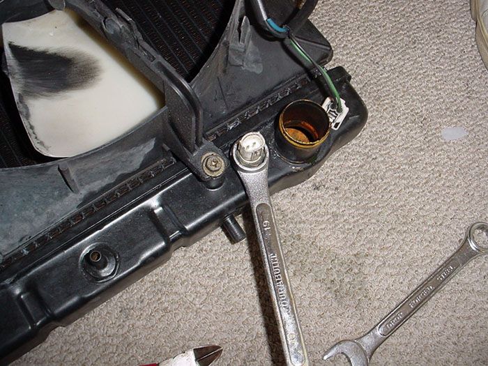

This is the sensor I removed and moved to the thermostat housing. The plug that attaches to this sensor remained connected after I moved it. I think the wires reached. Maybe not... I can't remember.
This made the rad fan turn on once the engine reached about 91 degrees and turned off the fan at 88 degrees.
