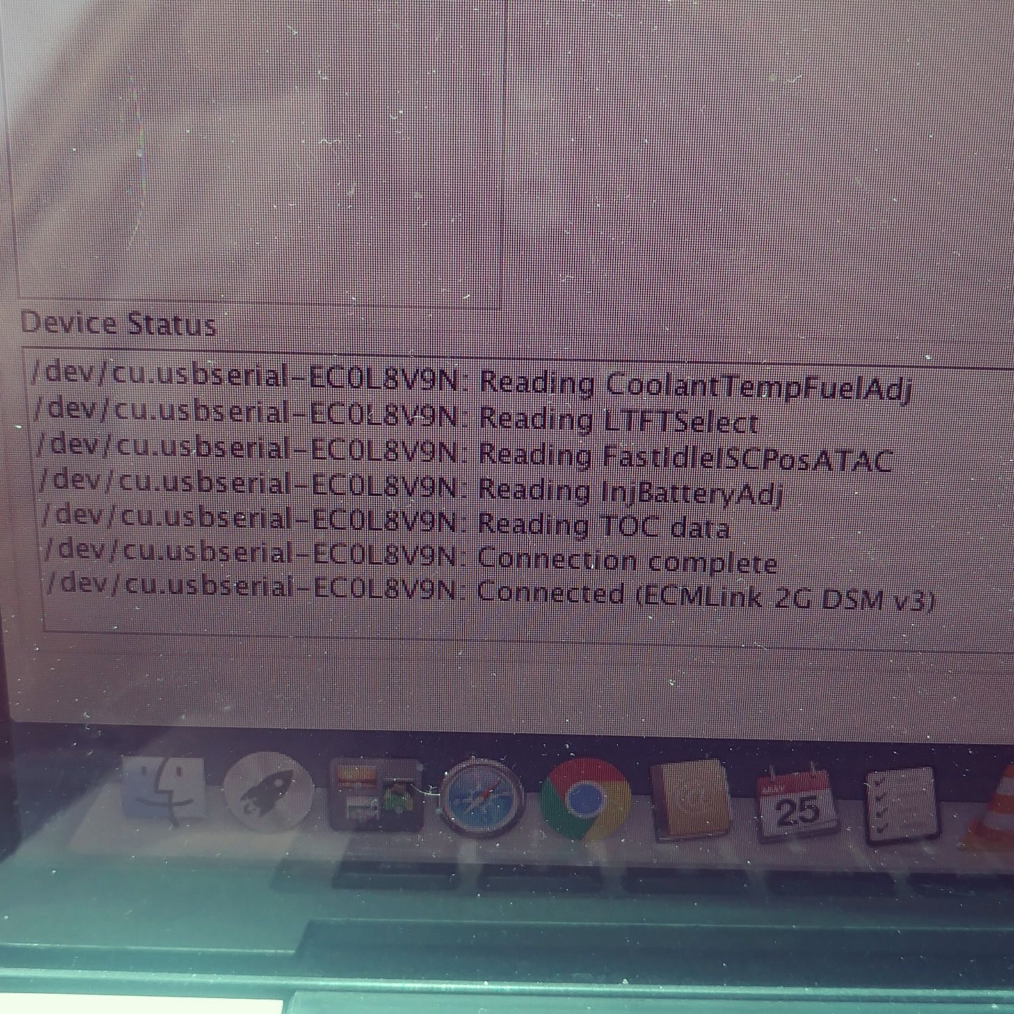

Yesterday I messed with the obd2 port and got my car to connect to link! I believe pin 16 wasn't making good enough contact with the link cable. I also reinstalled the software and driver, so that could have been it. It's been a while since I have touched ecmlink so I'll have to relearn a bit of the tuning process and what to log.

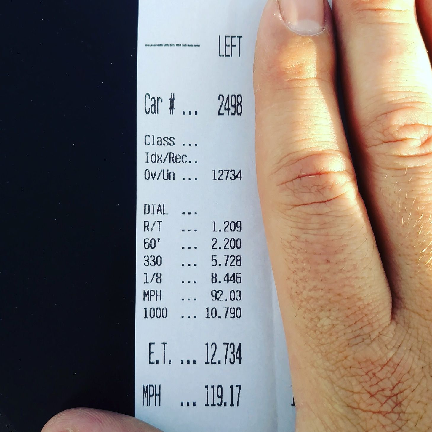

Went to the local drag strip last night to start working on the tune more and see what she can do. First run I beat my old record with a 12.734 at 119! My launch was terrible...LOL

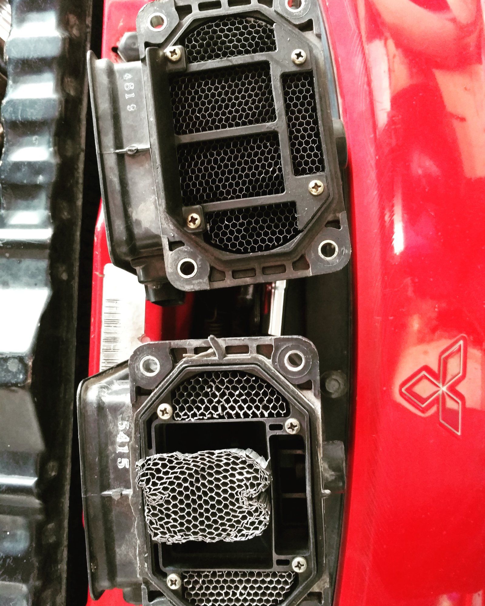

The honeycomb inside the 2g MAF came out which was cool, luckily it didn't get sucked in! The car refused to build boost and ran like dog shit while out of boost like it was in limp mode. This gave me the opportunity to finally switch to the evo8 MAF I planned on running. It was a very easy switch, just had to do a little mafcomp adjusting in link and it's good to go! I was already over running the 2g MAF with the hx35.

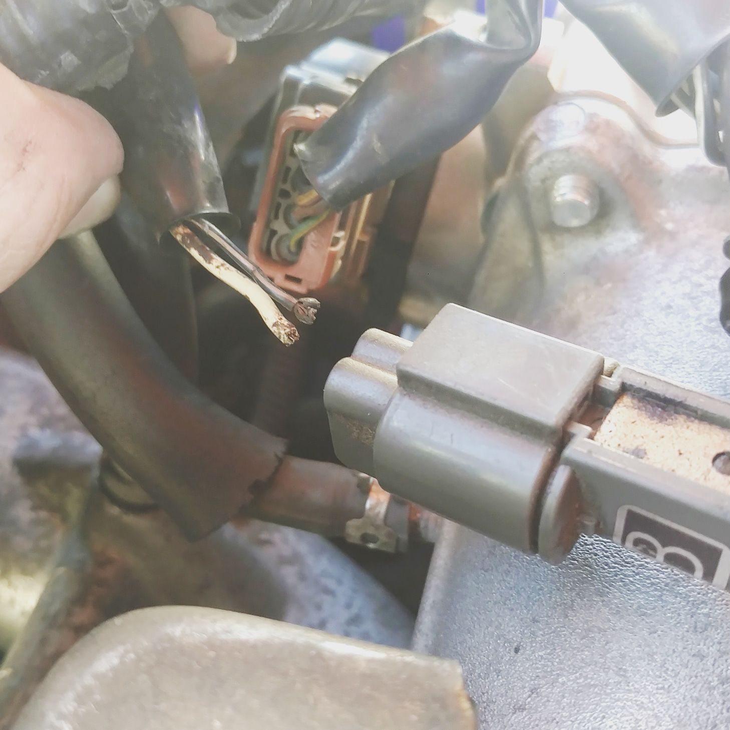

Also had the wires to the male pigtail side of the knock sensor break off somehow which cause the car to run terribly. Link couldn't communicate with the sensor so it ran off of the minimum timing tables. That was an easy fix as well.

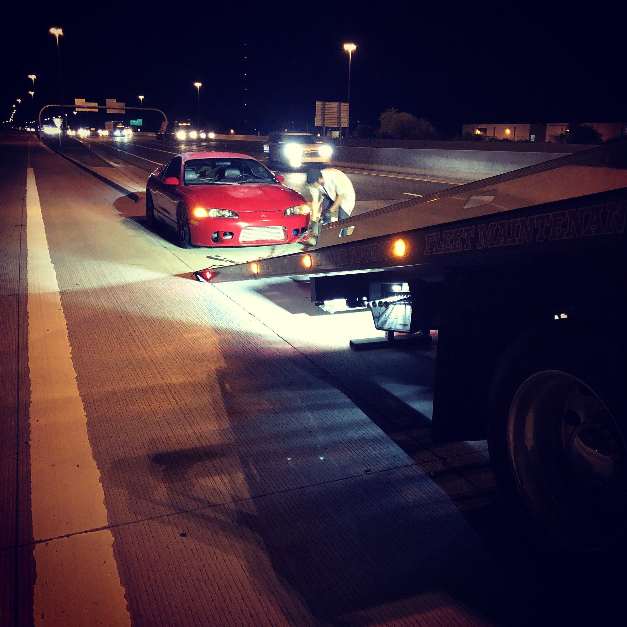

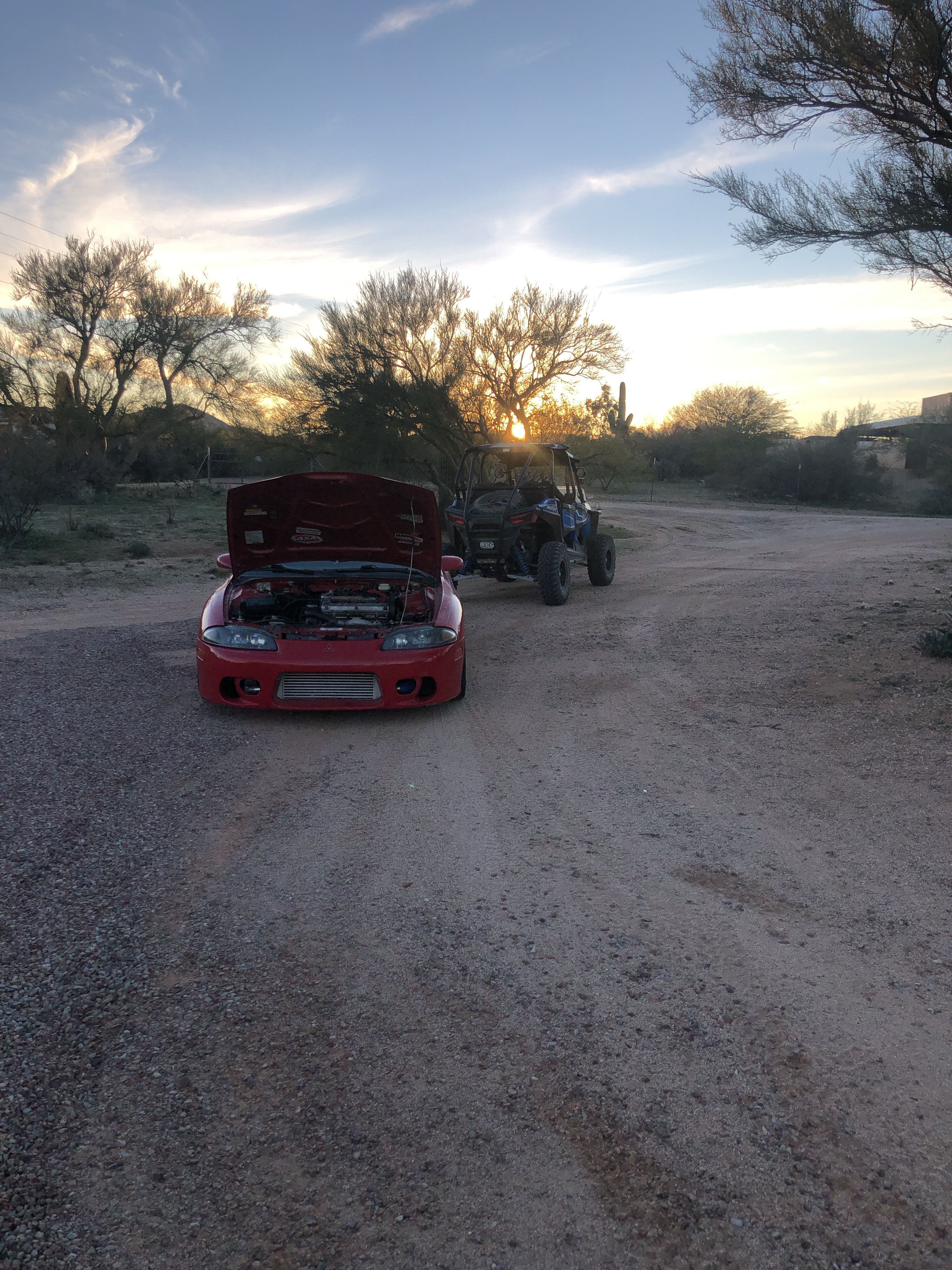

Bad news! First time I’ve ever had to call a tow truck!

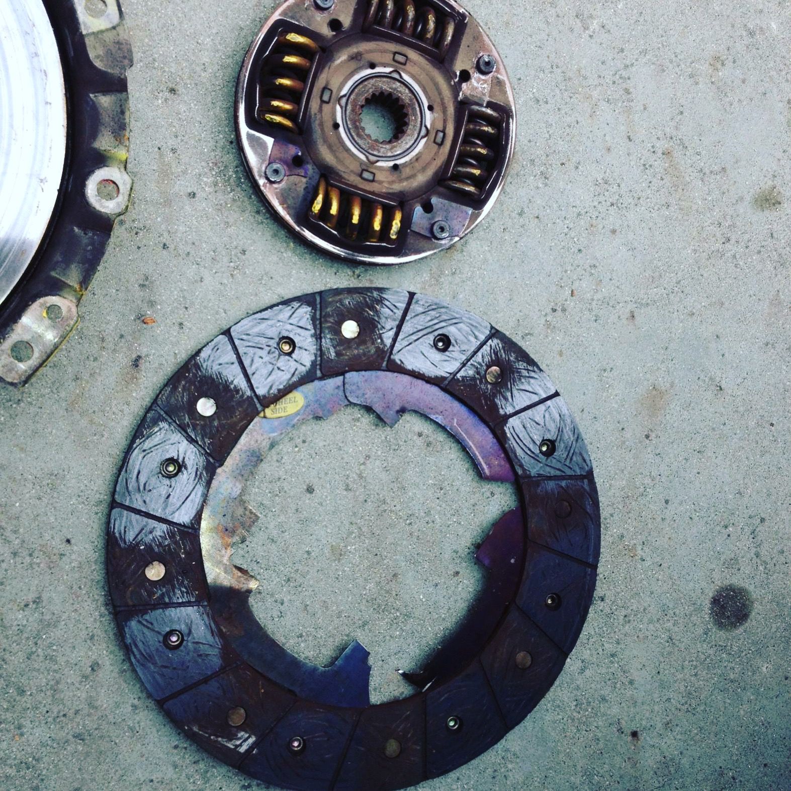

No it’s not really that bad honestly. I was driving down the highway, going about 65. I got on it in 5th to go around a car and the car acted like it slipped out of gear, which has never happened so I thought it was odd. Noticed it was sitting at under 1000 rpm like it was idling, pulled it out of 5th...put it back in 5th...car just revs with some crunchy noise. I pulled over and put it in each gear and tried to move, no movement and the car will idle in any gear, I can also rev it freely, just makes crunchy noises....

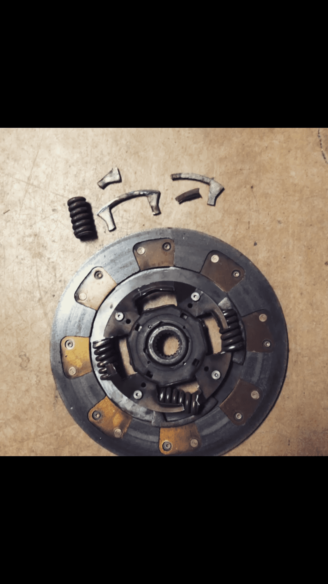

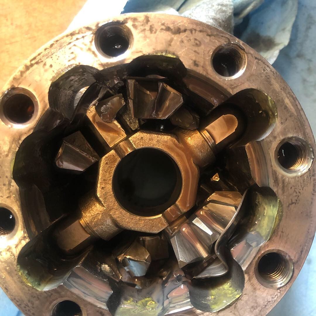

I’m fairly certain the hub of the clutch disc failed, it’s a Kevlar southbend and I’ve heard of issues similar to this. Good news is the engine isn’t hurt! If it’s just the clutch then I take this as a sign to finally put in the twin disc I bought a while back haha. If a shaft in the transmission is trashed then the spare transmission I got a few weeks go will come to the rescue.
I think something similar to this is my issue:

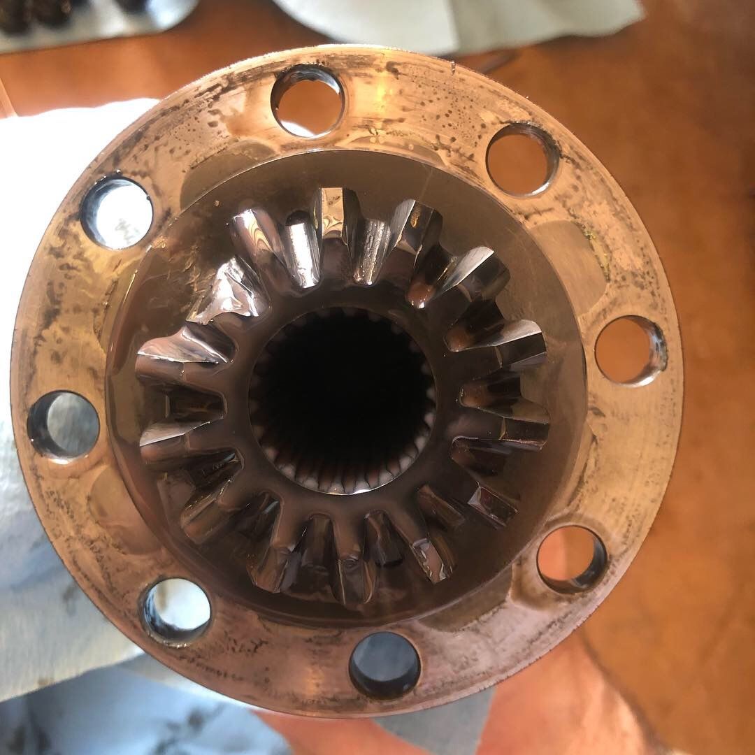

I was right, the hub of the clutch disc failed. The pressure plate and flywheel are in excellent condition still though.

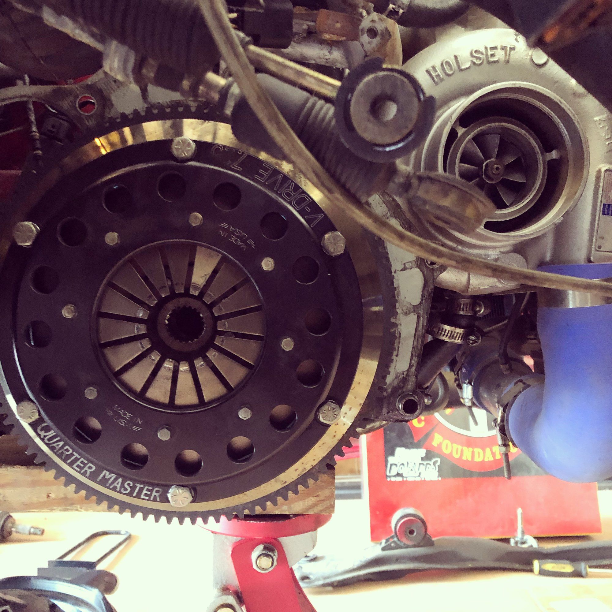

Installed a quartermaster twin disc and swapped my trans and the thing is SWEET.
Shifting is seamless and feel great.

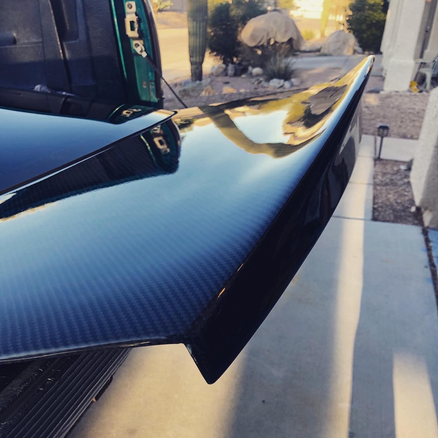

I picked up a 2gb hatch and spoiler as well and put that on, along with (worn) a carbon fiber hood.

I have only put maybe 5 miles on the car with the twin disc and I’m a huge fan. The engagement is completely different than the southbend that was in it and I really like it, this thing grabs HARD too. Mine is used as well and actually measured under recommended limits for use so I’m going to rebuild it here in a few weeks or when it starts giving me issues.
So far I love it though...the chatter tripped me out the first time I started it and pushed in the clutch ROFL

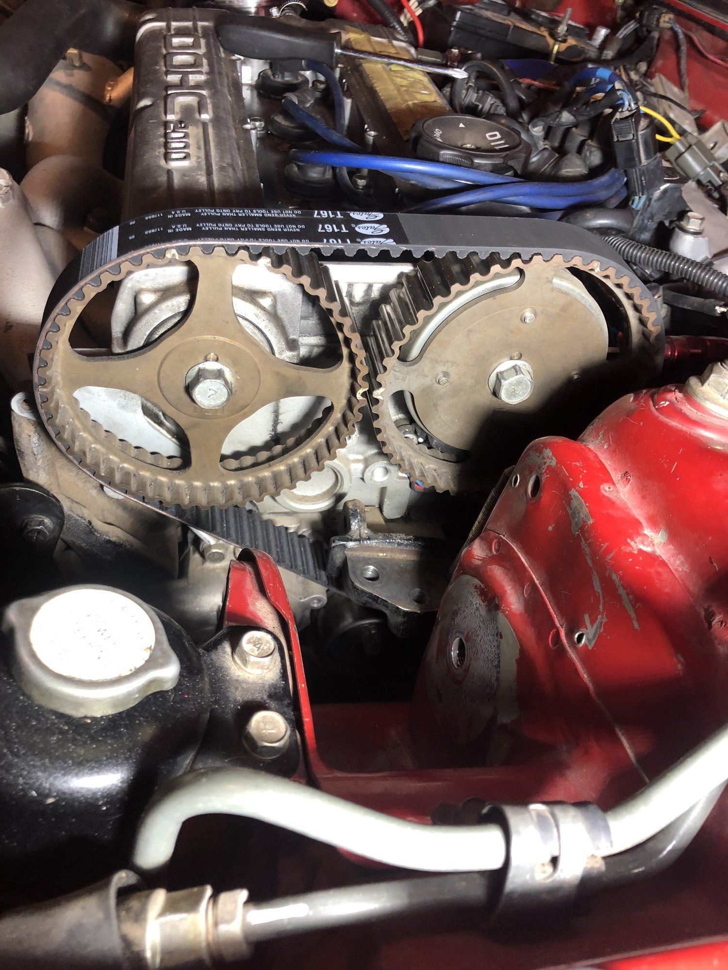

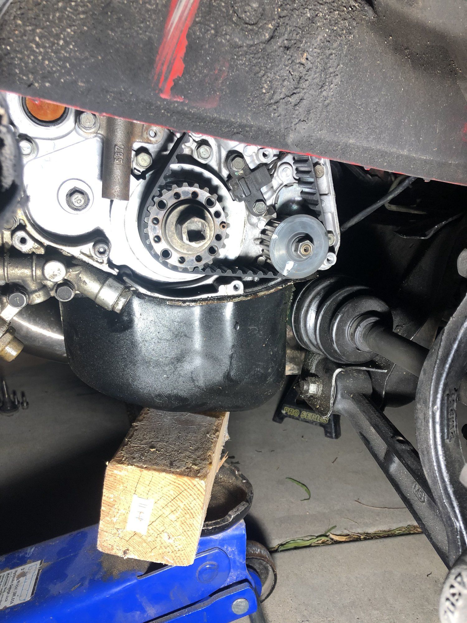

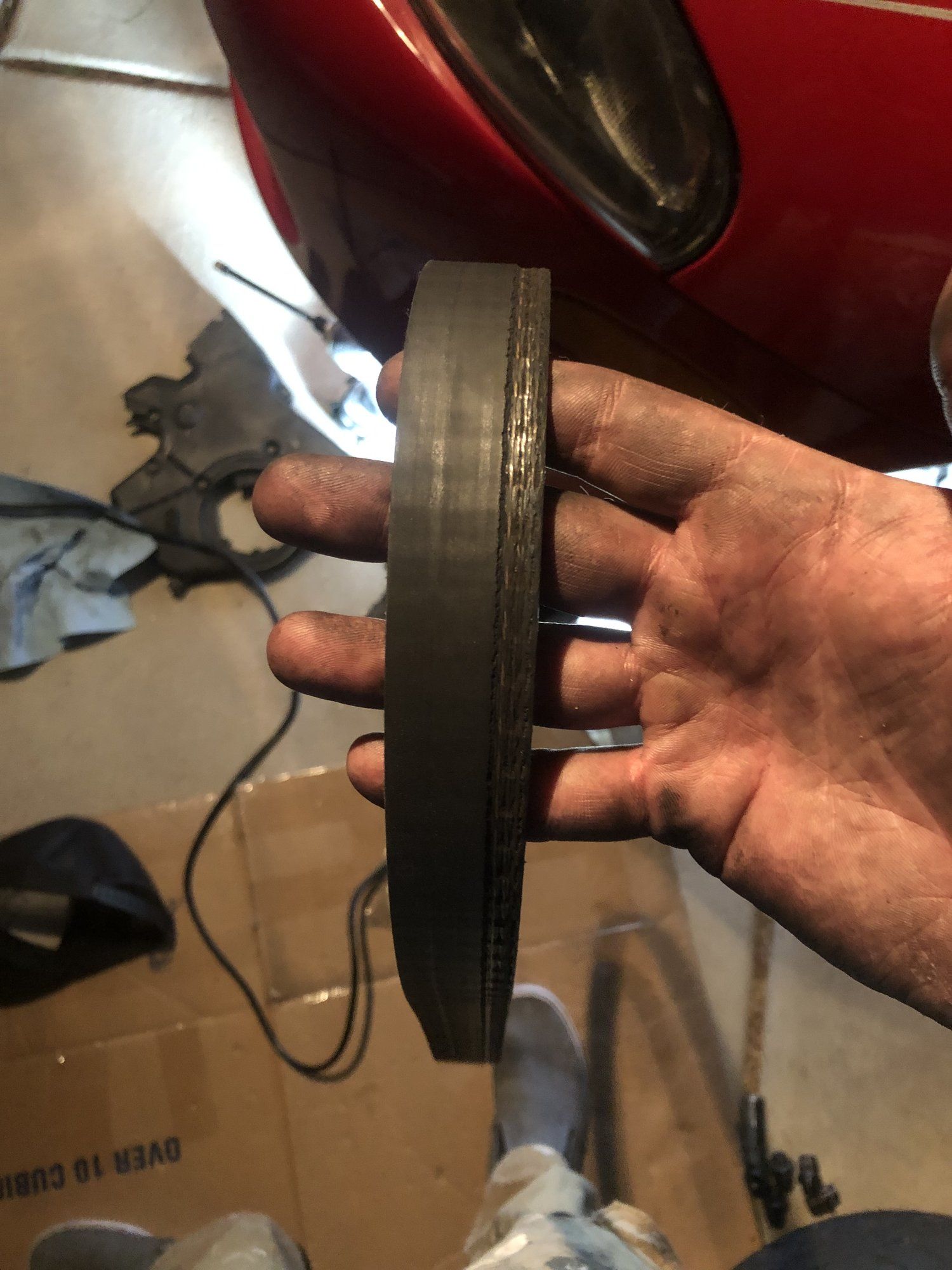

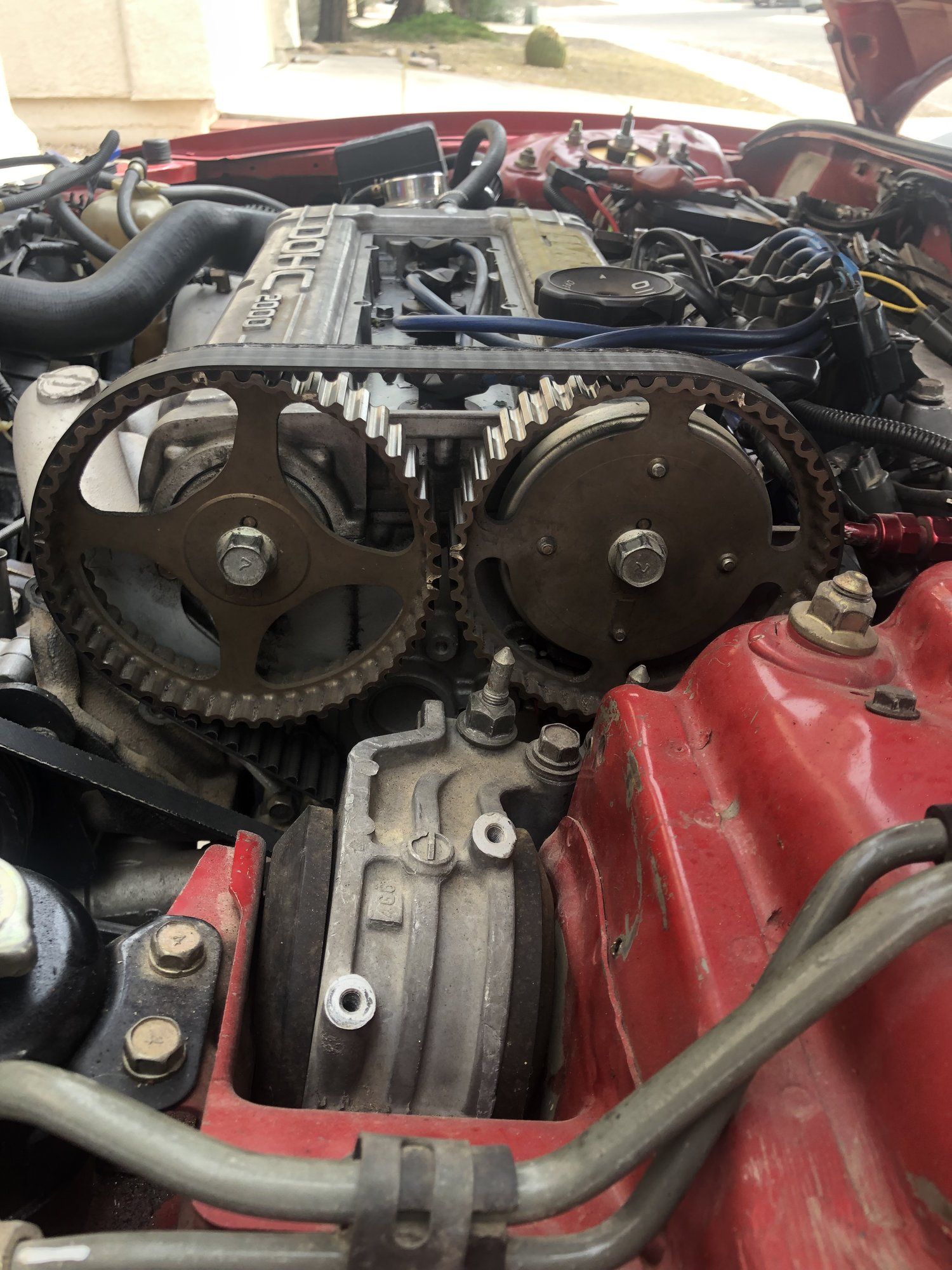

So I’ve still been having big issues with getting the car to run as hard as I know it can, bought new coils, wires, plugs and a knock sensor. While I was starting all of that I decided I’d check my timing just to make sure I’m set for the test and tune this coming Friday.
Well it jumped timing on the crank, who knows how long ago....not much but enough to make the car run not quite right.
I’ve needed a new belt for a bit anyway I’ve just been putting off doing it
Thanks to some help from fellow dsm peeps I got the new belt on with no issues, timing is much easier than people make it out to be. I’ll admit I was a bit nervous about doing it but it was pretty easy. I initially used the VFAQ method to set the tension which did not work at alllllll. Instead I just set the tensioner pulley with the grande pin still in and then removed the tool, worked perfect.

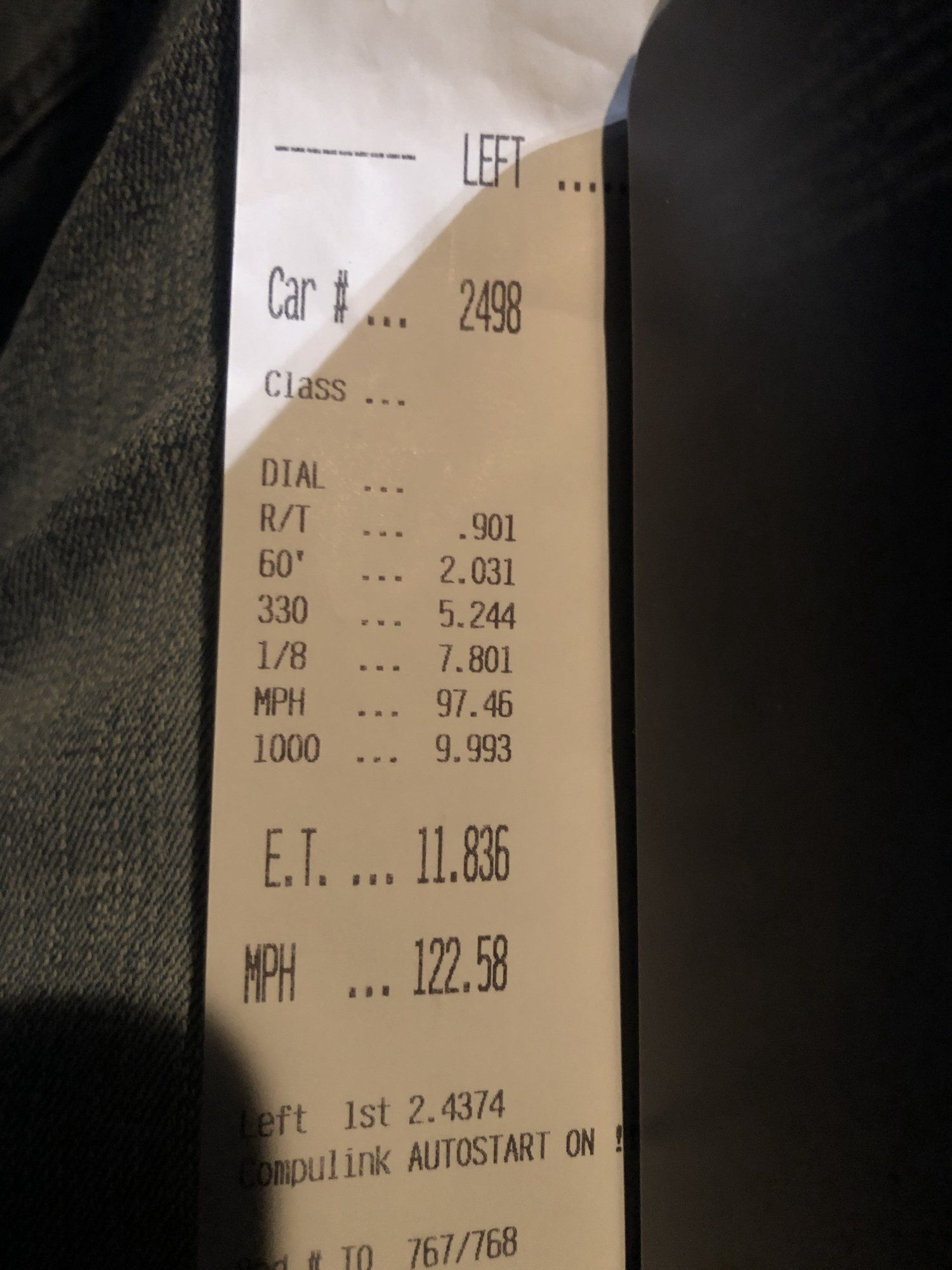

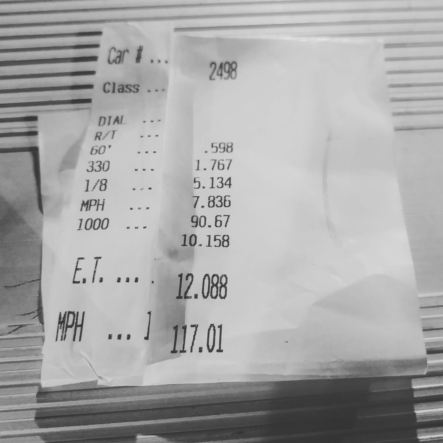

I can finally call my car an 11 second car! Clutch was slipping pretty hard so I turned boost down to 27 and increased timing (was running the stock 2g timing map) to keep torque down.
Got it done I’m so pumped, so many hours into this freaking car.

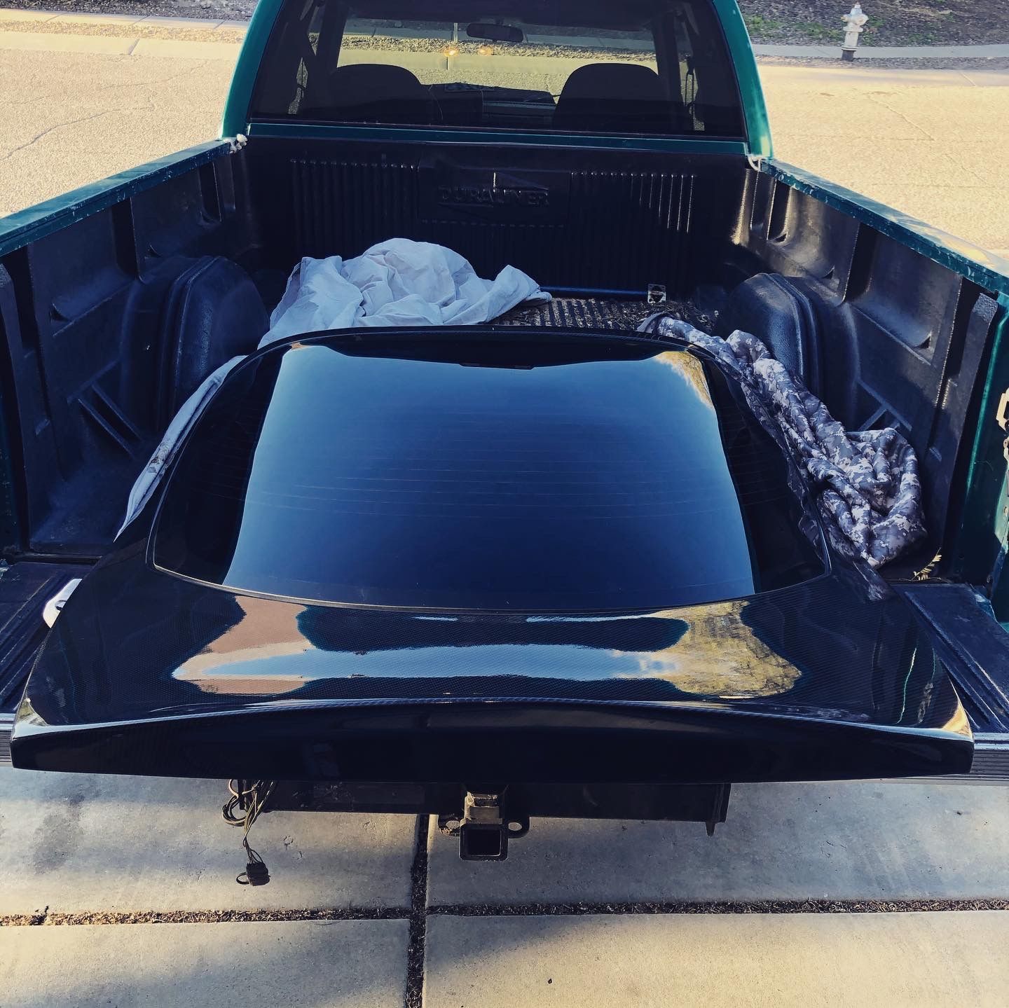

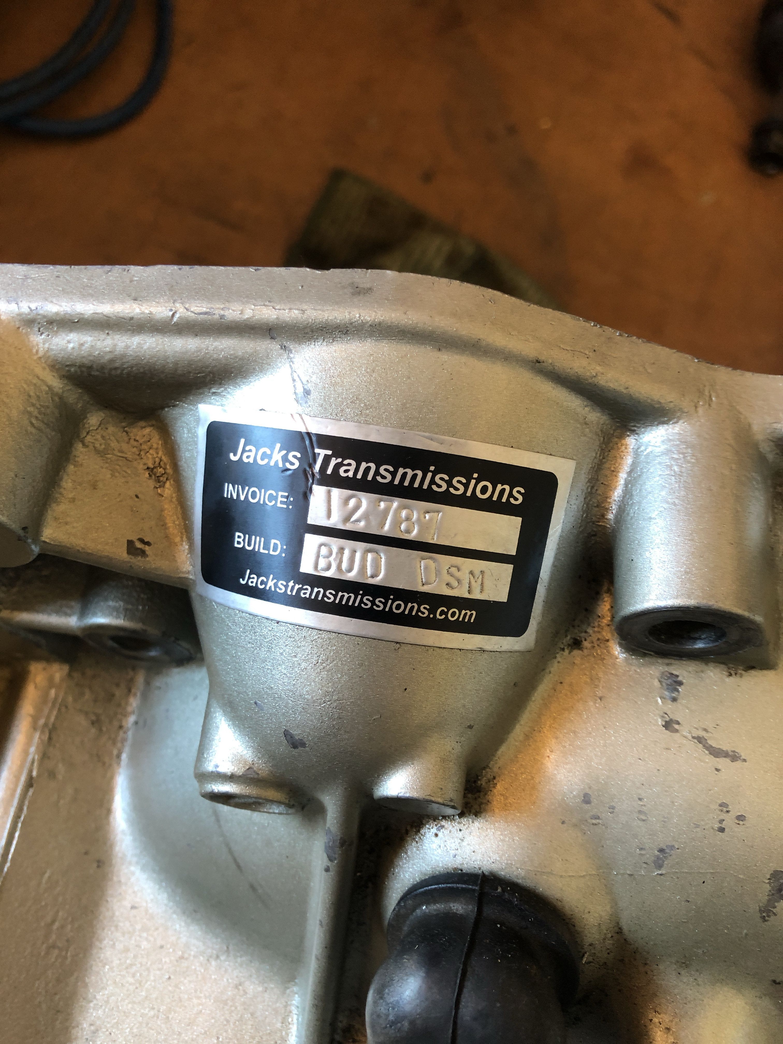

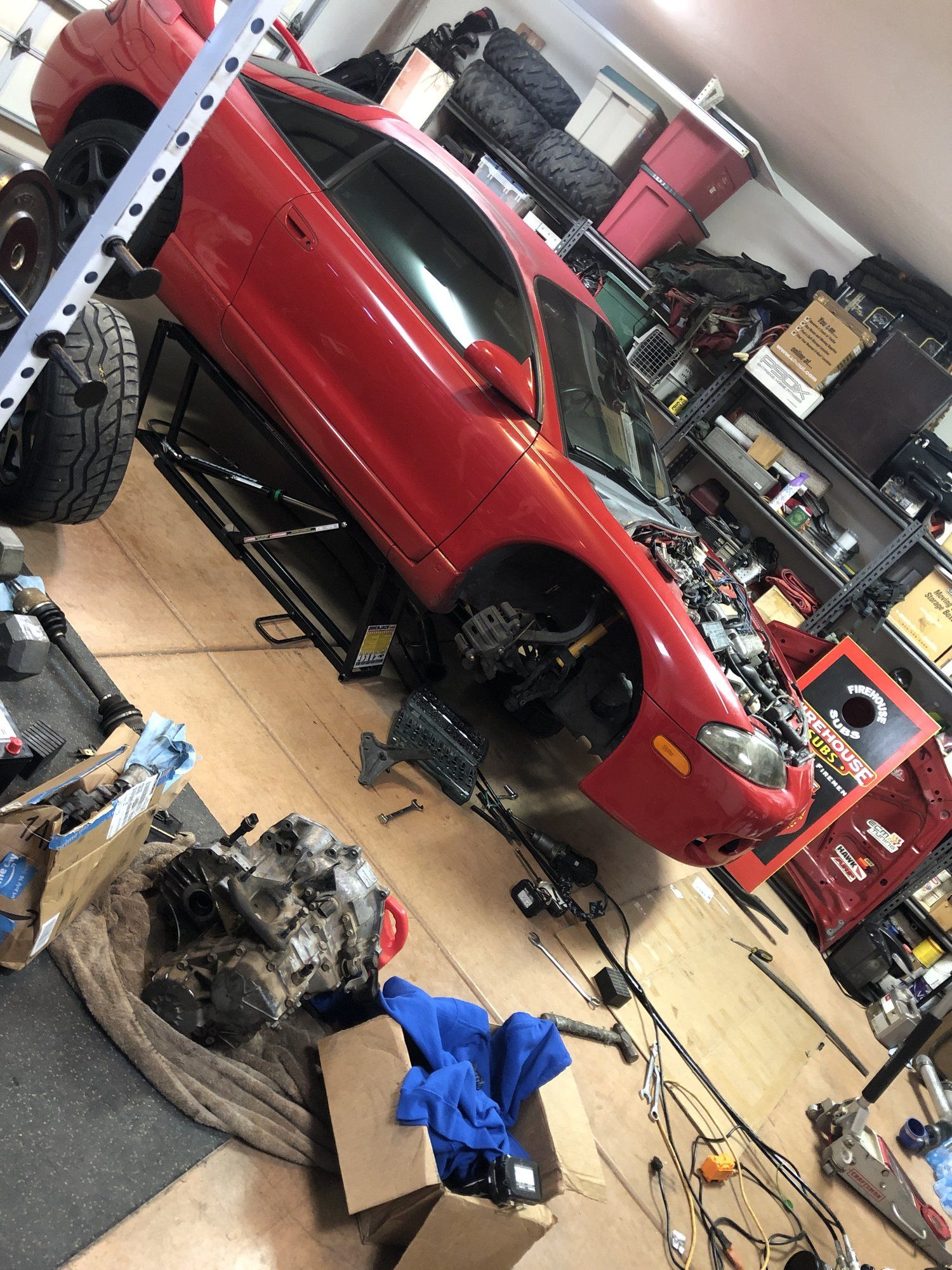

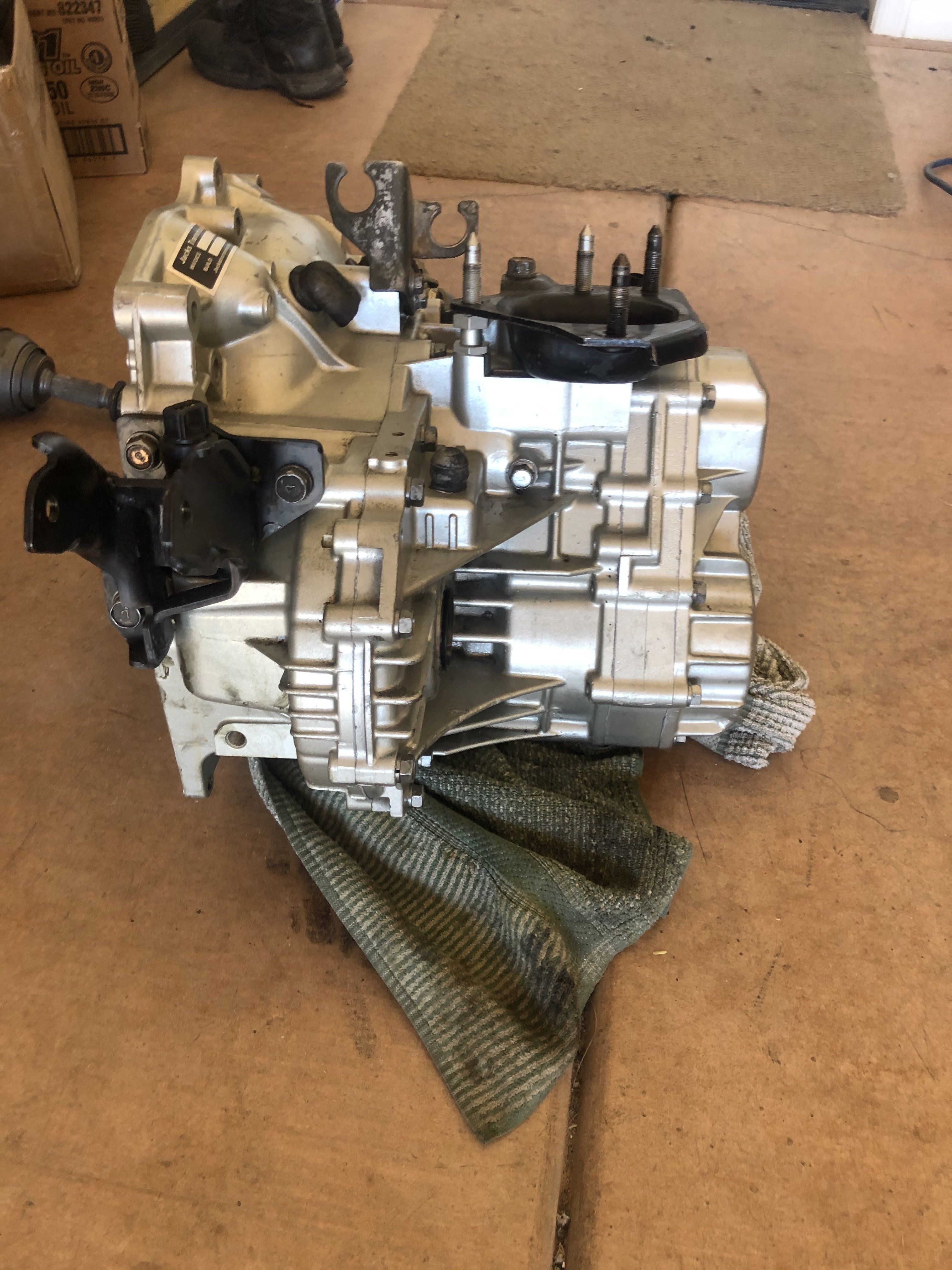

Anyway, local car got parted unfortunately, so I picked up a carbon hatch, jacks stage 1 transmission, fic 2150’s and some knock off bride seats...because why not....
I’m going to get the trans and hatch Friday and swap then on the car Saturday along with new discs for the clutch. Going to have to clean the piss out of the fuel lines/system I’m sure so that will be fun. Car should be going again though ideally by Saturday, I’ll post.
Hope to get it going on the hx40 before it starts getting too hot but that’s a big hope.

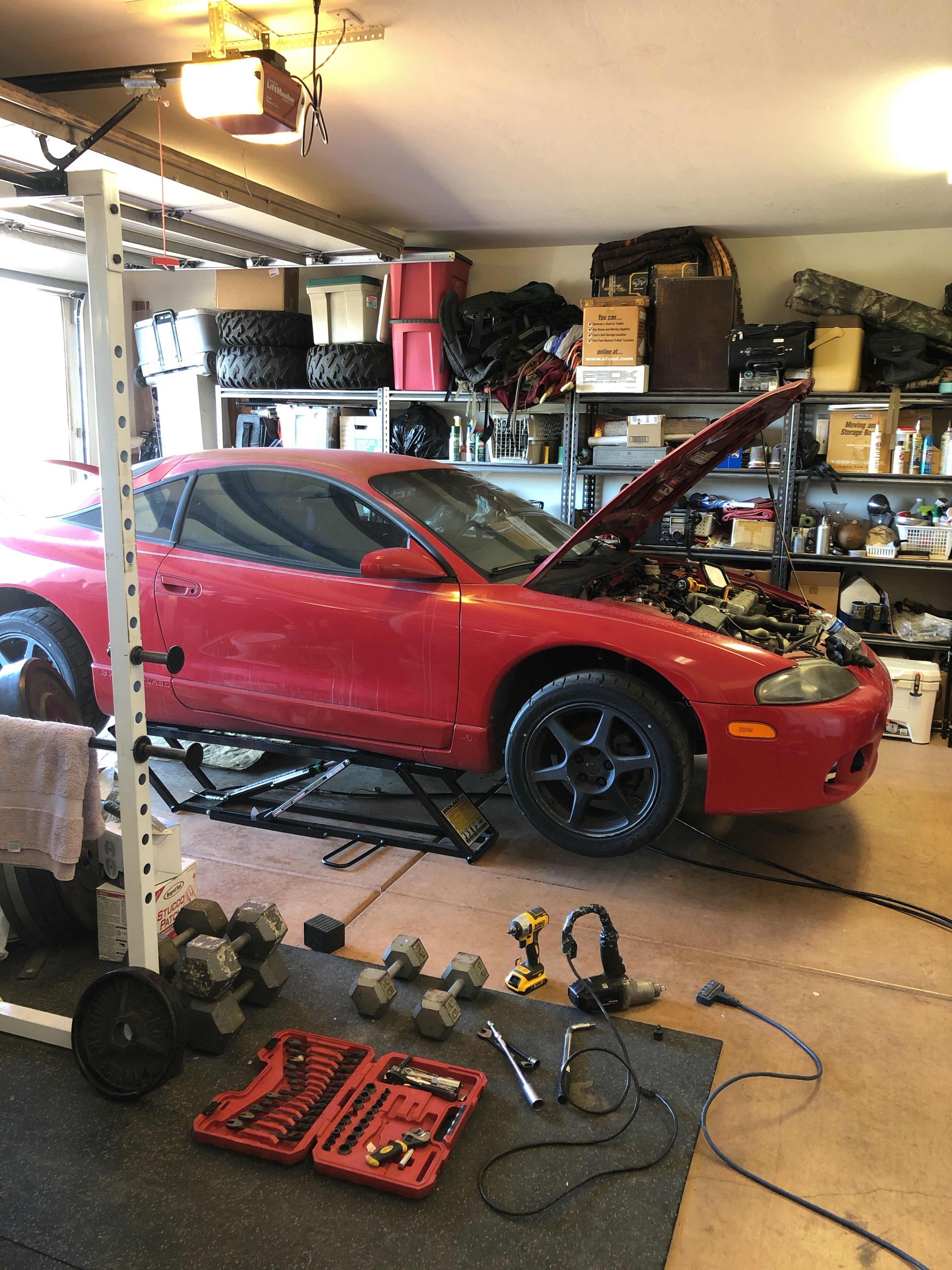

Car is back up and running as of Saturday...these transmission swaps get easier and easier LOL
I’ve also decided that it’s time to either paint this thing or refinish the surface/fix imperfections and have it wrapped. Not sure yet what I want to do but I’m a big diy kinda guy so I might respray it myself, don’t think I’ll mess with wrapping the car myself. Going to hold off on installing the carbon hatch until then, the car doesn’t do it justice right now. Paint is pitted/peeled down to metal in spots.

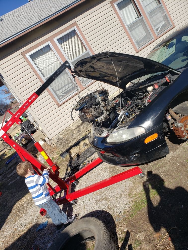

This will be your son in a couple years, just wait !!! :thumb:
This is my lil grandson Ayden, at 3 1/2, helping his dad pull a 4g63 out of the Talon so Papa can rebuild it! :) I'm so proud of him!!!
